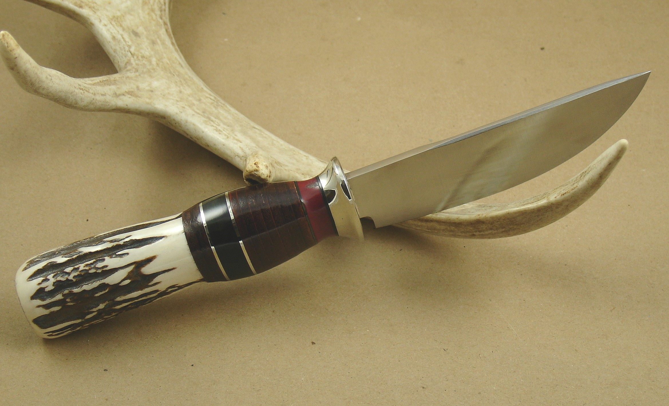

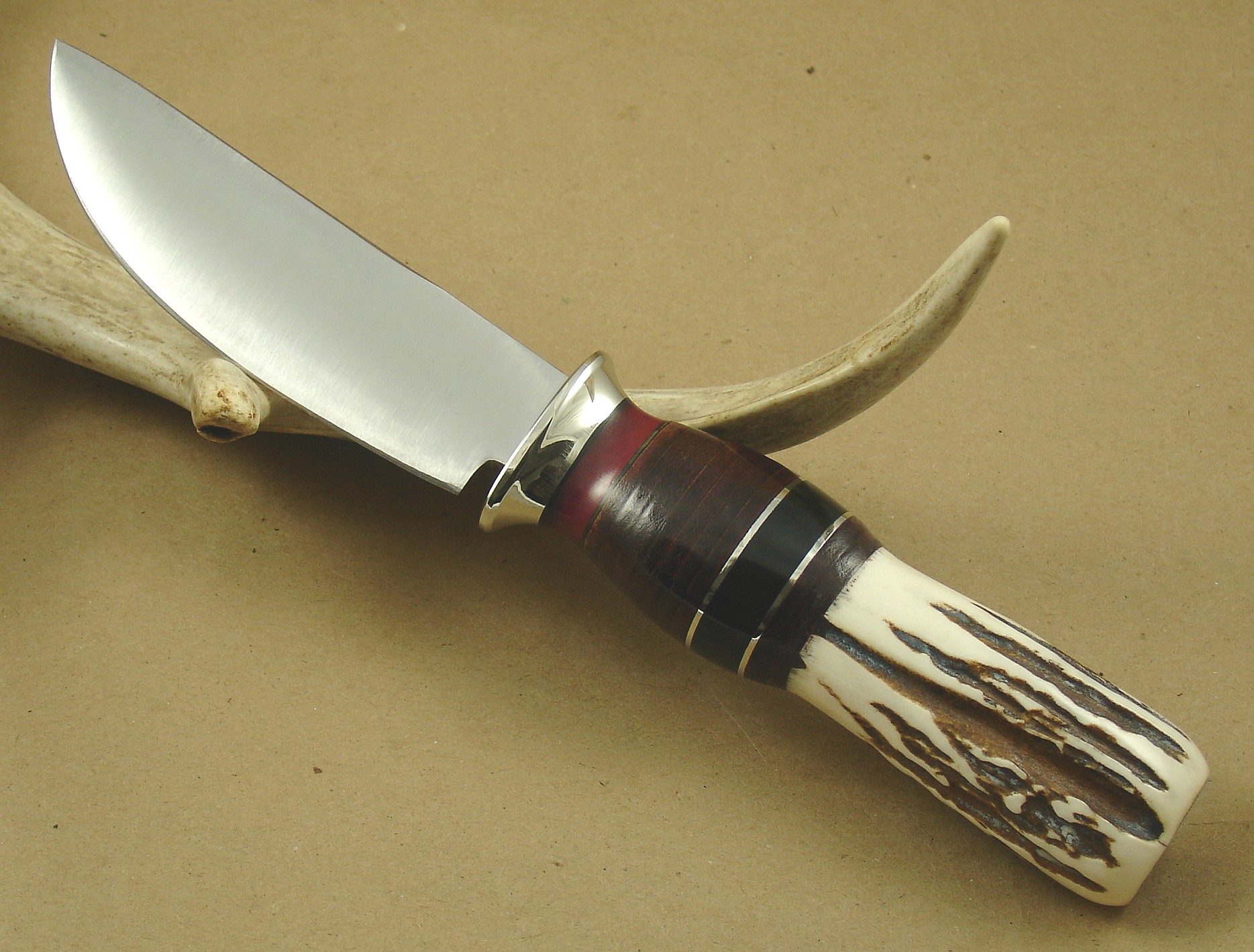

Here is the latest, just finished it today. An unusual shaped blade it's sort of a woodcraft-camp-skinner sort of thing. I really like the way it turned out (except for the red spacer). It fits nicley in the hand, nice balance, clean solder joint and finish out.......................I only forgot one thing!
My damn makers mark! Can you believe that!

Hey Gary,
You may not be proud enough of it to put your mark on it,
but I think I like it the most of all you've shown so far. I think you are super talented at knife making and I see a bright future for you in that arena. Keep up the good work, and let me know when you start takin orders. I want to get my name on that list.

Well, you need an etch.
Though most that forge prefer a stamp over an etch - showing that it is indeed forged rather than being made by stock removal. Most all stock removal guys use an etch.
What are the specs - oal, blade length, etc - from 52100?
I like the shape, a knife that will make a good skinner looking at the first couple inches from the tip and looks like the blade is thick enough for camp chores. Nicely done!

Gary, your just getting better and better. That looks really nice. I really like the handle, looks like it would be comfortable.
Keep up the good work!

Thank you Phil..........................
I'm my own worst critic. I want a knife I sell to be perfect and to perform well. I figure by August-September I'll be ready. I'm heading to Wyoming at the end of the month, I'm going to spend five days with Master Bladesmith Ed Fowler. He is the man when it comes to a performance blade.
Hukk.................It's 10" overall with a 4 3/4" forged 01 blade. That piece of red G-10 I threw in there really looks out of place. I'll do something about the mark (or lack of one) I don't know what yet! I still can't believe that I overlooked that. One just gets all excited about the quench and forgets to take a second to mark the blade. It dawned on me as I finished up soldering the guard and I wasn't about to start all over.
Craig.....................Thanks a bunch! I really enjoy making knives and the ideas just keep coming. I would like to venture off in so many different directions, but I think these Scagle style hunters will be my fortae.

Gary I am really liking your work. You are making some beautiful knives. I have been wanting to compliment you on them but "at home" I'm on dial-up and it's hit and miss getting logged on to the site. Here at my sister's, she has high speed so I get on everytime. I've only recently gotten interested in fixed blades and began looking at them for what they really are. You are making some fine lookin' knives my friend. Keep up the good work and please keep me in mind when you start taking orders. Definitely put me on the list. I'm wanting a smaller fixed blade about 3.5 or 4" blade. I'm not finding much that catches my eye but your stuff is looking like just the ticket. Keep up the good work.

Gary,
It is hard to say, but that may be my favorite of all the knives you have made so far.
I have an Electro-Chem Etch machine.
If you want to have a stencil made I will etch it for you.
BTW, I kind of like the red spacer. It adds a touch of color.
I really like the overall effect!

I think you may have to etch your mark now. IMG makes good etching power supplies and Patricia is great to work with when setting up your art work if you decide to buy into that route - it's what I use. I also have the raw stencil material and the developer to make a stencil if you have the artwork. I have not made one yet, but I know how to do it and can make one if you need one. (the project I bought the stuff for fell through - oh well,
it's not very expensive).
http://www.img-electromark.com/catalog.php I have the SS 211 which was marketed as being specifically for knifemakers when I bought it and it came with 3 electrolytes of my choosing as well as a neutralizer for the electrolytes once the etch was done.
The electrolyte must be neutralized and fully washed to avoid rust.
Anyhow, I can make a stencil, just let me know. I'll let you know what I need.

Gary, this one is also my favorite so far
Just a gorgeous knife !!!
And being from Michigan and being a Marbles fan
(before they went global)
This knife blade shape is right in between the woodcraft & fieldcraft
Has the bow type curve on the bottom like the woodcraft
but is longer and comes to a bit more of a point like the fieldcraft
With what your putting out and all the equipment Hukk is putting
together, maybe we will have a new knife company out there in
California in the future, if you 2 join forces !!!
Great stuff Gary, proud of ya !!!

Very nice Gary...the blade reminds me of a Marbles Cowboy skinner which I've always liked except for the guard....your guard and of course your handle is much mo betta.
