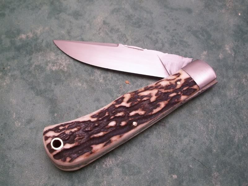

all I use is a dremel and a reinforced cut off wheel that is worn down to about 1/2" in diameter. it does take a steady hand and practice but it's not impossible.

MM those look NICE ! What do you mean by reinforced cut off wheel ?

thanks. they are the black dremel cut off wheels. they are reinforced with fiberglass, they are thicker and tougher than the thin brown ones that snap if you look at them funny.

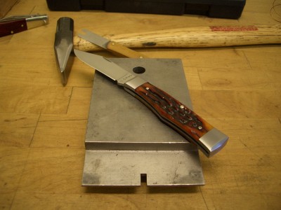

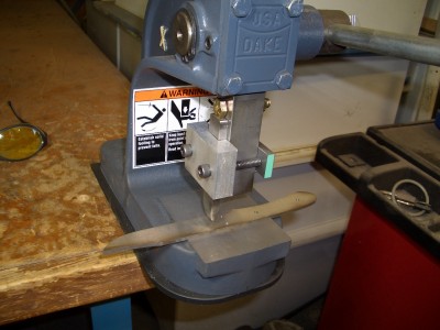

Cutting a clean nailmark has been one of the most difficult aspects of folder making for me. No matter how much I practiced with a flex shaft tool I would occasionally have them get away from me and ruin my blanked blades and it was back to square one. A big ugly nail mark ruins the apperance of a blade no matter how well it is ground and swaged (imo). I finally buckled down and bought a 1/2 ton arbor press and hand made a stamping die out of O1 to press/stamp the mark. What used to be an operation that would make my hands tremble and sweat bead on my forehead is now done in a few minutes. I still have to go in with a small dressed down Cratex wheel and do a little deepening of the mark by hand but the results are very nice!. I do'nt know if you want to go this route but I can post some pics if you're interested.

That press is a good idea. Please post some pics id love to see them, and if you can some of the press and the die as well. Thanks,Bryce

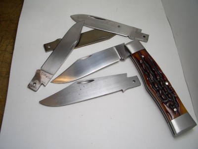

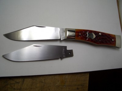

I am not a pro knifemaker, just a hobbiest. This is how I do it.FOG wrote:That press is a good idea. Please post some pics id love to see them, and if you can some of the press and the die as well. Thanks,Bryce
This photo is some nail marks cut with various dremel type wheels. The one on the completed knife is good. The other four are failures and the blades were scrapped. This photo shows stamped marks. The blank blade is soft steel and shows how the stamp looks before clean up straight from the arbor press. the finished knife has had the mark deepened by hand and is ground, hardened and tempered (of course).

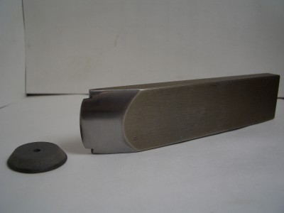

Here is the stamping die. Shop made by me from 1/4" O1 tool steel hardened and tempered to a staw color. Pretty simple to make with the grinder and hand files. One side straight the other a curved tapered radius. The little wheel is what I use to refine the mark after stamping. A 7/8" x 3/32" silicon carbide rubberized abrasive dressed down to a tapered radius. Here we have the press with the die stamp fixtured in place. The fixture is also shop made. The actual photo shows my tang stamp in the fixture but the nail mark die is done exactly the same way And since we are talking about shop made tooling I thought I would throw in a photo of this bench block steady. Made with the grinder and files, 3/4" thk x 3" wide x 5" 4140 Cr moly. Very resistant to dings and marring. I set my rivets and punch pins with it laying flat on the bench. When I need to work off the front I chock it up in the jaws of a horizontal viseFOG wrote:That press is a good idea. Please post some pics id love to see them, and if you can some of the press and the die as well. Thanks,Bryce

Pretty cool tool pictures and step by step instructions 2 speed. Thanks.

2 speed,
That is cool. I've never seen nor even thought about cutting nail nicks with a press.
I do have one question. Is there any deforming of the blade when it's pressed? Does the blade stay good and flat and maintain it's shape?
I will definitely have to try this someday. Looks a whole lot easier than trying to cut nailnicks any other way.

km 3, you are absolutely correct. Stamping the blade that close to the top displaces the metal and leaves a bump on the spine. Found that out the hard way. The way I get around it is;
scribe the layout leaving about 1/4" between the top of the pattern and the edge of the barstock and drill my hole in the tang.
stamp the nail mark.
profile the blank then surface grind.
Works out pretty good as you can see. A 1 ton press would work alot better but the 1/2 ton does a respectable job.
