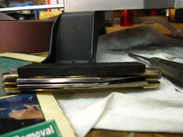

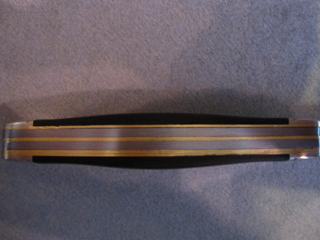

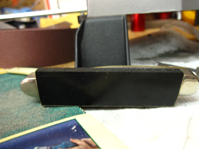

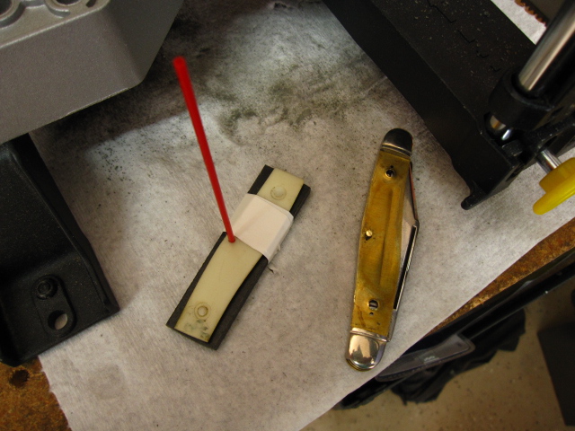

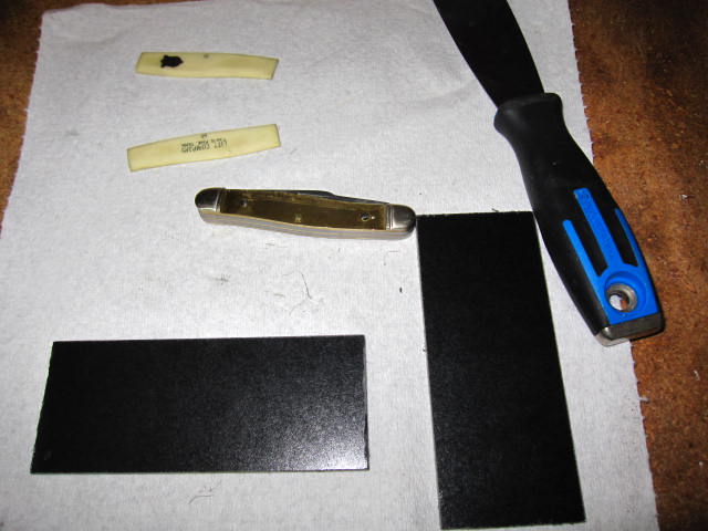

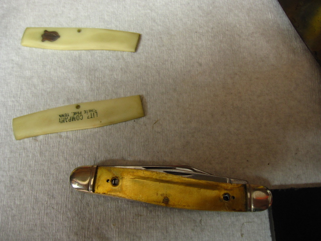

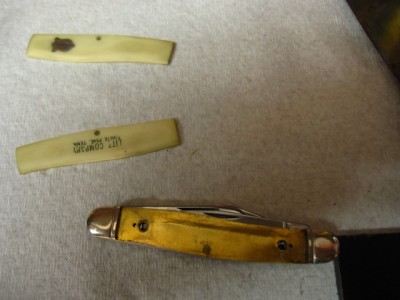

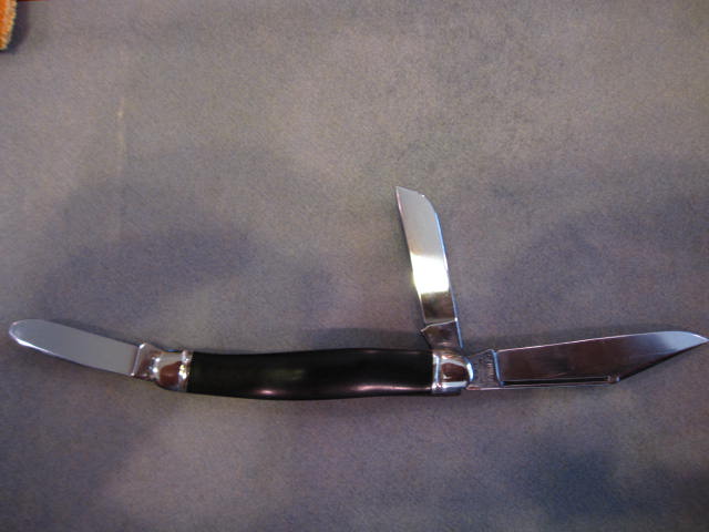

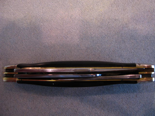

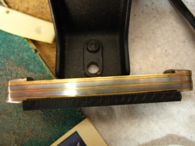

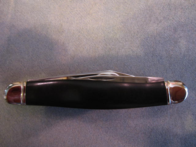

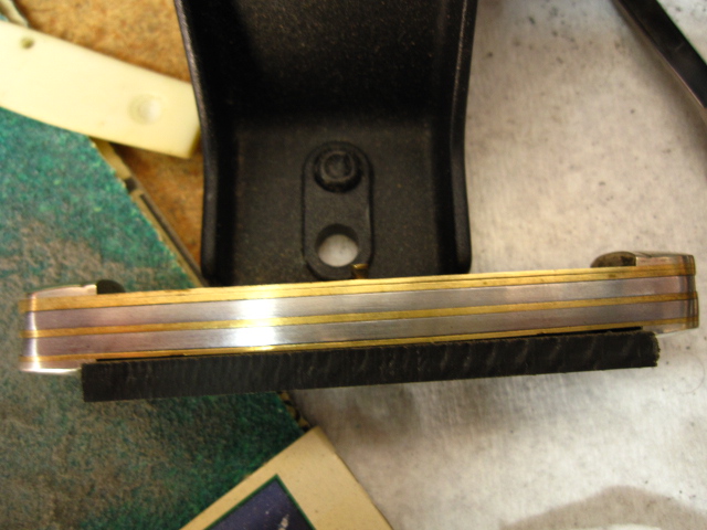

Hi, I just finished my first re-handle job on a stockman. I used black paper micarta for the job. Here are some pictures of my attempt to work on a knife. I have never tried anything like this before. I really liked it and I plan to do more knives.

Looks good Kurt. ::tu::
Did you use a hidden pin for the rocker pin?

Nice work. I like the looks of that black handle against the silver colored bolsters without the pins showing. ::tu::

I used the back spring pin with a hole tapped into the back of the micarta scale and adhesive. Thanks for the positive comments, Philco and Orvet. I thought the micarta would be more glossy than it ended up. I sanded and sanded from 220 grit progressively to 2000 grit and buffed it with polishing compound and finished with carnuba wax. It shines but not as much as I had hoped for. I am going to give the knife to my Brother as a thank you gift.

kurt6652 wrote:I thought the micarta would be more glossy than it ended up. I sanded and sanded from 220 grit progressively to 2000 grit and buffed it with polishing compound and finished with carnuba wax. It shines but not as much as I had hoped for.
Kurt,
Is the micarta, paper micarta? If not it won't shine.
Assuming it is paper micarta, I would suggest you go back through your grits & sand again.
You have to be dead certain that there are absolutely no scratches on the micarta from the 220 grit when you change from 320 to 400 grit.
