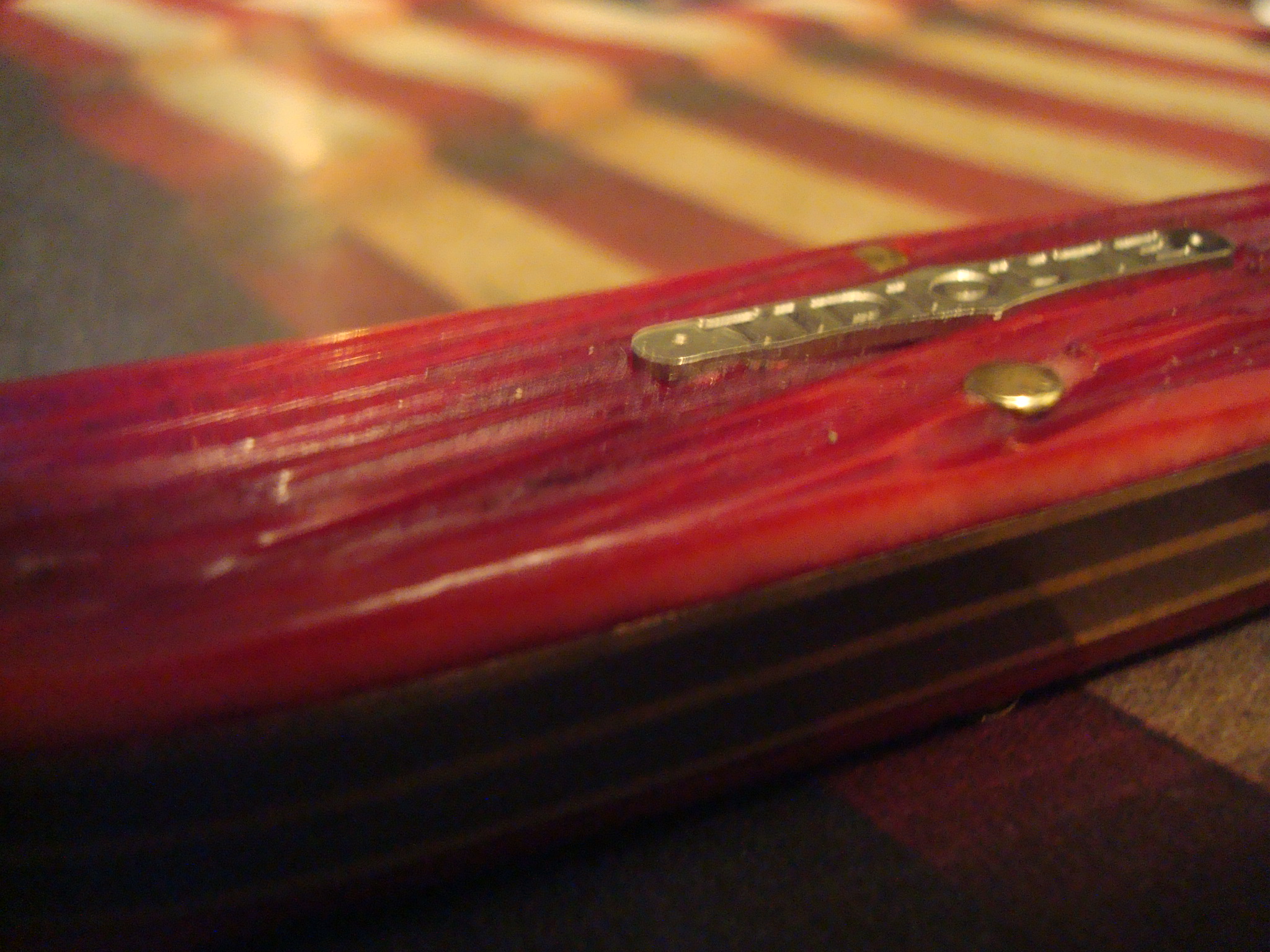

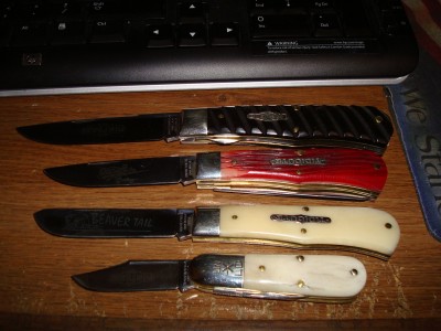

Wow, I just found Great Eastern Cutlery and went bananas. I bought five knives. So far I’ve received four. Two are wonderful and the other two are really disappointing. The black Buffalo bone NORTHFIELD UN X LD #25, and white bone Beaver Tail TIDIOUTE #24 are great examples of the craft.
The red diamond bone TIDIOUTE two blade #127 and white bone Barlow NORTHFIELD UN X LD #32 have problems I can not believe got by the people who I thought hand build them. First the red knife has a sharp edged name plate that is raised well above the surface of the handle and nor even evenly. One end is higher than the other and is just waiting to get snagged and pop off or do damage to a sheath or pocket. The center rivet along the spine on the opposite side from the name plate side has a sharp edge sticking above the radiused edge of the scale.
On the Barlow the center rivet along the spine is not set all the way down to the scales and have catching edges. On the side with the small blade, the center rivet where the blade swings out is set below the surface of the scale and it appears the bone was depressed or chipped off to one side of the rivet and it is cracked on each side of the rivet. I have many Barlows from Boker, Russell, Bulldog, and a Watson white horn Damascus and too many other slip joints to count. I have not encountered this kind of problem before.
I could not find any warranty info on the Great Eastern web site. Should I Contact the manufacture or the places I purchased form. I have already used and sharpened them, so I am looking for repair not replacements.
Has anyone had a similar issue with this brand of knife? ::shrug::

1) Inspect the knife when you get it in; because once you sharpen / modify it you complicate any return process. But most dealers will pay for you to send the knife back to the factory and work with them to insure your concerns are taken care of.
2) Your pin problems seem opposite ends of the spectrum. One you don't like because they spun it down in the bone; the other you don't like because they didn't spin it down into the bone. If they spin into the bone there will be a circle (and possible chipping) that many times cannot be buffed out. If they do not spin into the bone, it's cap will be extended a little above the bone. Spinning all the way down is very difficult on smooth bone. Spinning into jigged bone without chipping is hard as well. Thus before you send them back you might want to tell them if you want them spun into the bone or not. On the red bone it looks like the backspring pin had to go right into a bone ridge, just bad luck during assembly. On the primitive bone, it should have been spun a little more snug; but they may have been gun-shy on hitting that smooth bone.
Most sellers will inspect knives as they are packing them for shipment, but knives are made by humans and most times not completely perfect. Great Eastern knives are unique in that you can see the human in every one of them; if these issues you are seeing bother you, then 100% out of the box satisfaction is probably not going to be achievable. But, your dealer wants you to be happy and Great Eastern Cutlery wants you to be happy; so just keep pounding into the factories head what is and is not satisfactory to you. You will be doing us dealers a service as well as the end customer. Most every dealer looks at the knives before shipping; and if you look there will be a thread about one slipping by most all of them. What matters is how it is resolved. The only way to insure you are getting the knife perfect for you is to go to a gunshow and pay 50% too much for it.
If those knives were still as you received them, you could send them back to the dealer and the next 15 customers he sent them to would be tickled with them. But this hobby is about making sure every person gets what they want....
Long story short: If you are not happy, decide what work they need done to them and send them to the factory with a detailed note. This will help them understand their customer base expectations. Most times if a dealer sends them back, they just figure they have an anal dealer as opposed to real world customers. Send your dealer a note and they will probably agree to pay shipping for you.

prompted further discussion. But the answer is "yes". Mis-spun pins, pertruding/crooked shields, and bone finishing seem to be the more common issues with GEC products; as the more blatant defects (slab cracks / jigging faults, metal imperfections, etc) almost never leave GEC's floor. [Disclaimer, so there is no confusion: Great Eastern releases fewer defects and resolves them faster than any other company I have ever dealt with].
