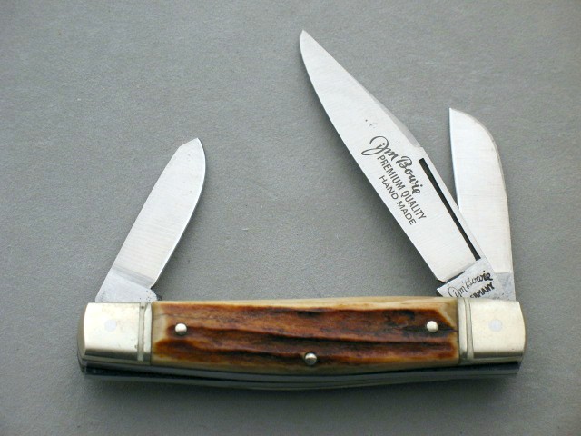

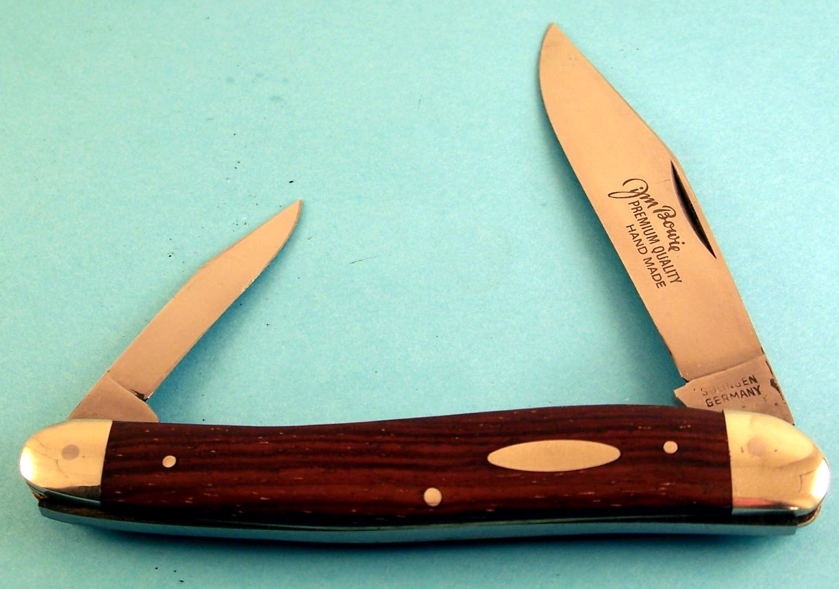

Just got this DANDY Jim Bowie in the mail from Paladin. Thanks Ray, this is now one of my favs

My EYE caught this knife also from Ray's store, and ordered one....hope you didn't get the last one MM.

Recant...checked my mail and mine is on its way....thanks Ray

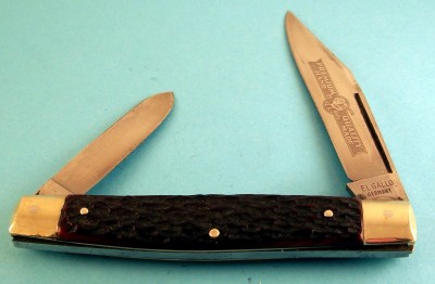

Here is my only El Gallo

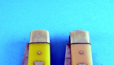

That looks like one that was assembled from parts "after the fact". Another way I've noted to identify an original vintage eye is the steel pivot pins. They used them for strength, newer eyes or ones that have been assembled from parts later on will almost always have nickel pivots, here is an example picture of a vintage 3 eye (left) and a late 80's model (right) trappers. From my observations it would seem they discontinued the use of steel pivot pins sometime in the mid-late 80's. The steel pivot is especially noticeable on knives that are kept shined and do not have tarnish on the bolsters, or if the bolster was a little over buffed at the factory the pivot will be sticking a little higher than the rest of the bolster becuase it buffs different becuase of the different hardness. Also note that jigged black bone and yellow comp/cell was used exclusively on carbon steel knives, most "rustless" or "surgical" knives had jigged brown bone handles, if it has something else there is a chance it is not 100% correct and vintage. This is just for the most common of things, eye is kinda like schrade "anything is possible" there are all kinds of variations floating around out there.

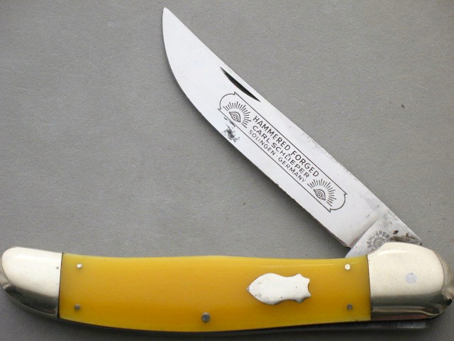

Paladin WOW.
Your Yellow knives are making my mouth water so bad it is dripping in my keyboard.............

Re: Other Lines of Cutlery Produced by Carl Schlieper
Ken,
I was hoping you would find those.
You better jump on 3 or 4 of them. They are hard to resist, like a red-headed woman!!
Ray
Ray
