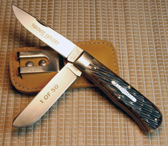

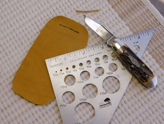

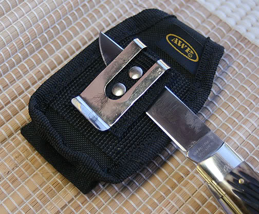

Need to make a pocket clip like the smaller one pictured for my larger knives like the Great Eastern #23.
I purchased this cheap cell phone case at Lowes for the clip. Different style clips are available through other sources.
Cut the clip off the case.
Drill the rivets out.

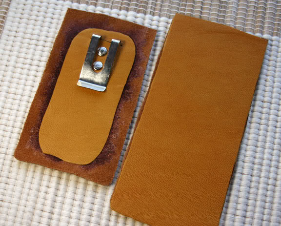

Cut a piece soft leather to fit your knife. I purchased mine at Michael's Arts and Crafts.
Cut a slit for the clip.

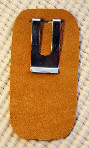

Insert the clip.
Punch holes for the rivets.
Rivet the clip to the leather with a Tandy Rivet Kit (purchased mine at Michael's) and a hammer.

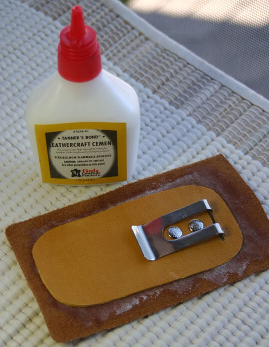

Glue a 2nd piece of leather to first piece(with clip) with leather adhesive(Rough sides together). Spread the glue evenly with a small paintbrush.
Allow the glue to dry with the whole assembly pressed in a book. I put the book under a table leg so it stays really flat. Wrap in waxed paper, so any excess glue doesn't stick to the book.

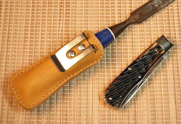

Punch holes in the leather using an awl and a hammer or mallet. Mine is a sculpting tool that was modified on a grinder. Space the holes evenly for a nice look.
Use a Tandy(or similar) leather stitching awl and waxed thread to attach both sides. The thread comes in lots of different colors. Follow the directions that come with the awl for best results.
Stretch the case to shape if necessary.
Finished sheaths.
Sheath in my pocket.

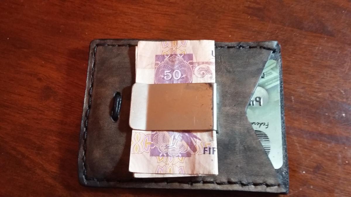

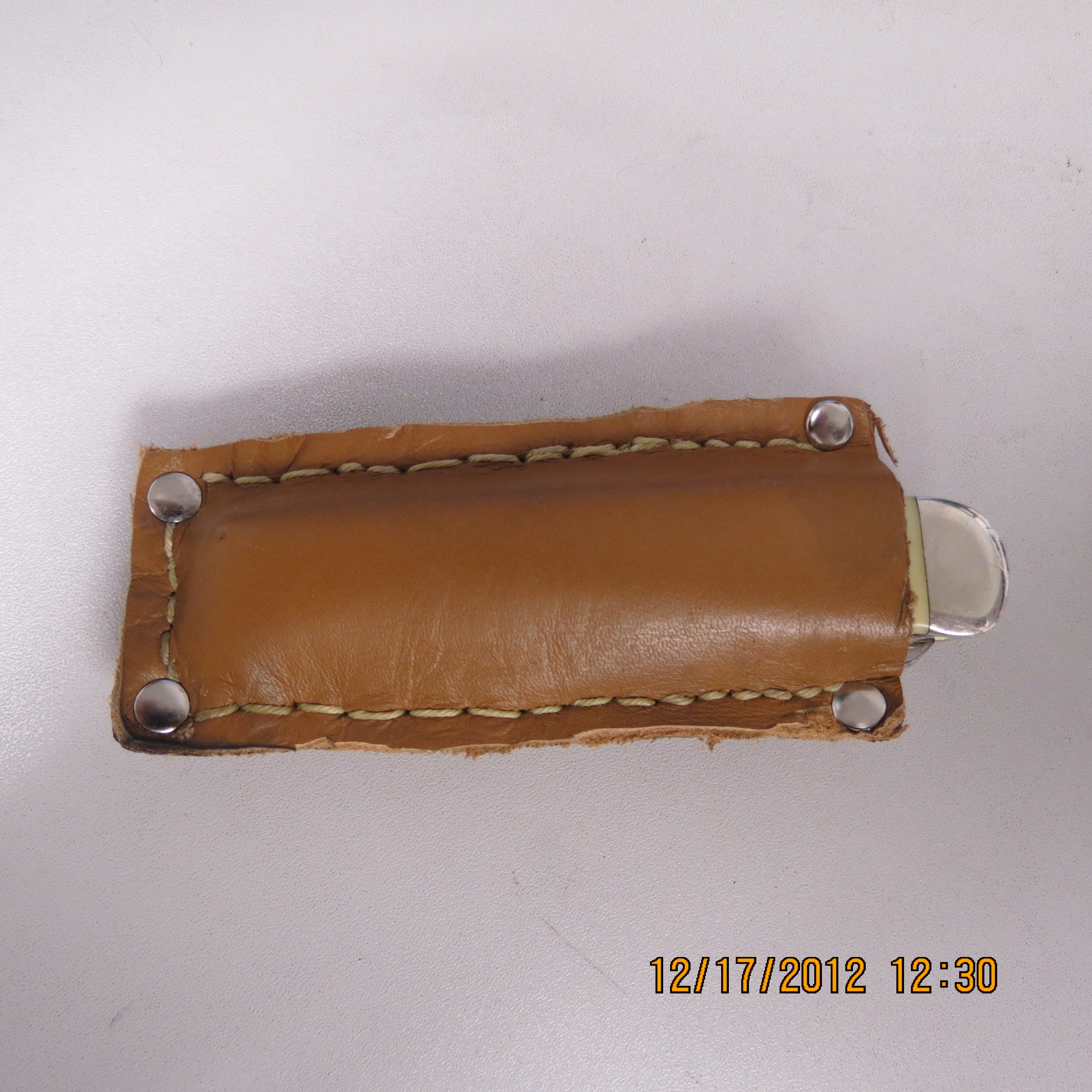

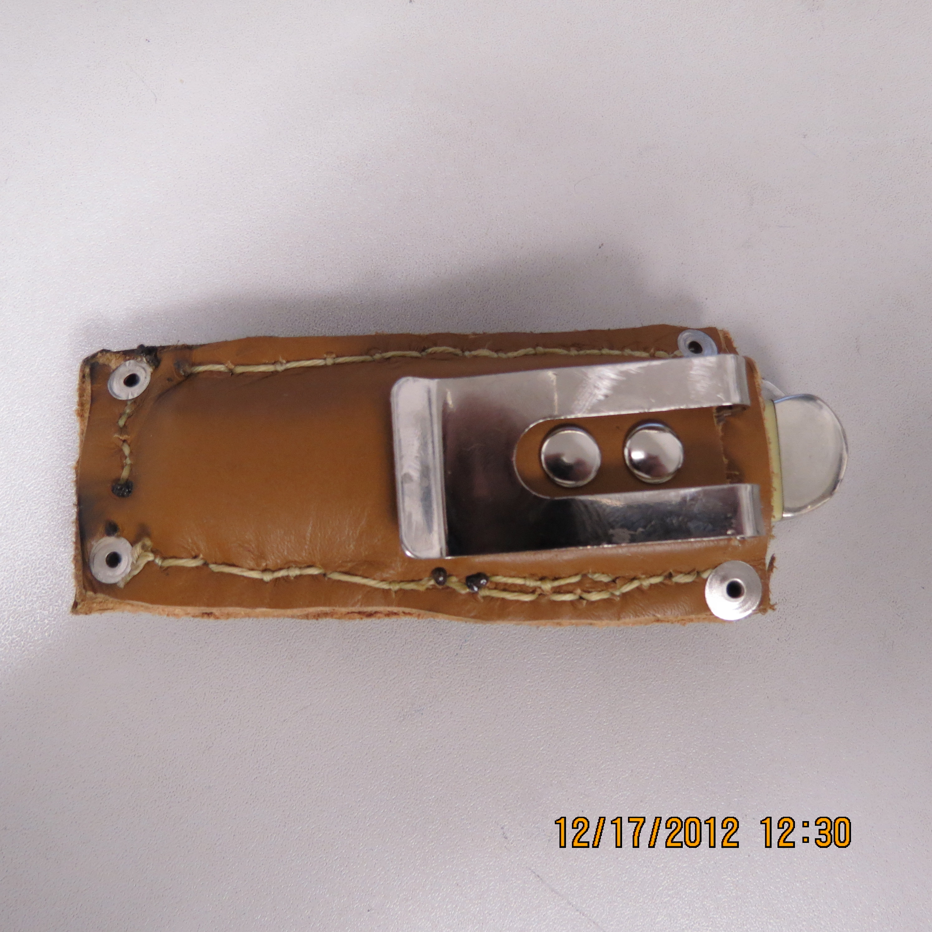

I took a shot at making one of these this weekend for my Case Trapper. I attached pictures of the results. It came out kind of rough but it does work. I got the clip from a cheap phone case. Tandy Leather sells pocket clips as well and I might order one for my next case.
The biggest problem I had was getting the rivets straight. Also, as you can probably tell, I am NOT a tailor. And yes, I realize that one of the rivet backs on the opening end is larger than the other. I ran out of rivets (like I said - I was having problems).
If I make another one I will probably fold over the leather so that the fold is at the top, for a cleaner appearance.

Looks like a pretty good first try to me. ::tu:: Perfection comes with practice

Re-reading the tutorial I think I see part of where I goofed. I should have pre-punched the holes for the stitching before doing the actual sewing. That would have resulted in more even stitching.
I also probably should invest in a real punch for the rivet holes.

Update - I added a piece of heat-shrink tubing to the clip to prevent it from scratching stuff I bump into. I have some more clips on order from Tandy leather that might be better suited but we'll see when they arrive.
On the next try I may attempt to cover the clip in leather. I'm thinking about how I would do that
I also learned that a pouch for a delrin-handled Trapper will not fit a bone-handled trapper since the handle is wider. It would probably work but would most likely stretch the leather out to the point it would not securely hold the delrin-handed trapper.

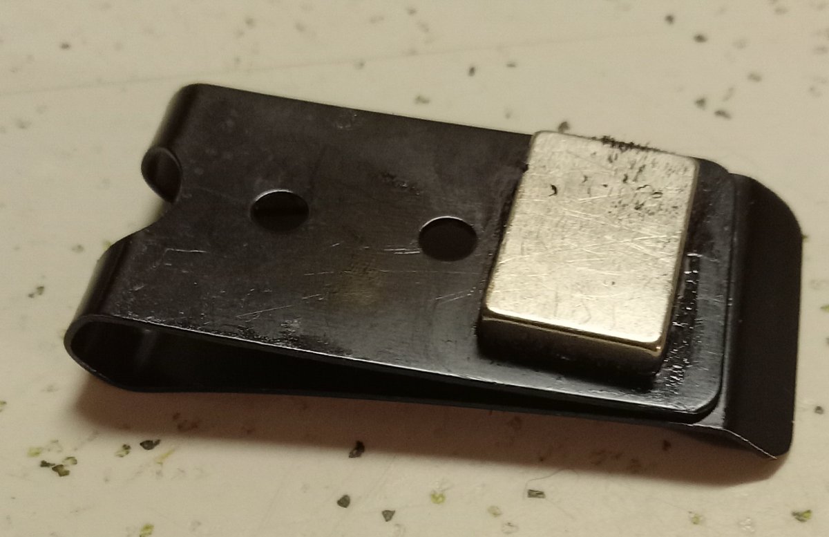

I skipped the leather and just glued a magnet on the clip. It will hold anything.
