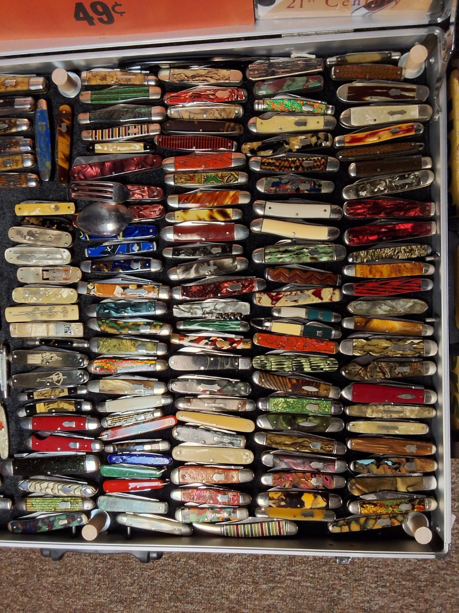

- edge213
- Posts: 8464
Re: Celluloid knife handles.
I'm not afraid of celluloid!
Just some of mine.
Just some of mine.

- edge213
- Posts: 8464
Thanks Bill and Joe
- Mumbleypeg
- Posts: 15700
- Location: Republic of Texas
I like it! I never let mine associate with each other though.

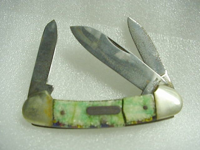

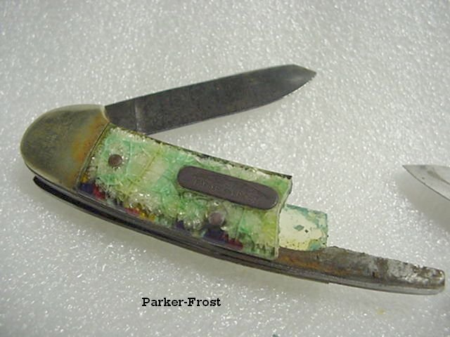

- Miller Bro's
- Posts: 13631
- Location: Earth
Warning, the pictures below may be disturbing to some viewers.
- Attachments
- 1000002624.jpg (54.09 KiB) Viewed 653 times
- 1000002623.jpg (44.6 KiB) Viewed 653 times
