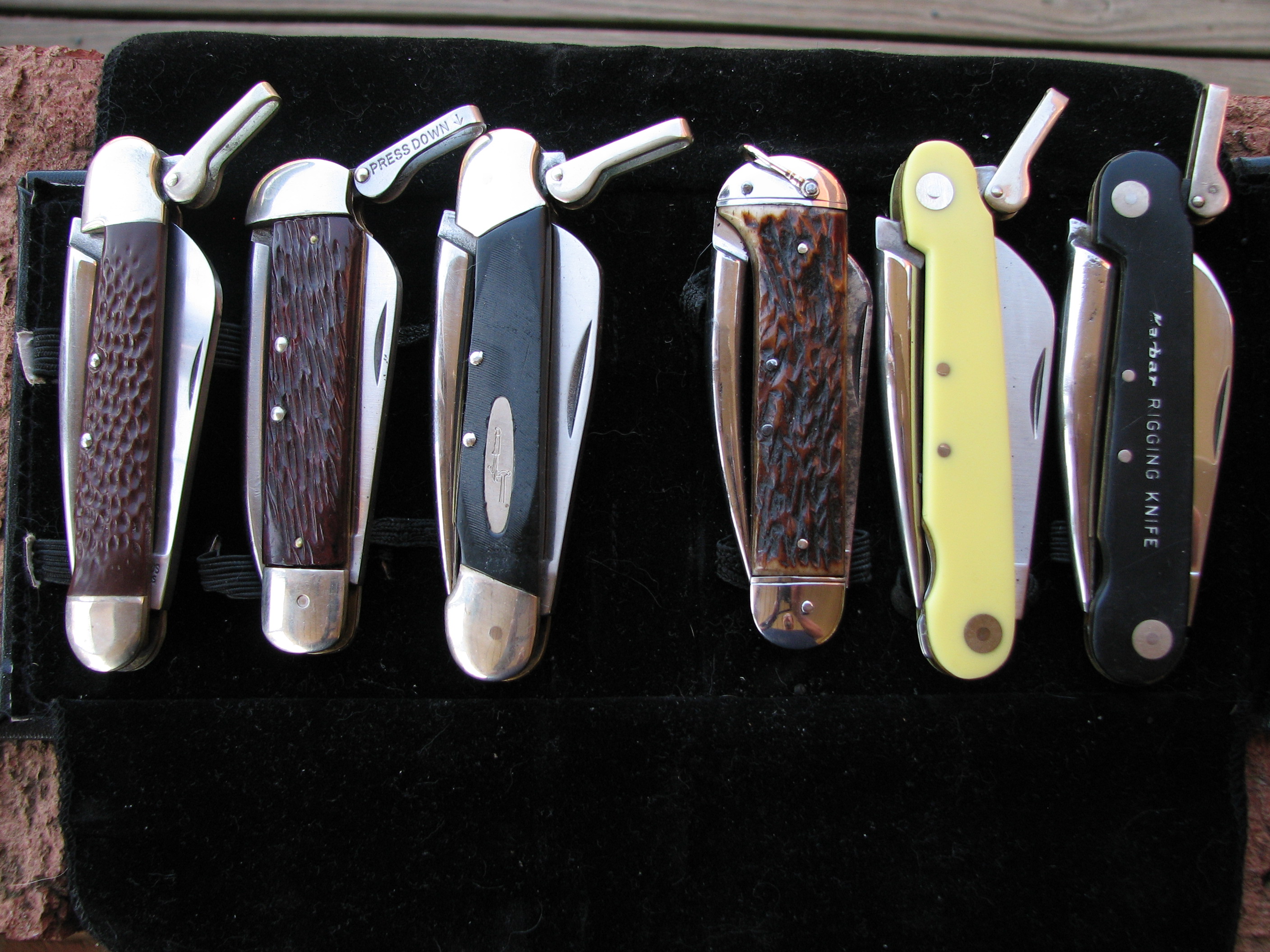

Here is my small collection of Marlin Spikes. All of them but one have the locking mechanism for the spike and all the locks are quite strong when the spike is snapped open. The locking mechanism does not lock the blade open on any of these knives.
They are left to right, Camillus, Schrade Walden, Buck, Yax (non locking one), Case, and Kabar.

Nice ones Phil!

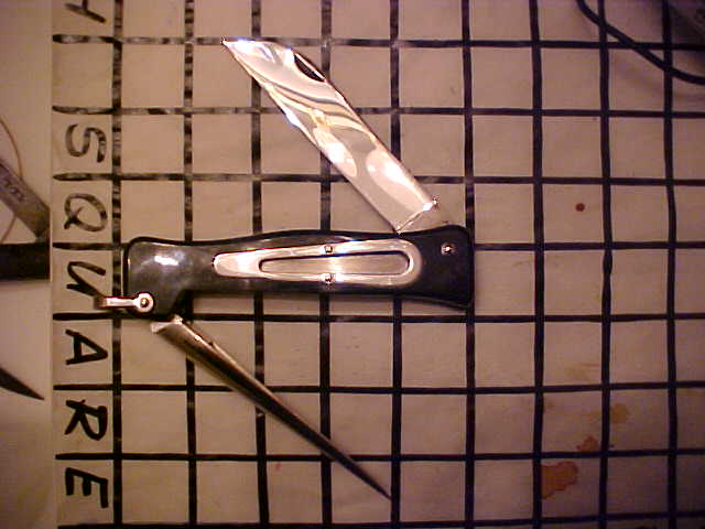

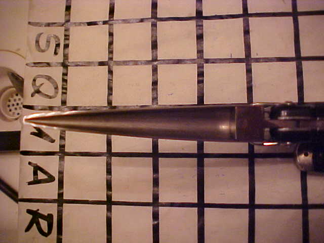

I went back through my rigger's knives to check and found that ALMOST all of them have a locking marlinspike.The exceptions are:
The Schrade 735 does lock but the lower priced Bosun's Mate(steel scales)does not.All of the military issue sailor's knives have non-locking marlinspikes.A curiosity is one very high end French made(J.Mongin)knife that has an unusual hollow marlinspike(a curved piece of metal)and polished horn scales does not lock either.

Knife nut - that is probably one of the coolest French knives I have seen!

The grooved spike on the french rigger is call a Splicing or Swedish fid.
Allows the strand to slide along the groove when splicing into three strand line. Many sailors knives sheaths have a place for a separate marlinspike, which I find most pro riggers and others who indulge in fancy knot work prefer. The locking bail is often secured to a laynard. My experience with Rough Rider riggers is that the marlinespike breaks when working with them.

Thank you for the info cusprider;it is greatly appreciated.I learned something today.cusprider wrote:The grooved spike on the french rigger is call a Splicing or Swedish fid.Allows the strand to slide along the groove when splicing into three strand line.
