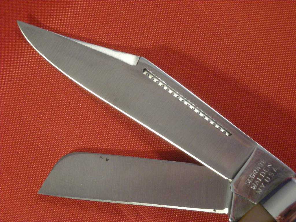

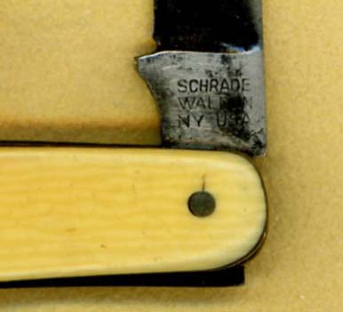

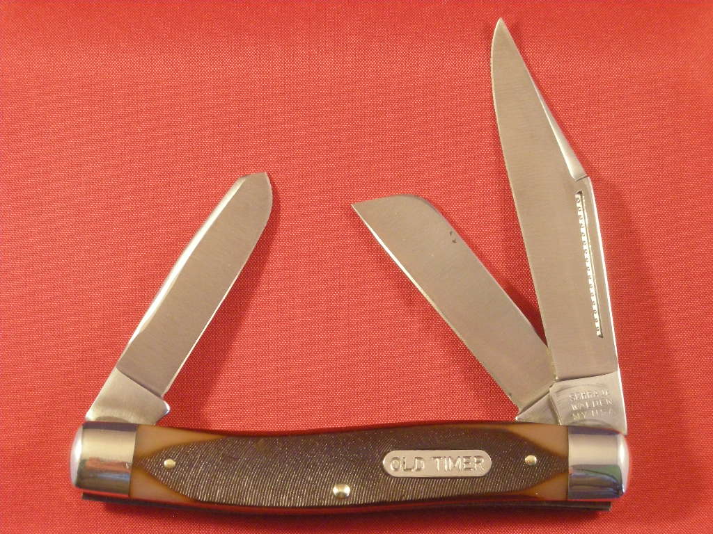

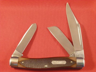

This is the first early Schrade Walden 8OT I've had in my hands. The clip blade is stamped Schrade over Walden over NY USA on the front. It is not stamped 8OT on the back. The long pull and swedge are diffrent from anything I've seen. The knife dose not look to have ever been apart or cleaned.
My question is, dose the knife look right to you?
Thanks,
Keith

ozzie
I thought that Schrade Waldens always had dots between the initials of N.Y. and U.S.A.
I went back to all the schrade Waldens I own and they all have them.
Dont know for sure tho.

Keith:
That blade is really more like a Camillus blade than a Schrade, but as we know, there were shared parts from time to time. If you see some Sears Craftsman knives built on a Schrade 80 frame, you will see that particular blade, and sometimes on an Ulster too. As far as the pattern not being on the back side, I do not think it is necessarily related, but it might be. Sometimes it was just left off. I have several 8OT's marked Schrade Walden, as well as other knives built off of the same frame with different handle material:
I believe in the 1960's, when they were making the Schrade Walden version of the 8OT, each blade got finished by hand, and a slight variance in grinds is apparent. Generally the swedge on an 8OT went back above the nail nick, on the spine where it flattened out. It is not apparent in my picture on each knife. On yours, and on my examples below, that swedge is like cookie cutter identical.
My examples where the blade is shaped like that, it stops at the same spot each time. Right where the spine changes direction.
I see examples from time to time where Schrade, Ulster, Imperial, Camillus, and Craftsman knives have inter mingling of parts.
To echo Gino, I have not looked at all of my Schrade Walden's, but I can say all so far have periods between N.Y. and U.S.A. I'm not sure what that means either. :?

Keith,

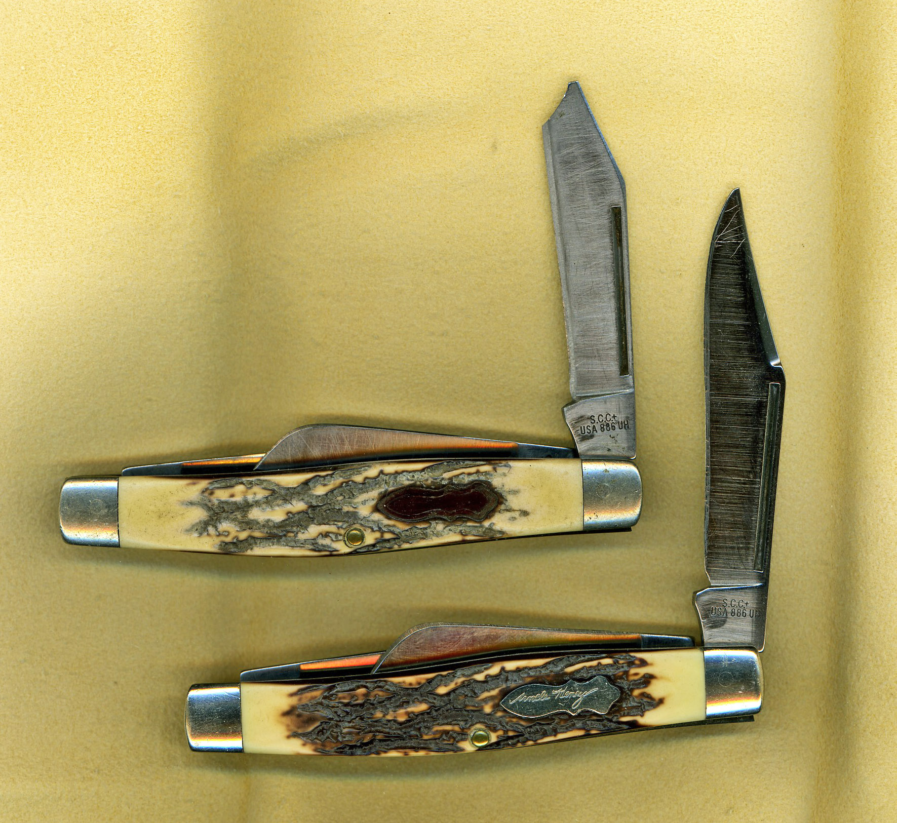

I would like to borrow your picture for some research I am doing on Schrade tang stamps. That is the first I am aware of with the missing periods after the N & Y.
I am inclined to think Hal is on to something when he mentioned Camillus.
The first pic I have here are two S.C.C.+ 886UHs, both made by Camillus. I have documented the S-cards on the knives with the S.C.C.+ stamp, and Tom Williams told me that the S.C.C.+ tang stamp is one that Camillus used for Schrade on a number of patterns. In addition I have copies of a purchase order for thousands of blades from Camillus for Schrade. IIRC the PO is for the 8OT, but I cannot find it at the moment. So we do know that Camillus made those type swedges.
So, I think Hal is right and Camillus may have made the blades. Notice that the two S.C.C.+ 886UHs both have that type of swedge cut on them.
But Schrade could have cut them as well.
In the second pic notice an Imperial and a Craftsman with that type of swedge. These appear to be made with the Swinden system. If that is true, they could only have been put together in the Schrade factory, as they were the only ones with the Swinden machine. Who knows where the blades were made, but they could have been made by Schrade, Camillus or even by Imperial.
These little mysteries keep Schrade collecting from getting boring!

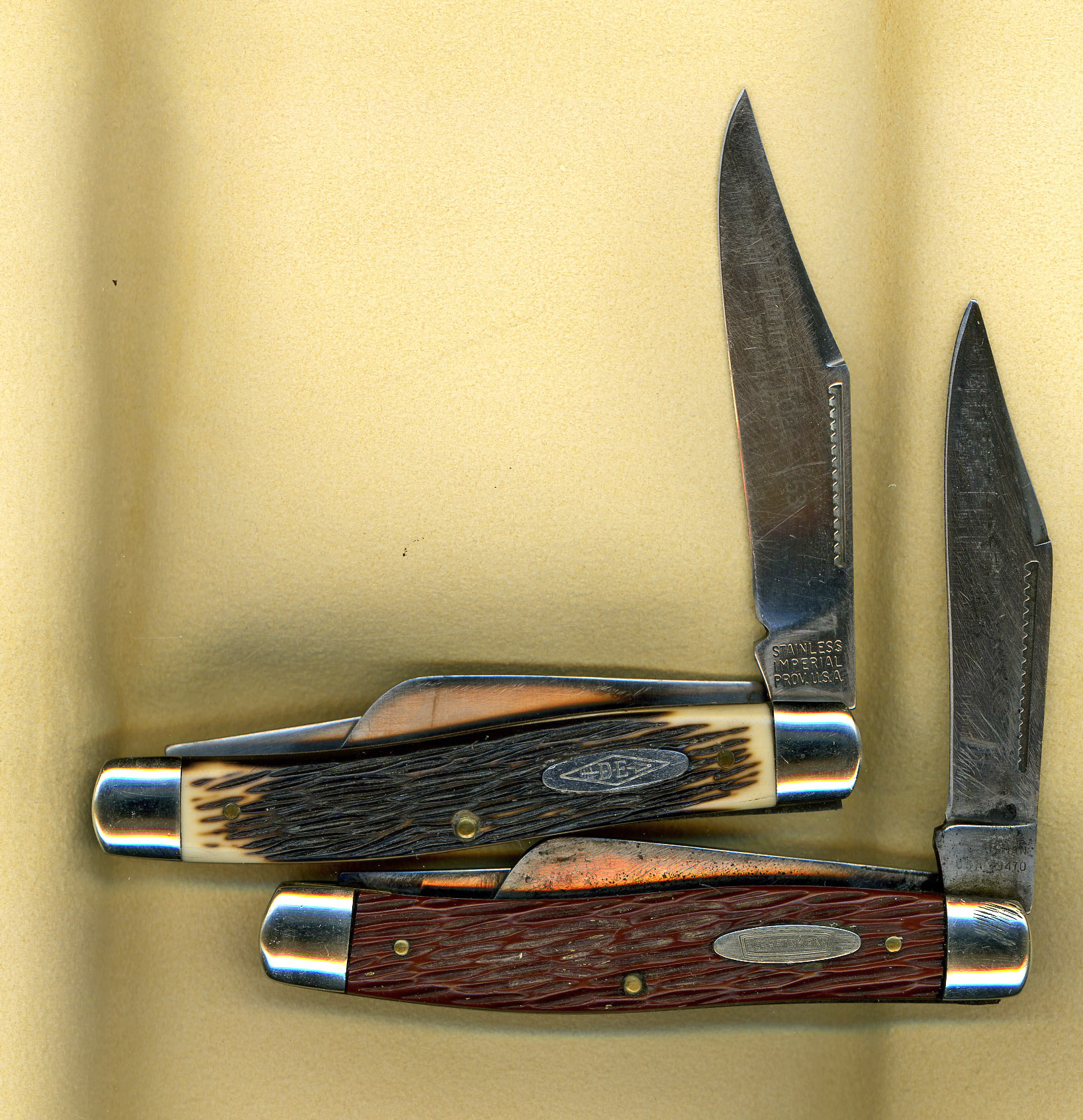

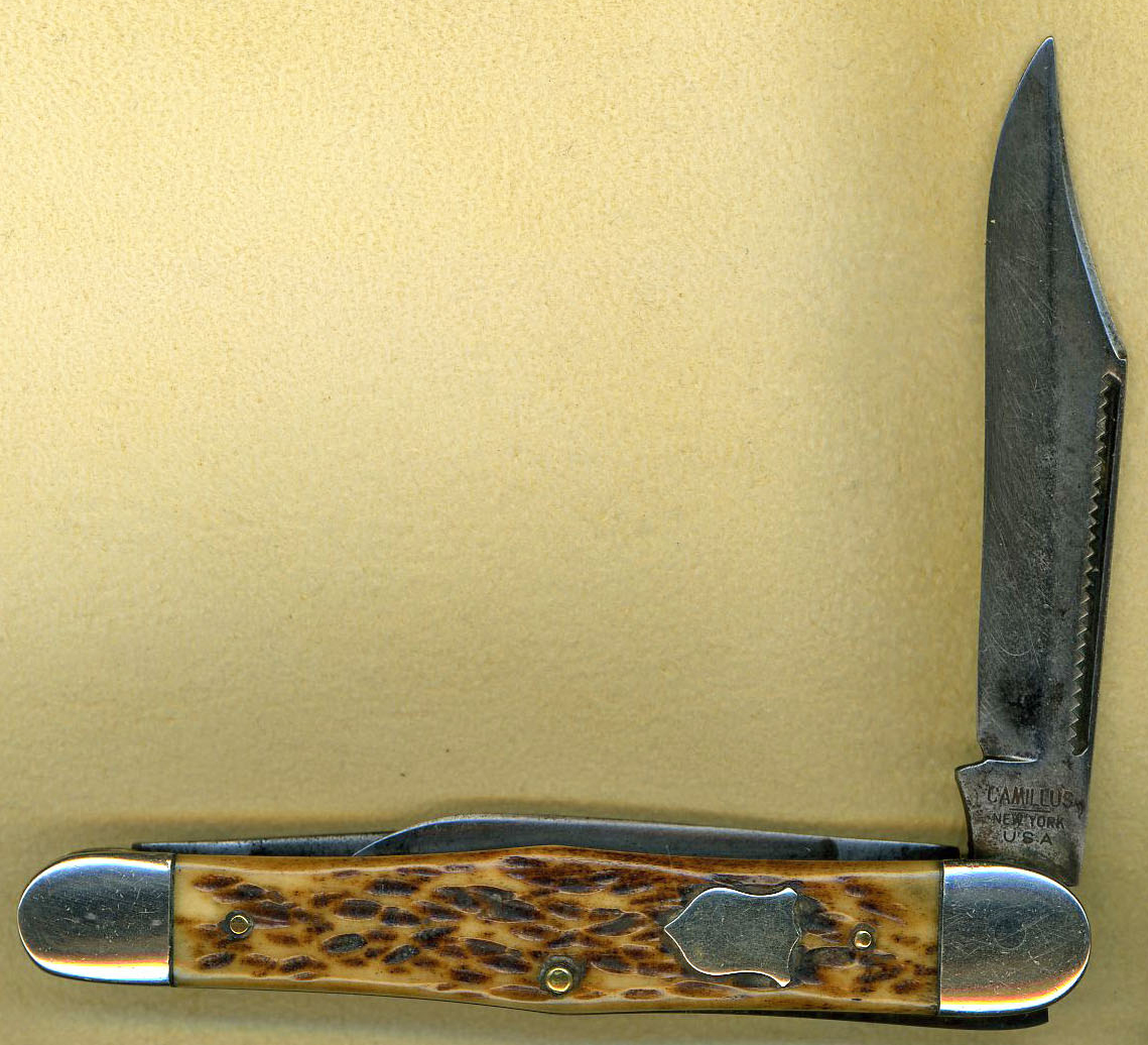

Just to keep things interesting, and exactly what I am referring to as far as interchangeable parts. Here is my 886UH, up next to a Schrade N.Y. 885UH. They both have the Schrade swedge, so I assume Schrade blade. The dude on the grinder did not finish the swedge along the spine above the pull, likely because the pull is too fat and close to the edge. The pulls on 885UH stock knives varied quite a bit too.
They are surrounded by a couple different version DE 353's. The stamps are different, and the shield is a touch different too.
Aimus, this DE series from the 1960's, unlike a lot of Imperials a real well made knife, and the blades are gorgeous. If there is a fault, the Delrin is a bit brittle and prone to pin cracks.
Hal

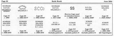

I was doing more research on Schrade tang stamps and going through some of the knives I have.
I found a Schrade Walden 196 that does not have the periods after the N & Y in N.Y.
Schrade 196 - tang stamp - no dots.jpg (31.13 KiB) Viewed 6172 times
The tang stamp is the same as the stamp on Keith's 8 OT in the first post of this thread.
Usually when I see a Schrade Walden tang stamp it has periods behind the NY and the USA.
Neither of these stamps have those periods.

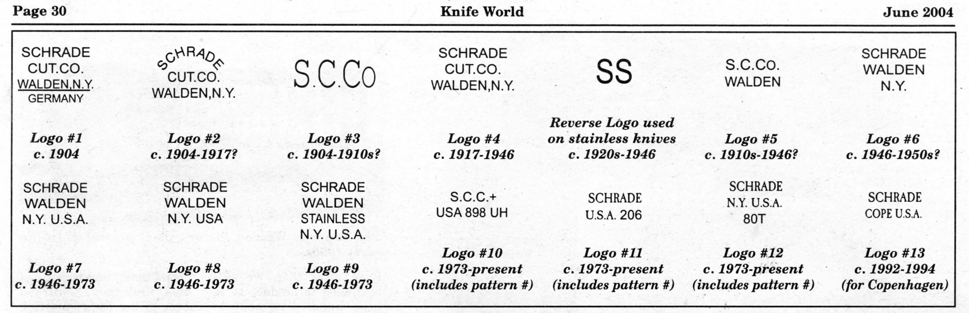

BK Brooks listed a stamp in his chart, published in Knife World, June 2004, that showed a similar stamp but with periods behind the N & Y and none in USA.
It is the second stamp from the left in the bottom row of his chart listed below.
As I have been researching I have found 3 or 4 stamps not listed on that chart.
It has become very interesting research!
As most of you know, no one loves a Schrade mystery more than I do! :mrgreen:

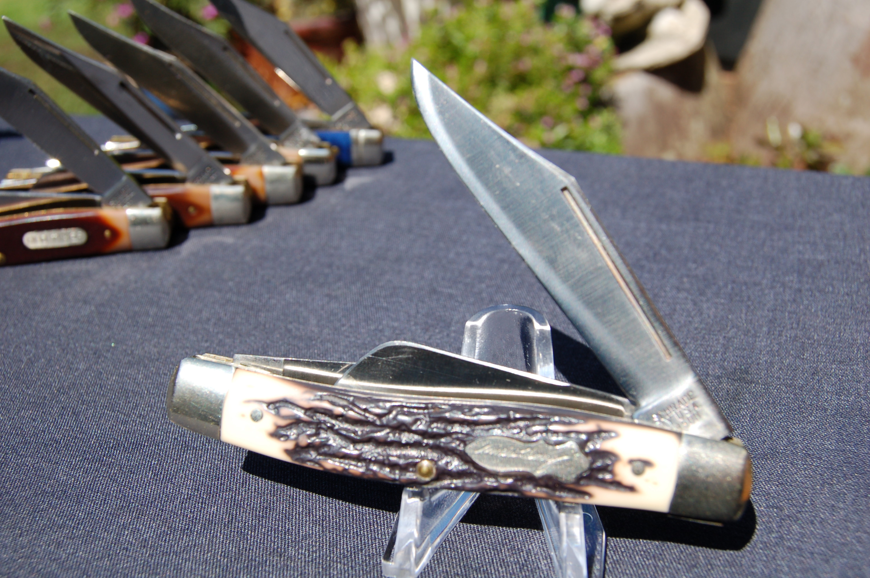

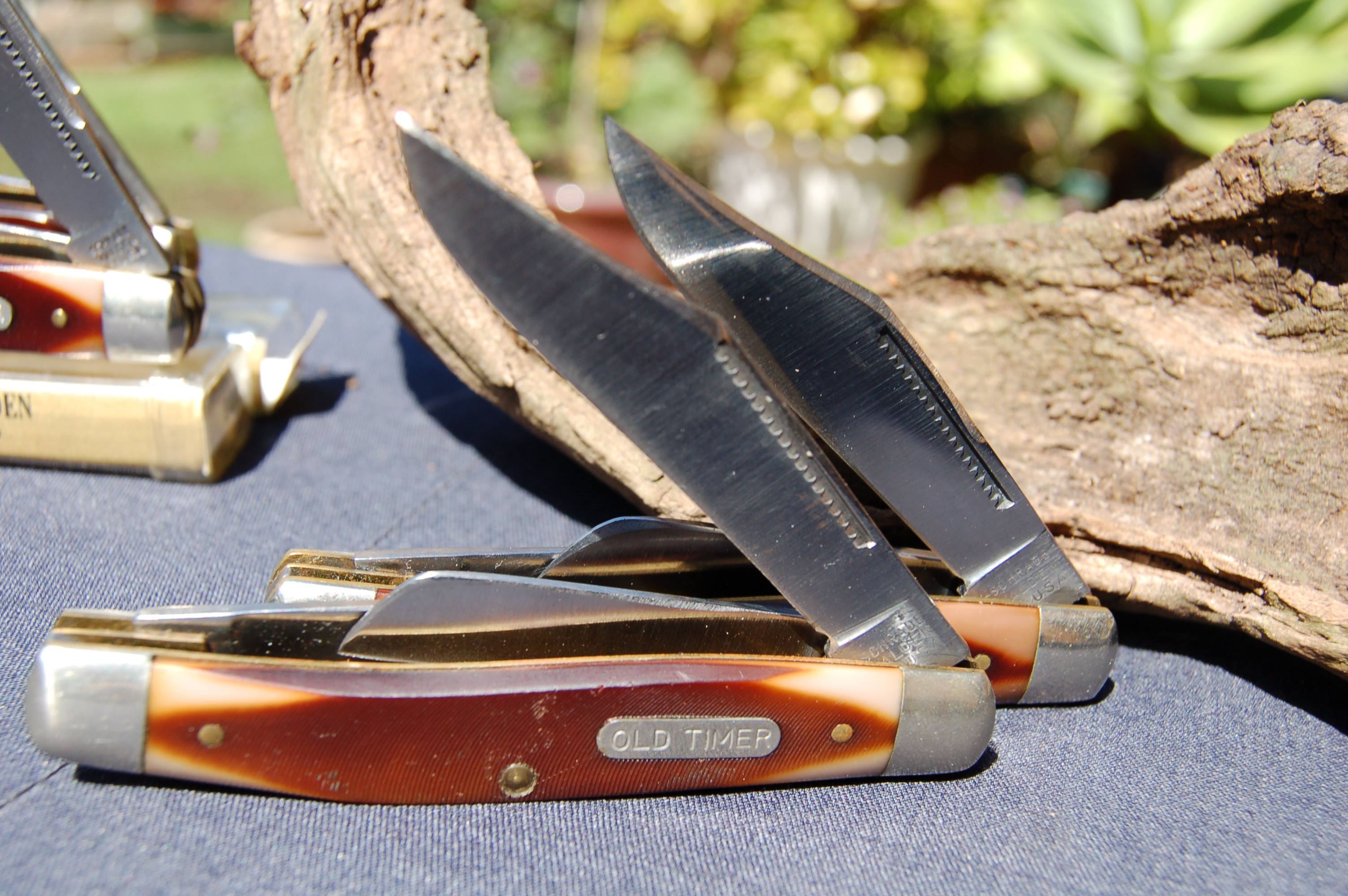

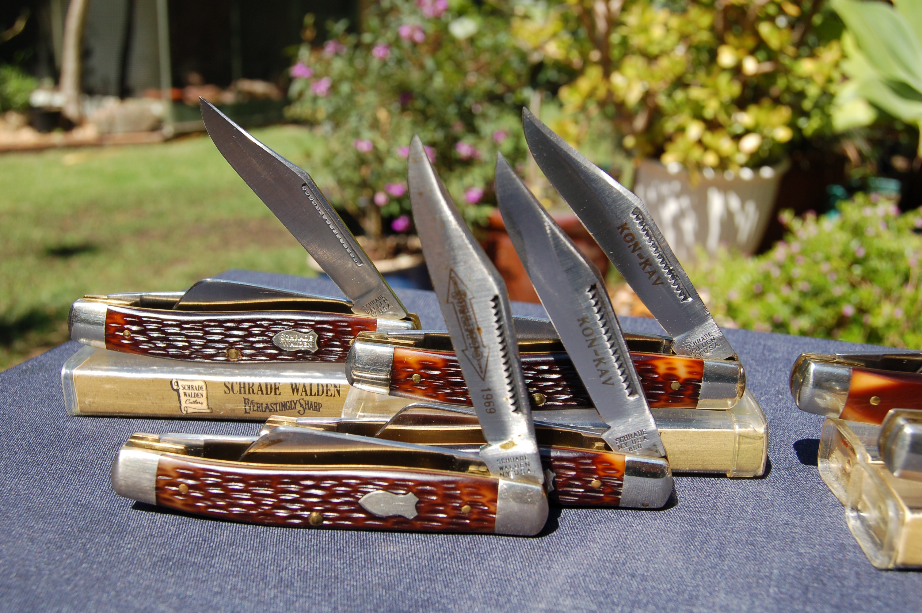

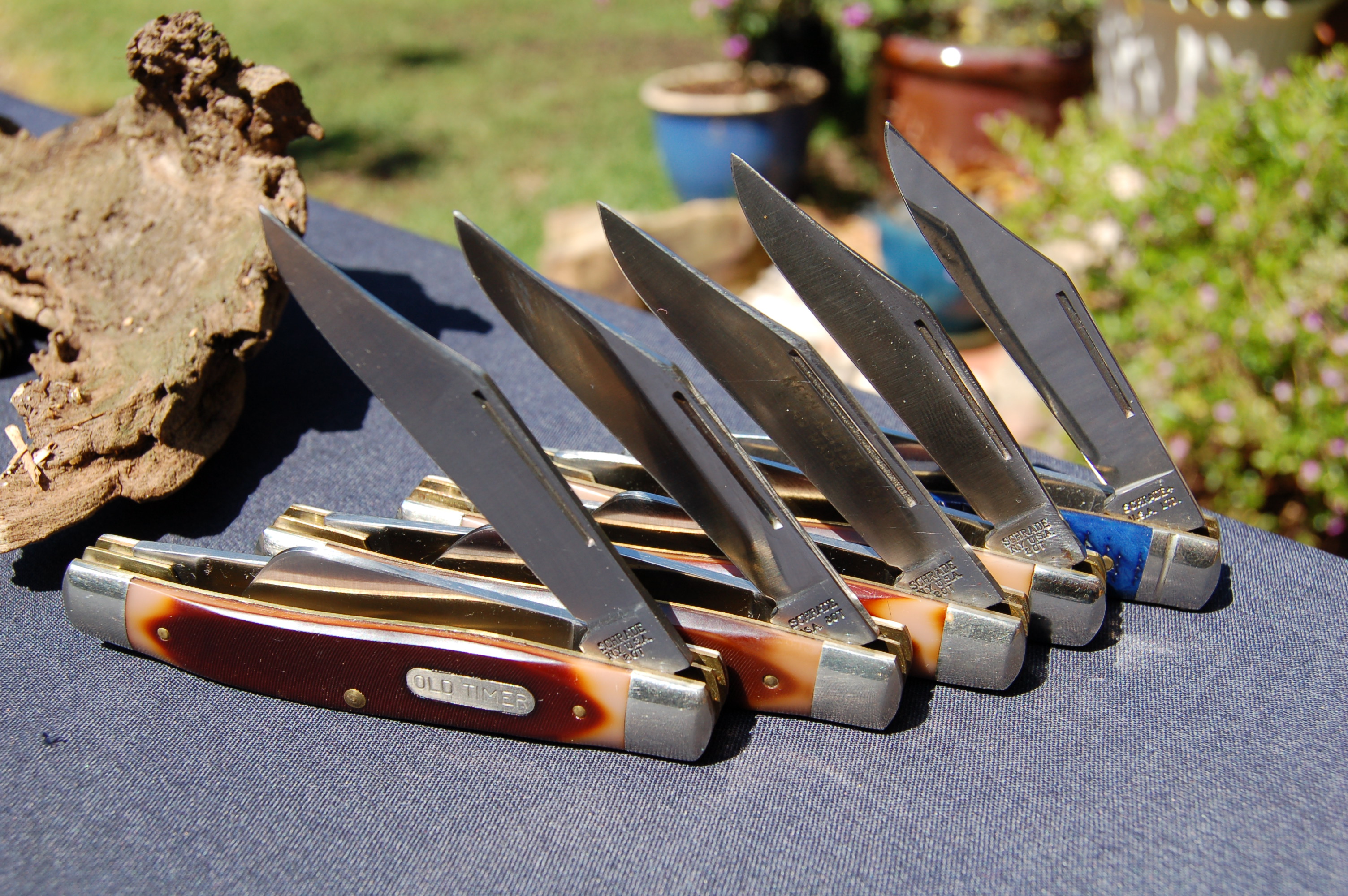

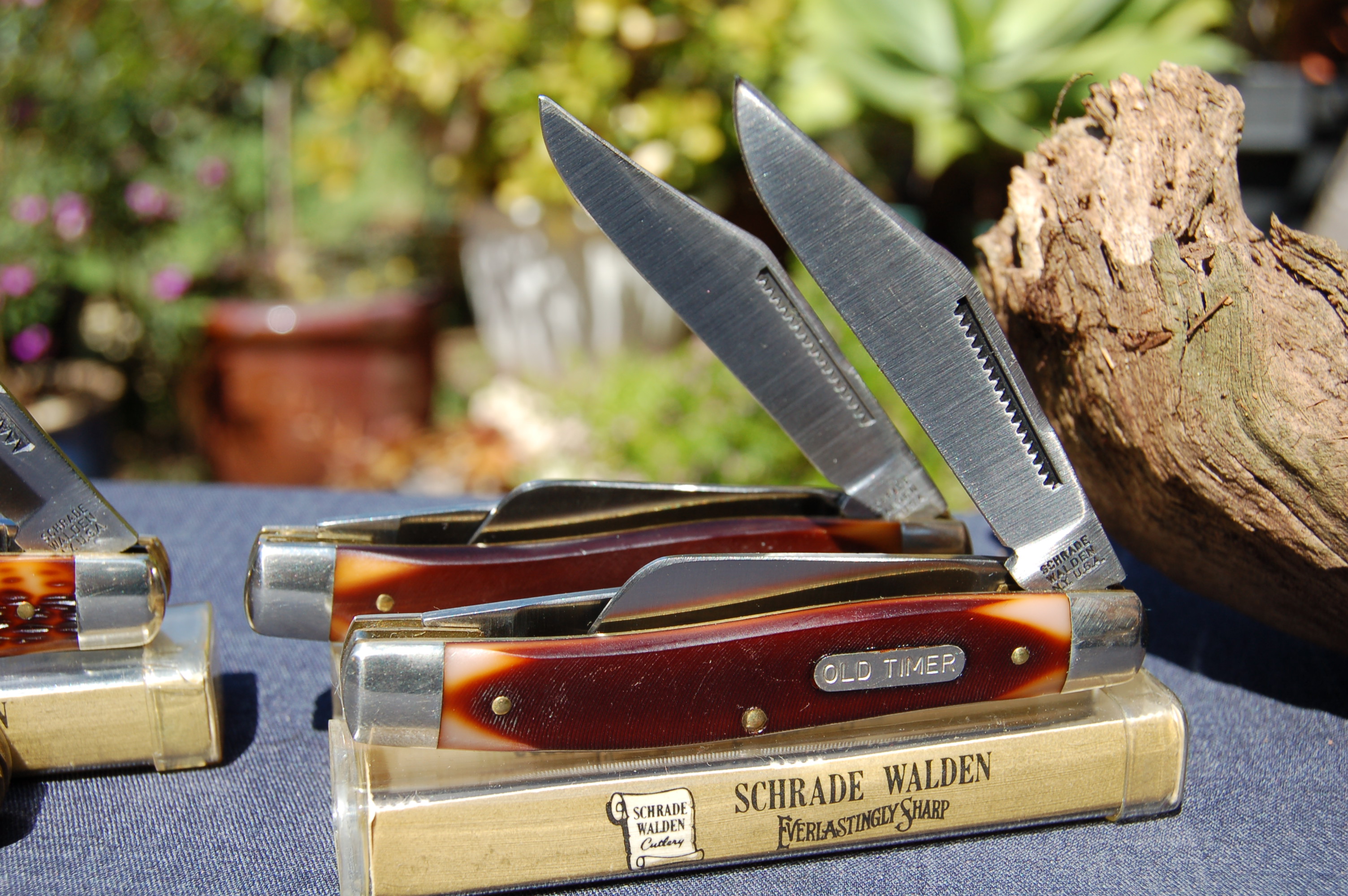

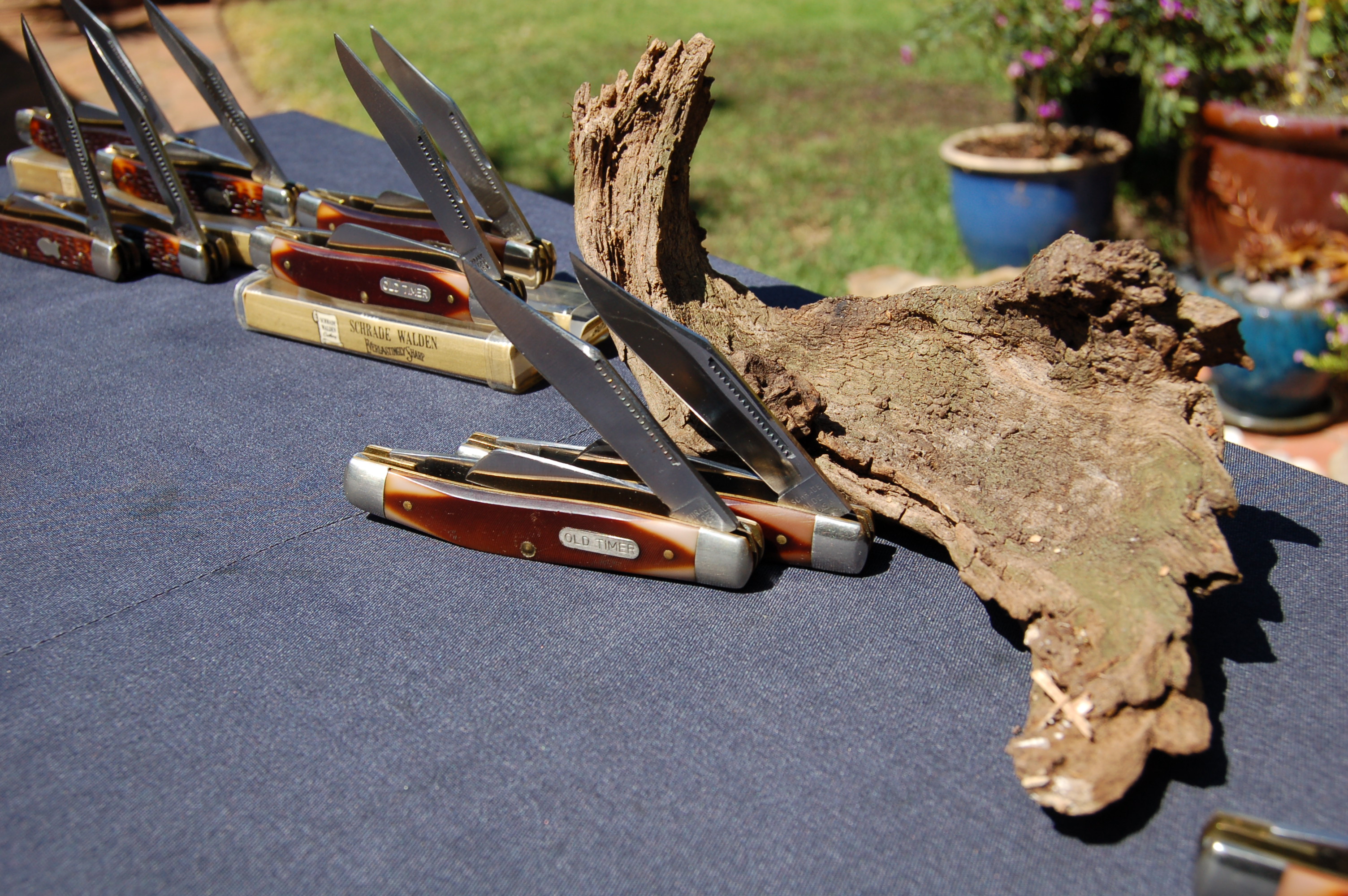

Hi from Australia,
I have pulled out some of my 4 inch knives. - Some of the Pre 1973 knives have very faint stamping.
As stated in earlyer posts - some Swedgers are fater then others, and close to the edge.
Most of my knives are NIB and have never been out of their packets until today.
All of the Walden knives are marked on the back side of the main blade with a number.

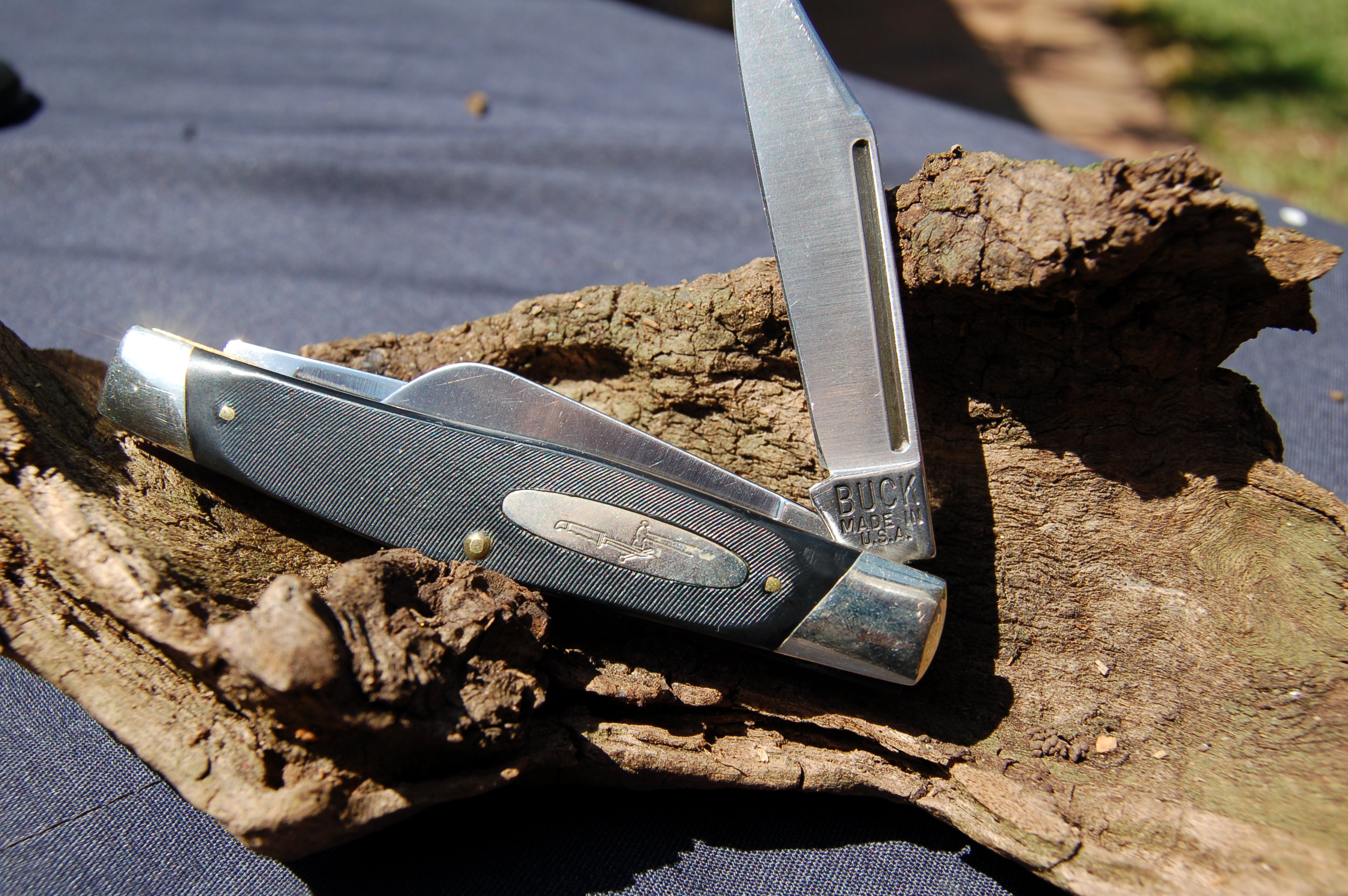

The two 935 John Primbel knifes where made by Schrade and sold for $$4.57 in 1971.
The Buck 301 was also made by Schrade, about the same time.

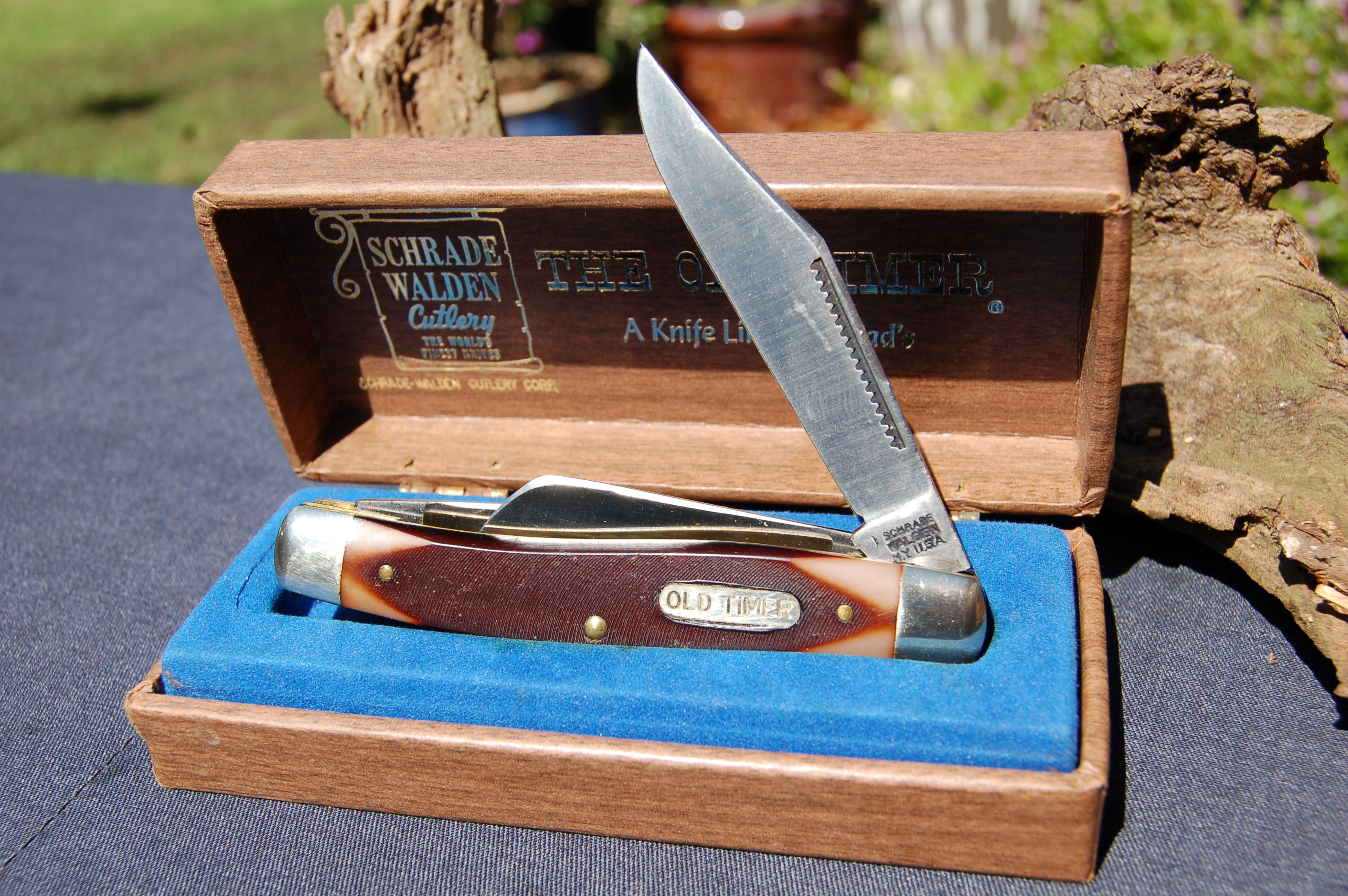

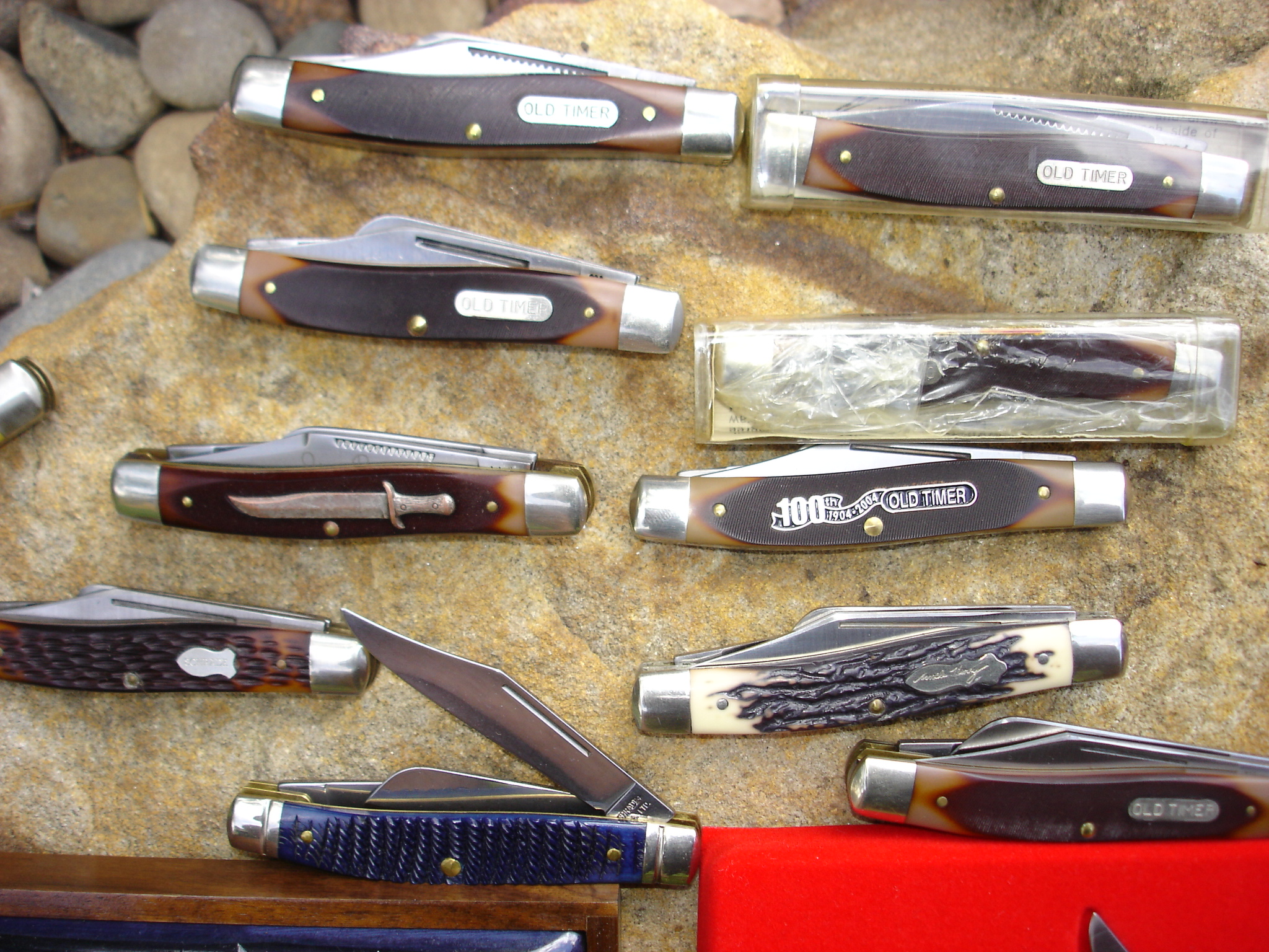

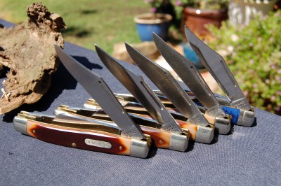

I have also taken this opportunity to take some pitchers of my Walden 880s and 881s,
I have quite a number of the 881s stamped Schrade NY also, but they do not have the match-strike pull.
If I can help by putting more pitchers up, Please let me know.
My collection starts in the 1960’s and finished up after the factory closed down…..Ken

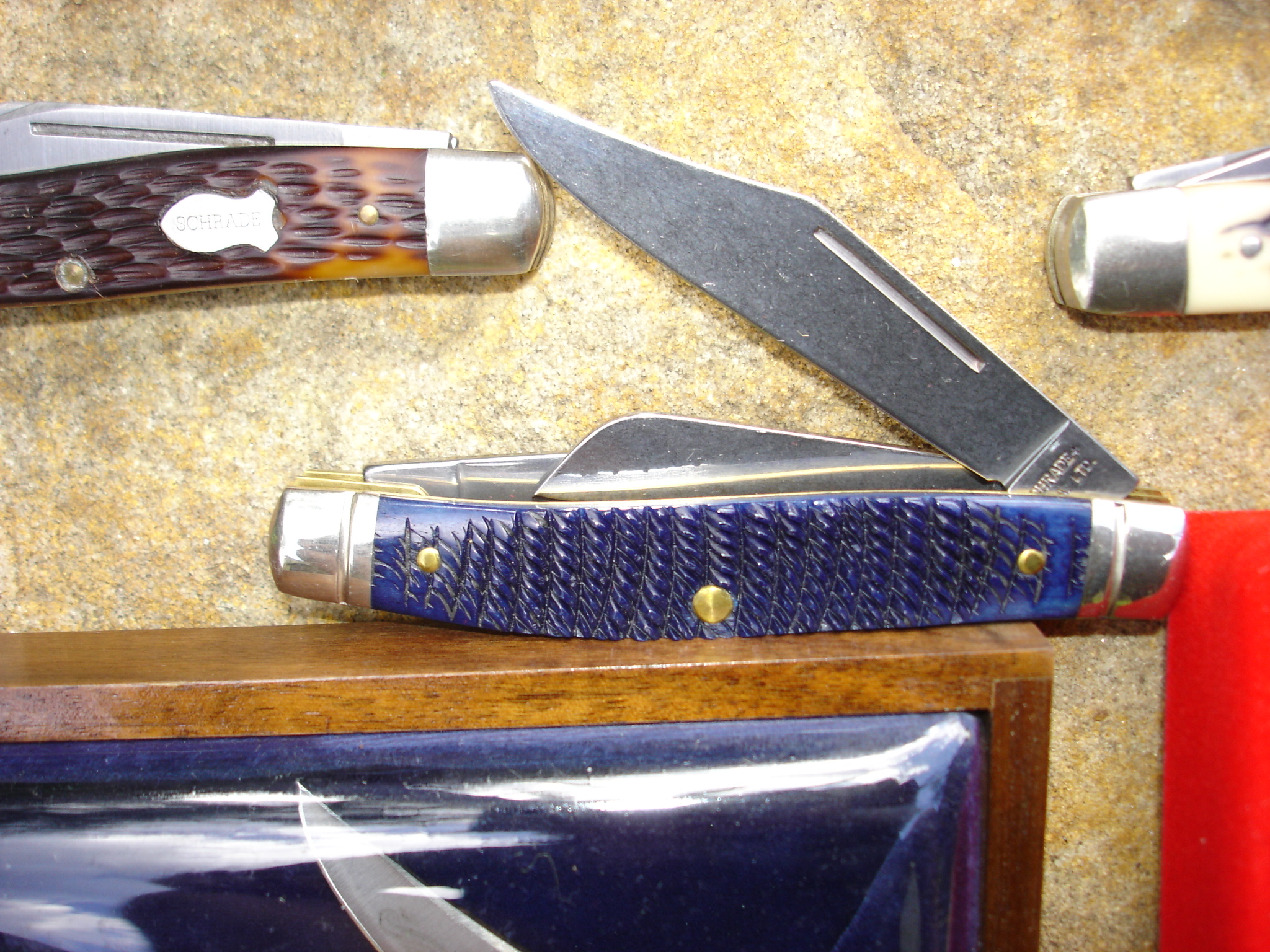

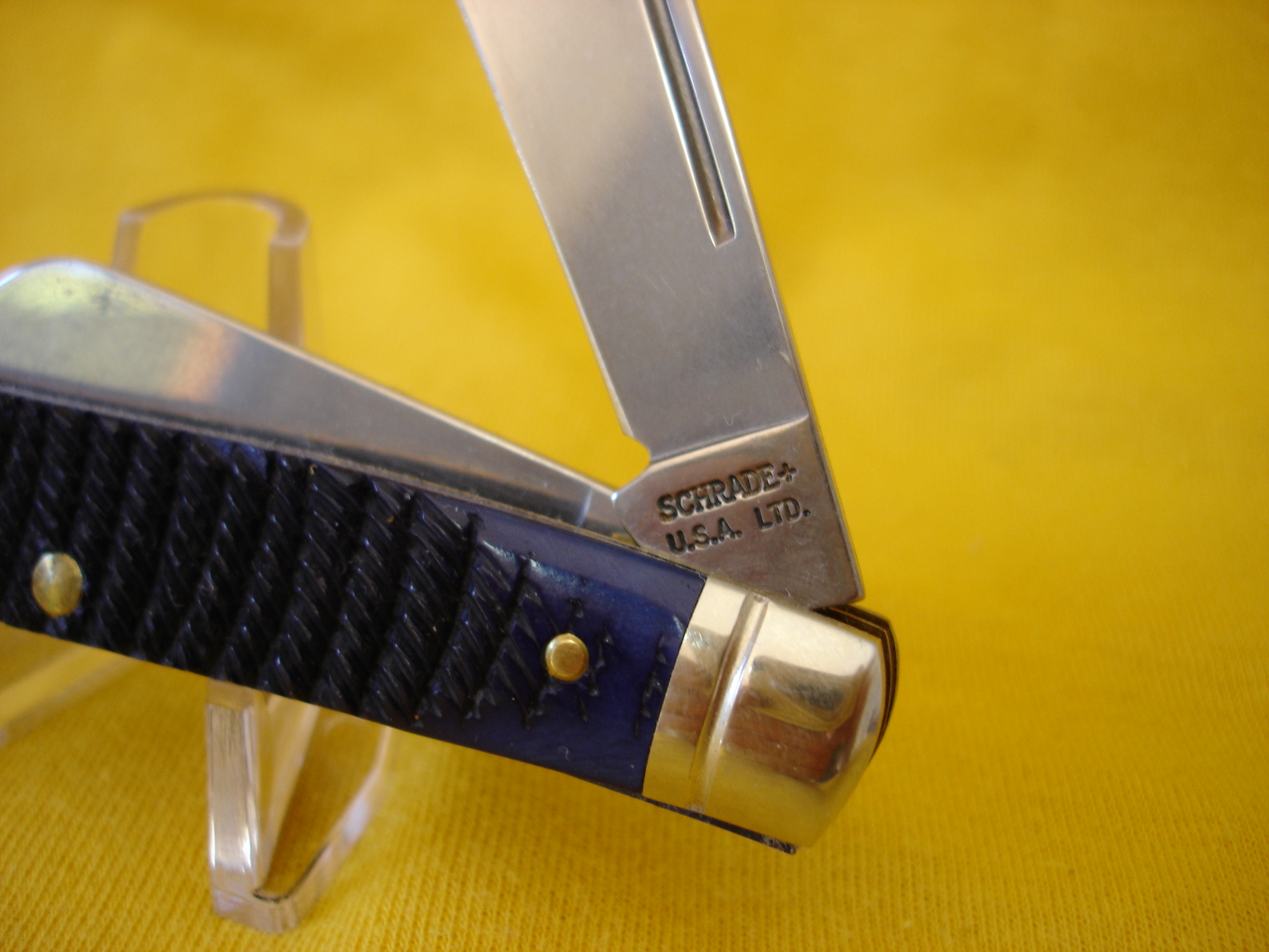

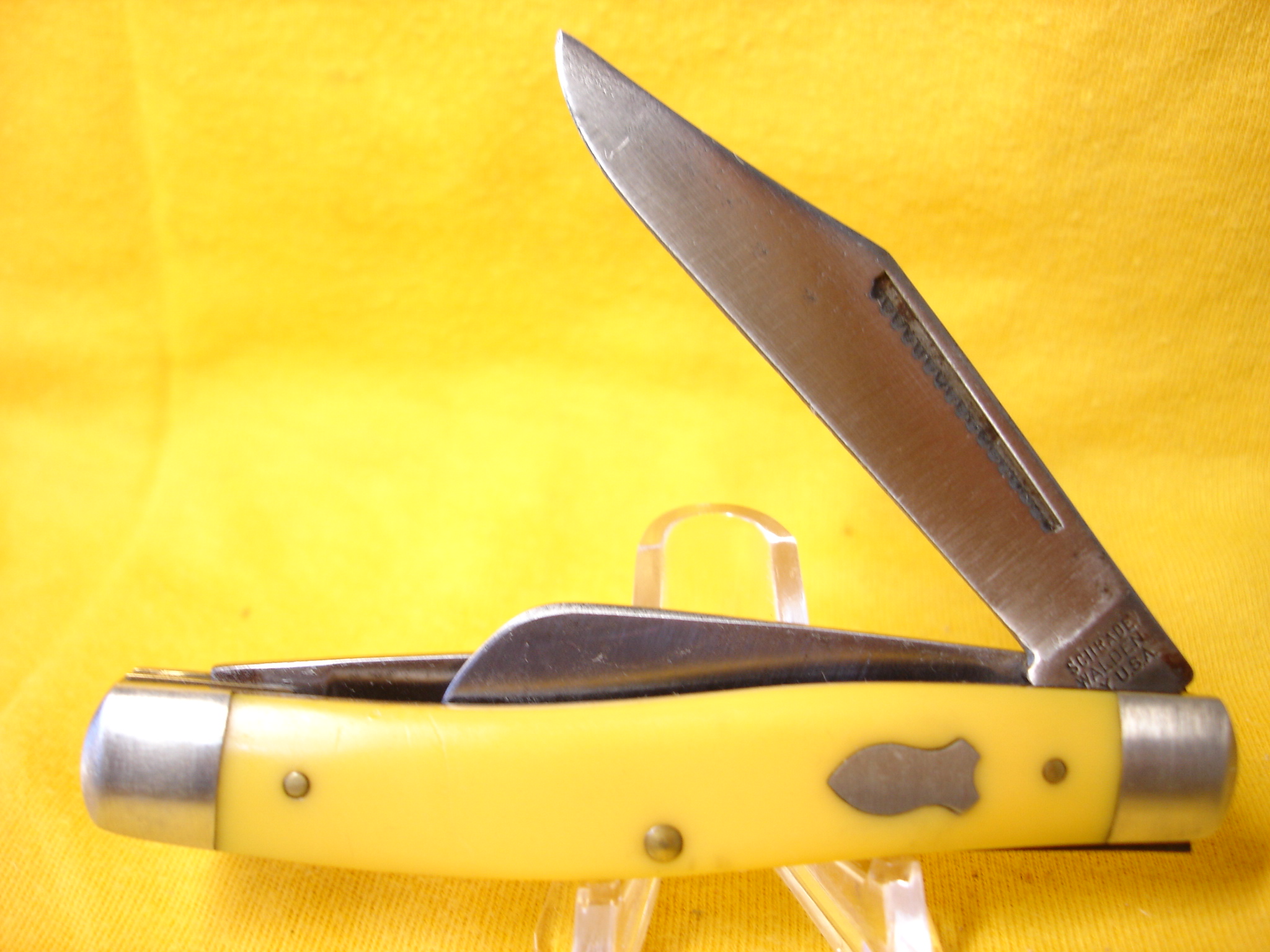

Koldy, those are some right smart #8's. I don't recognize that blue one. If you come across an odd bone one that doesn't fit with the rest of yours, I can give you some relief. I would even pay to get it over here. :shock: :mrgreen:
koldgold
Posts: 1101
Joined: Sat Apr 03, 2010 11:43 am
Location: Just North of Sydney,Australia.
Re: Schrade Walden 8OT Question
Post by koldgold »

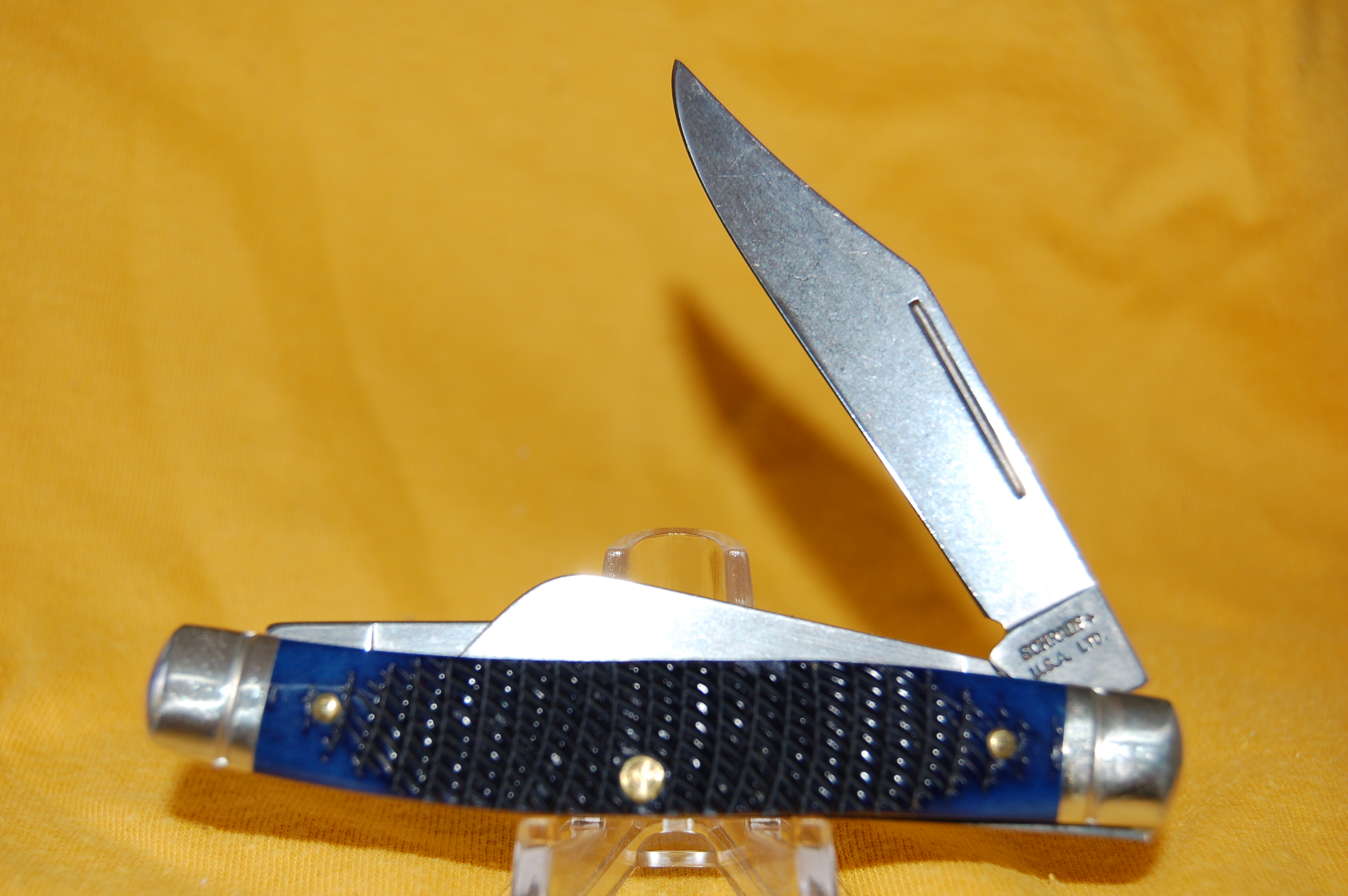

Hi,
The blue Schrader is a 3 blade Premium large Stockman, 4 inchs long when closed.
The blades ( clip, splay and sheep’s foot ) are all made of Schrade + steel.
It has Nickel silver bolsters, and brass liners.
The Handles are made of, Genuine BLUE - ROPE CUT BONE .(Not Staglon or Delrin)
This very RARE  knife was made in 2004, however they where never sold.
It was purchased at the Schrade factory Closing Down Sales in July 2004.
I can not  find any information on these knives.
There is no indication that they had ever been produced.
It is also very rare to find a schrade knife with a genuine bone handle, and even more rare when it has " ROPE CUT " Handles.  This knife is definitely a rare find.
The pictures of this knife do not come close to doing it justice.
It is an absolutely beautiful  knife, that  would make a great addition to anyone's collection.
It did not come in a box, I had two and sold one and keeped one....Ken ::dang::
I like the OTC 8O 4inch knife, almost as much as my #320 Schrade D'Holder. ::tu::
