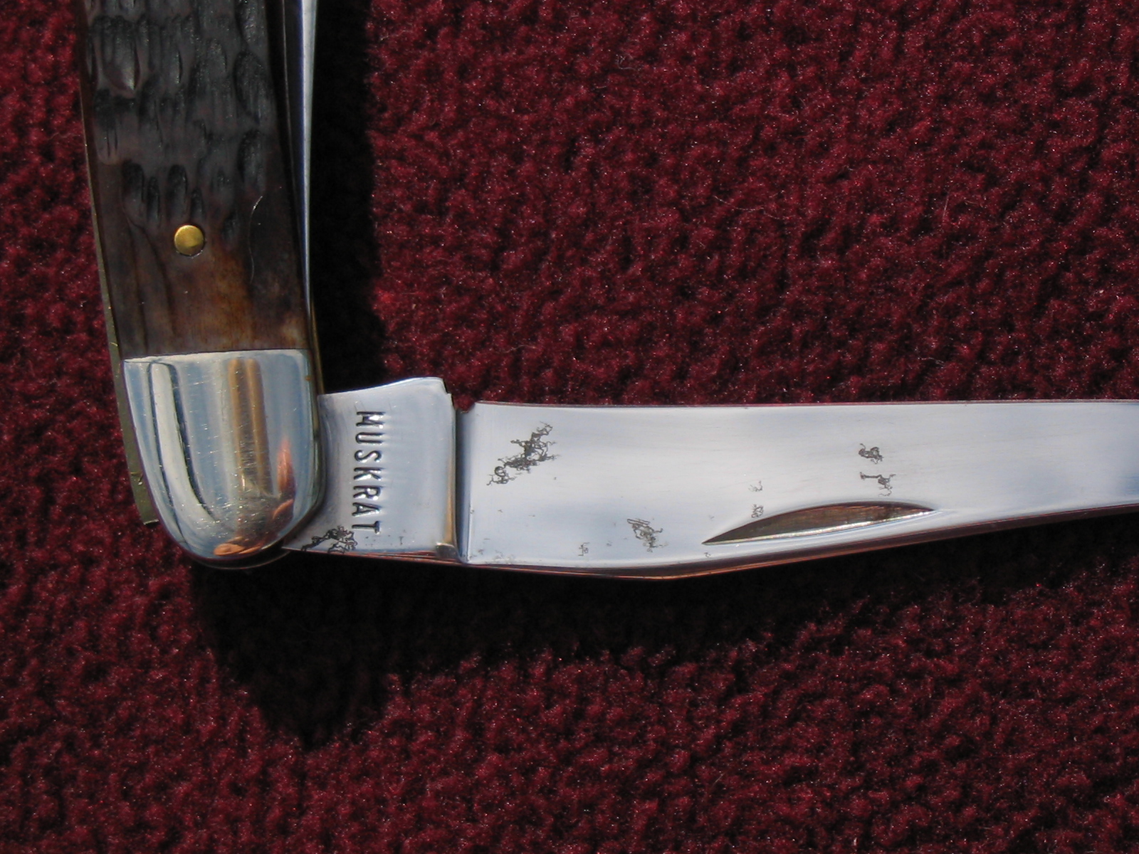

What is it that causes those black squiggly (spiders) marks on knife blades?
Don't think I have seen them on stainless before.
Is it some sort of fungus or bacteria colony that excrets an acidic waste actually etching the material? (just a guess)
A fungus does similar damage on camera lenses stored under humid conditions. The bacteria in our mouths excrete an acicic waste causing cavities over time.
I can't get my mind around oxidation causing such deeply etched localized tracings.
What can be done to prevent them or stop their progress?
::paranoid::
1980 Muskrat spiders.JPG (857.54 KiB) Viewed 3701 times

So far looking for the terms you suggested leads me to nothing that resembles the the patterns on my knife or ones I have seen.
If you click on the picture and supersize it you can see them pretty well. (took me a few tries to get a good photo)
Just curious about what causes it and preventative measures for it.

Looking at them very closely with a loop they are deep squiggly shaped pits, or lines radiating from a centralized area where they probably started from.
I couldn't say just how deep they are but that they can't be removed by any means other than removing some steel with them.
This Muskrats' example marks it for life in my opinion and I wonder if it will continue to get worse.

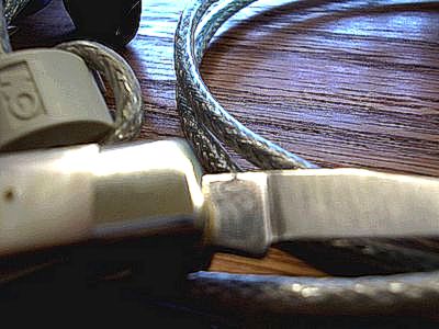

Here is one (on the tang) on a knife I have. No polish or such has any effect, unfortunately. But it has never changed in the 5 years that I've owned this knife.
Bill
P.S.
Sorry about the pic...the squiggly looks like a cobra there on the tang.
