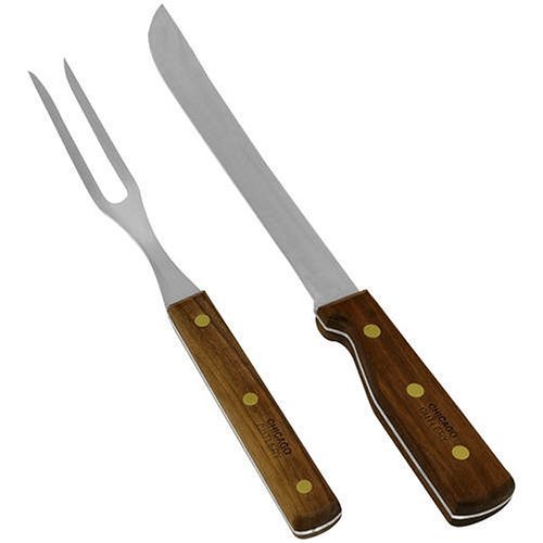

DaveT63
- Posts: 34
- Joined: Tue Apr 29, 2008 1:00 pm
Re: Fixed blade handle material removal?
Good call, Phil, hadn't thought of that. Hope this works....

- Elvis
- Posts: 2185
- Joined: Tue Dec 22, 2009 2:22 pm
- Location: Cincinnati, Ohio USA
When I saw the title of your post my first thought was a Dremel cutting wheel which would still work in cutting off one side of the rivit, but after looking at the picture I think drilling out one side then using a punch might be a good start.
coffeecup
- Posts: 1367
- Joined: Tue May 20, 2008 4:15 am
Disclaimer: I am most specifically not recommending the following technique, merely offering it for amusement and historical purposes.
I once did 30 sets of these for some crazy project my nephew came up with. Being the lazy man I am, I clamped the handle in a parallel clamp (Jorgenson or similar), with the knife/fork/whatever on edge. Then I just cut the old handle off with a bandsaw, carefully cutting to one side of the tang. Stop as soon as you've cut through the second rivet--so there is still some full-thickness wood--or the clamp will slip.
Took longer to replace the blade than to saw the handles off.

- Darksev
- Posts: 759
- Joined: Sat Jan 05, 2008 6:07 pm
- Location: NE Ohio
carefully drill out the head of the rivet on one side, then use a punch. remember when working with sharp knives tape up your blade before you work
- Diligence
- Posts: 446
- Joined: Thu Jan 04, 2007 5:43 pm
- Location: Alberta
To be clear (and to answer your question), you can't remove the handles without "ruining the hardware".. since these are rivets, with a mechanical connection (ie. press fit) you will need to cut them to remove them.

DaveT63
- Posts: 34
Thanks for all the tips, everyone! I tried the drilling method, and the handles came off in about two minutes flat. I was sure they would be glued on for some reason, but I guess that just adds to manufacturing time and costs, huh? Anyway, I will be gluing the new ones on and adding mosaic pins to dress them up a bit.
