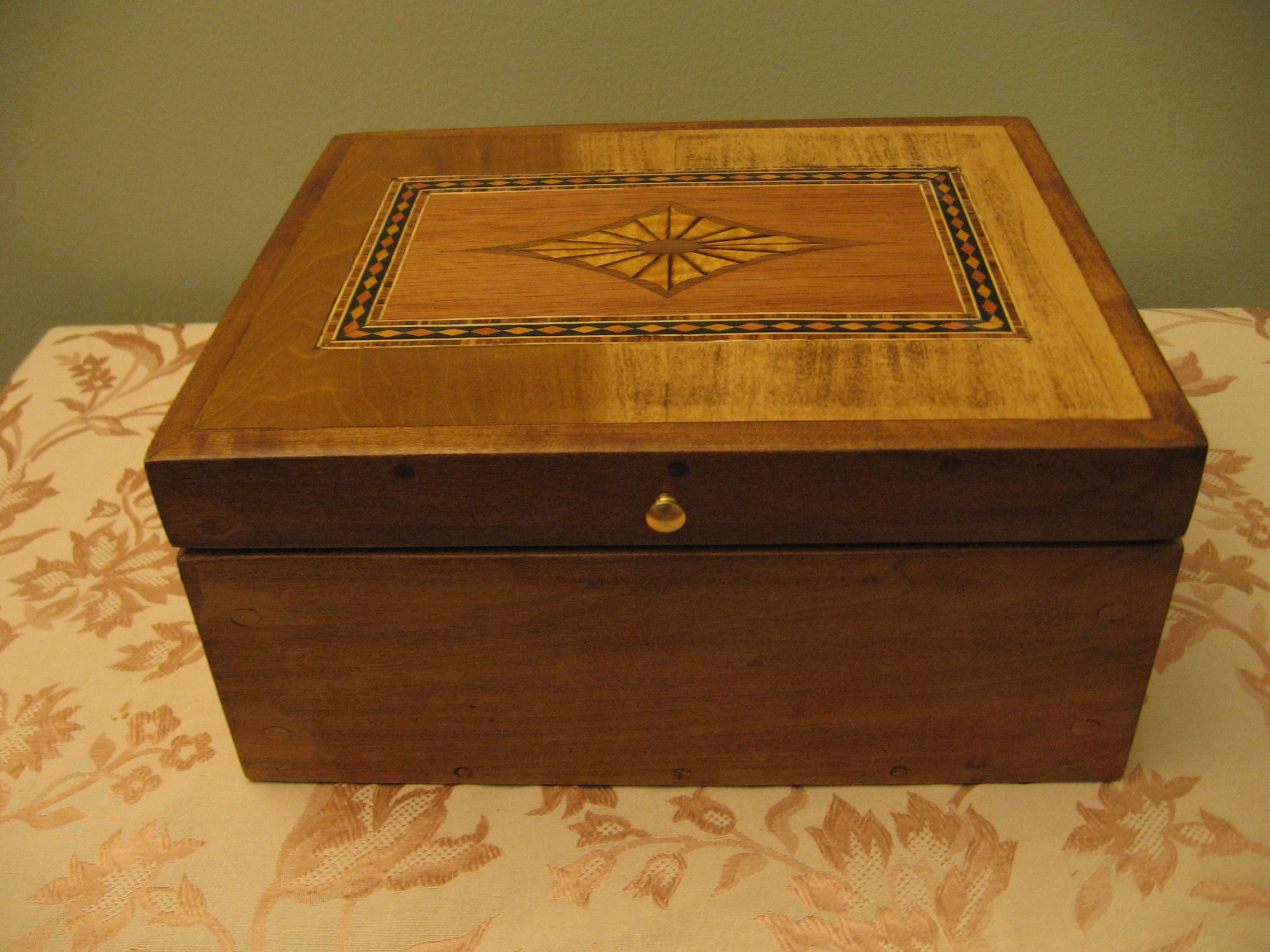

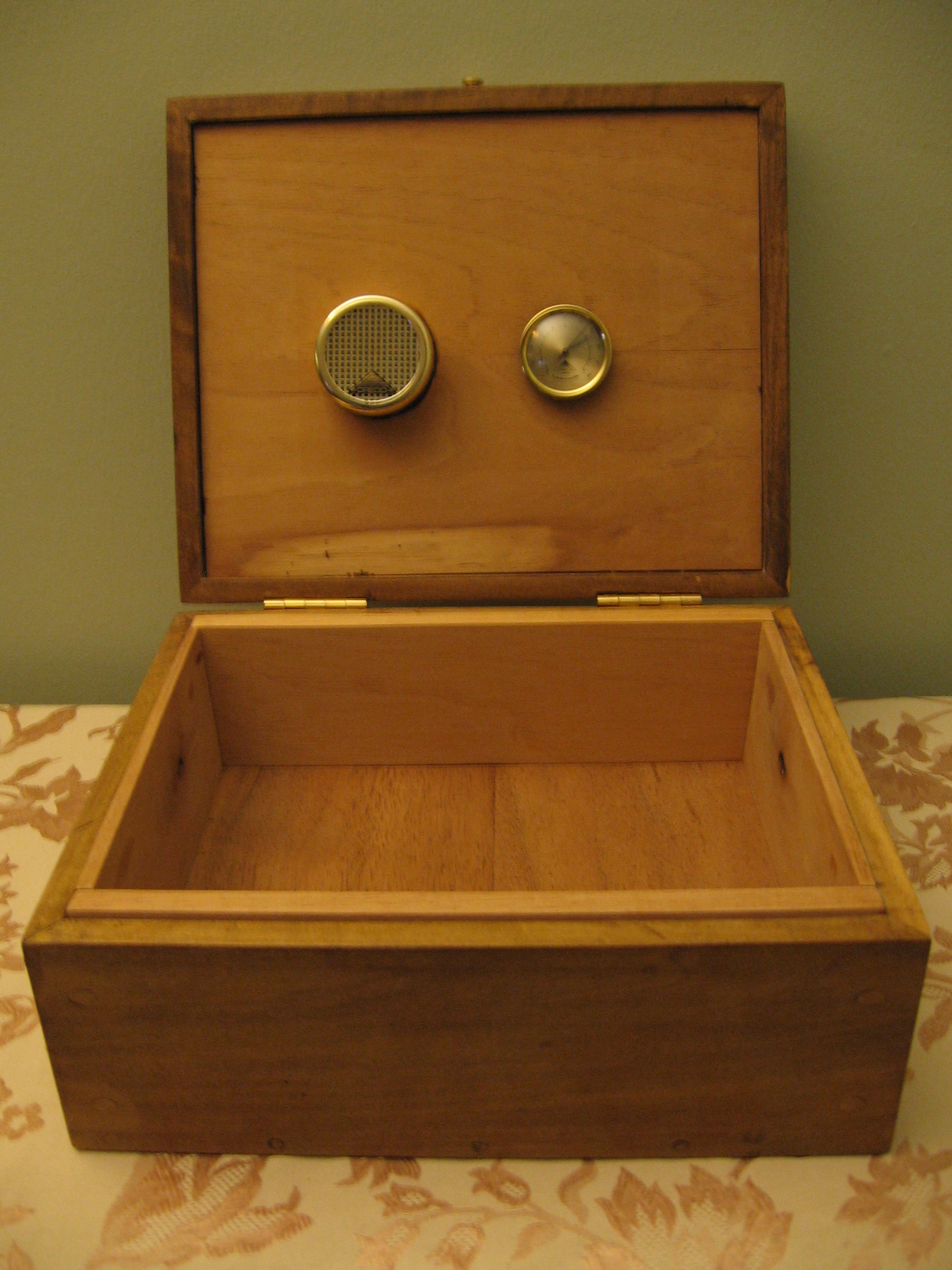

I don't.
However, I thought building a small humidor would make an interesting project, so here are the pics of my maiden attempt. It was actually very interesting and satisfying, and I've already bought the lumber for the next one, which is going to be walnut and zebrawood, with some decorative inlays and banding.
So now I guess I'm not only going to be a guy who doesn't hunt yet owns a bunch of hunting knives -- I'm also going to be a guy who doesn't smoke cigars but has a bunch of humidors. ::doh::

That's a great looking humidor Longbeach. Nice work ::tu:: I don't like cigars but I recently acquired this cool little Victorian era cigar cutter. It is only about 1.5 inches tall. Obviously not designed for big stoggies. There is a little pincer on a spring. By turning the top of the champagne bottle one way the pincer is locked shut. Turning the top the other way causes it to spring open. Place the tip of the cigar into the end of the bottle and push the pincer through with your thumb. :) s-k

Very cool S/K... ::tu:: ::tu::
Jim, that is excellent work...very well done.
I do like cigars, and have several humidors, none of them any nicer than that one.

S-K, that's a really cool little trinket you've got there. Between us two non-cigar smokers, we're pretty well equipped I'd say.
Bill, so you are a cigar aficionado, huh? Well if you're ever down this way, you've got an open invitation to drop in for a stogie and a glass of your favorite potable, potent or otherwise. That goes for the rest of you knife knuts as well.
After I'm done curing the cedar interior, which is the only thing left to do, it's going on our sideboard next to the decanter of brandy. I'm going to stock it with twenty cigars in the $5 range to test it out. Anyone have suggestions for a good $5 cigar?

Make sure you use distilled water, not tap water, as it might cause mold growth. Also, I don't suggest rubbing the inside of the humidor down with water...as it will raise the grain. Just put a glass of distilled water inside for about 5 days and let the wood pick up the moisture gradually. JMO.

I'm glad you mentioned that about evaporation vs. direct moistening. I was flirting with the idea of sponging, now I won't. I'd read that distilled water was preferred, but I didn't know why. Now I do -- thanks!

I have a good stick once and a while. I think you'll want to place a larger humidifier unit in that humidor. The reason for distilled water is because the particles in tap water clog the humidifier material. You really must maintain 70% humidity and the optimum temperature of 70 degrees. If the humidity goes too high you will get a blue mold, and the perfect conditions for mold are high temperatures and high humidity.
You have a nice box there, and I hope after it's seasoned it will be a fine humidor. Just remember that a $.75 cigar can be just as good as a $5.00 cigar if you know what to look for, and how to take care of them.

For all I know we don't need them in So Cal either. I've had the hygrometer out sitting next to the humidor while I've been curing it for the last several days, and the reading never varies far from 70%. If I make several of these and decide to sell them there may not be much of a local market.
