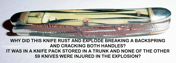

I just opened a knife pack of 60 knives...stored in a trunk...and I found the one in the picture had rusted, and exploded, breaking the back spring and cracking both handles. None of the other knives were injured in the rust explosion! The knive was new and unused when it was put in the pack.
Was it my bad handling or storage of knives or was there something on the knife when I stored it?

I think you are right there Johnny. At first I thought there may be more to it, but looking at the discolorization of the bolsters, outgassing of the celluloid was definitely the culprit. That is one of the more severe cases I've seen.jonet143 wrote:celluoid gasout! you're lucky more knives were'nt harmed.
This is why we keep celluloid seperate from non-celluloid knives. I don't know if I would keep 60 knives with celluloid together, you might want to keep a close eye on the other 59 that were stored with it.

A local collector had a case with about 25 knives in it. One of the celluloids suddenly started to outgas. I had looked in that case about 2 months before it happened & he had looked at them about 2-3 weeks before it happened & they were fine. When he opened the case the last time one knife was almost totally destroyed and several others had been damaged. The cost of the damage was hundreds of dollars in decreased value to the knives in the case.
I try to keep my celluloids separate from my other knives.

Suspect high humidity. Myself for one would be interested in a hygrometer
reading in that trunk closed up as the knives were stored. An hour should be long enough for an accurate reading. Seems as though the conditions for rust and gassing were ultimate. Also an interior temperature reading would be helpful.

Gasout it was, I think. One of the worse cases I've seen. Could you post some more pics of that knife, please? I woul like to keep them in my personal files.
I think of this happening everytime I buy a great old cell handled knife. That's one reason I keep them in the open, on display. I like to think air circulation helps preserve them and I get to enjoy the knives more that way-- until or if they deterierate.

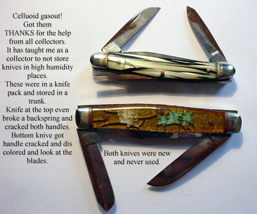

Gr8Scout wanted some more pictures of the celluoid gasout explosion.
I found another knife that was damaged. One handle was cracked and discolored and rust galore on the blade. One knife next to it got some rust and the first knive that got a broken backspring and both handles cracked, even changed handle color. It was blue now it's green. Gas turns you green I guess? Both knives were new and unused when I put them in the pack. Yes Gr8Scout I have learned instead of collecting and storing ~ we need to collect and show ~ What good is a collection of knives stored in a trunk to get damaged. I hope picture 2 shows the knife where the backspring broke and it even broke one of the straps holding it. The Christmas tree canoe next to it got some rust damage, but cleaned up...The second knife was on the opposite side of the pack.

Gr8Scout
Thank you for the photos. Very good post here. To be clear... I do not know if keeping my old cells out in the open will improve their life expectantcy. My point is to enjoy them and show them off and I am hopefull that fresh air surrounding them will help.
Here is the best thing I have read on cell handles, from the BRLevine site.
http://www.oregonknifeclub.org/celluloid_02.html
