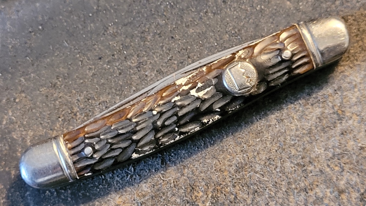

by eveled
These are the Imperials I was curious about. I thought they might be a plastic slab riveted on. But I’ve been told they are wrapped in celluloid like the one in Dales post.
Re: Anatomy of a Shell Handled Knife
Posted: Mon Aug 14, 2023 10:48 pm
by Dinadan
eveled wrote: Sun Aug 13, 2023 11:56 am One question. Did shell handle knives ever have rivets on the scales?
I have a couple of shell handle knives that have rivets in the scales. I think the rivets are just ornamental. Here is one with the wrap missing from one side.
Or in other words. Does the shell handle refer to the metal with the wrap? Or the general construction with the tabs?
A shell handle knife, by definition, is going to have the tab construction. I have never seen one without the wrap, but if it were bare metal it would still be a shell handle knife. I think.
