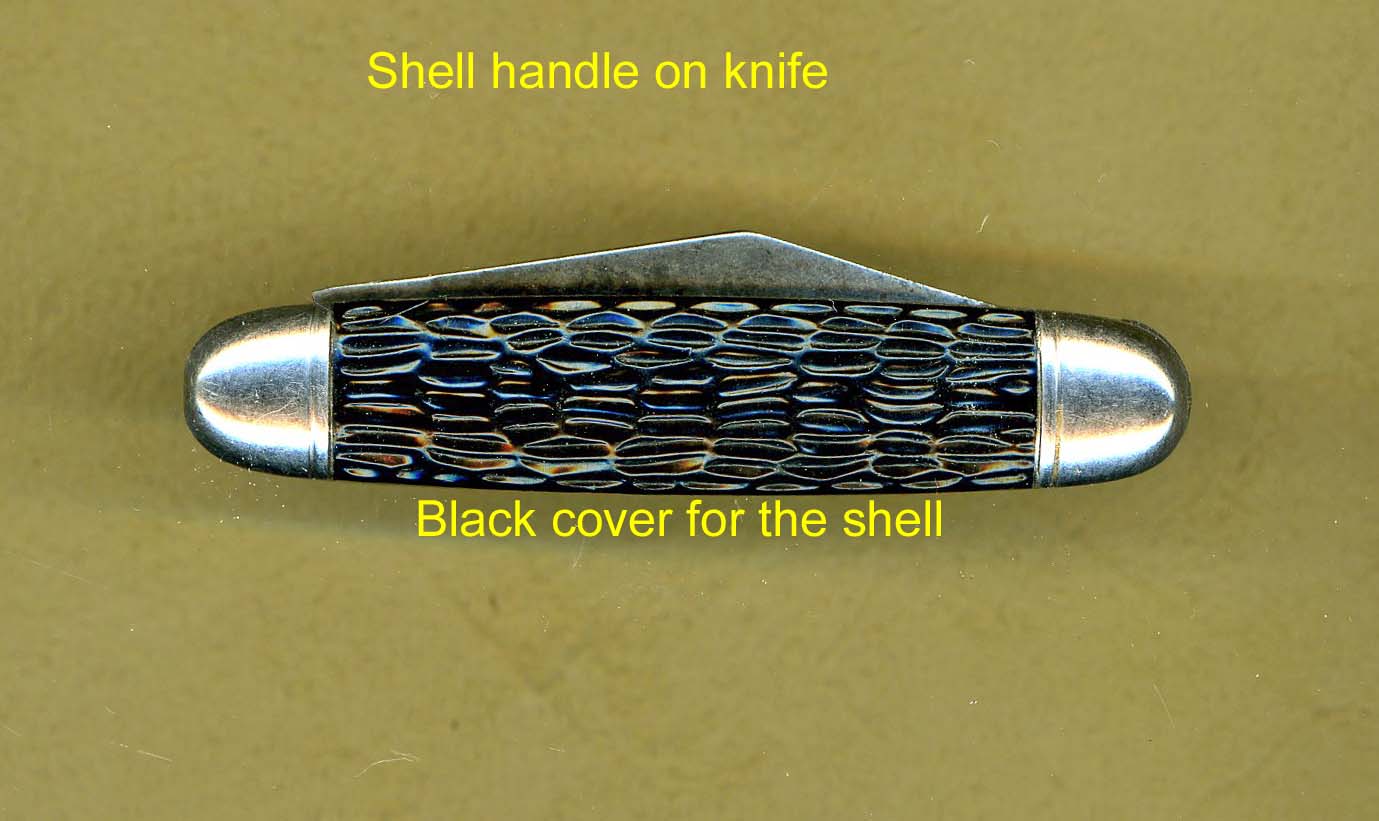

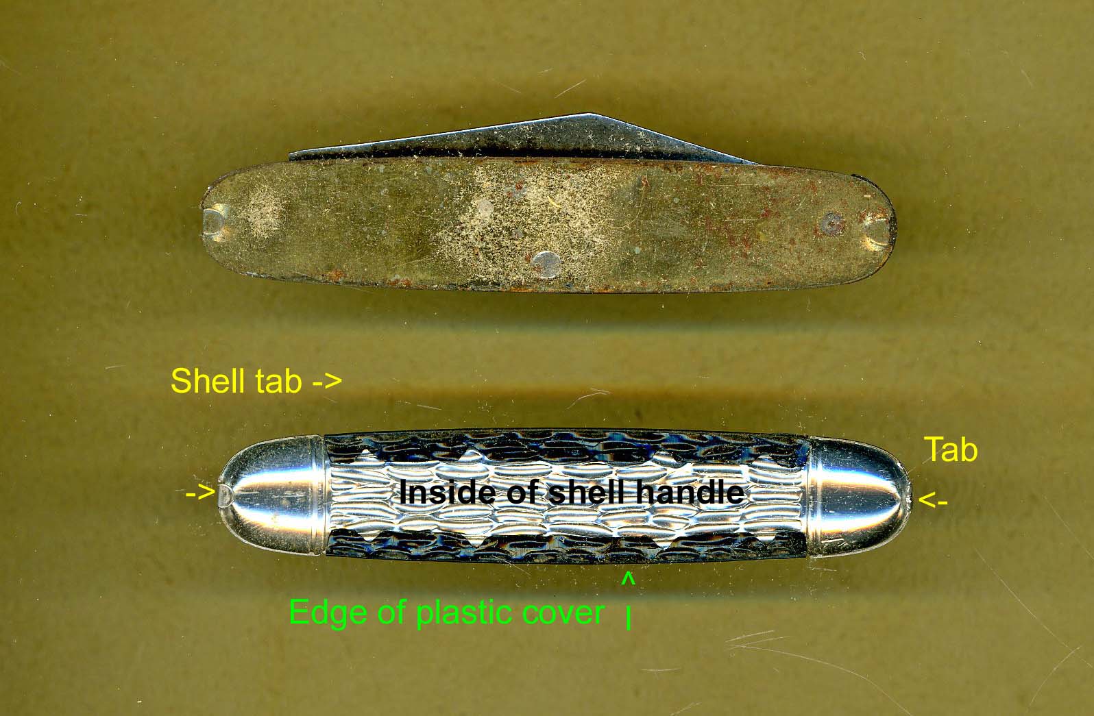

This is the knife we are starting with. It is an Imperial Hammer Brand jackknife. The handle on the front side of the knife was long gone when I acquired the knife. You can see in this first picture the liner of the mark side of the knife. Notice the sockets or indentations at both ends of the liner. This is where the tabs on the ends of the shell handles were fitted.
In this picture you see the shell handle still intact on the pile side of the knife.
The black part of the handle is not paint, is a piece of plastic or celluloid that is stretched around the outside of the shell handle and tucked inside of the hollow shell.

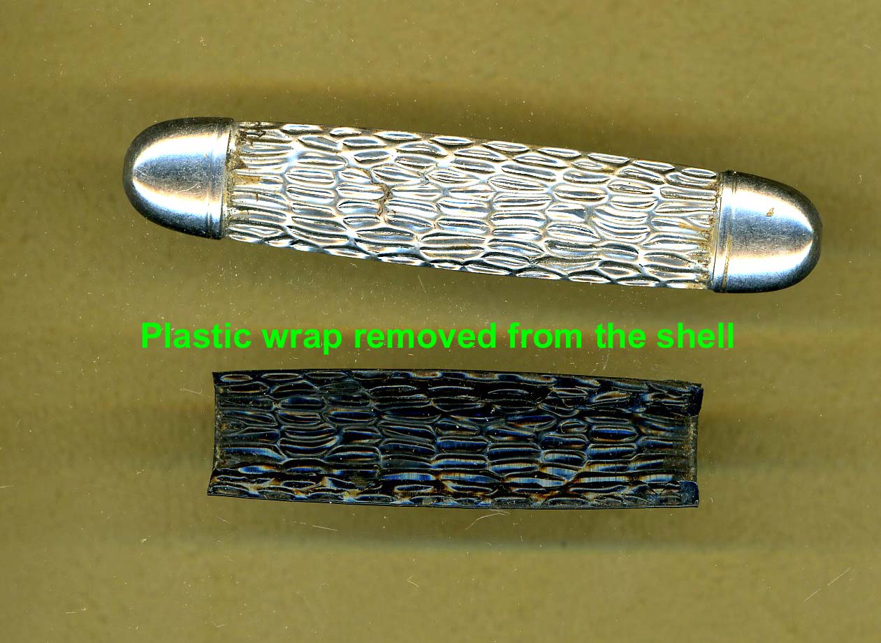

In this picture we see the inside of the shell handle with the edge of the plastic wrapper folded inside of the shell.

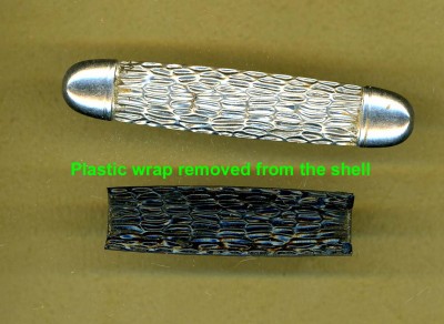

In this picture we see the shell handle and we see the plastic wrapper or skin removed from the shell.

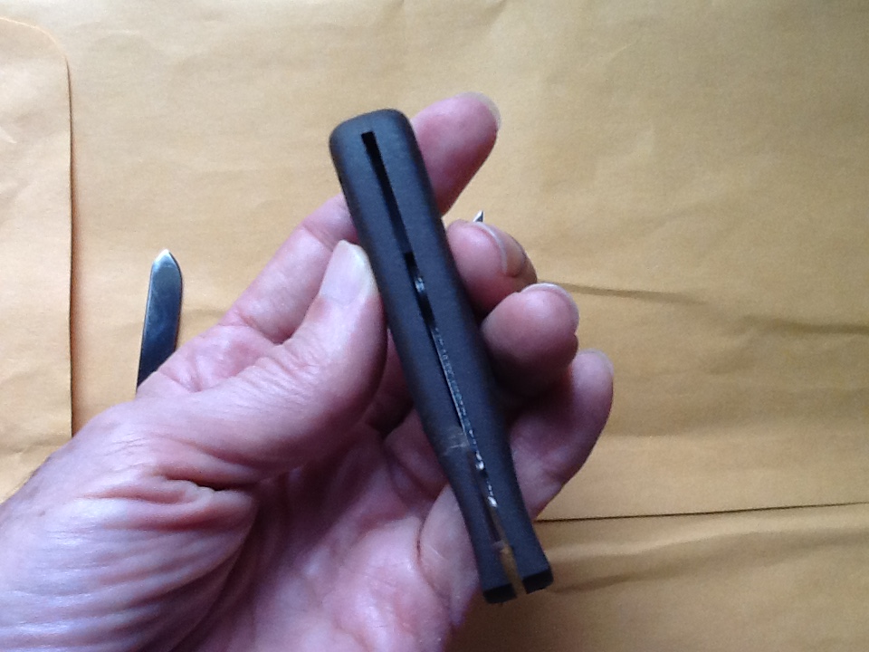

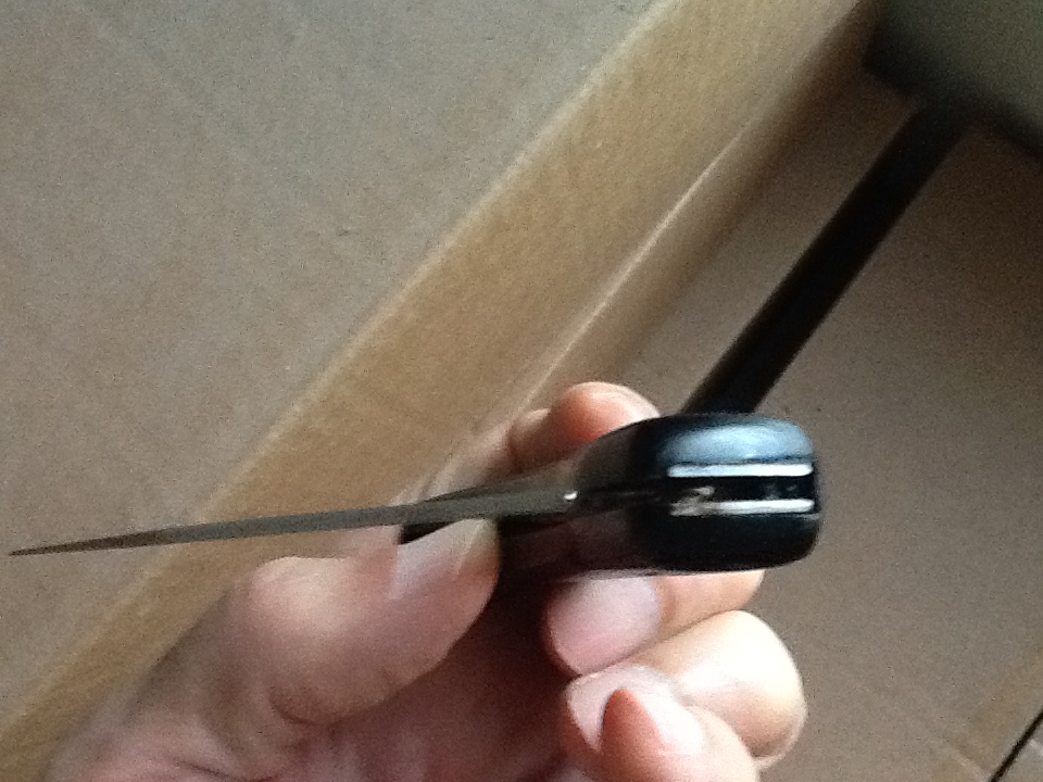

These next two pictures will not enlarge as much as the ones I took with my scanner. These were taken with the camera on my workbench.
Here you see the tab of the pile side shell that has been loosened from the knife by the tip of this corkscrew.
Imperial Hammer Brand -e- tab loosened.jpg (26.89 KiB) Viewed 8709 times

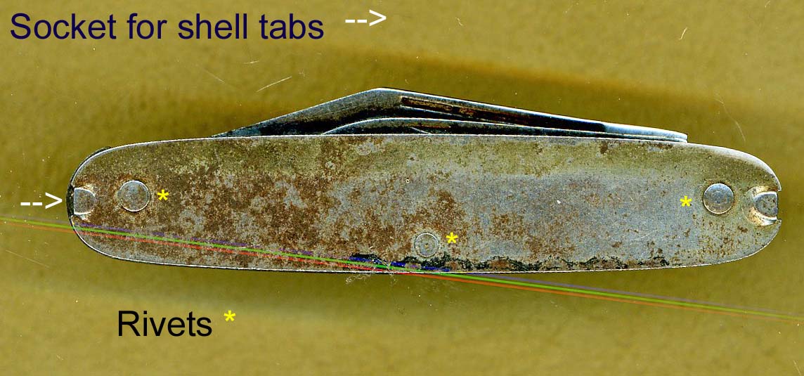

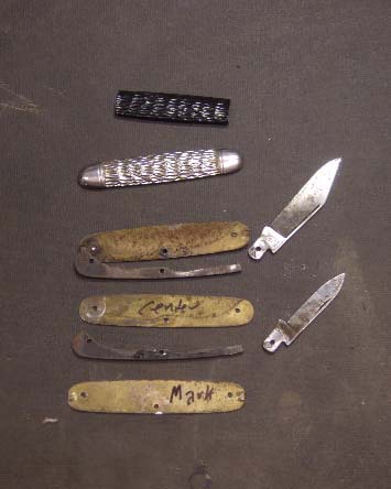

In this last picture you see the various parts of the knife disassembled with the exception of the mark side shell and plastic, which were missing to begin with.
Imperial Hammer Brand -f- disassembled.jpg (37.28 KiB) Viewed 8709 times
Instead of having a frame this shell handle has three liners of steel (don't let the brass color throw you, they are steel), two springs, & two blades which were held together by three rivets. This formed the functional portion of the knife. The shell handle on the outside was for the purpose of making it fit the hand better and look more like the customers expectation of a pocketknife. With the exception of comfort in the hand, the shell handle knife, (excluding any damage), is fully functional without the shell handles.
There you have a quick anatomy lesson of the shell handle.
I hope you find it helpful.

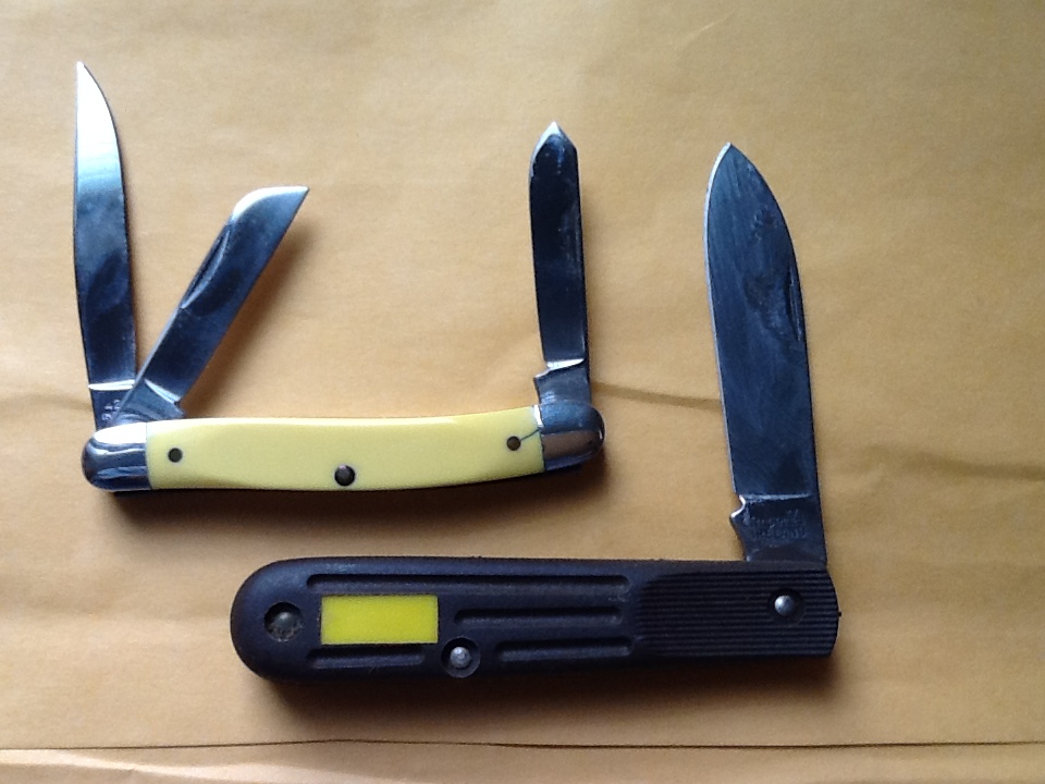

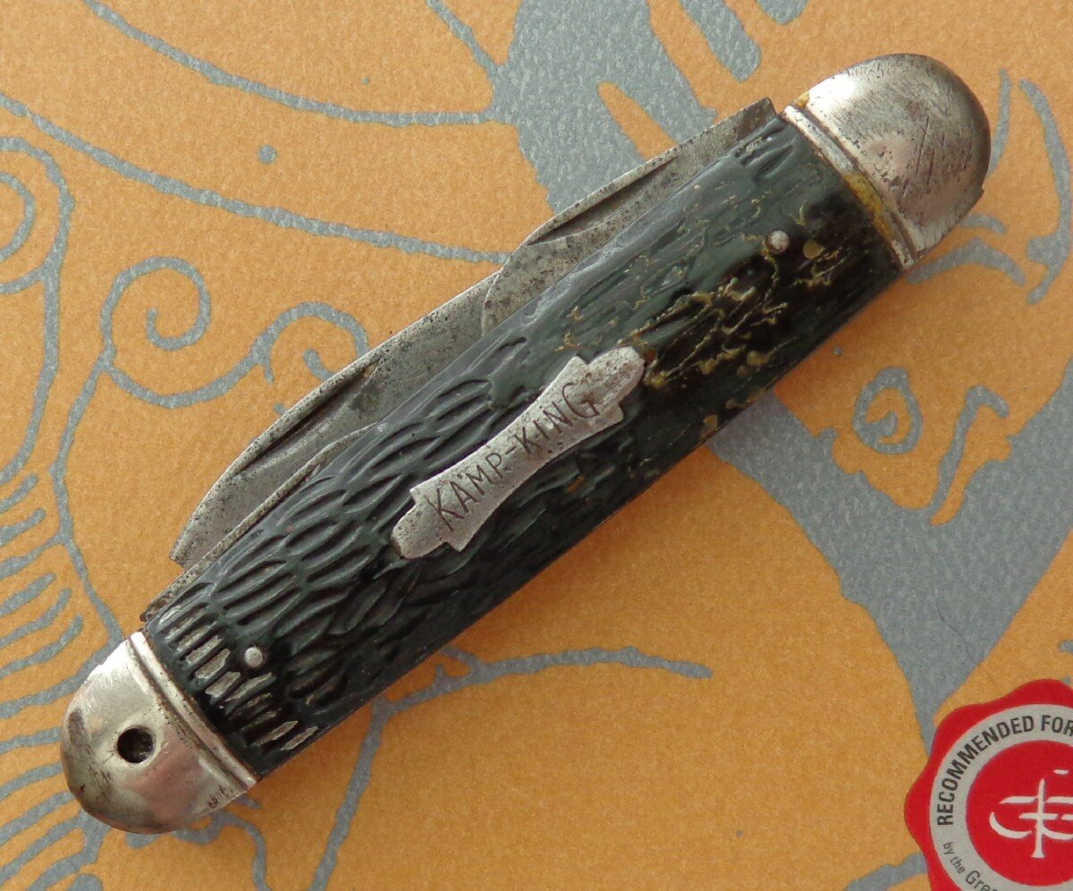

One question. Did shell handle knives ever have rivets on the scales?
Or in other words. Does the shell handle refer to the metal with the wrap? Or the general construction with the tabs?
Reverand
Posts: 4469
Location: Pisgah, AL
Re: Anatomy of a Shell Handled Knife
Post by Reverand »
I have never seen an Imperial shell handle that had rivets in the handles.
I have seen a couple of lower-cost German and Japanese knives that had a hollow bolster, and it was pinned through that. But they did not have true shell handles, just a shell-like bolster with solid handles.
But, as I am relearning ever day, there is probably an exception to every rule.
Jesus is life.
~Reverand
eveled
Posts: 2582
Post by eveled »
These are the Imperials I was curious about. I thought they might be a plastic slab riveted on. But I’ve been told they are wrapped in celluloid like the one in Dales post.
Dinadan
Posts: 3647
Location: Coastal Alabama
Post by Dinadan »
eveled wrote: Sun Aug 13, 2023 11:56 am One question. Did shell handle knives ever have rivets on the scales?
I have a couple of shell handle knives that have rivets in the scales. I think the rivets are just ornamental. Here is one with the wrap missing from one side.
A shell handle knife, by definition, is going to have the tab construction. I have never seen one without the wrap, but if it were bare metal it would still be a shell handle knife. I think.
