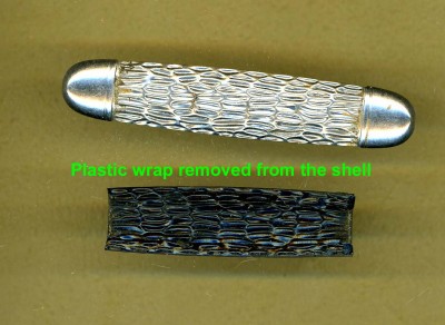

OK, here is a quick tutorial on the anatomy of a shell handle knife.
There are variations on the shell types, but this is the one commonly used by Imperial starting about 1936 through the close of the Schrade factory in Ireland in 2004.
These knives were cheap (price wise) even by the standards of their day, and remember they were introduced in the middle of the Great Depression. But low price did not mean low quality. I recall a conversation I had with a knife repairman who was about 85 years old; he said there was one knife company that always used good steel in their blades, even in their cheap knives, in his opinion that company was Imperial. I agree wholeheartedly. These inexpensive knives are still around today, many made in the 1930s and they still work as a knife. Many are worse for the wear, but if they have been oiled to prevent the rust that commonly plagues carbon steel they are still functional.
I personally think the shell handle knives are an excellent example of the cutlery industry using technology to lower the price of a pocketknife in response to the depressed economy to stay in business and still provide their customers with a nice-looking and more importantly a functional pocketknife.
Yes, I know they are not nearly as nice as a Case stockman or a Remington trapper but they did have something that these others did not, they were affordable to the average guy at that time.

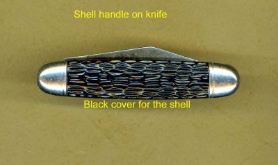

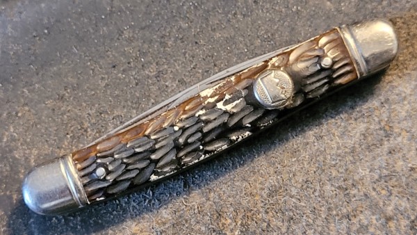

This is the knife we are starting with. It is an Imperial Hammer Brand jackknife. The handle on the front side of the knife was long gone when I acquired the knife. You can see in this first picture the liner of the mark side of the knife. Notice the sockets or indentations at both ends of the liner. This is where the tabs on the ends of the shell handles were fitted.
In this picture you see the shell handle still intact on the pile side of the knife.
The black part of the handle is not paint, is a piece of plastic or celluloid that is stretched around the outside of the shell handle and tucked inside of the hollow shell.

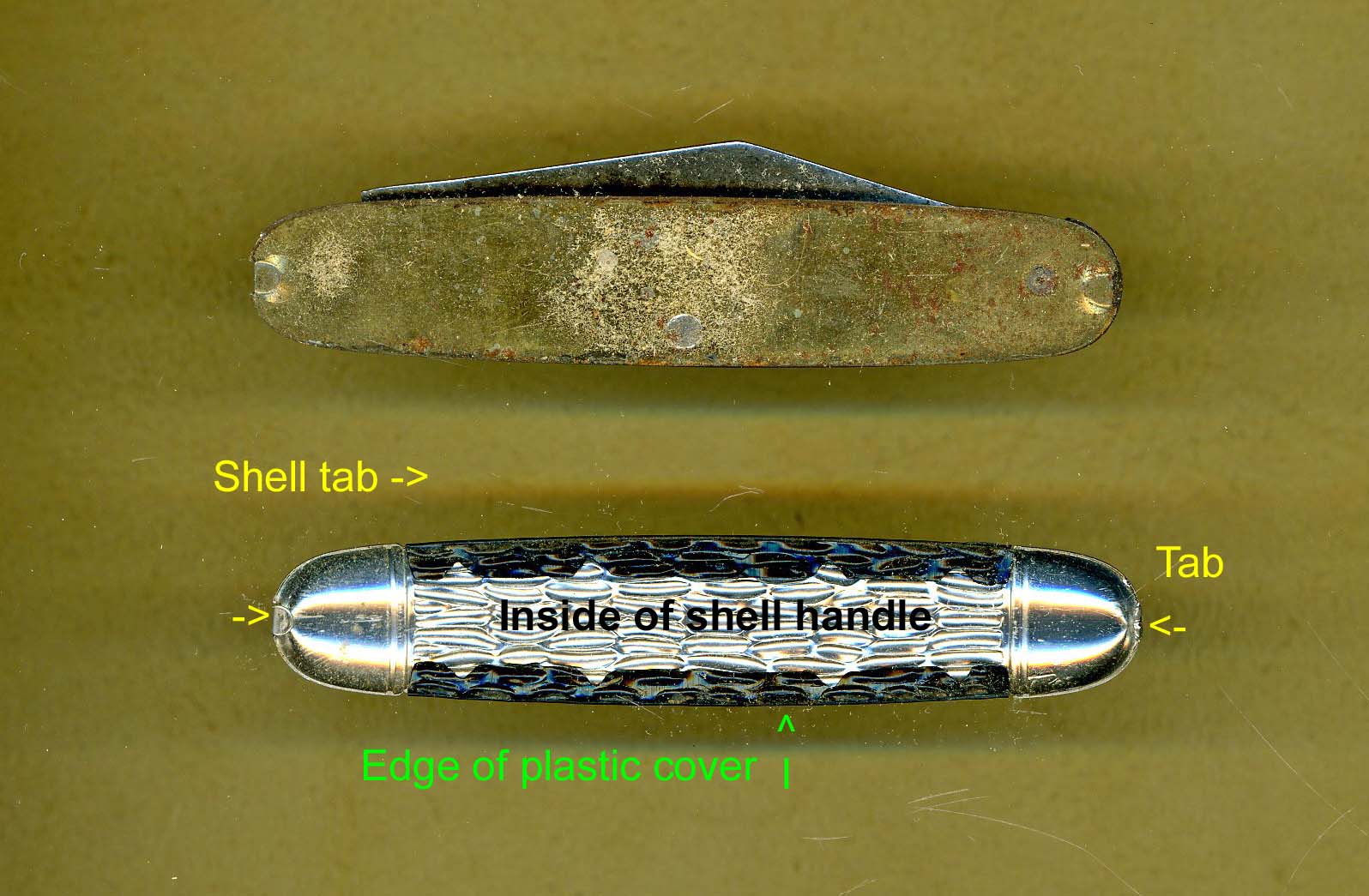

In this picture we see the inside of the shell handle with the edge of the plastic wrapper folded inside of the shell.
In this picture we see the shell handle and we see the plastic wrapper or skin removed from the shell.

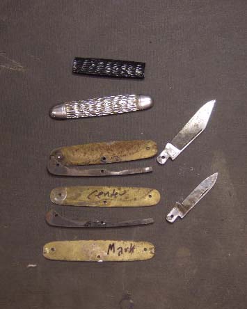

These next two pictures will not enlarge as much as the ones I took with my scanner. These were taken with the camera on my workbench.

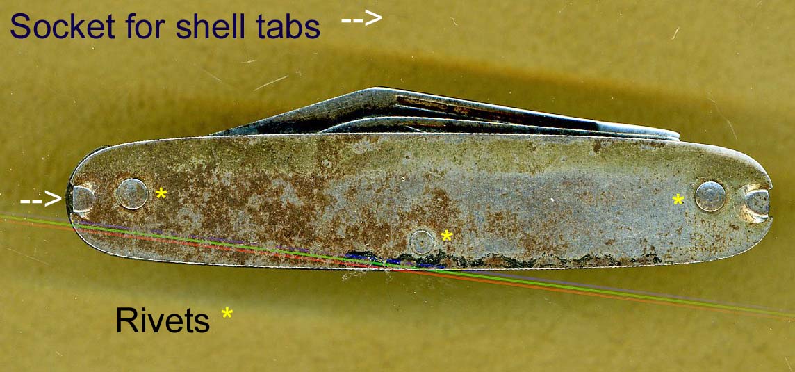

Here you see the tab of the pile side shell that has been loosened from the knife by the tip of this corkscrew.
In this last picture you see the various parts of the knife disassembled with the exception of the mark side shell and plastic, which were missing to begin with.
Instead of having a frame this shell handle has three liners of steel (don't let the brass color throw you, they are steel), two springs, & two blades which were held together by three rivets. This formed the functional portion of the knife. The shell handle on the outside was for the purpose of making it fit the hand better and look more like the customers expectation of a pocketknife. With the exception of comfort in the hand, the shell handle knife, (excluding any damage), is fully functional without the shell handles.
There you have a quick anatomy lesson of the shell handle.
I hope you find it helpful.

In my experience the tabs are the weak point if you’re looking to disassemble this style of knife. The tabs are extremely thin steel/tin and they seem to break quite often during disassembly/reassembly. Once the tab is broken I’m not sure there is a way to repair it. I guess you could solder a new tab in place but the heat would likely affect the handle material.jerryd6818 wrote:Au contraire mon ami. An Imperial shell handle in your hand would disabuse you of this prejudice. You can't be a piece of weak crap and last for 70-80+ years/Edgewise wrote: I suppose the tabs were the weak point of those knives.
The design itself is fairly straight forward but in my opinion it wasn’t developed with serviceability in mind. It was a cheap, inexpensive way to attach handles to a knife. It’s functional for sure but I view it as a one time use sort of thing.
Hey … it’s a pocketknife for gosh sakes. I’m not selling the Mona Lisa….Bullitt4001

The tabs are a weak point if you are trying to repair the knife, especially if you take it apart more than once and try to reassemble it. You are also correct that it was not developed with serviceability in mind. The same is true of the Swinden key system that Schrade used. They were not easy to repair, but the manufacturing process was so cost-effective they could easily afford to give customer a new knife. Replacing the knife was far cheaper than paying someone to repair it; that would be true of a shell handle Imperial as well as a Swinden construction 34OT.Jeffinn wrote: In my experience the tabs are the weak point if you’re looking to disassemble this style of knife. The tabs are extremely thin steel/tin and they seem to break quite often during disassembly/reassembly. Once the tab is broken I’m not sure there is a way to repair it. I guess you could solder a new tab in place but the heat would likely affect the handle material.
Maybe it is sort of a one time use knife that cannot be repaired, but if the knife lasts for 40 years or more, who can really complain about that?

I have never seen an Imperial shell handle that had rivets in the handles.
I have seen a couple of lower-cost German and Japanese knives that had a hollow bolster, and it was pinned through that. But they did not have true shell handles, just a shell-like bolster with solid handles.
But, as I am relearning ever day, there is probably an exception to every rule.

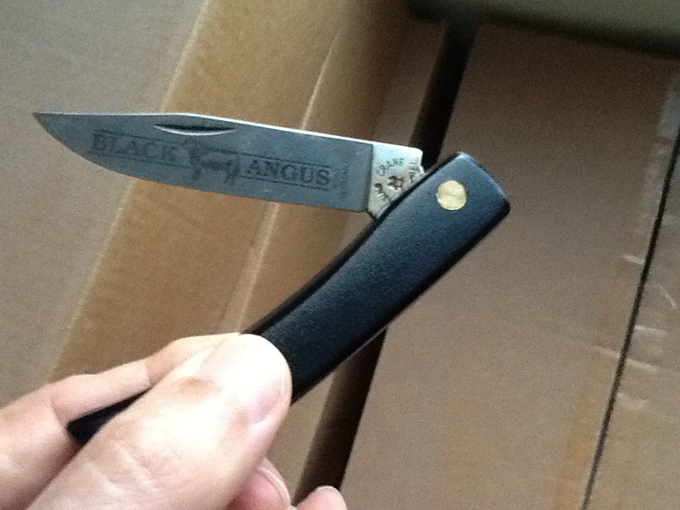

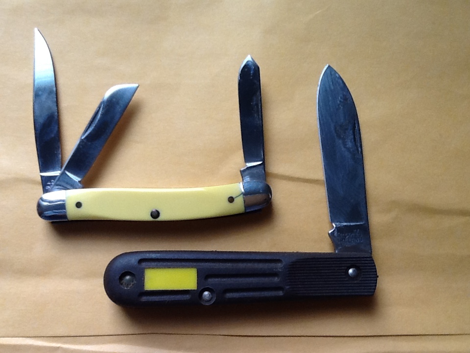

These are the Imperials I was curious about. I thought they might be a plastic slab riveted on. But I’ve been told they are wrapped in celluloid like the one in Dales post.
- Dinadan
- Silver Tier
- Posts: 3640
- Joined: Sat Dec 29, 2012 2:34 am
- Location: Coastal Alabama
Re: Anatomy of a Shell Handled Knife
I have a couple of shell handle knives that have rivets in the scales. I think the rivets are just ornamental. Here is one with the wrap missing from one side.
A shell handle knife, by definition, is going to have the tab construction. I have never seen one without the wrap, but if it were bare metal it would still be a shell handle knife. I think.Or in other words. Does the shell handle refer to the metal with the wrap? Or the general construction with the tabs?
