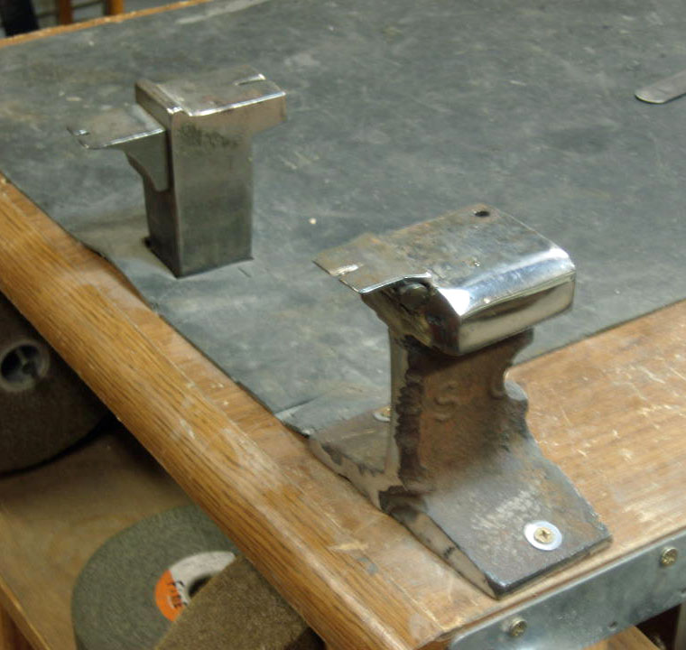

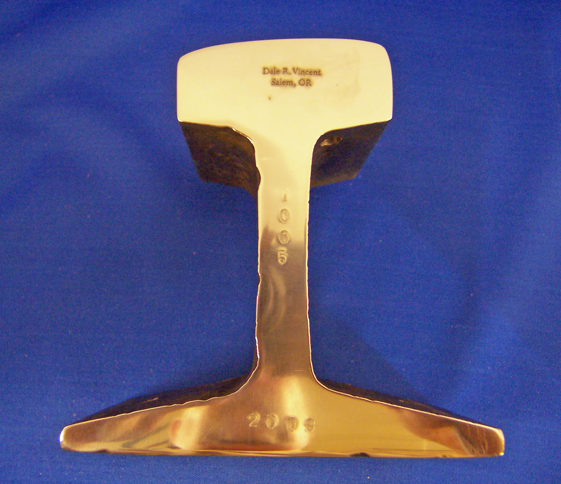

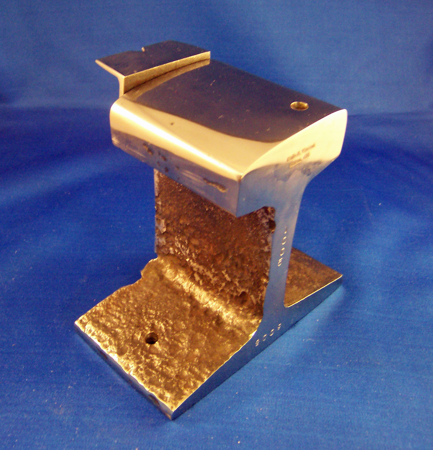

I bought my first steady. By the time I paid shipping I paid nearly $300 for it.
Since then I have come up with a much less expensive alternative. I make them.
I have sold several in my AAPK store, though I don't have any completed currently, though I do have one or two in the works.
I will get some pics and post them later.

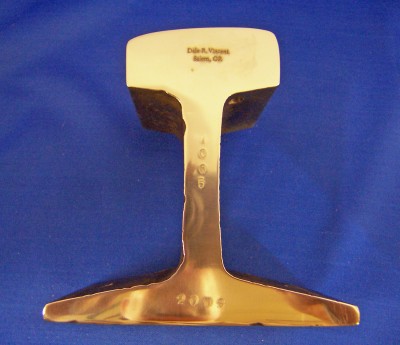

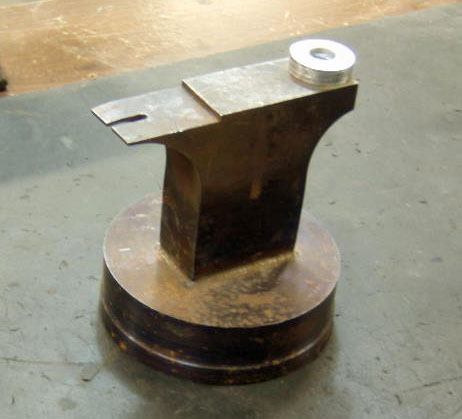

Here are pics of some stiddys I have made in the past.

Is that made from a piece of I beam, Dale?
What is the height?
What is the width of the base?
..... Joe
What is the height?
..... Joe

looks like early narrow gauge rail stock...mining use maybe.

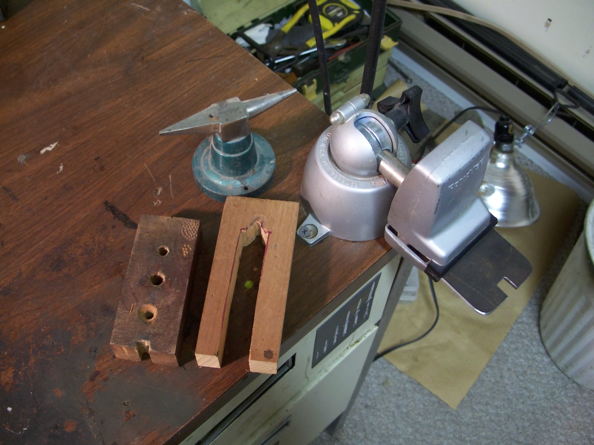

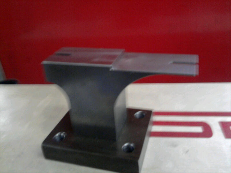

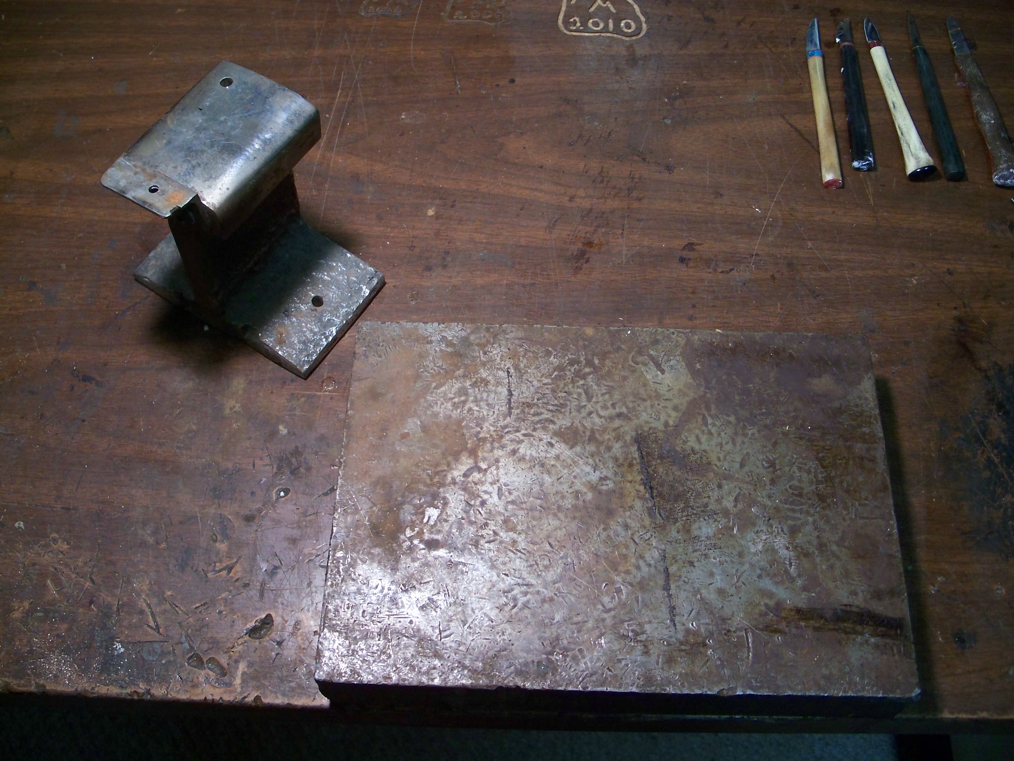

I am so with you on the home-made crap. It's how I've been getting by for years. I've got some pictures that I hope to explain and a diagram scanned in from a book that is being used to fashion the bench anvil that I'm told will be delivered TOMORROW! (YES, I'm a tad excited about it!) Let's start with the pics: (NOTE: one pic is just a block of very hard wood with a couple of holes in it. (Cumaru-S.American Chestnut) I use it for an anvil most times when I drive a pin out of a nickel-silver bolster to avoid scratching it.)
As you can see, one picture is simply a couple of small anvils from Harbor Freight with a few pieces of hardened metal in the plastic box with them. A quick trip to the welding shop and my friend can put these together in any number of configurations and then the rest is up to me and a cutting wheel and grinder. Another is of the small hammers I use for peening. Yes, they're small and I really think that it helps a lot when peening nickel-silver expecially on MOP. Light tapping helps heat up the metal while working it and makes it bend into shape easier (my opinion). The other pieces are blocks of steel begged from my friendly welding shop with some welded together and finally is the last picture which is a scan of the one I'm having made. These dimensions were fed into some huge computerized CNC machine and it has been making the piece from a large chunk of A4, which I'm told is a tool steel. I should be able to show pictures of it soon.
And while I'm still typing....Dale, Sweet work on the home-made jobs! I really like the sharp point on the anvil head (I can picture many handy occasions) and the add on is brilliant. Gary...Great pictures! That's what I'm talking about. Those were probably putting knives together a century ago. Too cool!

I did buy my first steady several years ago and it cost me nearly $300 by the time I paid shipping. If I knew then what I know now I would not have spent that much money.

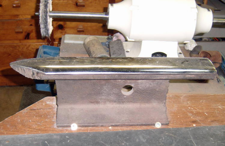

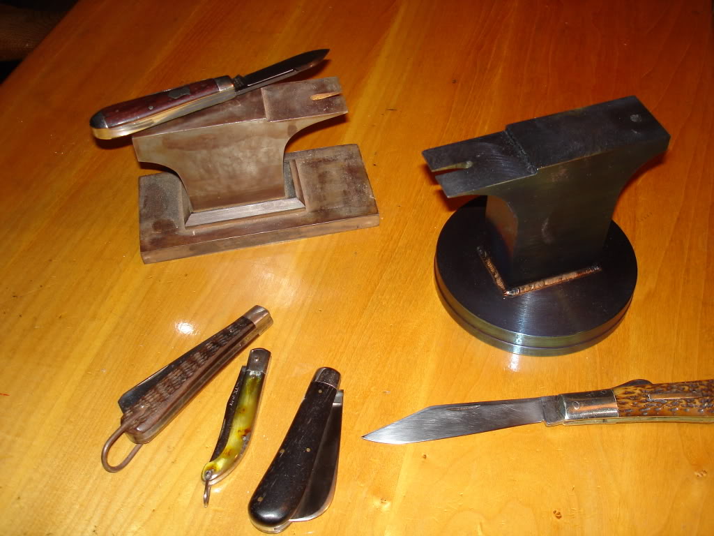

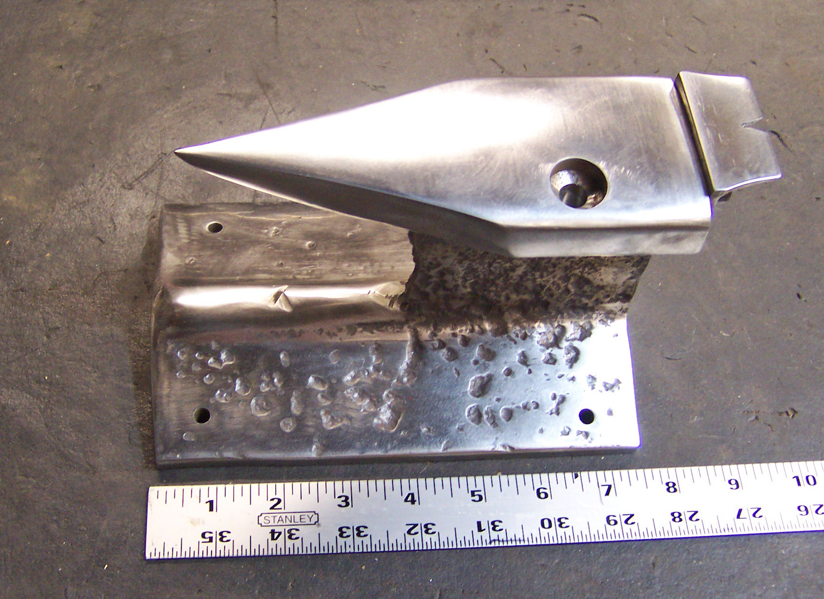

It works very well. The aluminum disc is what I use to peen down the inside scale pins. The aluminum is soft enough that the pin will dent the aluminum and won’t flatten out the head I have spun on it. But it gives enough resistance to flatten out the little bit of pin on the inside of the liners.

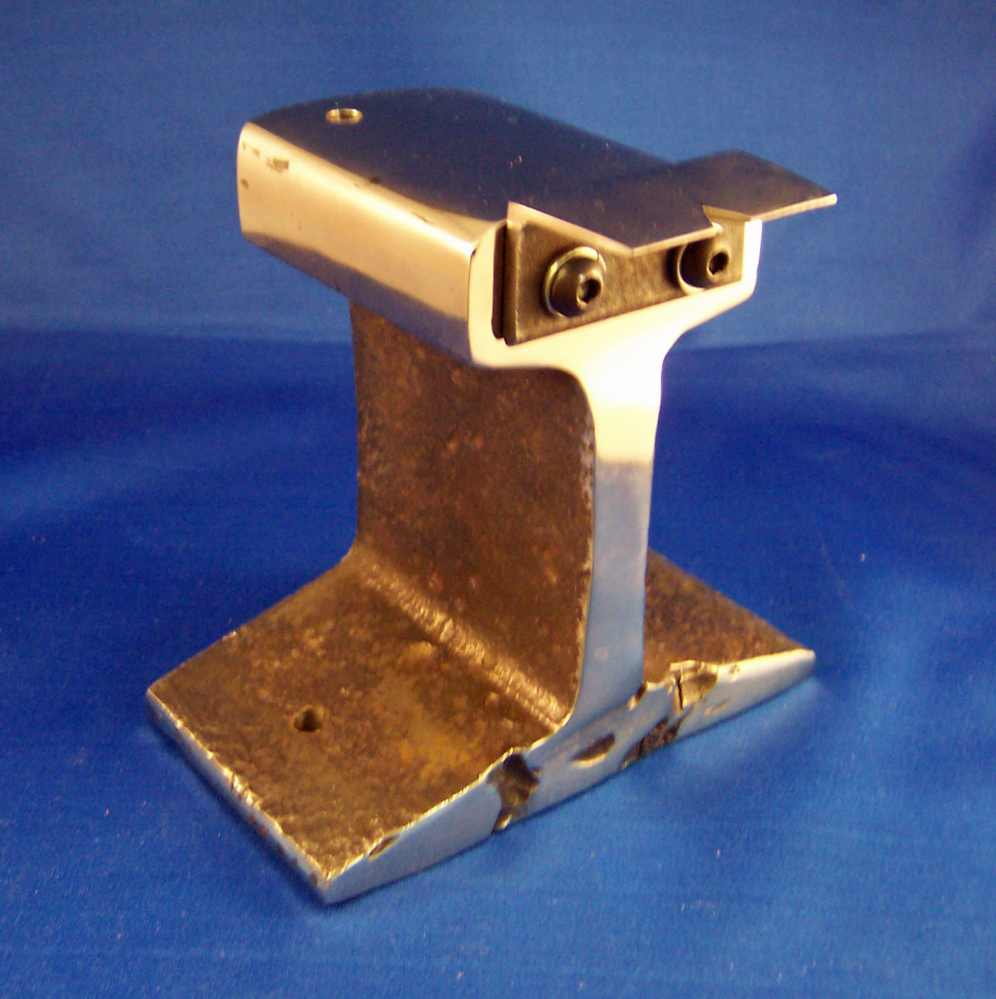

A year or so after I got the first stiddy I was corresponding with some of the guys who had worked at Camillus. One of them (I don’t recall which one at the moment, but I think it was Tom Williams) sent me one of the original stiddys that they used at Camillus. As you can see it looks a lot different than the manufactured one. It sits in a socket cut into the top of a workbench.
The Camillus stiddy got me to thinking that a useful stiddy didn’t have to look like the first one I bought. I already had a small anvil that someone had done a nice job of making from railroad track. It does not rebound like my Hay Buddon, but I wouldn’t want to forge on it anyway. I just use it when I need a hard surface to pound on in the shop.
This is the result of my first attempt at a stiddy. I welded the horn on a piece of railroad track. I didn’t have welding rod with manganese in it so the welds were pretty ugly & I am way out of practice with a cracker box. I sent this one to Johnnie Fain and he used it until he died in 2009. I think he had it for about 2 years. Johnnie couldn’t get around very well, so he did most of his knife work in his easy chair. He had a large plastic cutting board that he bolted the stiddy to and a small vise bolted onto it as well. Johnnie told me the stiddy really worked well. Annettee insisted on sending it back to me after Johnnie died, so now it sets in my bench and it is usually the first one I use.
The one I made for Johnnie is at the corner, the one to the left is the Camillus stiddy setting in the socket in the bench.

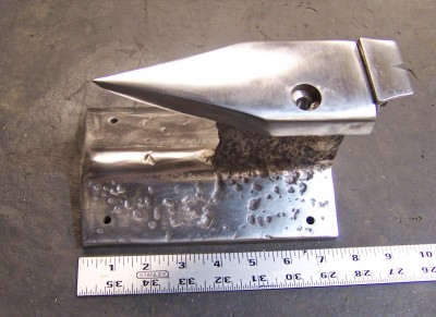

After welding the first stiddy I started attaching the horns with ¼” screws. The horn can be removed and replaced if a cutler decides they want to design a different horn. The top of the horn is offset from the top of the stiddy for use in crinking blades. They usually weigh about 4 to 7 lbs. depending on the gage of the track and the length of the stiddy. If you are a handy at all with a torch or have a good saw you could cut your own track and make your own stiddy just from looking at my design. I usually polish them up so they look pretty when they are new, but they don’t stay that way long when you start using them. The smaller ones I usually mount to a bench for better stability. If a guy cuts them at about 8” in length you probably wouldn’t need to screw them to a bench.

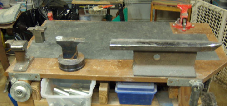

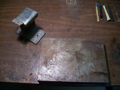

This is a picture of my stiddy/project table.
The tiny vise on the left corner is the one Johnnie had mounted to his cutting board.
He did some nice work setting in his easy chair.

I've got the guy who made this one for me considering making more. IF he decides to do it, I have no idea what he will charge. But anyway, here is the Stiddy (I believe that's what the old timers called them) that I've been waiting months for. A4 tool steel, which I believe is some form of stainless and made exactly to the specs shown on the drawing I posted earlier. I can't wait to mount it to the bench and start using it.

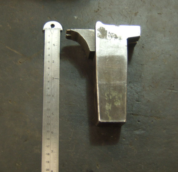

Here's mine - i had it made in about 1987 in Texas. Cost me over 300 bucks back then. It has served me well - as you can see, all the edges are still nice & sharp - Tom

Tom, Your's looks like it was made to the same specs as mine. I can see that the pictures of mine give the illusion of something less than straight lines and smooth surfaces. That isn't the case. One difference I can see is that yours is welded on to the base and mine is held on with two large bolts countersunk through the base. Other than that it looks like we may have pulled our plans from the same book.
Would you know what steel it is made from?
Looking back a page, Orvet's appears to have the same design/dimensions. Have these ever been made comercially?
I hear ya Kaleb. The guy is considering making more. Kind of like a definite maybe. I did some very heavy bartering to get this one. I have no idea what he may charge if he decides to make any more.

Re: Got a Question about your bench anvil....
I had a machinist I know make this one for me, I took him the plan yesterday and he sent me this pic today. I will pick it up tomorrow and post better pictures, he asked me if anyone would be interested in one as he has it programmed into his CNC, I had him make the base seperate and it is held on with 2 machine screws.
- Attachments
- steady.jpg (44.53 KiB) Viewed 4778 times
