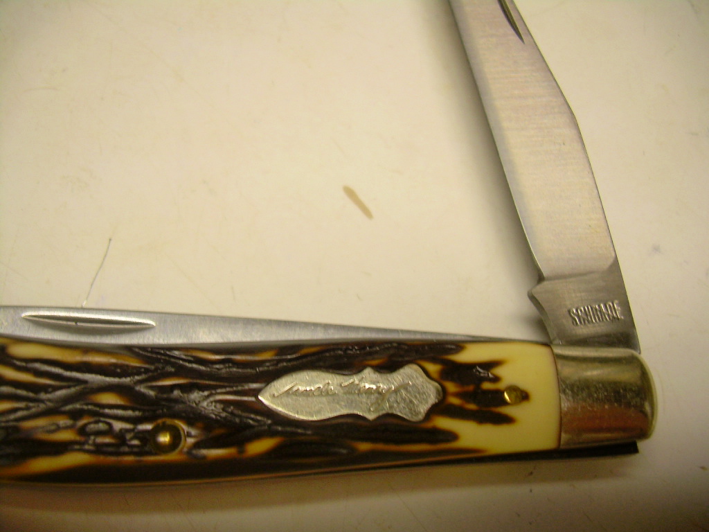

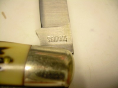

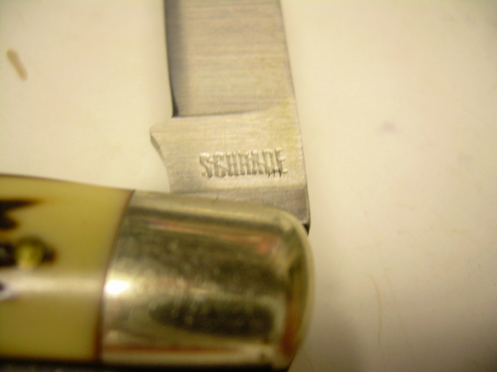

There is such a thing as seconds but I am not sure they were intended to be sold directly to the public but they sure ended up being sold second market or whatever. Also the problem is you dont know what you have unless its in your hand with something like that. You should really know or trust the seller before you spend your money!
Here is a tang marking I still cant figure out?? Although there is no other markings I know its a import from the quality but that tang is,well????

Tom, whats up with the one I have pictured above? Can you help me out with that? I know its a import.
I knew they sold those seconds to employees but didnt think they were sold directly to the public?
Gino
Gino

Sorry Gino...That's not a Schrade USA
Font is way wrong on the Tang Stamp

gino
- Posts: 8371
- Joined: Sun Feb 28, 2010 3:50 pm
- Location: Pa
Re: Scharde seconds ??????
I was sure that it was a import but what would be the reason for those marks thru the Schrade ??

Chinese knives probably have rejects also. Yours (Gino) is Chinese. In addition to the different font, the U.S.A knives always had USA stamped, unless it was ground off. If it was ground off, as it was on some seconds, all of it would have been ground off. American Schrades always say USA on them. There are presently a great deal of USA seconds, mismatched blades, knives with no shield, short runs unfinished, and forty eleven other oddball combinations now being sold by the folks who attended the bankruptcy auction. Also, Taylor commissioned, and continues to commission knives stamped "Schrade Walden/NY/USA from Utica and Bear and Son, and formerly from Camillus between 2004 and 2007. These are not Schrades as such, but they are USA knives. They are better than the imports. Some are excellent. These are hard for newbies to recognize. I think I can probably spot all of them by now, from experience. Before the Schrade bankruptcy, Camillus, Ulster and Imperial (in RI) all traded parts, jobs, and even employees with the Schrade factory from time to time. Confused yet?
