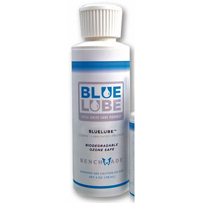

- MITCH RAPP
- Posts: 4184
- Joined: Sun Jul 24, 2005 5:49 pm
- Location: Southern California
Re: Basic maintenance tips?
- Attachments
- BM983900.jpg (14.97 KiB) Viewed 2641 times
MITCH
