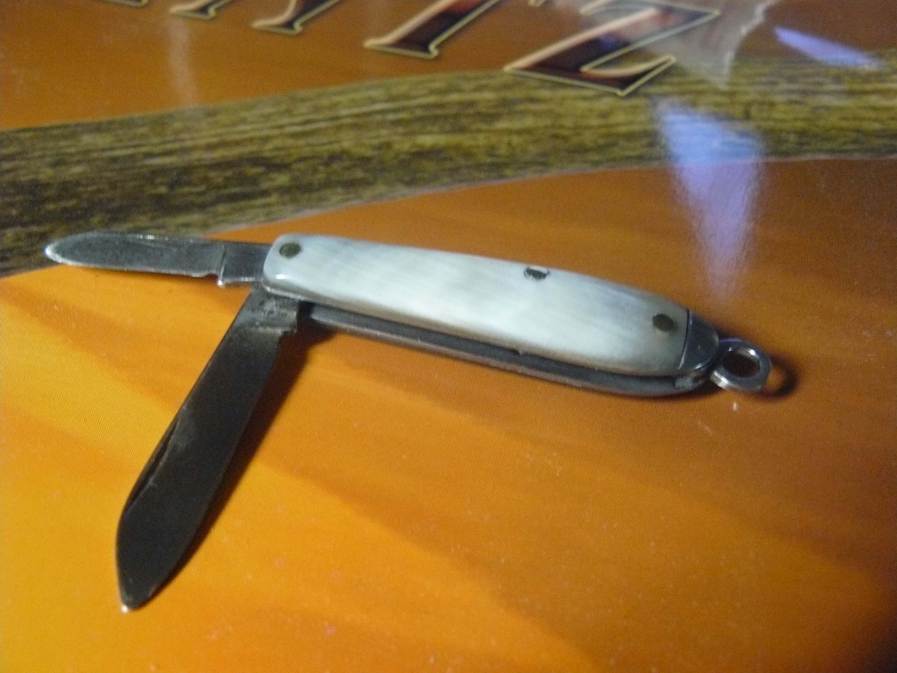

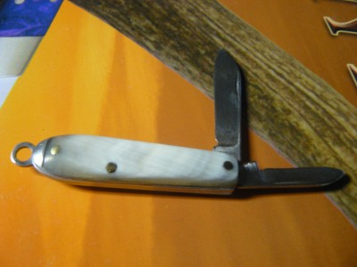

Thanks Dale, I put these horn handles on this mini knife, it had some sort of bone on it,broken of course.
I got to this point and the gap at the bolsters seems too pronounced. The bolsters are pressed which doesn't give them a real square bottom on them.
I undercut them a tad trying not to get too much gap down there but still not happy with it.
Any suggestions.
cheers Gary.

ringergary wrote:Thanks Dale, I put these horn handles on this mini knife, it had some sort of bone on it,broken of course.
Any suggestions.
cheers Gary.
Gary~
With your next knife, do as Dale stated above "undercutting" at a slight angle.
But leave the scales slightly longer than you need.
From this point it's all sanding by hand. Stay away from the sander.
Wrap some medium to fine sandpaper around a perfectly square block of wood.
Take a few passes with the paper on the undercut edge. then see how they fit.
Keep making passes till they fit like a glove.
Like Dale said, these knives are not perfect. So custom fitting is needed.
Remember, your working on old knives.
A slight gap at the scales and bolsters doesn't matter.
It only matches the ware and age of the folder.
Use a sealer to fill in any gaps to keep moisture away from the underside.
If you are making brand new custom show pieces then that's a different story and you will have to be precise.
Your mini knife posted looks fine to me.
The knife doesn't even look as if the scales were replaced.
This is what you want when restoring an old knife.
Fix what's wrong but keep that aged look.
Excellent job............
