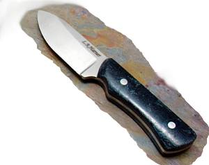

El Lobo
Posts: 3036
Joined: Tue Dec 14, 2004 4:47 pm
Location: Arizona, right here in the U.S. of A.
Post by El Lobo »
I liked those as well. As a matter of fact I know the guy who owns this one... :mrgreen:
Bill
Harner Mycarta.jpg (17.12 KiB) Viewed 3913 times
