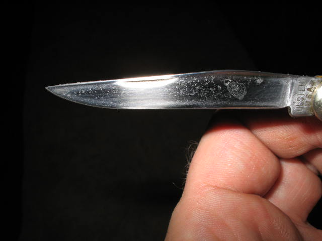

I know People are going to scoff at this but the only way that I know to make the blade look new again is to use sand paper....Depending on the severity of the discoloration,I start out with 6 or 800 and work my way up to 1500.When I get to the 1500 I apply MAAS{polishing creme} directly with the 1500 sand paper...This is a technique that I have used,I am not saying that this is what you should do...A lot of collectors are against buffing of any sort.
PS,I have also had descent results using my dremel with a felt wheel and polishing creme..
PSS,This is a knife I'm still working on,sorry I don't have a before pic,but it was really, really bad...the next one ,I will get a before and after pic.
