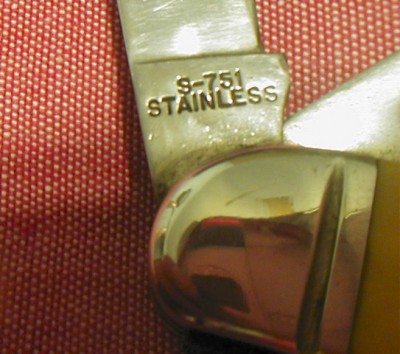

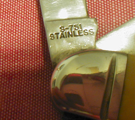

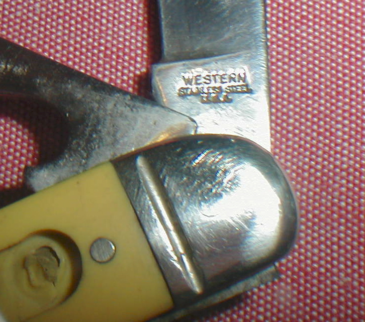

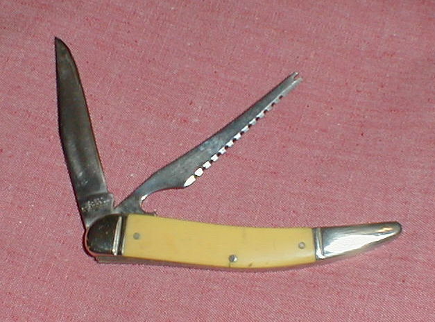

I bought this Western fish knife at a flea market yesterday. The hook sharpening stone is broken and much of it is missing. That's probably why it was only a dollar but I thought it was a great buy. If there is a way, I would like to replace the hook stone. Can these stones be purchased? Has anyone ever made one from a wetstone? How would you cut and shape a wetstone. I was able to date the knife to between 1967-1977 based on information I was able to find on Western knife forum [on this AAPK site], but what does the S-751 indicate. My quess is the type of stainless - does anyone know for sure. Thanks for reading.

S-751 is the model number.
I see the knife in the 1968 Western Catalog as reprinted in the back of Harvey Platts’ book; The Knife Makers Who Went West.”
Knife Makers indicating the steel used in a knife, like BG-42, VG-10, ATS-34, etc, is a fairly recent phenomenon, not seen often until about 20 years ago or so.

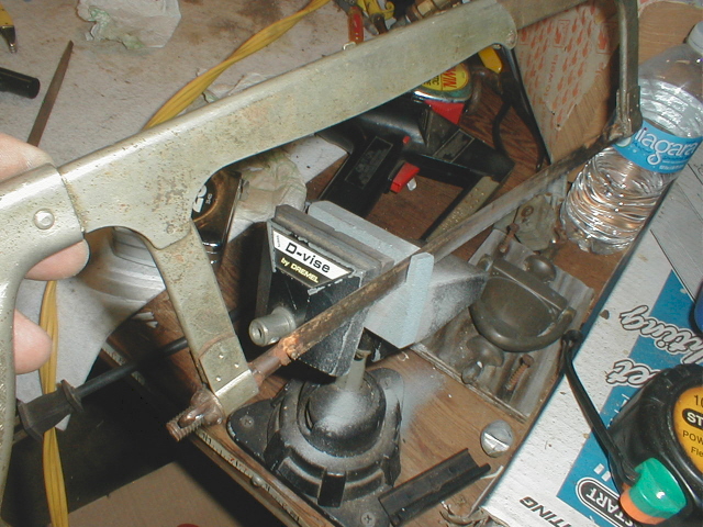

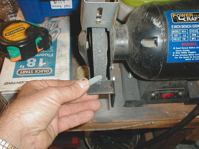

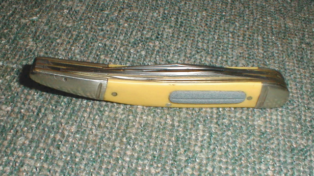

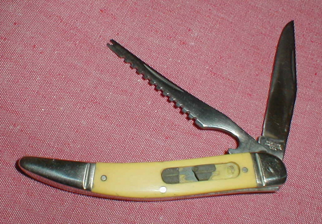

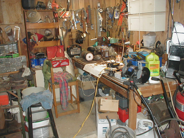

I custom made a replacement hook sharpener and it turned out to be cheap and easy. I have attached pictures. The first picture shows a neat, clean, well organized work area essential for the project. I found an chunk of whetstone and gently clamped it in a vise. A hacksaw was used to slice off a piece [ slightly thicker than is needed]. The whetstone cuts and grinds as easy as sandstone. Next, I rough shaped the piece on a grinder then fine tuned it with a file. A triangular file was used to make the hook slot. I used a couple of drops of clear glue to hold the stone in place. I thought that a whetstone would be as difficult to work with as a grindstone but it isn't.

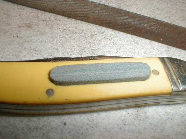

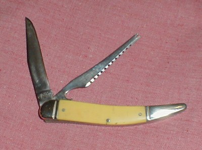

My last post showed the hook sharpener just resting in the handle of the knife. The picture in this post shows the finished job. I sanded off the stone a little more to make it protrude above the handle the same as the original, then I rounded off the top edges to match the original.

That looks just like new. Great job!almyjmoore wrote:My last post showed the hook sharpener just resting in the handle of the knife. The picture in this post shows the finished job. I sanded off the stone a little more to make it protrude above the handle the same as the original, then I rounded off the top edges to match the original.
