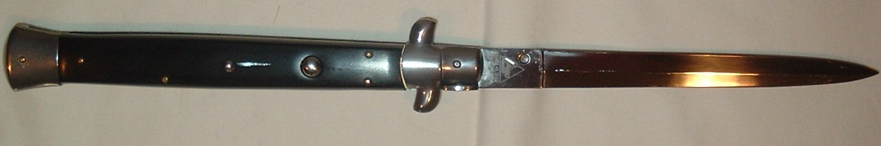

- big monk
- Bronze Tier
- Posts: 5718
Re: Switchblades?
whitebuffalo58 wrote:Do we not have a switchblade forum here?
Most of the chat,on switchblades,has been in this forum"'General Knife Discussion"'_____-I only have this one___Johnnie Rotten,has a nice collection,and pointed me where to find this one !!!
MONK****

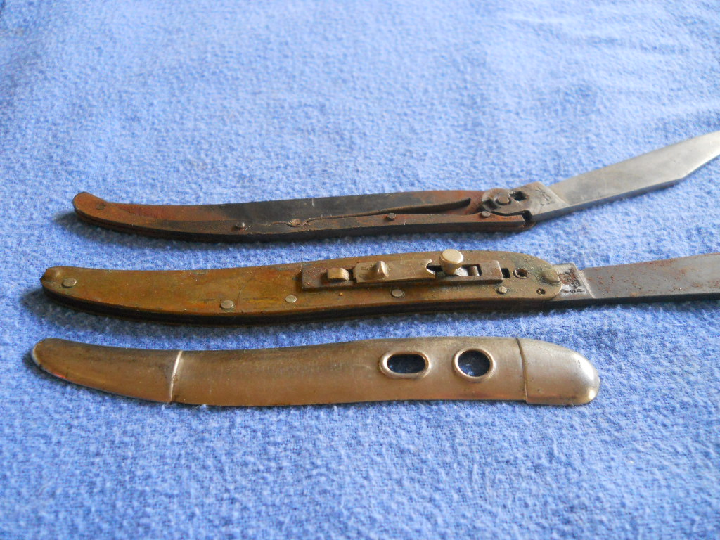

I have a few of the Imperial autos with shell handles. I'll try to get some pics up one of these days.
What i'm looking for right now are blueprints of some of the older autos. Springer, Presto, SureSnap, EdgeMaster, Imperial/Hammer Brand and some of the other German and Italian makers. I picked up a box lot of parts knives and not sure where to start with 'em.
I havn't tried a Google search yet, thought i'd try here first. If anyone can point me in the right direction, it would be greatly appreciated. WB

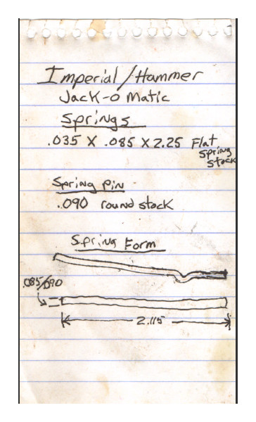

WB, pm me your address and I will send you a copy of this.
I don't have the angles dimensioned, so you will need to bend them to match this form.
I used a hand saw blade for the spring stock. It needs to be cold formed because it's
tough to get the hardness correct if you don't have a RC tester.

PM sent Joe, thanks! I had wondered about using tines from a good quality leaf rake for the throw springs. They're essentially tempered to a spring hardness.

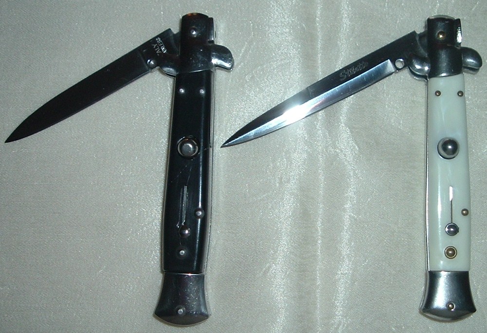

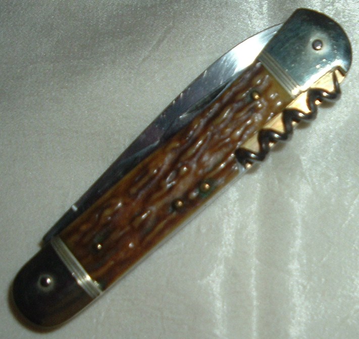

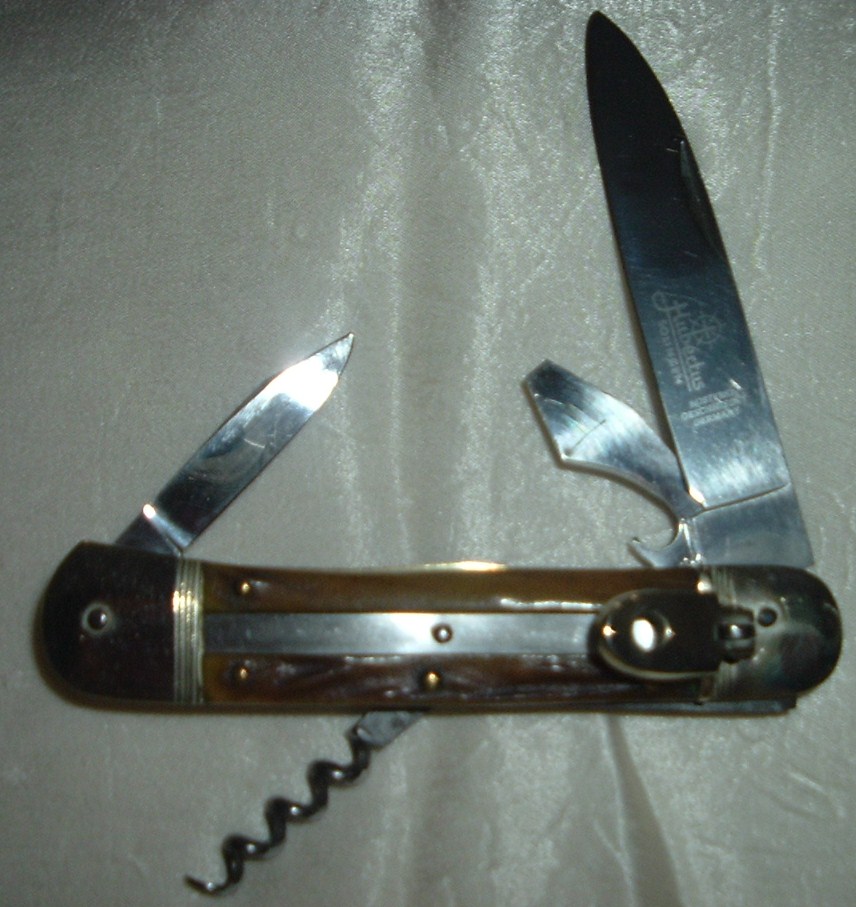

- whitebuffalo58
- Posts: 2743
- Joined: Tue Aug 17, 2010 2:35 am
- Location: SW MO Heart of the Ozarks
Re: Switchblades?

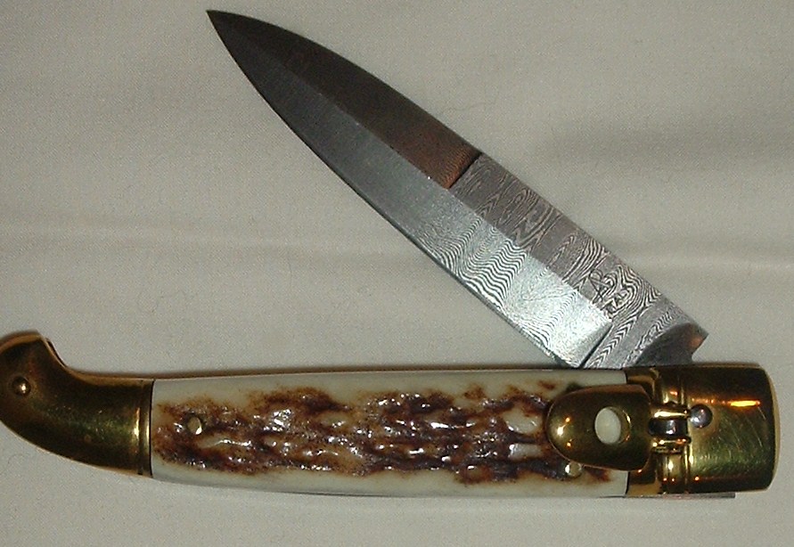

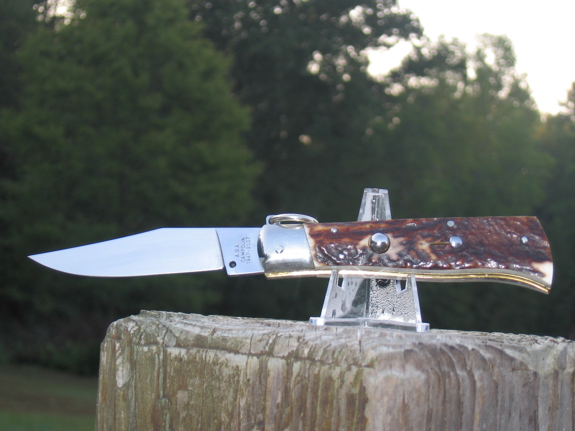

Very nice wazu! A couple of those are very similar to ones I have in this repair/rebuild bunch.
On the Hubertus, is the primary the only auto blade? I like it best!

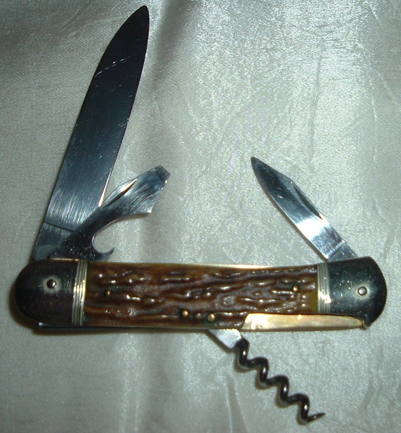

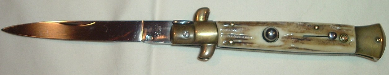

- IMBand
- Posts: 2915
- Joined: Mon May 16, 2011 5:12 pm
- Location: S.E. Alaska
Re: Switchblades?

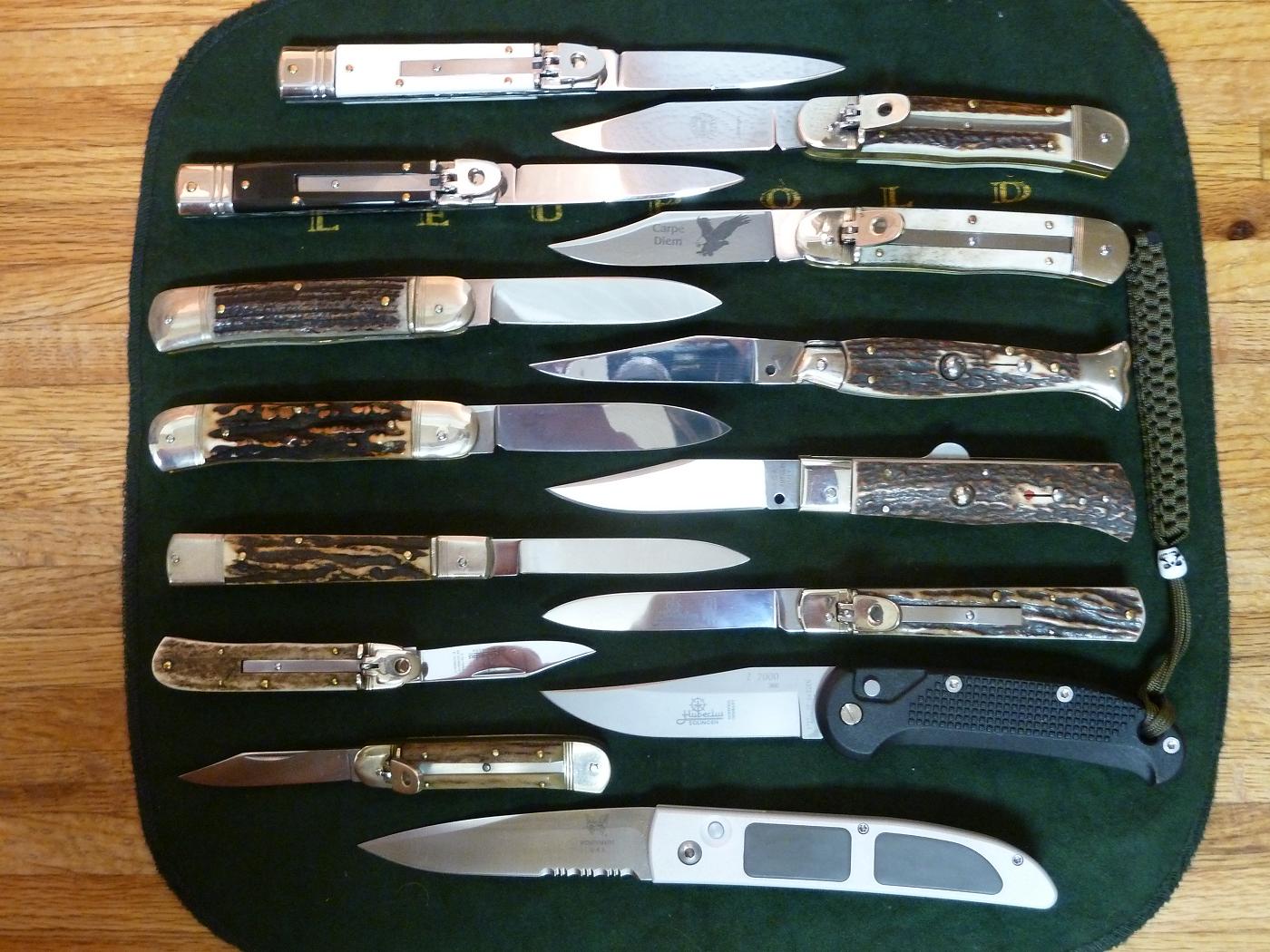

I have posted this before....................but here are most of mine.
IM
IM

- Posts: 2390
- Joined: Thu Oct 29, 2009 9:58 pm
Re: Switchblades?
The primary is the only auto. The knife is a beauty though.
whitebuffalo58 wrote:Very nice wazu! A couple of those are very similar to ones I have in this repair/rebuild bunch.

IM, what can I say but WOW!

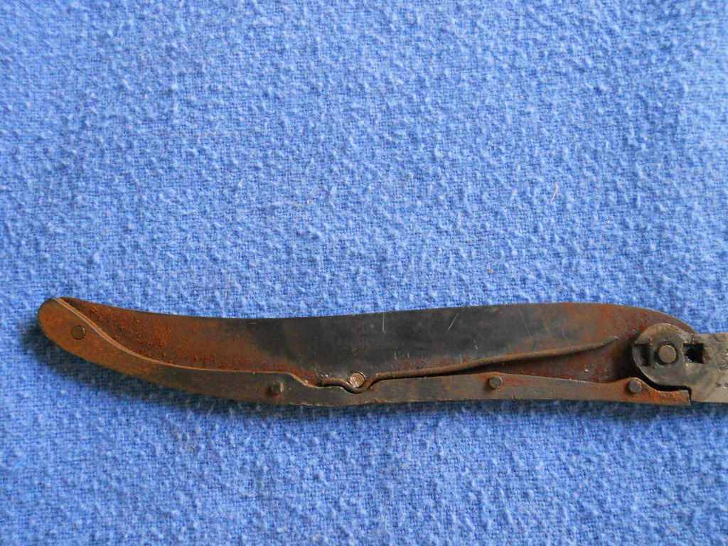

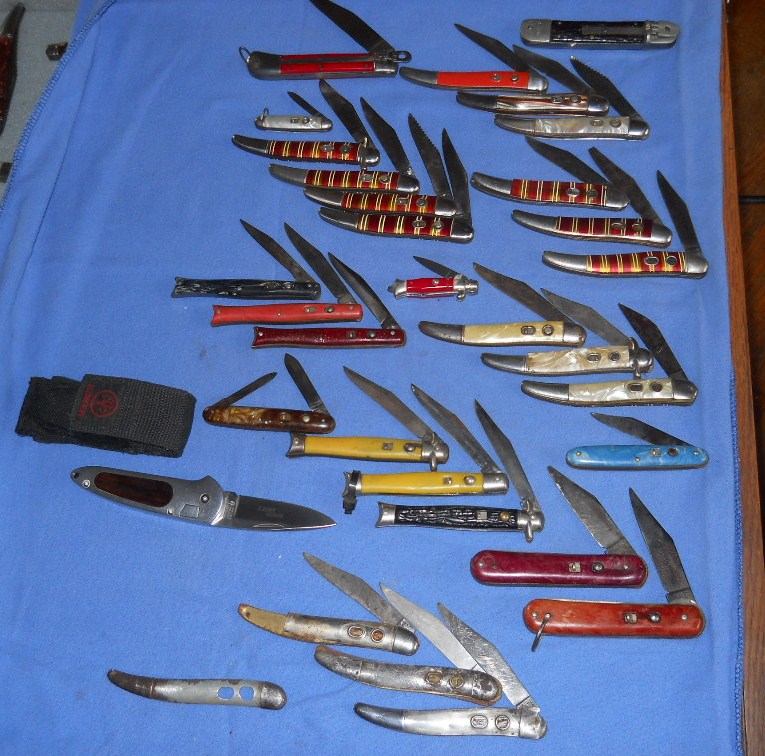

In this bunch of basket cases, there is one old Solingen Cut. Co. Springer. If I can get that knife to look even half as good as these others, I will be a happy man!!

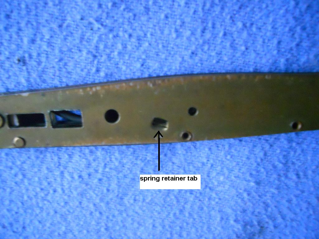

- Joe Dirt
- Posts: 1747
- Joined: Tue Mar 16, 2010 4:10 pm
- Location: N.C. USA
Re: Switchblades?
Thanks WB!

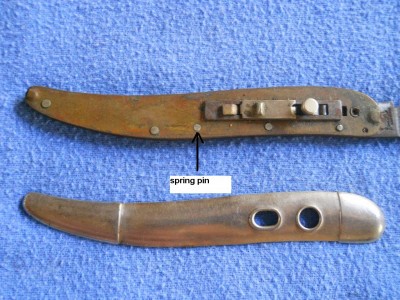

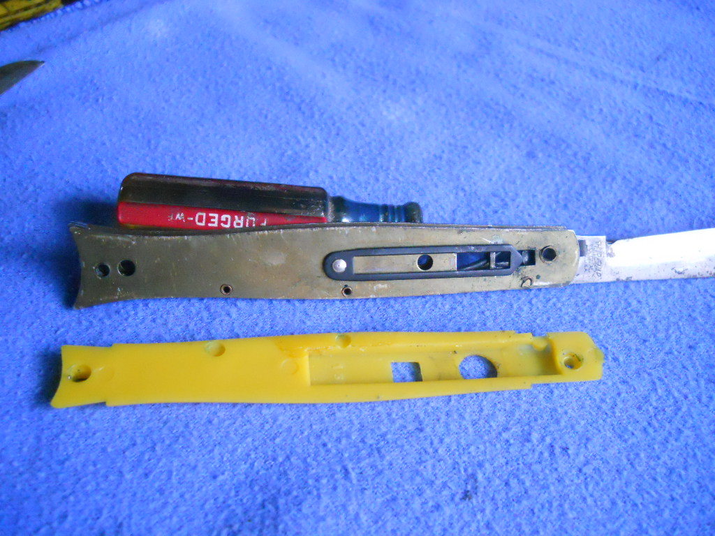

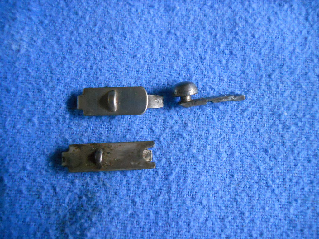

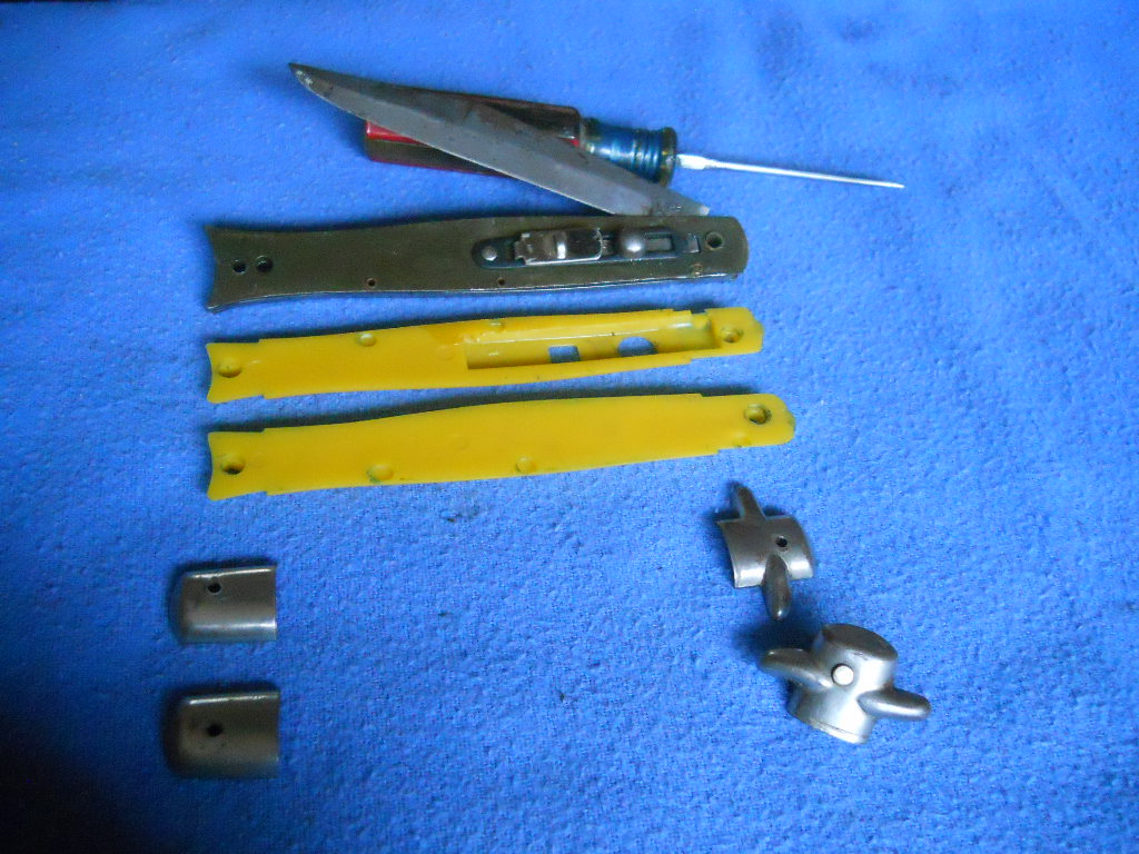

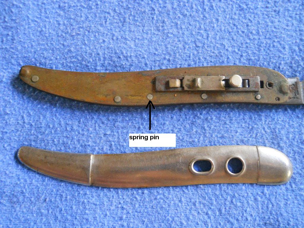

Here's some pics of the button assembly and the spring on the Imperials.
The shell holds the assembly in place.
..... Joe
..... Joe
..... cardboard addicted.....

Excellent Joe! That's exactly what I was needing. Thanks much!
WB
WB

nice of joe..for sure...but....
that style of opening mech is a bear to create...and making scales for that type button is even worst...

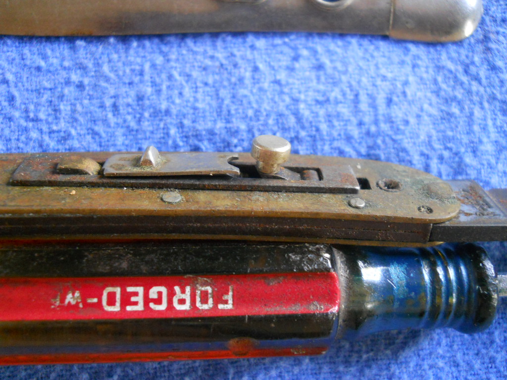

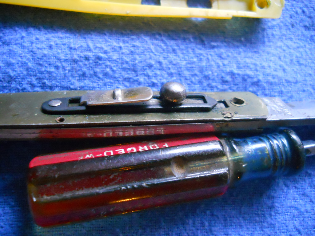

- Joe Dirt
- Posts: 1747
Re: Switchblades?
Gringo summed that up pretty well. It's nearly impossible to duplicate those parts.
The button is bradded to the sheer and the sheer is a maze of compound radius's in itself.
Something I have done in the past is to fill the shell with led solder. This gives the whole knife a
different feel, heavy and a more sold action!
If you do decide to led the shell, it is best to thru pin it. (the tabs aren't strong enough to hold the handles on)
This too will add to the characteristics of the heavier knife.
I'm thinkin I may have sent Orvet a leaded shell, to show him what I was talking about.
Anyhow, if you have the parts, that's how they go together.
I'll take the two yellow Colonials apart soon and post pics of how there assembled. (these 2 combined will make 1 nice knife)
NOT trying to hijack the thread, but I'm in need of the small parts for the Imperials and Hammer Brands.
The buttons and locks are what I need the most. Sooo.... if anyone has any parts or part knives, PLEASE let me know!!
Thanks,..... Joe
Thanks,..... Joe

Colonial makes the Imperials look like Frank B's when it comes to there construction!
EVERY pin is hollow!! Even the spring is held in place by a TAB punched in the frame!
The sheer is of a much simpler design and works exactly the same as the Imperials.
The retaining spring is pined to the frame and there really isn't any reason to remove it.
From the 2 knives i disassembled there were 2 different design slide locks.
Both locks are interchangeable and 1 works just as well as the other.
Here's the button/lock assembly for the Colonial Shur-Snaps.
....... Joe
....... Joe
