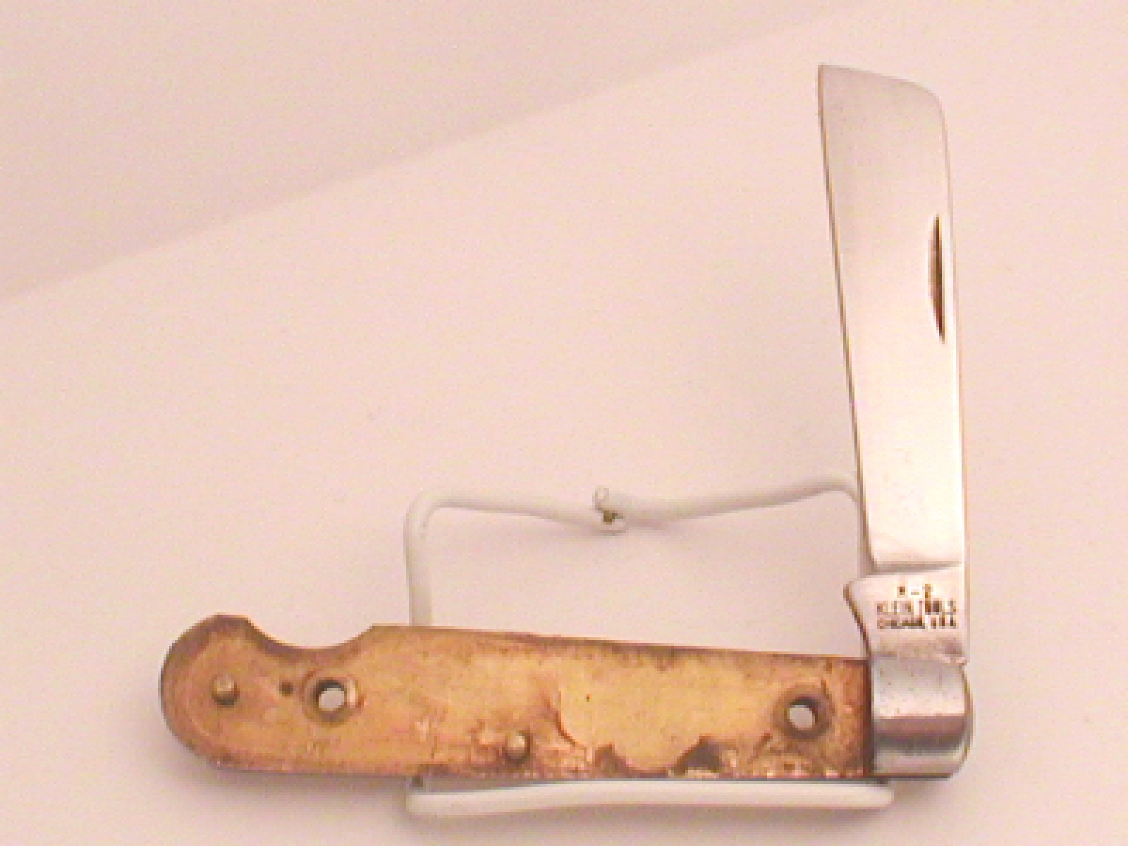

rehandle, filework. i'll post blow by blow if interested.

let's see it Johnnie, it'd be nice to see how others do it too.

Is this what you had to begin with, or were the handles on it before these pictures?

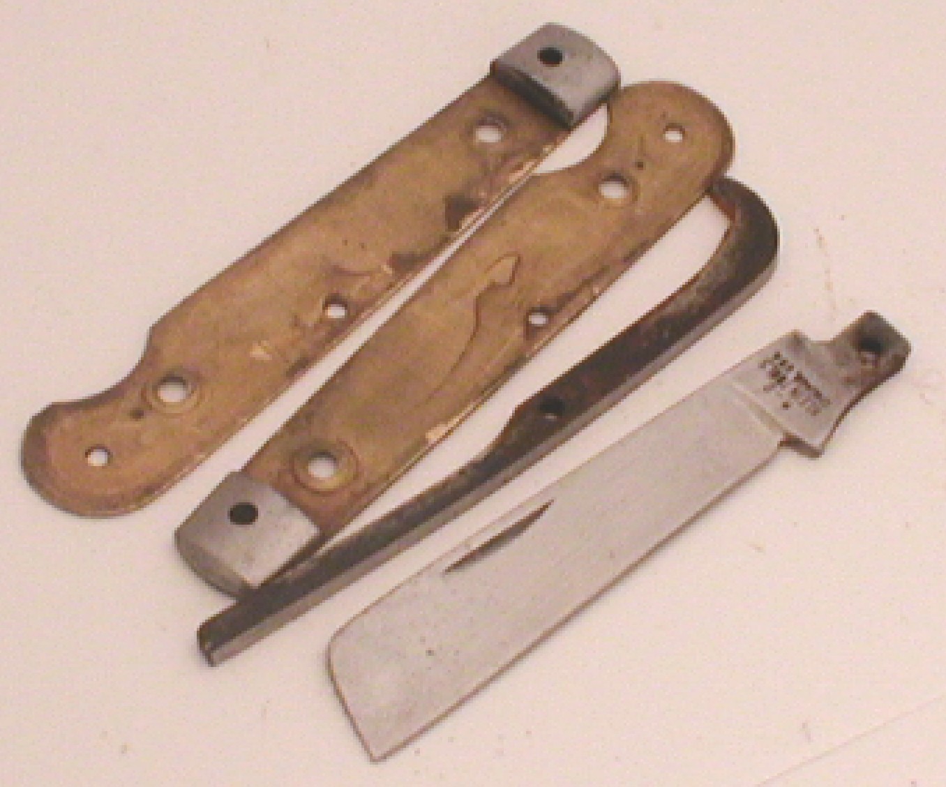

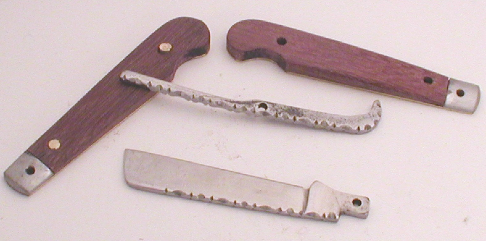

ok, here are the pieces after filework and new handles. the blade and backspring were filed with a small triangle file, small round and half inch half-round files. polished with felt bob and grey pol. compound. i polished the inside of the spring as well. the sides of the springs are polished but still have stains, but that won't be visable. i'm in the process of pinning the handles. the bolster liners were attached with small pins and a tab from the old plastic scales. i utilized the larger holes for my new pins, big pins. re-assembly is next.

Hey Johnnie, where did you learn to file man? That looks fantastic!

thanks kaleb, i was a gunsmith for many years and files play a large part in customizing, repair and fabrication of parts for weapons.

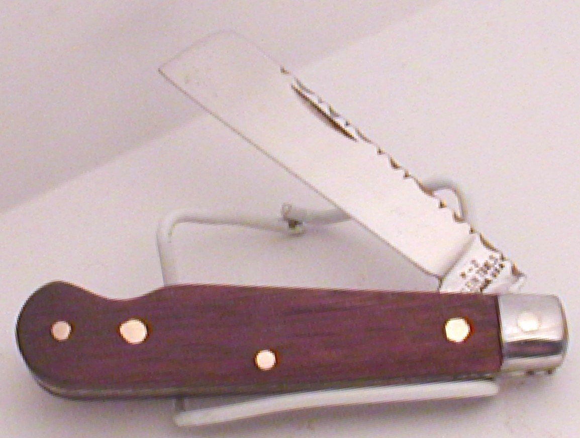

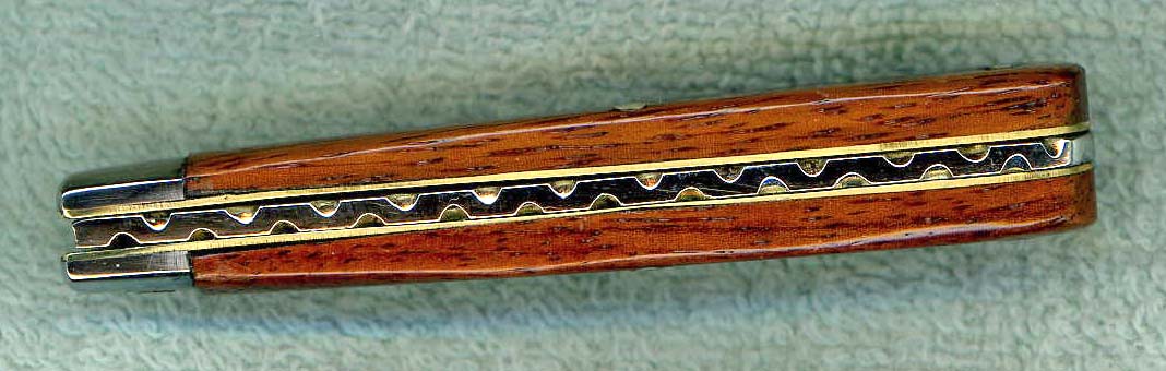

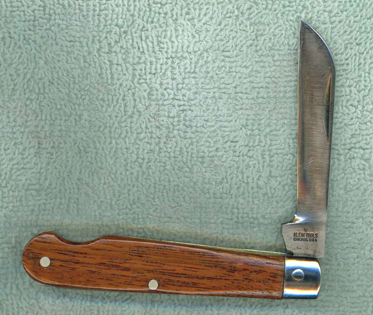

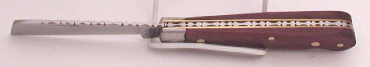

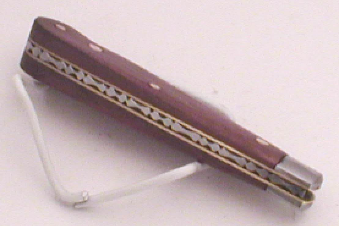

anyhoo, it's finished, here's the pics.
klein 3 1/4" utility.
handle material - purple heart(from jeff jones)
blade and spring fileworked and polished
i only have one kind of nickle rod, and it didn't match the bolsters in color but that's ok.
the original handle pins were very small. i used the holes in the liners where the old plastic covers attached instead and used a much larger pin. just because. pins are hammered not spun. i like hammered pins on this knife. the next one i do will have spun pins and i will photo the tools and steps required.

I think the big pins give a very custom look. I like for my knives to be immediately recognizable as a customized piece. I wan't people that may not be "Knife" people to recognize the difference. You have certainly got that.
I'm glad the Purple heart worked good for you. How many splinters did you get? If you will leave it in the sun or expose it to heat like a heat gun or lamp before you seal it, the color will get darker and deeper.

thanks jeff, splinters? only one and it was major! bled like i was cut.
yeah, the pins set it off. i thought about turnin it into a wharnie but the more i looked at it ...... the blade was in pretty good shape and since i rehandled in wood, almost looks like an original in spriit.
