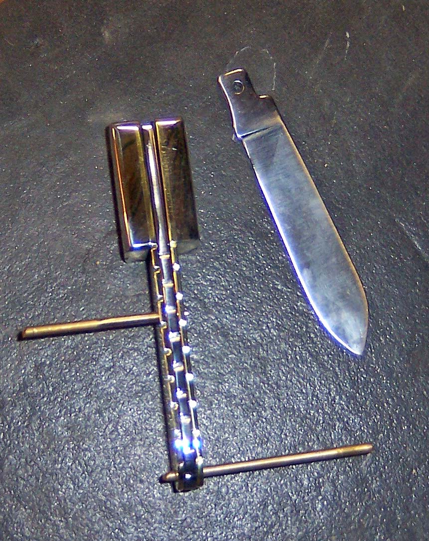

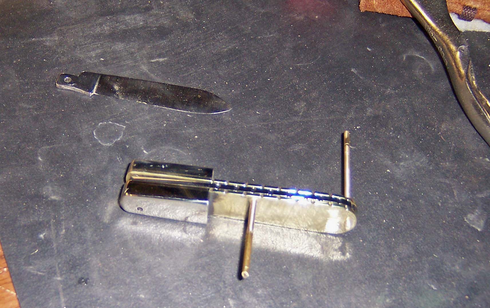

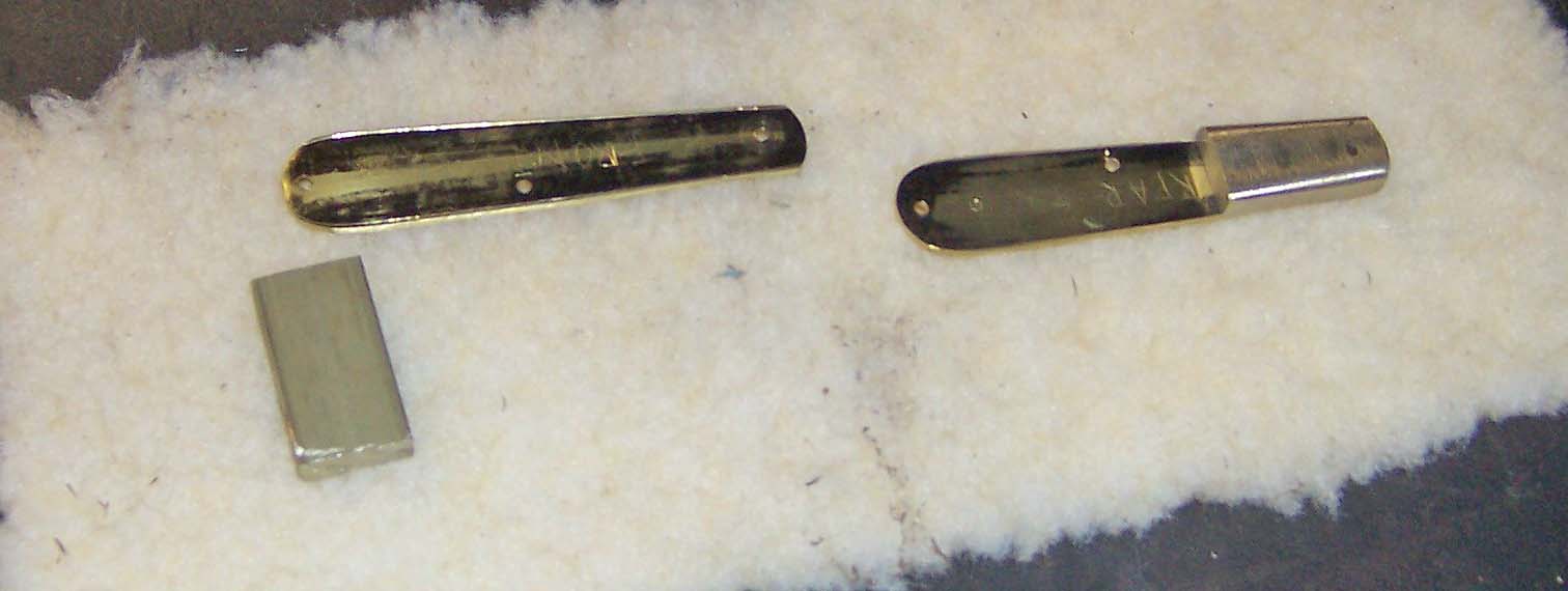

Here is an example of an embellishment job I am doing now.
It started with a Camillus TL-29. I decided I would take it apart and make a single blade Barlow out of it.
The liners were thinner than I wanted so I made new ones. I had some nickle silver bar stock that I used for the bolsters. Did a bit of file work on the liners & spring. I am about ready to put it together, but haven't decided what to put on the handle. I think I have it narrowed down to ebony or stag.
I am taking a vote:
Let me know what you think, ebony or stag?
Here are a couple pics.
I am taking a vote:

- Here are the liners and bolsters in a rough state. One bolster is pinned on, the other is just a piece of bar stock.
- TL-WIP.jpg (75.44 KiB) Viewed 4626 times

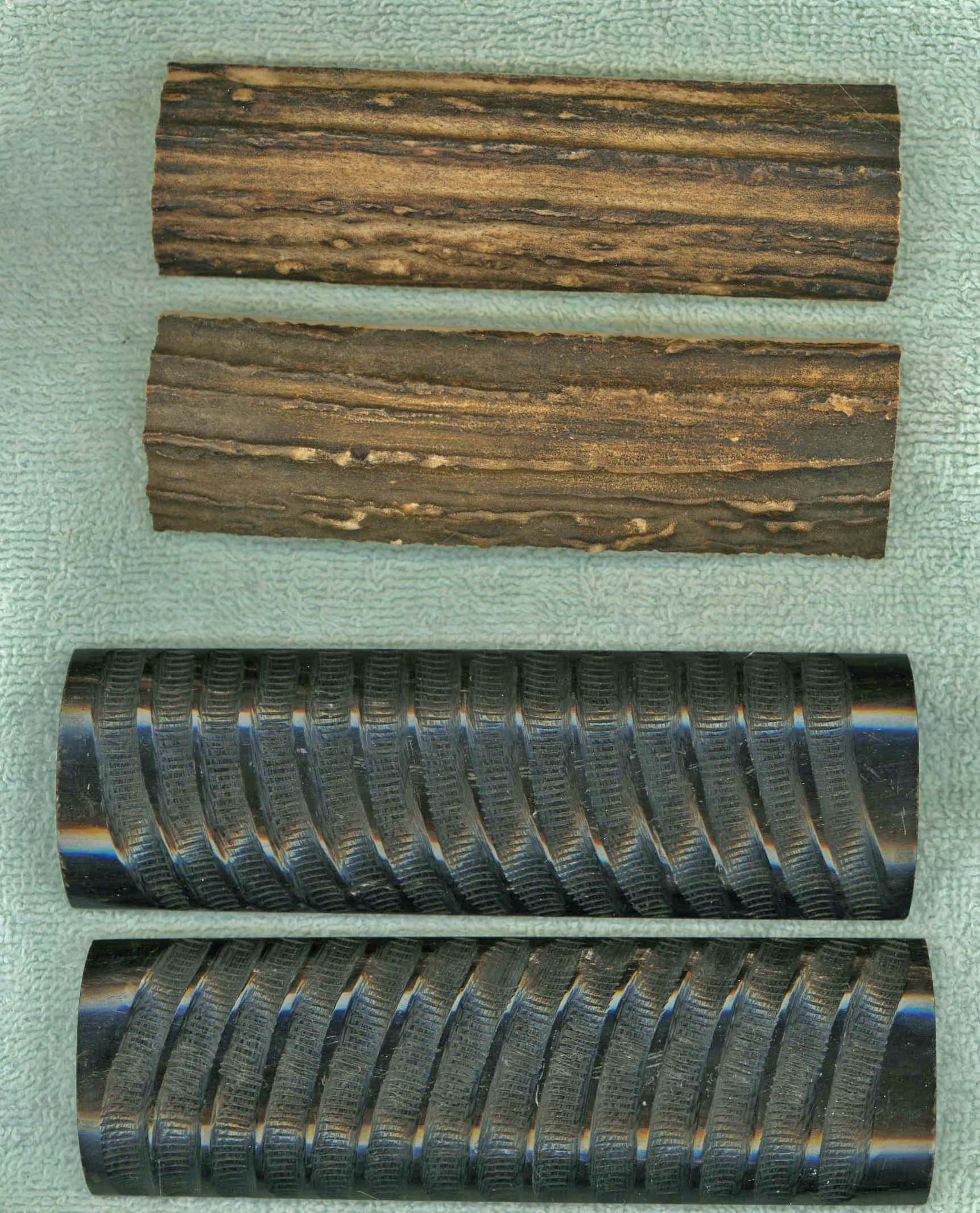

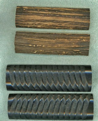

I found some Water Buffalo horn that has been jugged to look like Impala or I have the stag. Here is a pic of both.
I think I am leaning toward the stag.
Thanks for the input,

hmmm, that buffalo horn would look good with those bolsters, but I'm gonna stick with the stag
- orvet
- Posts: 19901
Stag it is...............................unless I screw it up

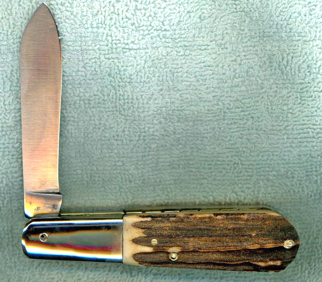

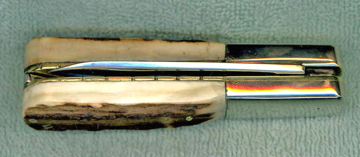

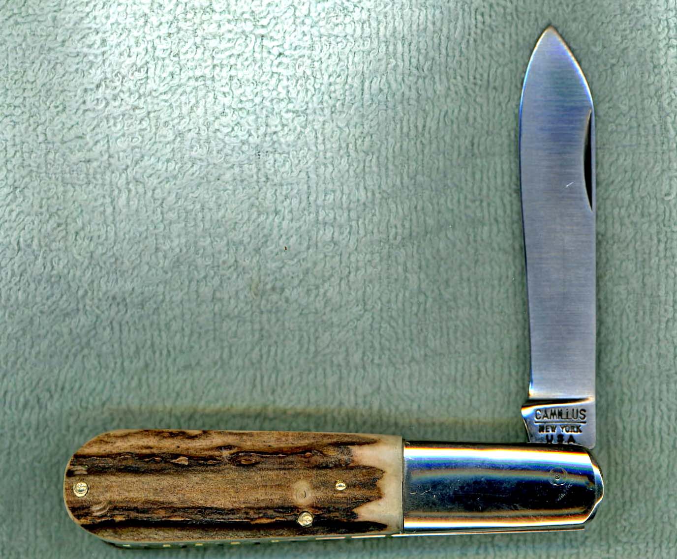

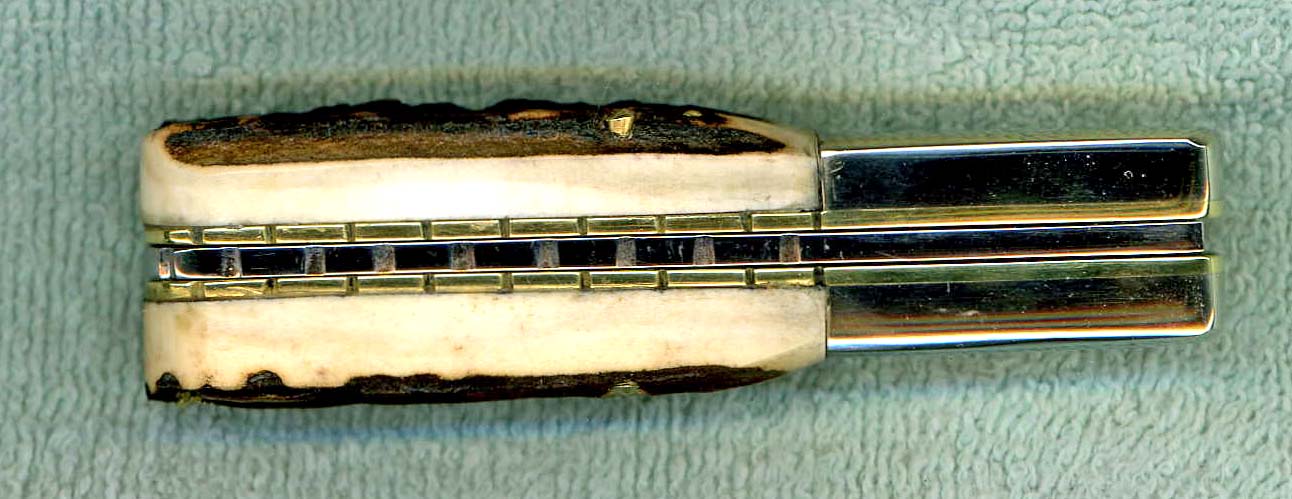

OK, I finally got it pretty well finished. I had trouble with some head spinners that I made. It came off one pin & left a nice round circle in the stag on one side.
And the pin heads didn't come out as well as I had hoped. I also had trouble with the pivot pin & had to peen it, which left a nice mark in the center of the pin on both sides of the bolster, as you can see in the pics.
I still need to do some work on the blade and reshape it a bit. Someone had taken a grinder to the blade and I had to do a lot of buffing & polishing to get as good as it is. Still have more work to do on the blade, it is easier to see in the pics than in person.
I started with a Camillus TL-29 and only used the blade & the back spring. Everything else I made. The liners are a lot thicker than the ones that came on the original knife. It is a big heavy knife.............but I kinda like is, especially since it is the first knife I have done in stag.
