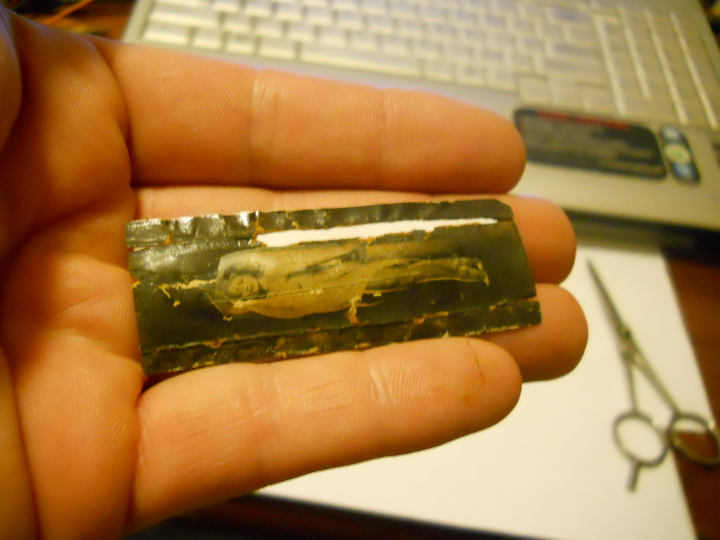

There's no glue under them. Just sandwiched between the scale and liner.
The pictures are "old school" screen printed. Pins are small enough to
press straight through them without damaging them.

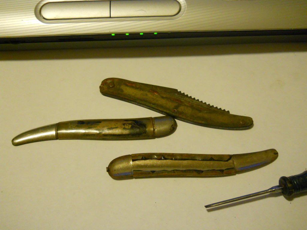

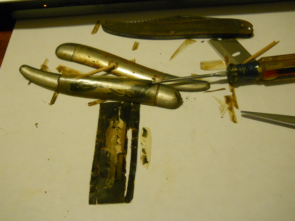

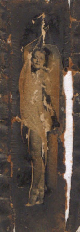

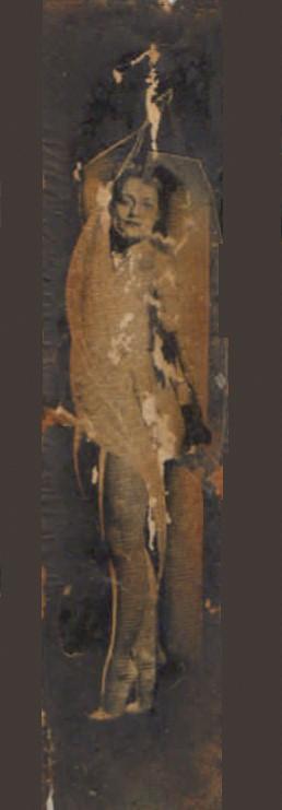

I've been working on a couple of them on shell handle toothpicks. There's
no way to restore the origional image - I scanned mine and I am working on
reproducing them with the aid of Photo Shop.
Pretty fun work for me!
..... Joe
..... Joe

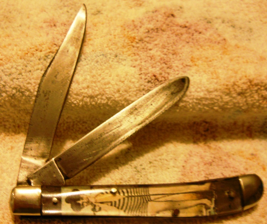

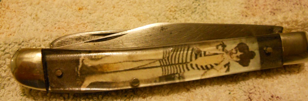

It was stormy here today so I put one of these together. I didn't take before and after pics becasue I never know how things will turn out. I have zero patience and many knives end up in my neighbor's yard. Anyway the material this handle is made of is Lexan. I took this knife with broken handles and blades to a glass shop and they suggested this. It is easy to work with and cleaned up nice with the buffer and 1000 grit. I see a few scratches in it since I brought it in under the bright light. The most time consuming asspect of this was finding a suitable picture and then formatting it. I have this on file and if anyone wants to try one of these knives I can email this picture. It is about 5/8 by 2½". It should be printed on card stock that is .010. This is the first knife of this type I've done but will help if I can.
Men make plans and God laughs
