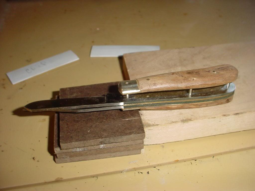

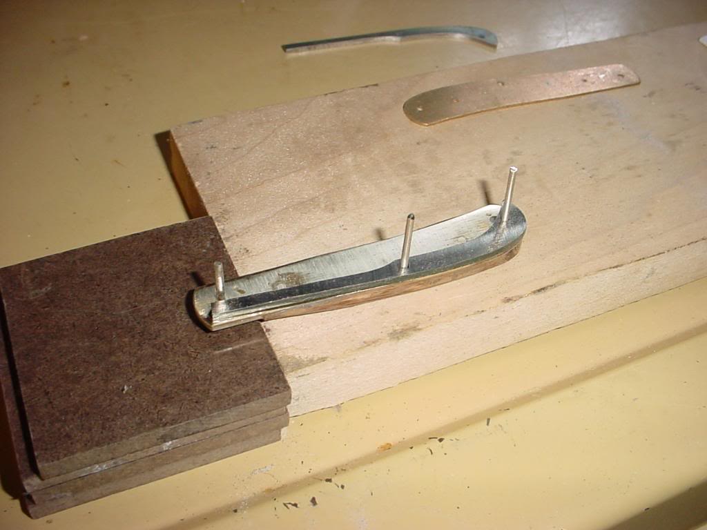

You could use a flat piece of wood as a jigg something like the pictures shown below.
Place the scales / liners on the board and drill holes through the liner holes half way through the wood.
Place the right size diameter pins through the holes and make sure they are tight in the holes.
You could use this to get a new back spring and blade adjusted to your liking.
I've used this method before and it works well.
You can open and close the knife before you put it together for proper operation.
Hope this helps~
JW

If you're replacing both the blade and the backspring, I'm guessing that original parts aren't available so you need to modify some to fit. Am I close? I'd recommend using the broken parts as a template to grind the new ones into the correct shape for your knife. If you were building one from scratch, then you'd need all those math problems, a very sensetive instrument called a "rise and fall indicator" and would have probably have had it all figured out on paper before you started. For a repair, all the hard work has already been done and all you would need to do is copy the old parts. "Dry fit" the parts and adjust as needed before reassembly. I type faster than I think, so if something doesn't make sense just ask and we'll try to help.
