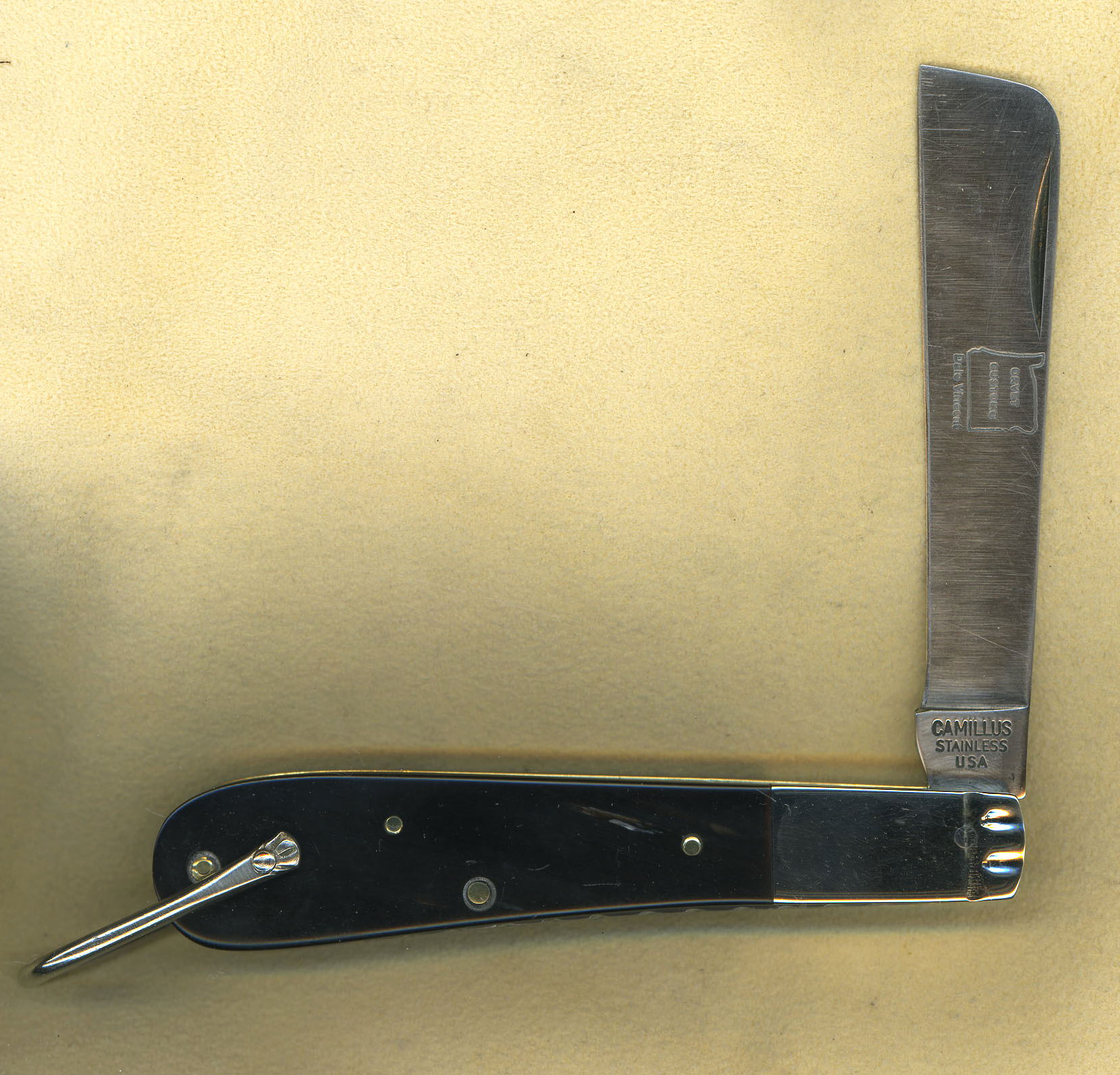

This is what an S702 looks like as it comes from the factory (except for the shrunken handles).
They have a Rope blade and a can opener. I do believe this model was used after WW II as a life raft knife.

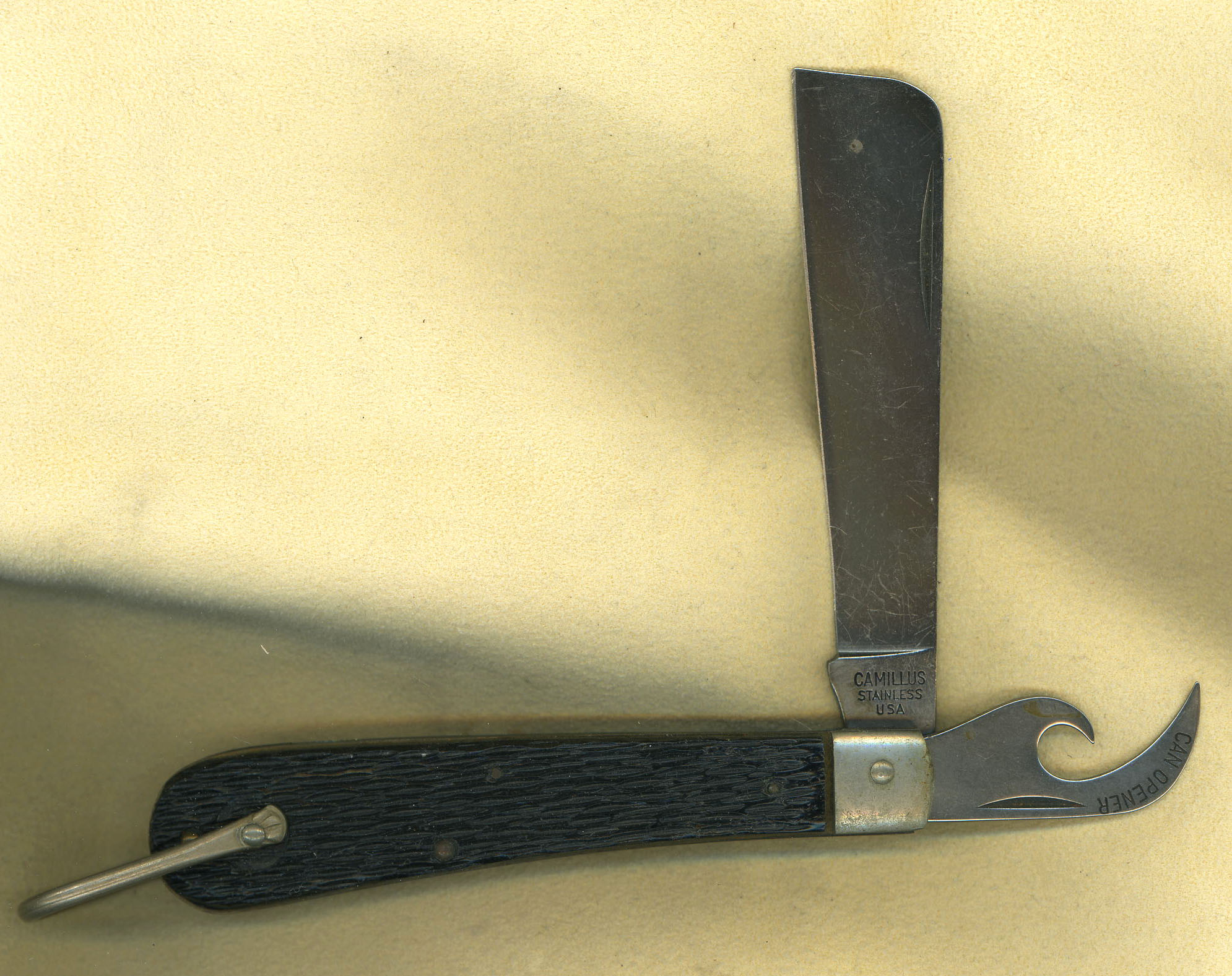

The knife I actually worked on was a bit more used than the one shown here. The handles were partially gone, the back spring of the can opener was broken and half was missing. The whole knife seemed flimsy to me with it’s short bolsters and the thin liners and thin handles.

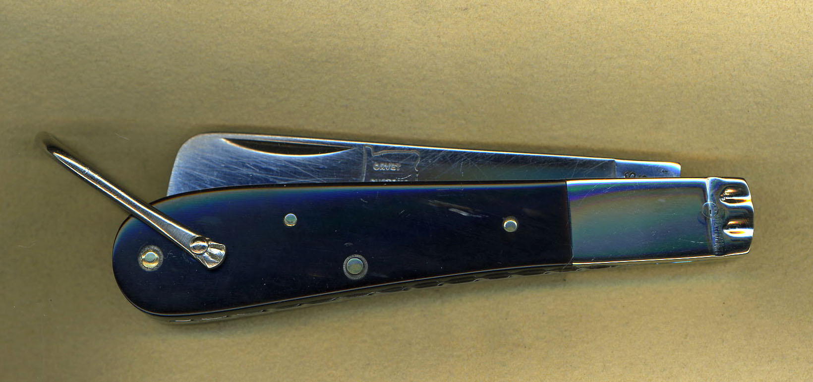

I decided I would remake the knife into a proper and usable rope knife, and hopefully make it a bit prettier in the process.

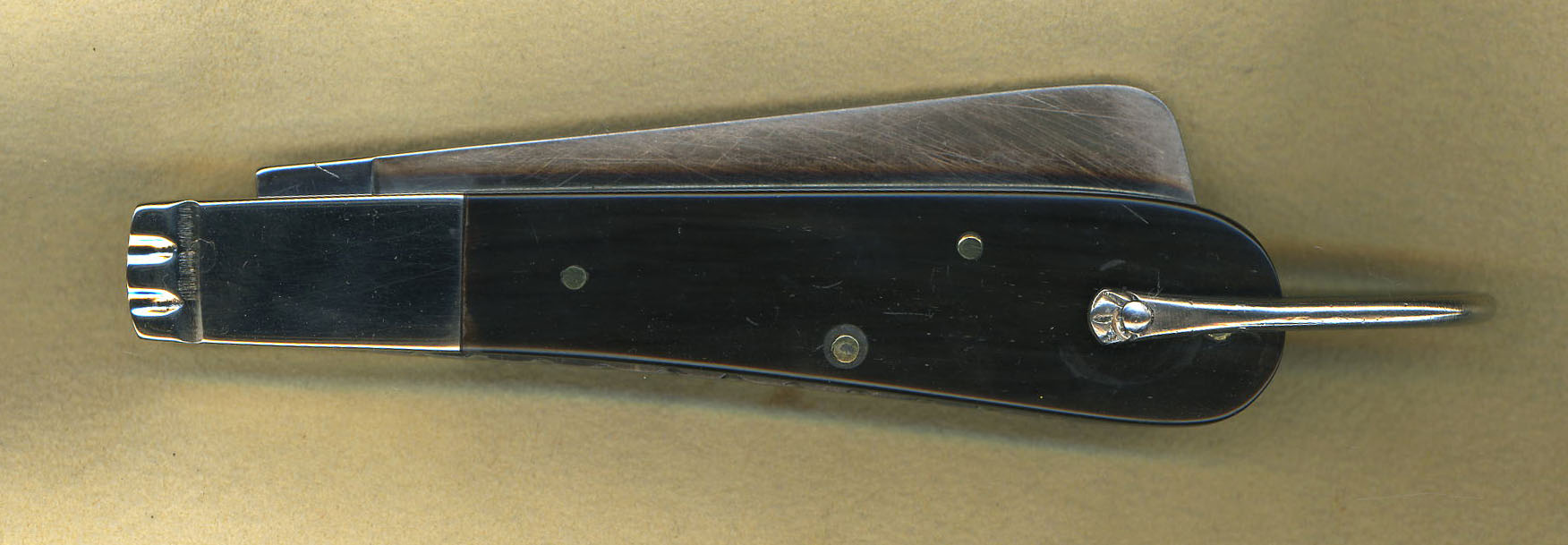

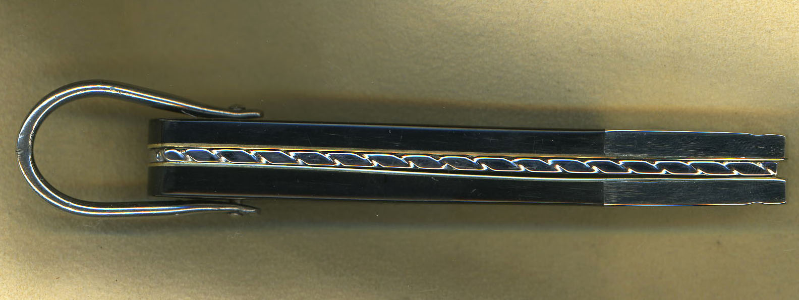

I removed the broken spring and the can opener blade when I took this knife apart. I also removed the tiny bolsters because they did not give it enough strength for such a long blade. So I made new thicker & longer bolsters and soldered them on to the liners. I added water buffalo horn handles, which are mostly black with a few flecks of white in them. I put rope file work on the backspring and crowning on the nickel silver bolsters. Then I remounted the lanyard loop.

What do you think?
