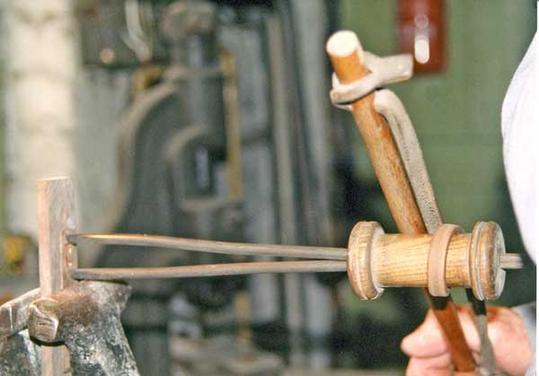

This information on an old parser is interesting.
http://www.watchman.dsl.pipex.com/two-l ... arser.html
Cool picture of someone using one.

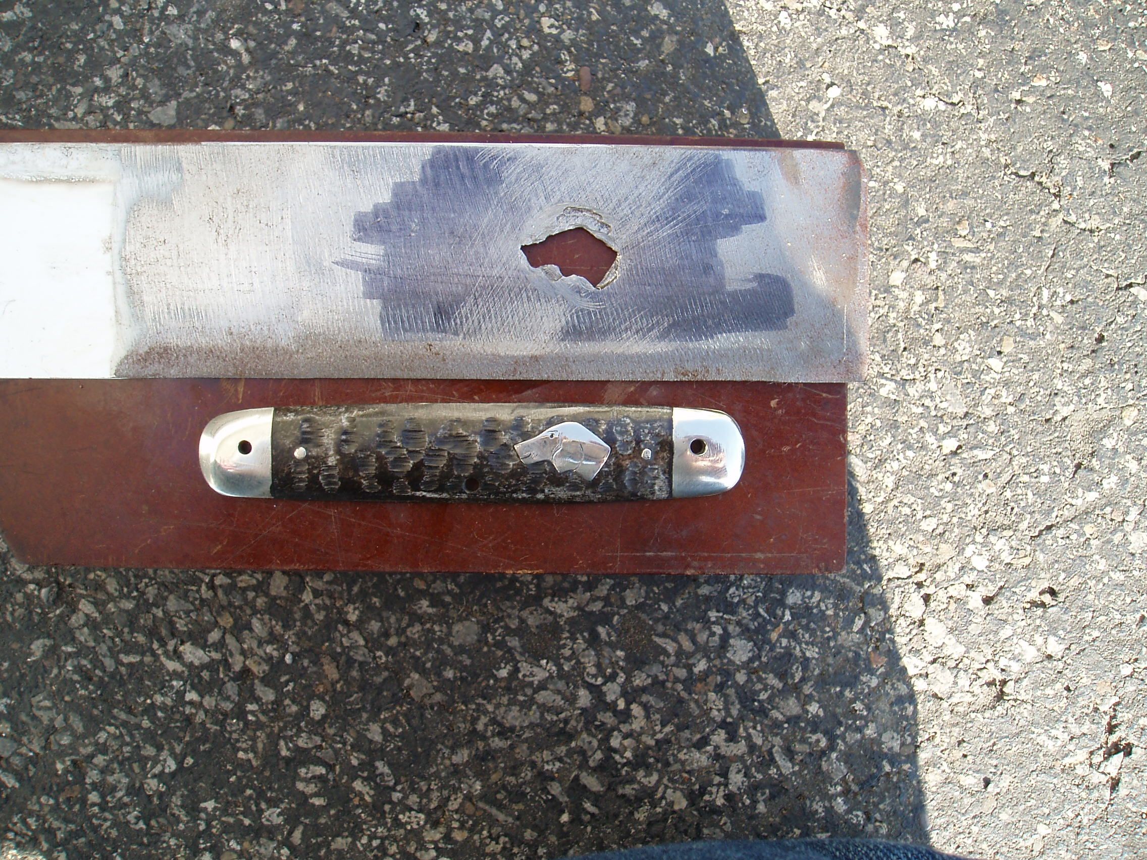

It is funny this thread came up, because I am just about done with my 1st attempt. I am close to putting it back together, but here is a pic of the shield. I filed a template out of soft mild steel, so it would be easy to work. If you were doing several, it would be best to use a hardenable alloy, and harden when done. I didn't have a cutter that was the right size, so it wouldn't cut into the template. The one I had was carbide, so I couldn't easily modify it so the smooth shank would run up against the template. You can see where I bit into the template a little bit. I have better control with both hands on the piece, elbows rested, with the cutter in a drill press.
I have some nickel silver here somewhere, but couldn't find it, so I cut the dog out of a nickel, trying to match an original the best I could. I punched in the details with whatever I could grind to work. He looked better, before I scarfed him behind the eye with a file when taking the pin down

That is a GREAT JOB!! Very Impressed!!! How did you clamp the template to the handle? Thanks

I used a cedar door shim, cut out the knife hole, leaving an open end, then pinched it sideways with needle nose vise grips, then clamped the template down to the wood.wheelgun44 wrote:That is a GREAT JOB!! Very Impressed!!! How did you clamp the template to the handle? Thanks

Bret, that is quite skilled to cut a dogs head out of a nickel!
