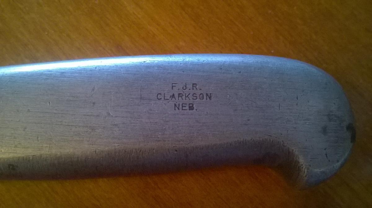

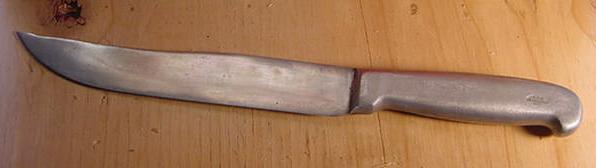

Richtig

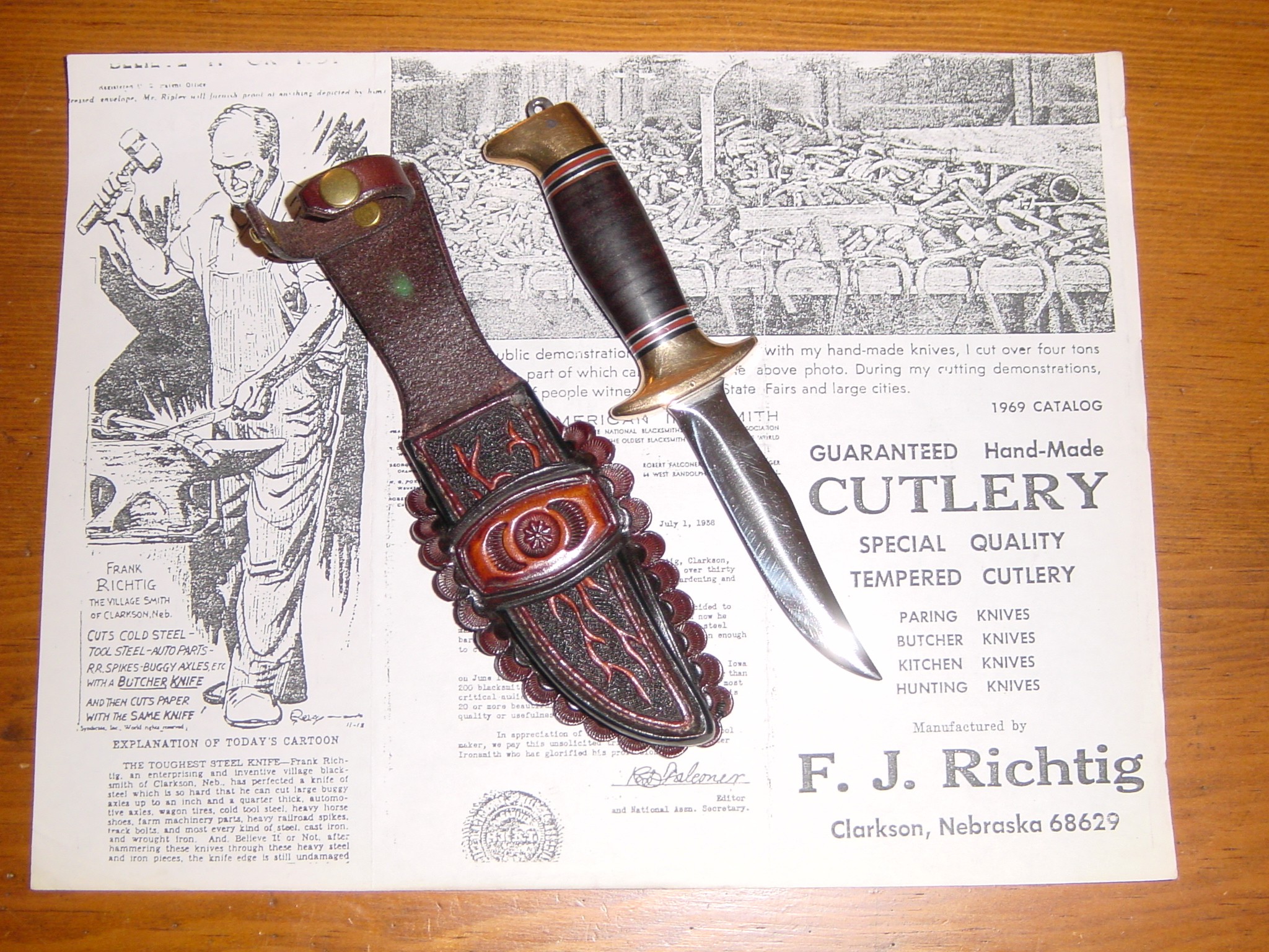

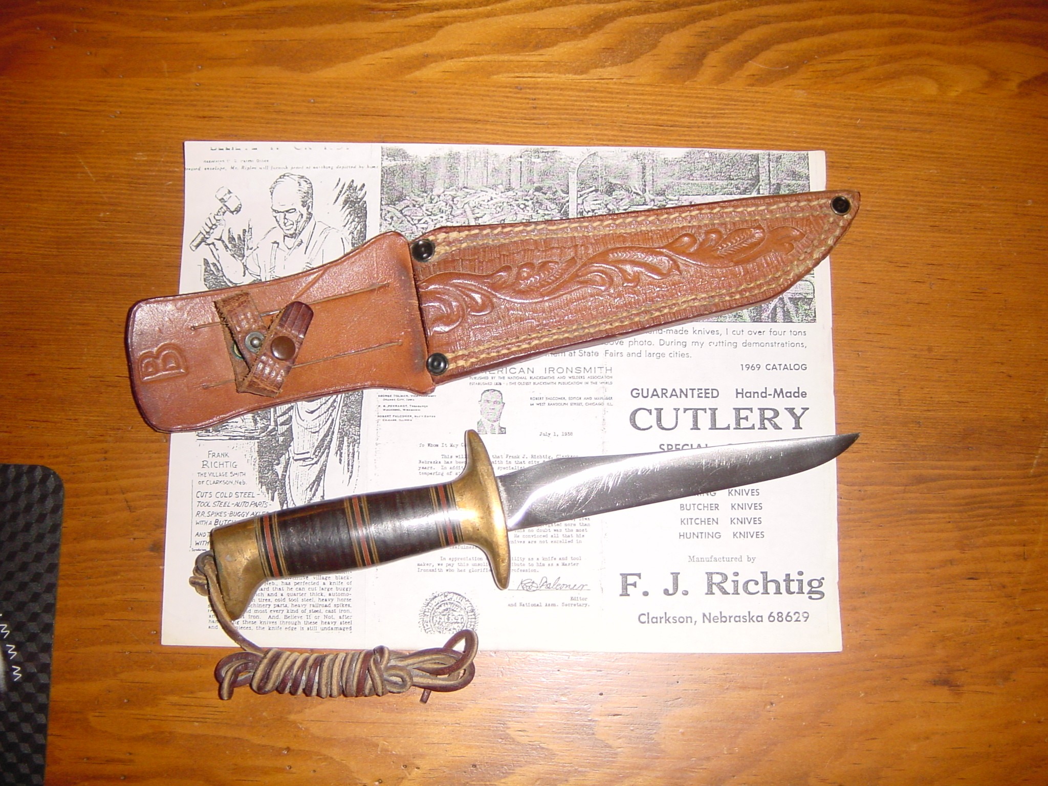

Hi Rich, Great write up. I have been very lucky with finding Richtig's. Attached are pics of mine. I have a copy of the cartoon and as soon as I get back home on Thursday I will send a copy to you.
I've put these on the site before but in another forum

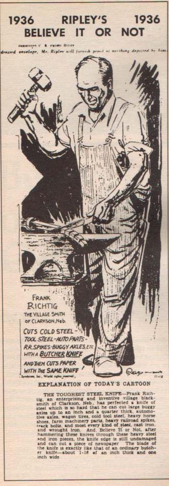

And there it is I knew I had seen it. Here is the dogone Ripleys now me and dale won't have to try to scratch that itch no more. He even contacted the Ripley archives and they didn't have it . Thankyou woofer thankyou for the offer mike looks like i have a copy. Mike. PS Those are dandys and High enders. PPS Ok now I guess i have no excuse not to do that display. It is a lot easier when you know where to look 84 was right between 83 and 85 in book case. DUHHH. I probably would have hit it in a year or two. The way the memory is going I wouldn't have remembered anyway.

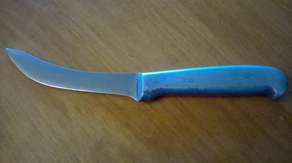

No problem Rich anything to help. Another pic of the last of mine.
- Attachments
- RichtigMini2Ivory.jpg (59.38 KiB) Viewed 9817 times

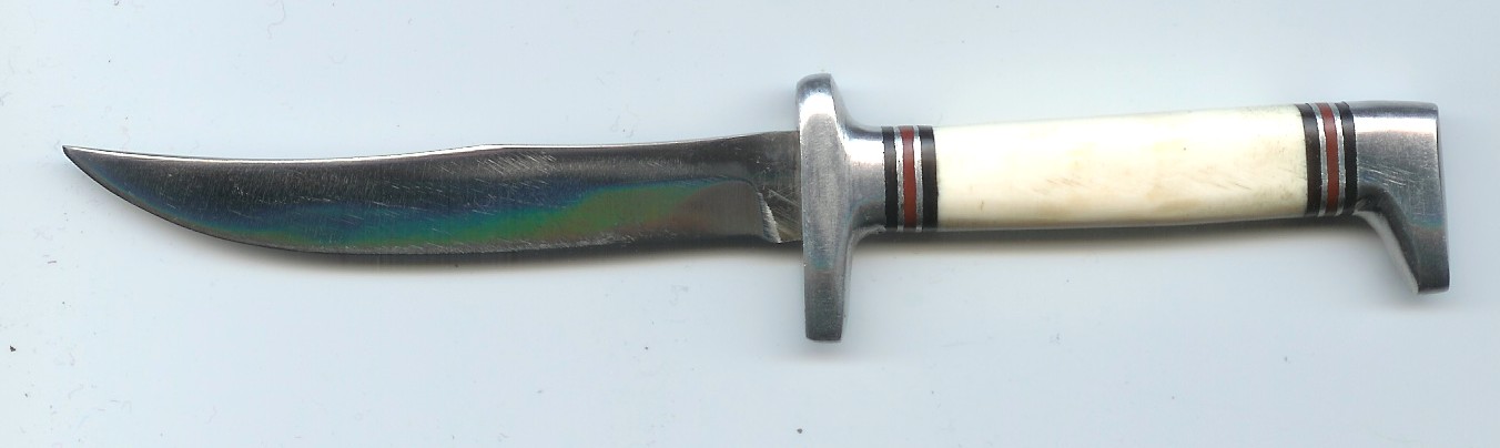

Thanks again. Ok here is the display much like any thing else in my life I find it best to do when it is on my mind ( such as it is ). Not the fanciest but it does preserve the history. Now where to put it. Well I know some of you out there might tell me where to put it . However I choose not to so it becomes another one on the pile. Rather than on the piles Thanks to all for your help. LT PS Pardon my vulgarity

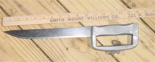

I'm sure that a lot of you remember me posting this picture some time back. When I recalled the story that came with the knife, many years ago, I sent the following letter to Lt and also to Michael Lossico(galvanic 1882). I haven't heard from galvanic 1882, but Lt asked me to re-post the picture and include the story, in hope that it might uncover some additional information. Any info will most certainly be appreciated. Lt thinks that this could possibly be a Richtig knife.
I posted this picture several months ago and the thread about Richtig got me to wondering.
The man I bought it from was a WW2 veteran. He is long gone now. He was born and raised in Lincoln, Nebraska. He told me that there was a Nebraska knife maker, that was making knives to give to local boys that were going off to war. Said all you had to do, if you were from Nebraska, and were going to the Military, was send him your name and address and he would mail you a knife(at no charge). If you chose to visit his shop, he would try to make one to your specs. He recieved this one in the mail.
I can't find a marking anywhere on this knife. I suppose it could have been made by any number of people, but with the aluminum handle and the story from many years ago, who knows.
I love the old knife. It is well made and SCARY sharp.
What do you think about it? I value your opinion. Thank you.

First thing that came to my mind was. WOW people back then really did care about helping the young men going to war. I bet the man was aloud to take this with him back then too.
I am sure today’s army will not let you carry some thing like this or even a new SOG knife. The media is so down on military helping others it all most hurts our men as much and a bloody wound would.
I sure hope you find out the name of this knife maker. I will buy one of his knives just from reading this CCBILL. Thanks for showing this the 2nd time I missed it the first time.

Hi Bill, I am sorry but I did not see the picture before. I have something you can look for on the knife which might help. Look on the top of the guard were it meets the blade. See if there is any tool marks there. I have seen some with 2 lines or grooves which Richtig used to line up the blade. I can't get a good picture of them but will keep trying. I hope this helps. You also can send a picture to Harlan Suedmier in Nabraska and he might be able to help. When I get home on Thursday I will get his info to you.
Regards Mike
