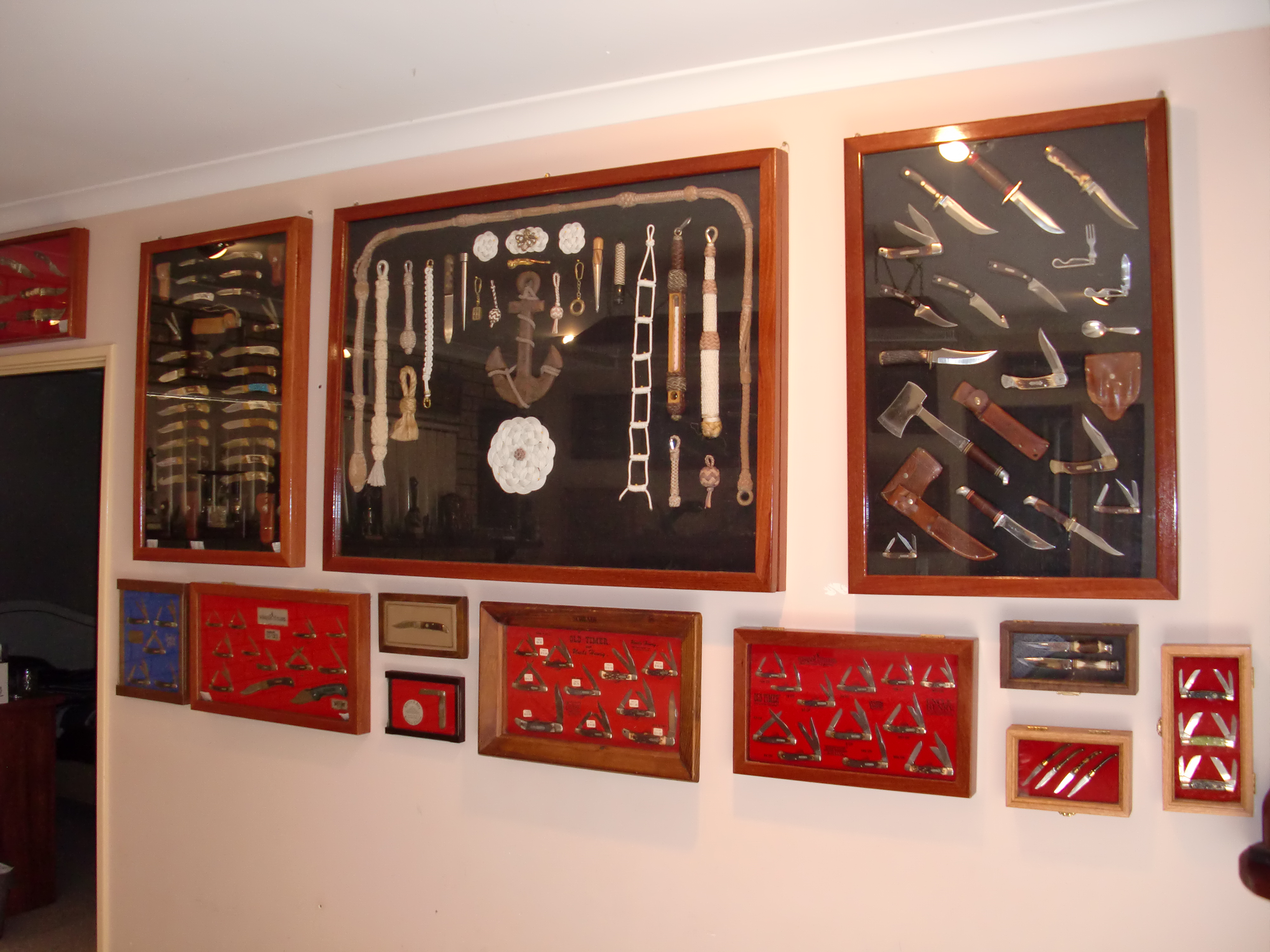

Every now and then i wonder if displaying pocket knives in the "half open" does irrepairable damage to the backsprings.
I mean does the spring eventually get a "memory" that affects the snap on opening and closing.
75% of my knives are displayed in one form or another and i would hate to think i am doing them an injustice.
Any opinions or facts would be greatly appreciated.
