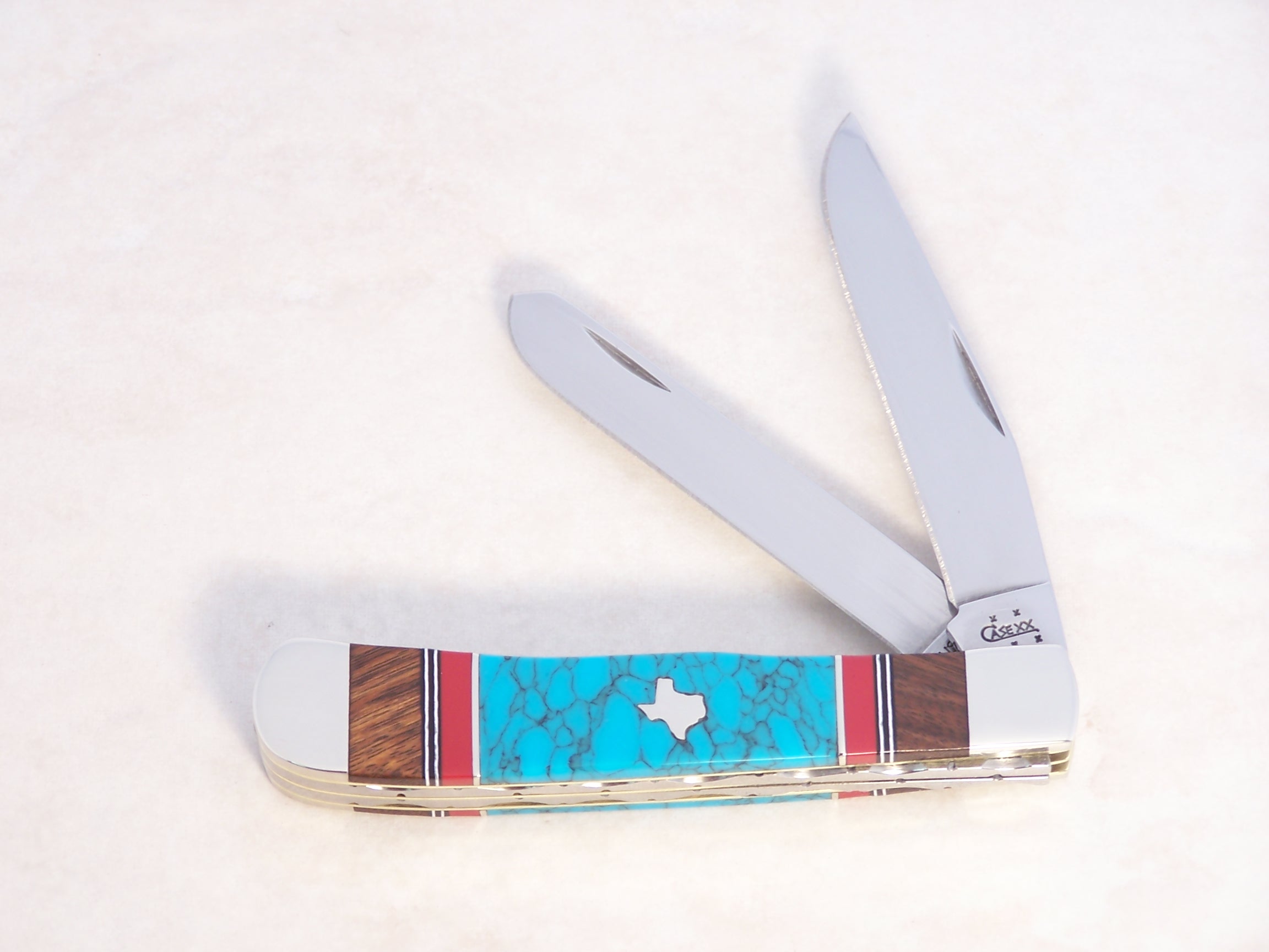

I used a paper template of this Texas emblem. I glued it on and simply cut away the paper. The picture shows the gap a lot more than it show in your hand. I took the picture before I cleaned all the buffer residue off. I glued the emblem in with blue tinted epoxy.
I cut it out with my turbocarver and a tiny little 1/16th shank straight cut dental bit.

Jeff, That is a good looking knife!
see ya Randy

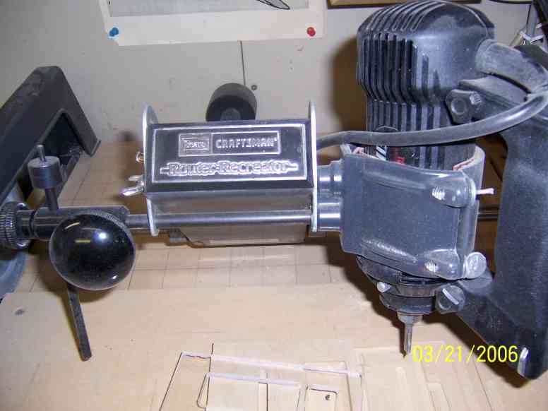

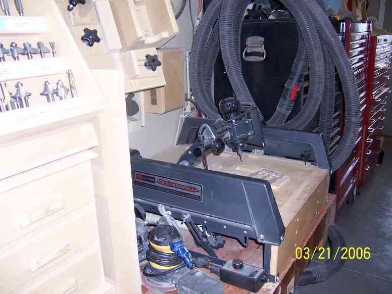

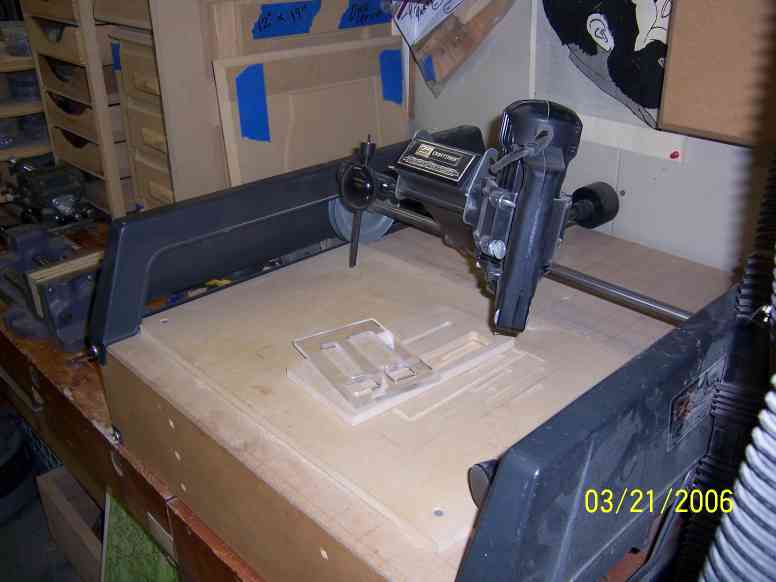

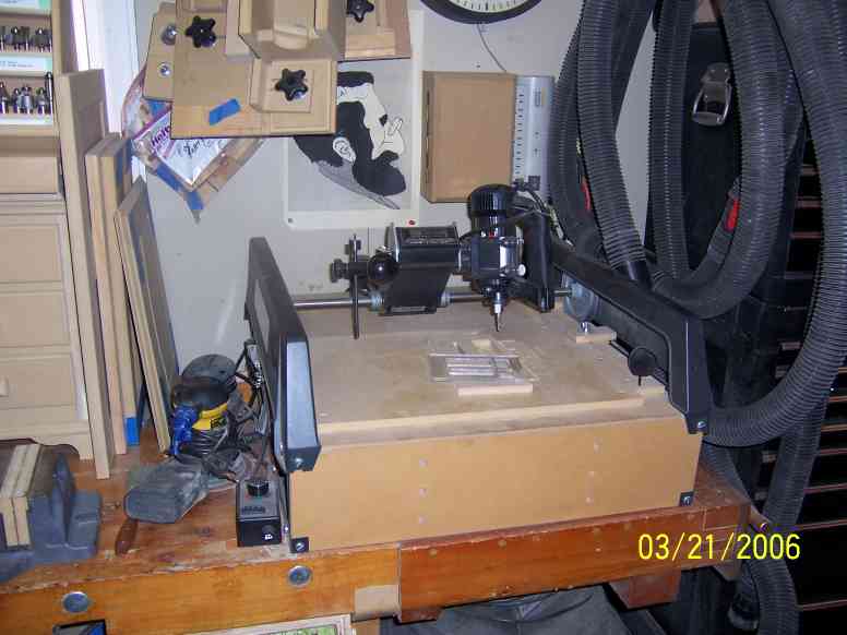

Sunburst,
The router motor is mounted on a carriage that is on rails and rollers. this allows it to move back and forth. The carriage can also slide on the roller axle from side to side. the carriage will also allow the motor to move up and down. all of this is controlled by guiding a stylus along a pattern. Clear as Mud!!!
Here are some photos that may help
This is a modified one. This is what I would like to do to mine in the future.
Hope this helps,
Jeff
Hope this helps,
Jeff
