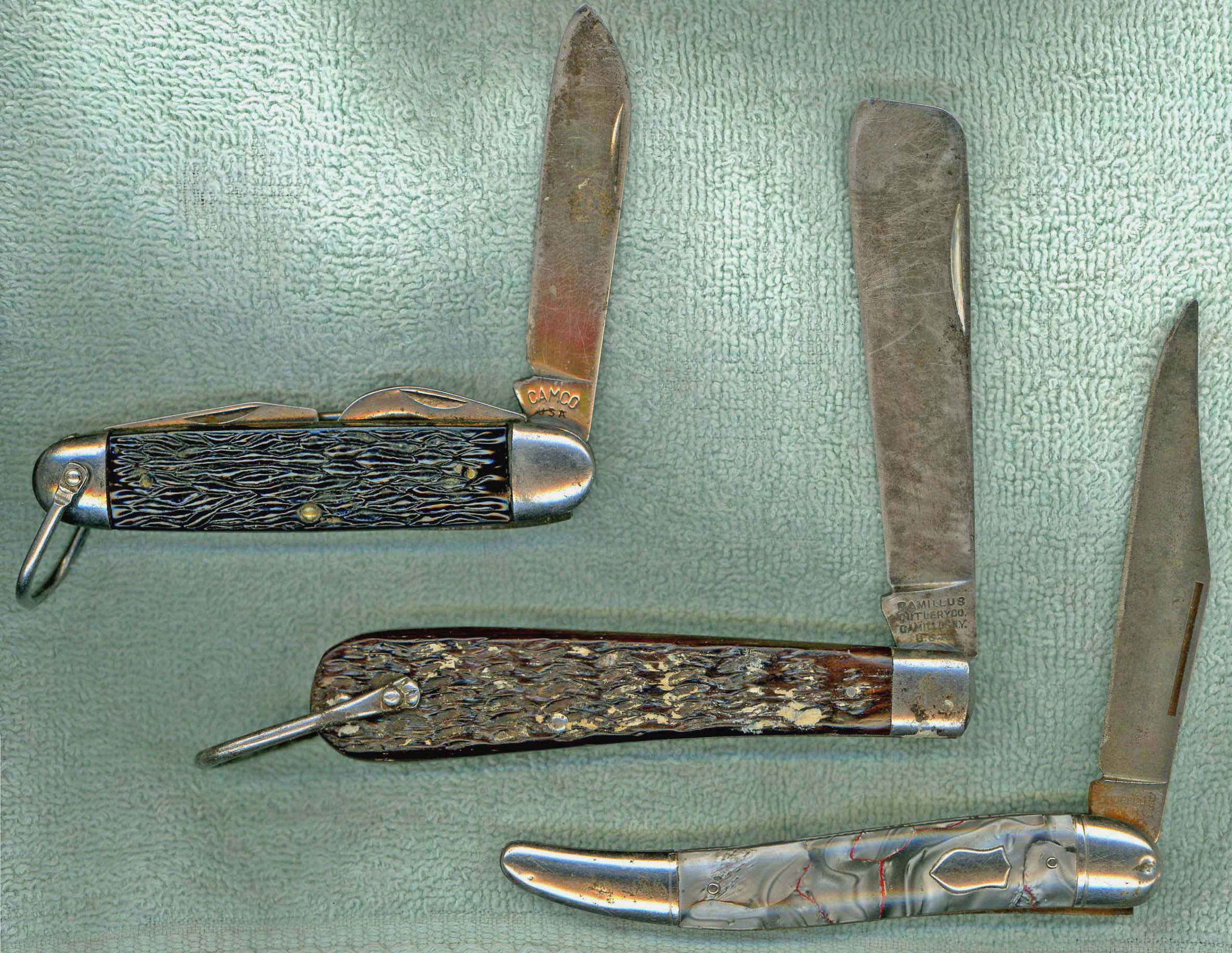

I made a nice score yesterday at an antique mall. One of the sellers there has a bargain basket. I check it out for something I can rebuild. I got these three and a Richards of Sheffield that I posted in another forum here at AAPK.
The top knife is a Camco camp knife. The middle is a Camillus rope knife & the bottom is an Imperial. I am especially anxious to get started on the rope knife. I may make a Wharncliffe out of it. I haven't decided yet, but I can't wait to get started. But at the rate work is rolling in, I may not get to it for a month or so.

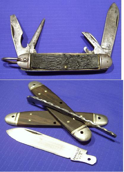

My latest project, 10 minutes at a time is this. Hope to finish it today and I just bought some hawkbills off ebay last night so they will likely be next.
Stolen spring from another busted 3 blade Camillus with my first file work. Quick photo. The wood is African Blackheart (?)

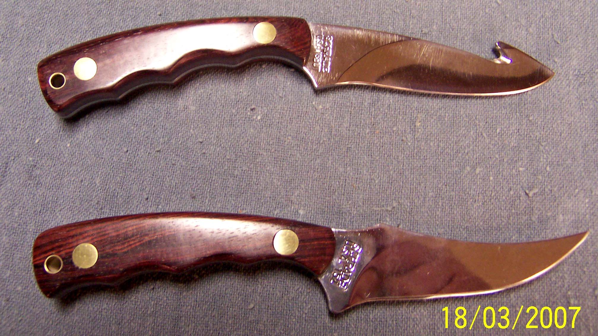

Here is a shot of a couple I am doing now. I put a coat of finish on them only to find out that King Wood is too oily for the finish to dry properly. I will have to buff them with Carnauba after a base coat of Howard's Feed-N-Wax. It was a bummer to have to strip off the finish.
Sorry for the lousy pic, it was in direct sunlight.

Yeah, kingwood looks great but needs to be treated like cocobolo. Some Thuya burl will take a finish, other pieces can be stabilized just fine, and the others will weep after stabilization, also they won't take of finish and need to be treated like cocobolo, even from the same chunk of lumberorvet wrote:Here is a shot of a couple I am doing now. I put a coat of finish on them only to find out that King Wood is too oily for the finish to dry properly. I will have to buff them with Carnauba after a base coat of Howard's Feed-N-Wax. It was a bummer to have to strip off the finish.

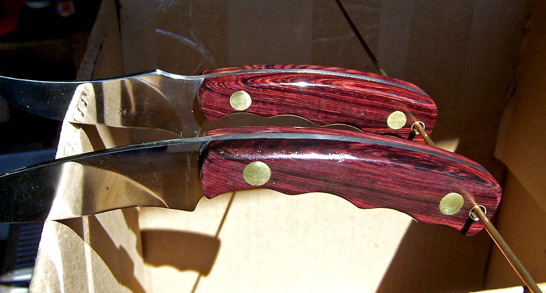

I attached a pic of how they turned out with some Howard's & several coats of Carnauba & Ren wax. Not as shiny as I wanted, but I sanded them to 2000 grit then used 4000, 6000 & 8000 grit micron paper. They couldn't get much smoother.
Sorry for the glare, I don't have a light box.

lookin' good dale, as far as ironwood goes, a little linseed oil, then a good buff on a loose wheel will mak'er shine

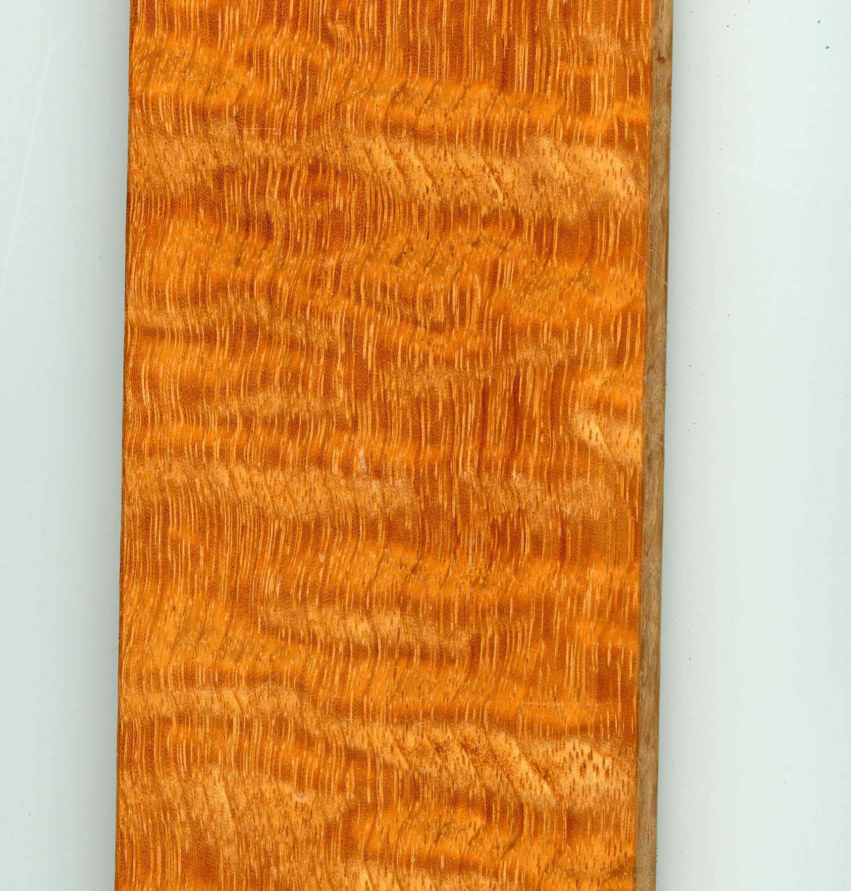

The finish I used first on the King Wood (that I had to take off) was a Swedish made Hardwood floor finish. I got some from my son, who installs & finishes hardwood floors.
I also get some great scrap wood from him.
Lots of Oak, Beech, Brazilian Cherry, Walnut, even a few pieces of Kemper. The Kemper was a bit fibrous to work with, but when it had a coat of the floor finish on it.........Oh Baby!!!
I attached a scan of the Kemper wood in the raw state.
