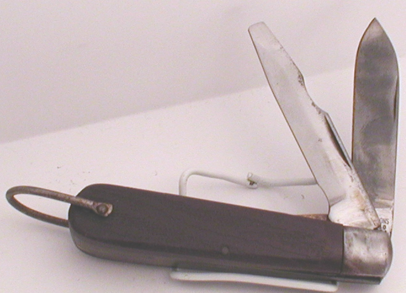

gonna turn this sow's ear into a silk purse. new handles and file work including the bolsters. i plan on keeping both blades and working the lock liner as well. i'll take pics and post if anyone is interested.
suggestions?
m klein before

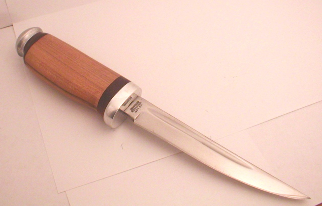

here's one i rehandled in spalted maple and bloodwood. made from scratch bolster and butt from aircraft aluminum.

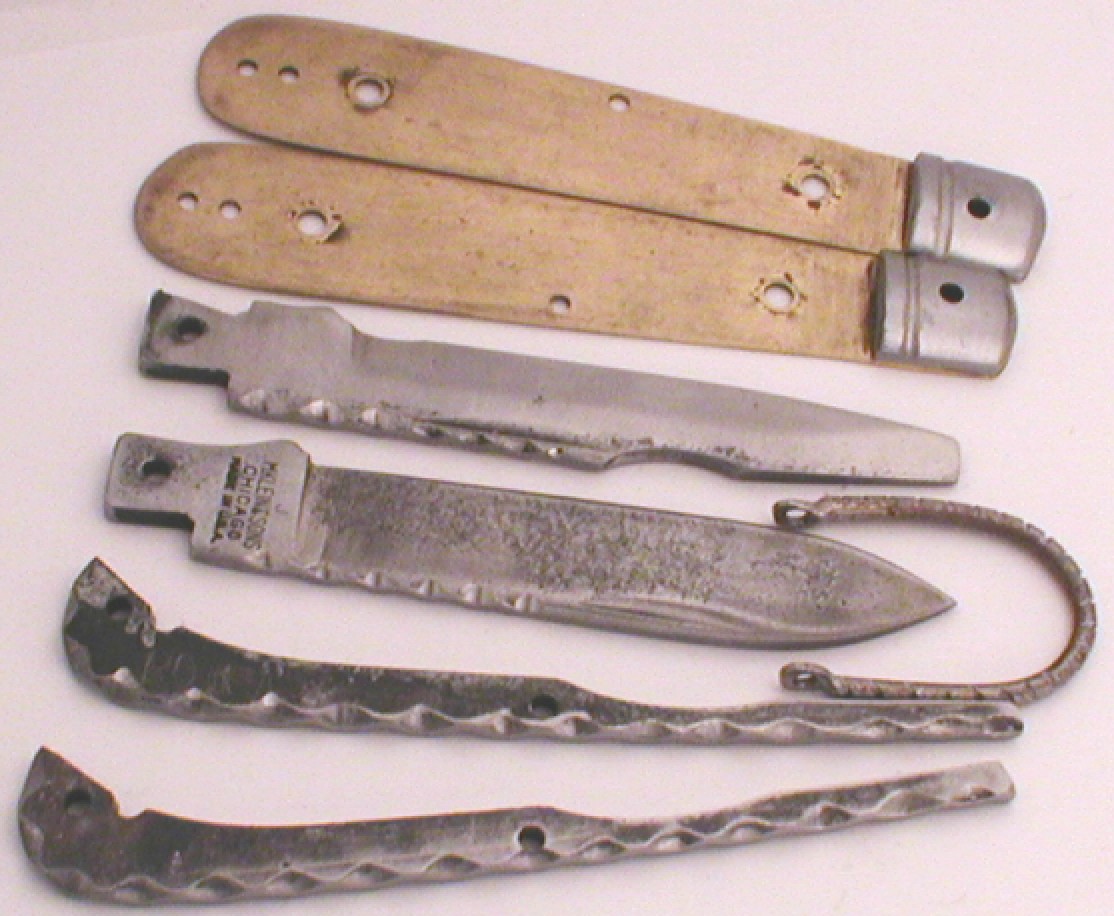

file work and de-cruding
Post by jonet143 »

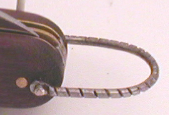

here are the pieces after file work, ready to be polished. including grooved bolsters and a spiral filed bail for diligence.
johnnie f 1949
orvet
Posts: 19901
Post by orvet »
Nice file work Johnnie. ::tu::
Did you groove the bolsters with a file?
What type of glue do you use on the scales (or do you)?
I can't wait to see the finished product.
jonet143
Posts: 6922
Location: w'ford-tejas
Post by jonet143 »
thanks dale. yes, i used a small triangular to score and a small round to finish. i use a small amount of devcon5 to secure before pinning.
the steel on this spear point wore out three files. hardest i've worked on. are these chicago kleins contracts by camillus? or?

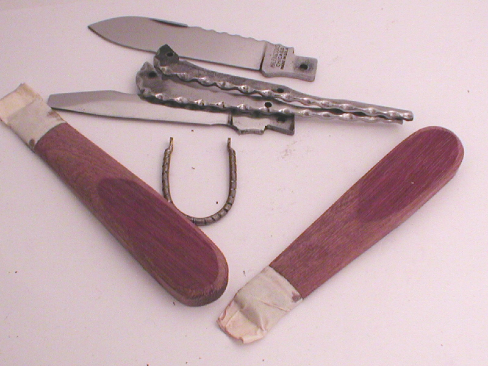

another step taken....
Post by jonet143 »
ok, all polished and ren waxed. handles are roughed in. now i'll drill, pin, finish the handles and re-assemble. main blade had a lot of pepper but 600 grit followed by polish cleaned it up nice.
all dressed up and nowhere to go
johnnie f 1949
orvet
Posts: 19901
Post by orvet »
Lookin' good Johnnie ::tu::
I see you tape the bolsters too when sanding. I use electrical tape because it is thicker. Some times I use it when polishing to, but then I tape the handle to polish the bolster.
Nice choice in wood. Looks like it may be Bokote?
It is coming along nicely. Thanks for keeping us posted. I'm looking forward to the next set of pics.

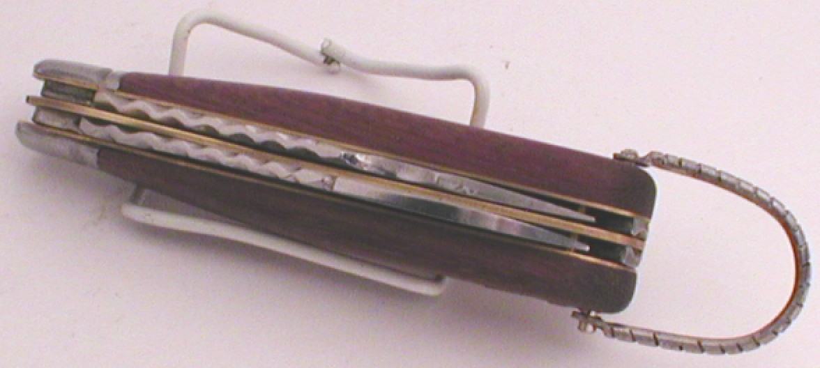

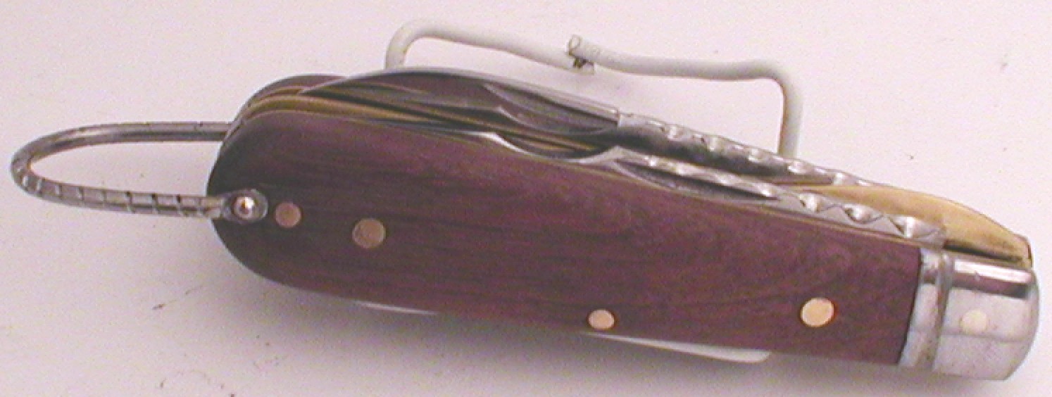

what do you think ?
Post by jonet143 »

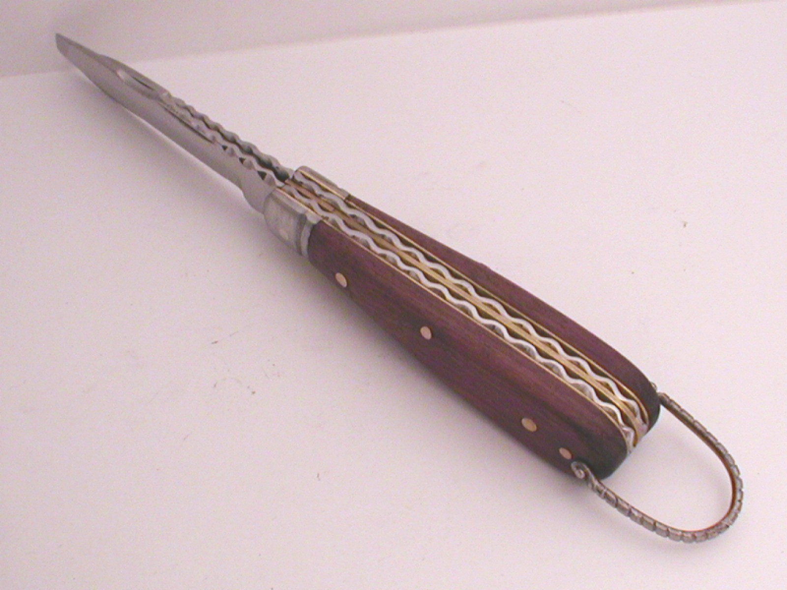

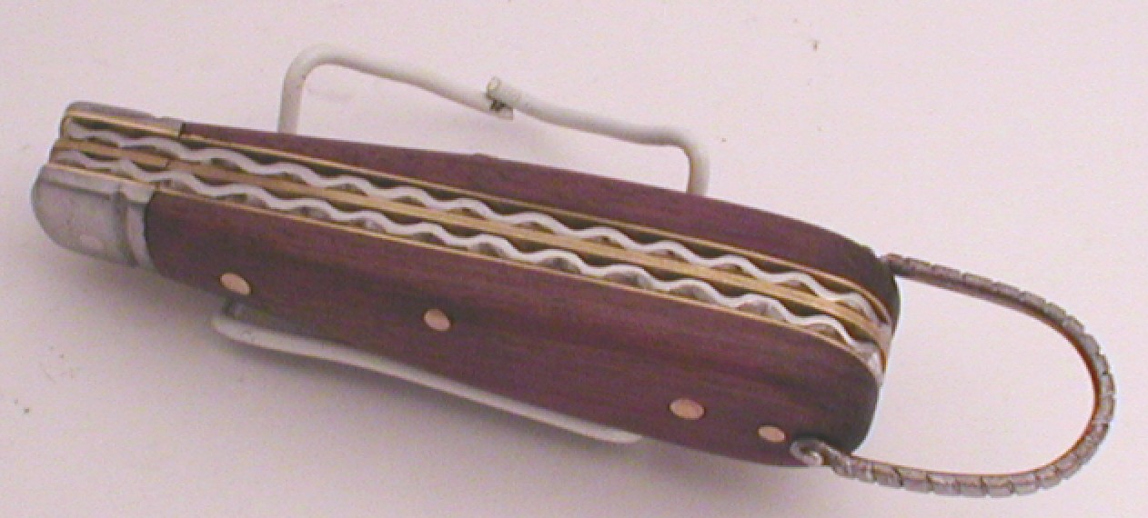

all done now, ready to go electrocute myself. kept it stock, a working knife with flair, i hope. ::shrug::
johnnie f 1949
muskrat man
Posts: 5684
Location: Ohio
Post by muskrat man »
way to go Johnnie! ::tu:: ::tu::
jonet143
Posts: 6922
Post by jonet143 »

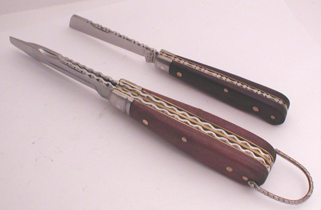

thanks kaleb, there is a lot of time spent on a two back spring knife as you know. and spiraling the bail was a challenge. you can't see it but on the end of the f/w on the blades are little snake heads. ::paranoid:: i also adjusted the heel of the screwdriver blade to make it straight with the handle. i've used these tools and it's an improvment. straight screwdrivers work better! ::dang:: got a little klein one arm man razor knife that's goinin under next. i'll have a whole tribe of kleins. or would that be a gaggle?
