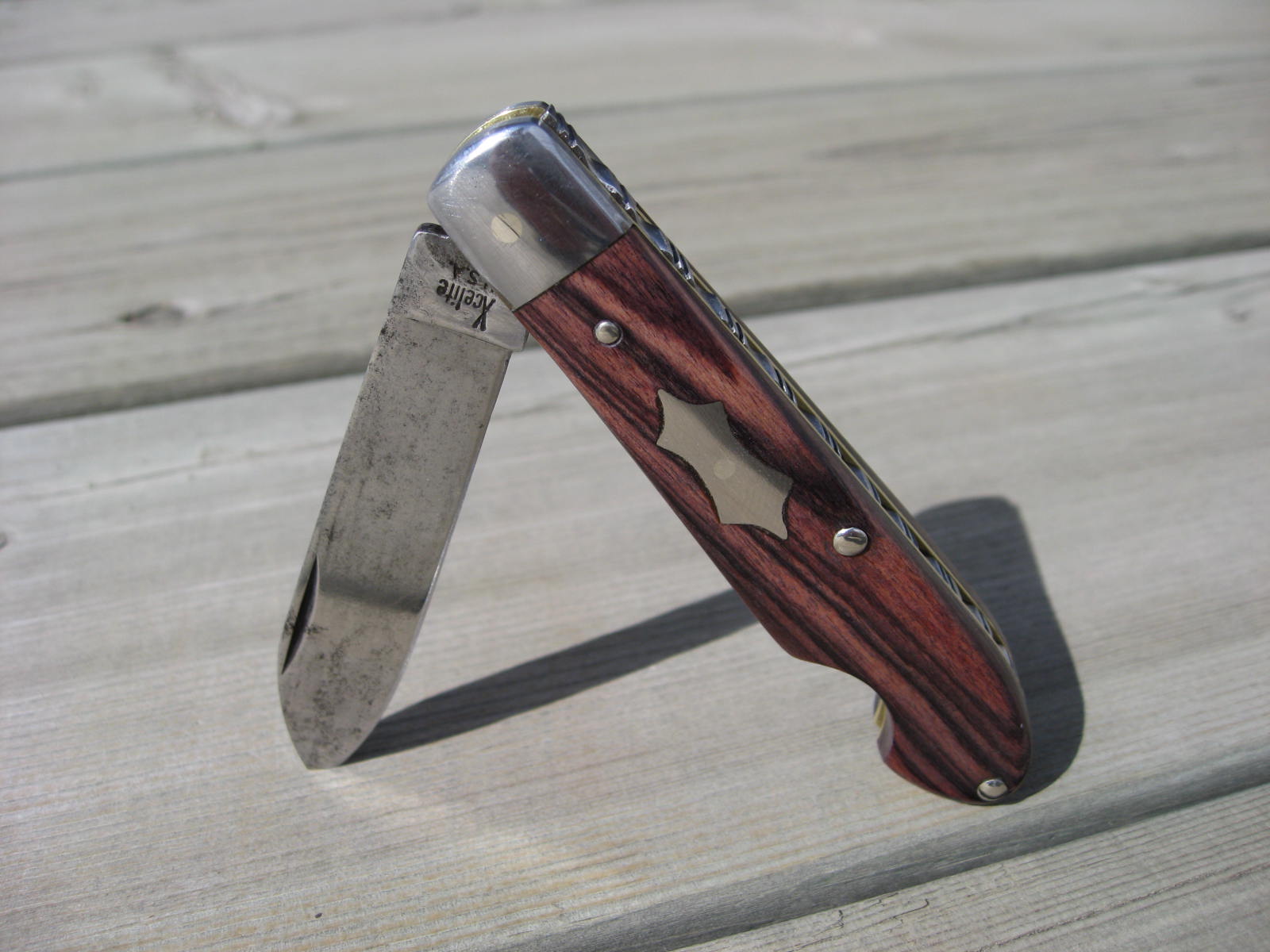

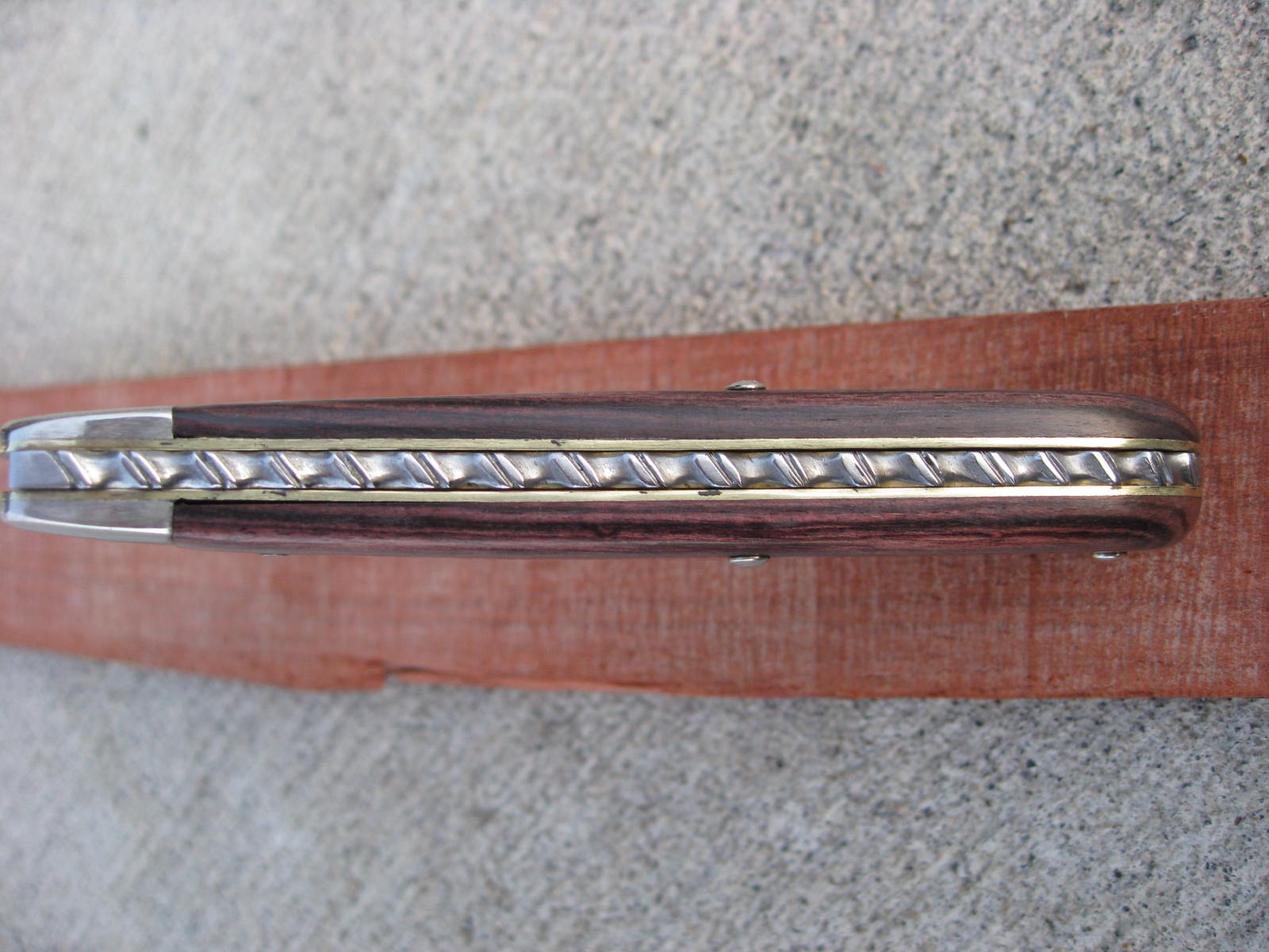

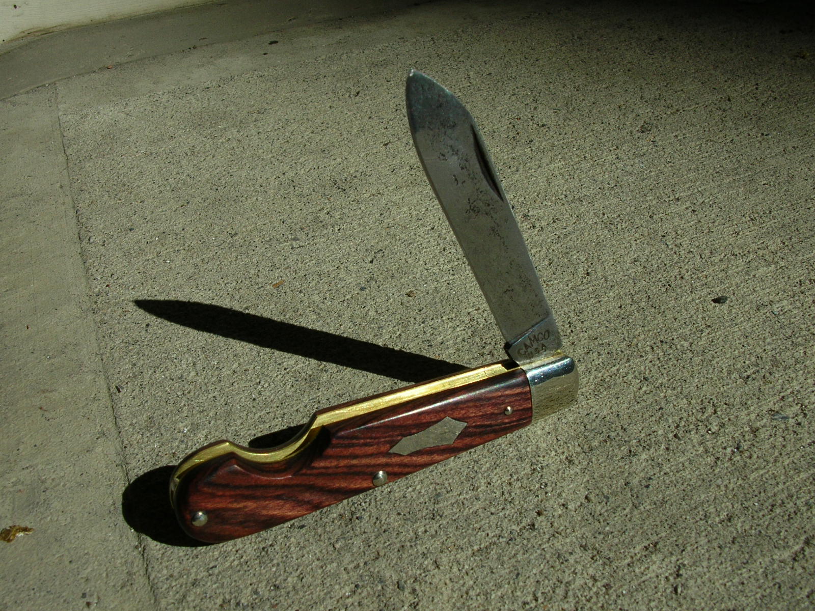

I had pretty good success with both 3/32 and 1/16 pins. Nickel-silver and brass. Steel pins, I could not spin.
I used a little Delta 8" benchpress. Good support underneath, slow speed and steady pressure with a light 3:1 oil. For a spinner, I made a couple out of set screws, and also hex-drive screws which already had a little concave bottom on them. I find that preparing the pins with a little bit of a top bevel all around works well, and also making the top of the pin flat with a file, part way thru the spinning process seemed to help the dome form.
For all my pins, they ended up looking a little pointy on top (because I used a conventional drill to make my spinner), but still spread out (ie mushroomed). I just hit the tops with a little sandpaper or file and buffed and they turned out fine.
Here's a couple of photos of what the pins look like when I'm done.
Haven't worked on a knife in many months now. Kids, life and work all seem to take priority.
Cheers,
D
