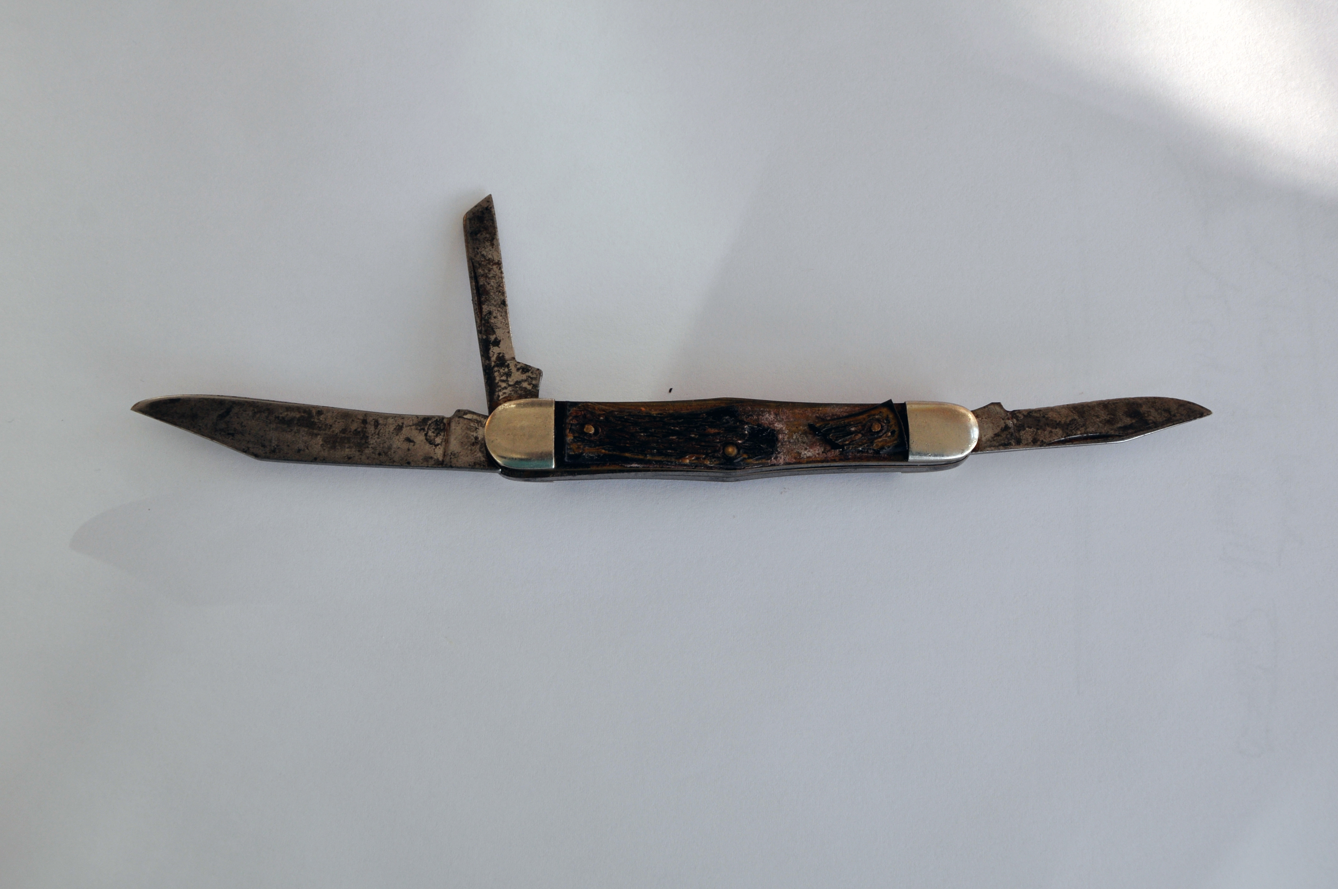

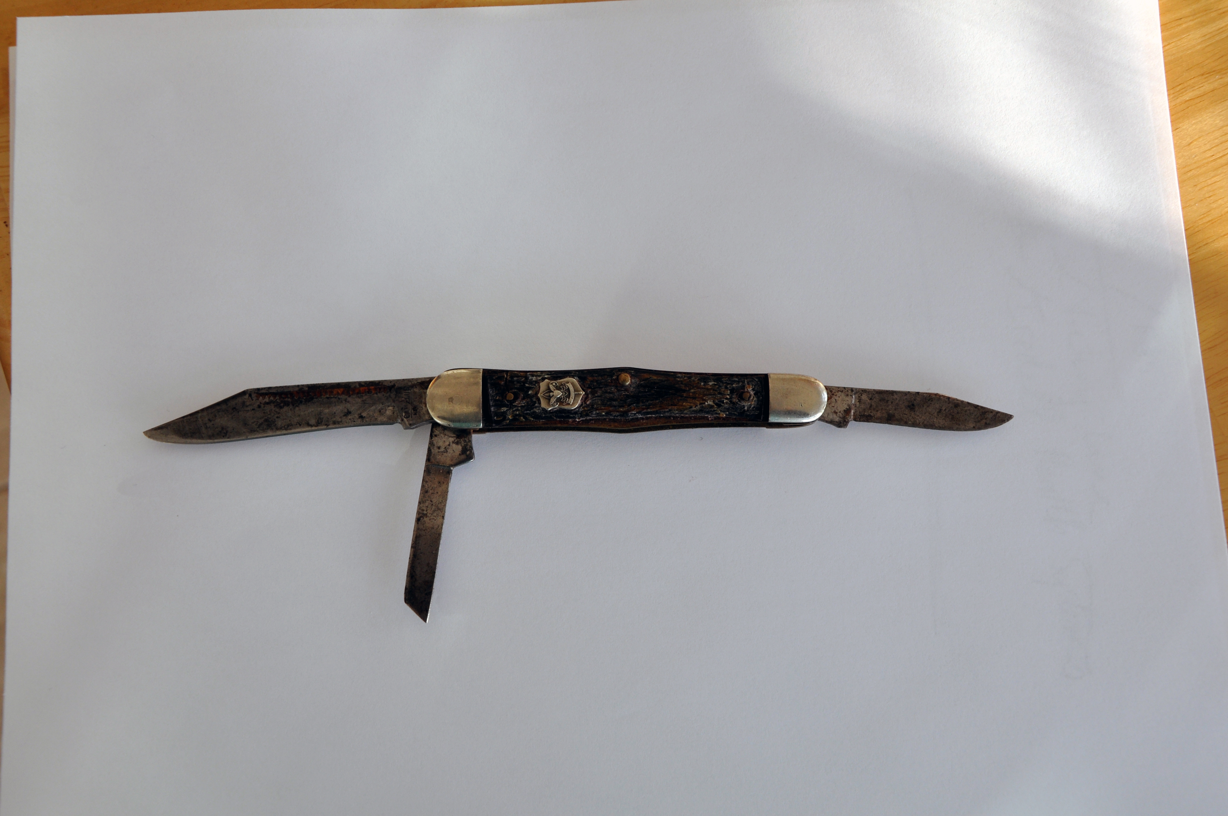

I have attached 2 pictures of the knife I am trying to have repaired/restored...new handles.

Of which Glenn is one!!glennbad wrote:There are quite a few skilled mechanics on this site that can work with a knife like that.
Your knife is a Camillus #1047 (the Scout version of the Camillus #72). It has those old black synthetic "shrinky dink" handles they put on during the '40s and up through the '50s. Yours is most likely 1950s sometime.
If wood is what you want for a re-handle, then ask the mechanic you choose to put wood on. If you have any interest in jigged bone, Culpeppers has some really great jigged bone. Be specific about what you want. You've already said you want the shield retained, do you want the knife buffed and shined up or just new handles installed?
I think you need to ask the mechanics if they are interested because it doesn't look like there's a lot of volunteering going on. PM Glennbad or Whitebuffalo58. There are others but those are two that have done work for me and I was quite satisfied. No disrespect intended towards any of the other knife mechanics.

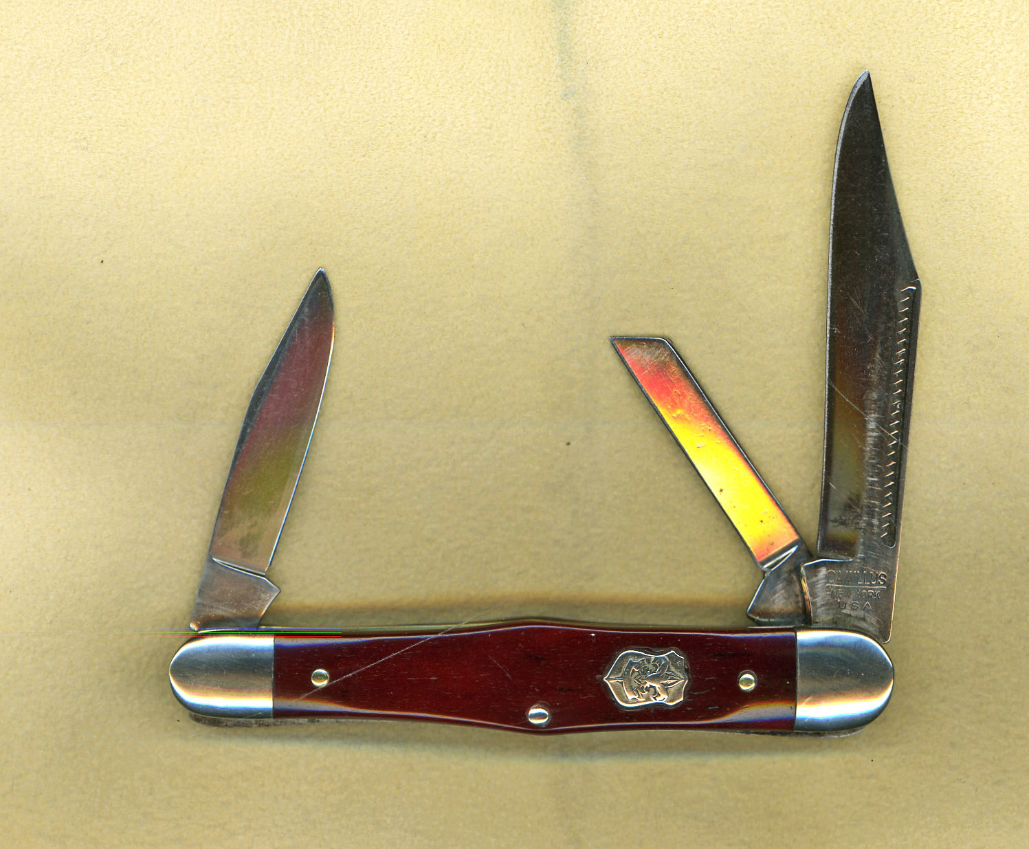

I Have repaired that same model of Camillus knife before and inlaid the shield into the new bone handles.
Here is one I did for TJ in smooth red bone.
TJ has better pictures of the knife than I do, I just took a couple quick scans with my old scratched scanner before I mailed the knife back to him.
The old handle material used on these knives was a plastic they used before the invention of DuPont Delrin.
JerryD calls them "shrinky-dink" handles and aptly so. They shrink and curl with age.
There is nothing you can do except replace them.
If you want the knife close to the original look I would use black jigged bone and then inlay the shield.
I do have a few replacement blades for that model, but those blades look nice and full. They just need to be cleaned up.
Inlaying the shield requires special tools, IMO. A Dremel is too fast with too little torque to do the job properly. I have a couple Foredom flex-shaft tools I use to inlay shields. It is labor intensive to do them freehand, but unless you have a hardened template from the factory for that exact shield, then you have to do it freehand. Since there are no templates sold for the Camillus scout shields, I do them freehand. It can take a couple hours or more to inlay a shield, depending on the handle material and the size and shape of the shield. I use magnifying glasses to be able to see the fine detail when inlaying the shields.
Like a lot of knife work, it is labor intensive and requires some specialized tools, but I enjoy the work.
If you can wait until my knee heals up after the surgery, I can replace the handles and inlay the shield into the new handles.

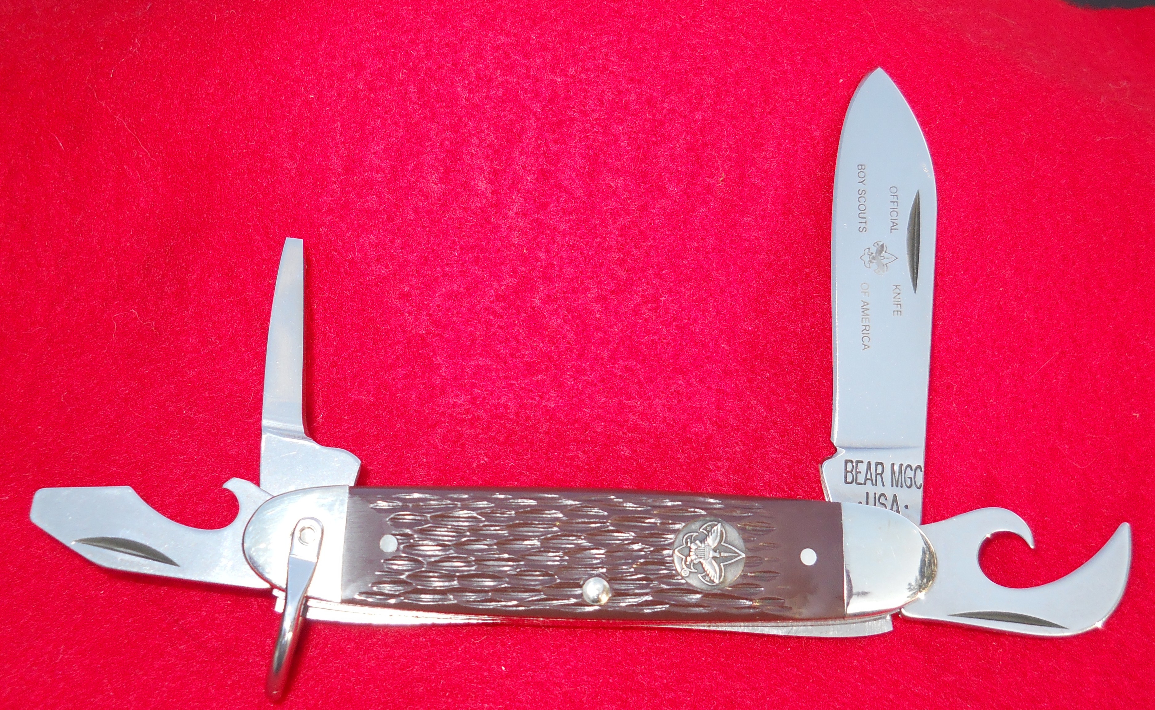

I walked into the local "Offical" Boy Scout store and bought these 2 knives without producing any Scout I.D. I was able to buy an Axe along with some camping equipment as well. All the Chineese made items were available too.

Here's a stockman for sale on Ebay now. Run it down and tell him the magic man made him better one. I can't get a real good picture here for you so click on the link if your interested.

Waz -- I've had that one on my watch list since the morning after it was listed. That baby's been fluffed and buffed within an inch of it's life. I have a feeling it's going to go for something so far out of my price range I won't be able to see it with binoculars.
If there is a definitive example of "shiny sells", this knife may be it.

Jerryd, looking at the pictures of the knife that Waz posted, the one you are watching on ebay, does the handle shrinkage concern you? Will it finally turn into the knife that started this thread? Just wondering your thoughts on it other than it was highly cleaned? Treefarmer
