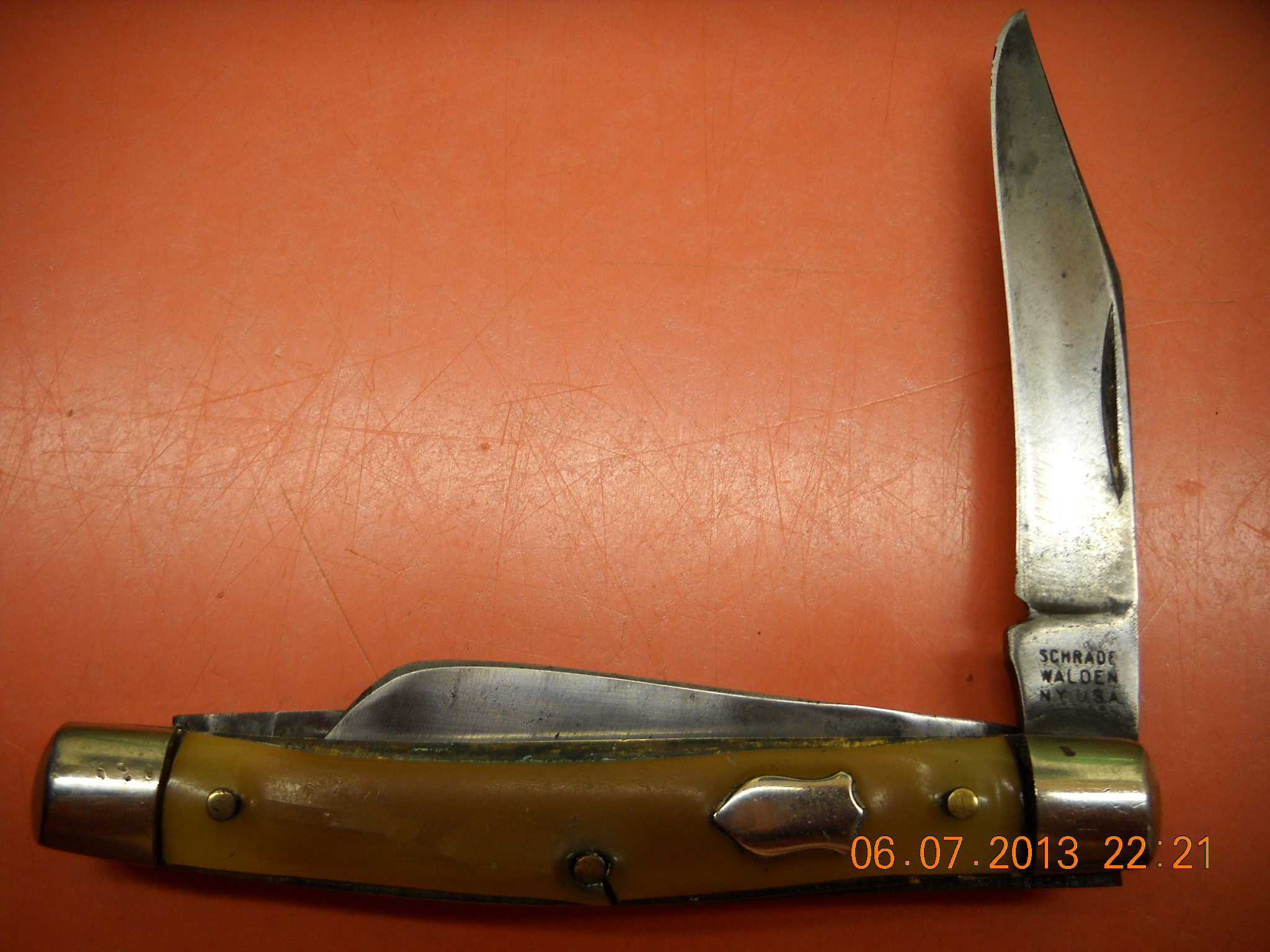

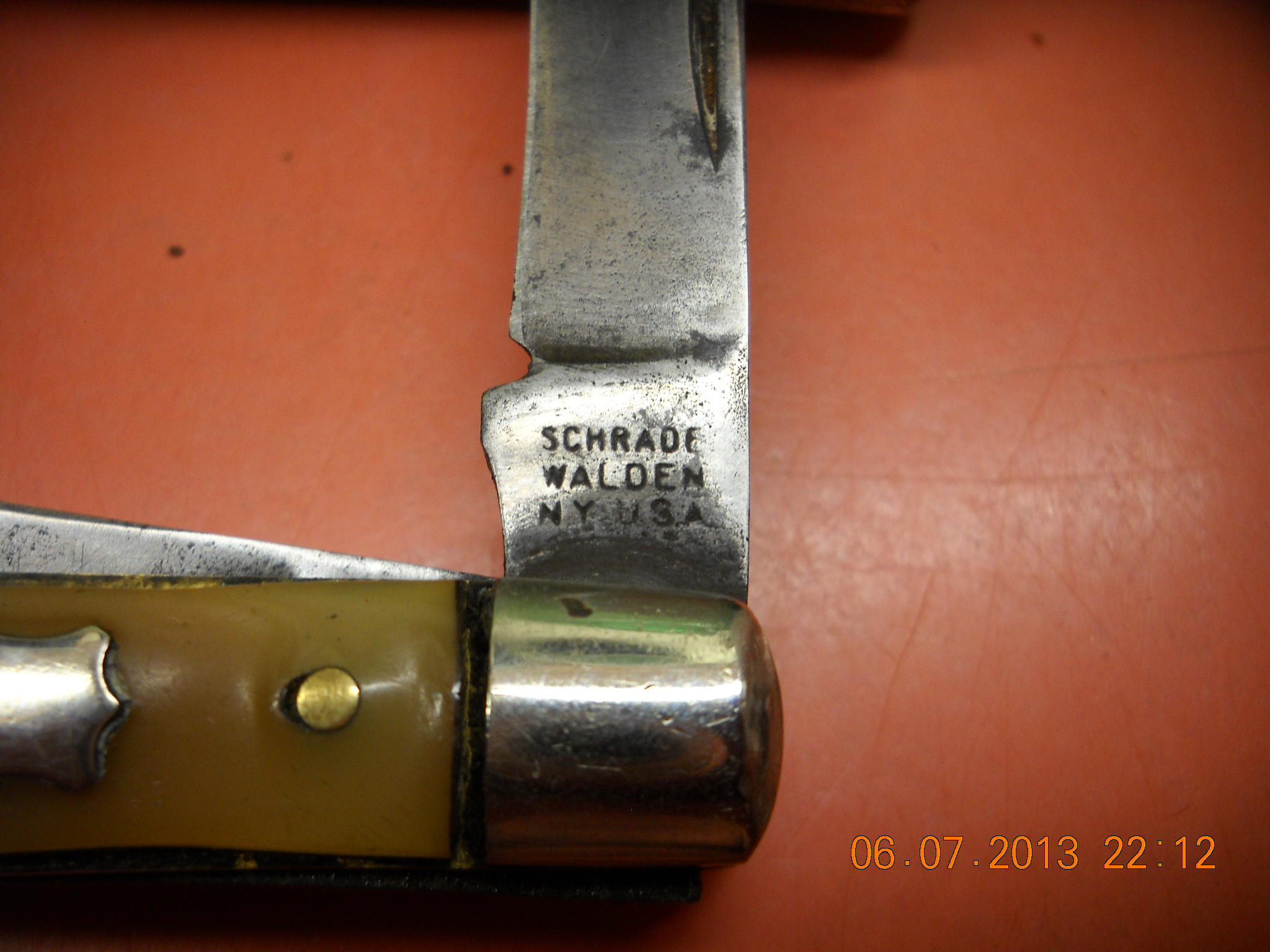

I guess this is a small stockman 3 1/4". Good blades, all snap like new but the scales are shrinking. I got it at an outdoor flea market and it was in a glass covered box and was so hot from the sun, I had to let it cool in the shade before I could handle it. Did the exposure to the sun over a period of time cause this? Are the scales celluloid and they're just going bad? There doesn't appear to be any crumbling of the scales or deterioration of the brass liners or blades.

Wow! If I had to guess, I would agree with you that the sun did that, especially with the absence of typical corrosion associated with outgassing. I see those types of vendors at the flea markets, that keep all their stuff under glass. Most of the time, I will not even ask them to take stuff out for me. I understand being concerned with thievery, but I like to be able to pick stuff up and check it out on my own.
Those could be cell, as it is a Walden, or an early composition. In that shape, you will want to keep an eye on it, cause if it is cell, then the exposure to the sun may set off the outgassing reaction. You may also want to keep it stored away from your other knives for awhile.
Or, you could mod it...
ETA...now that I look at the first pic up close, the material does have cracks in it that remind me of outgassing of cell...

Oh yeah Philip....she's coming unglued!!
The celluloid is breaking down....

It's an 834Y yellow cell. Check the number on the back tang if it has one. That's what that stuff looks like as it shrivels up.

Re: Shrinking Scales
Phil,
I see a crack in the handle toward the rear bolster and corrosion around the rocker pin.
I'll bet you a new hat (a USMC baseball cap)
that it is starting to out gass!
If it were mine it would get new yellow bone handles.

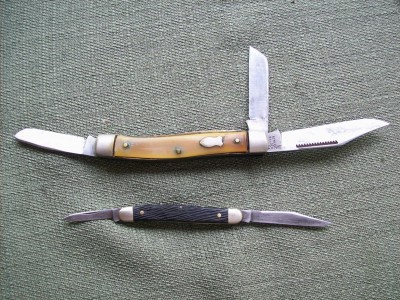

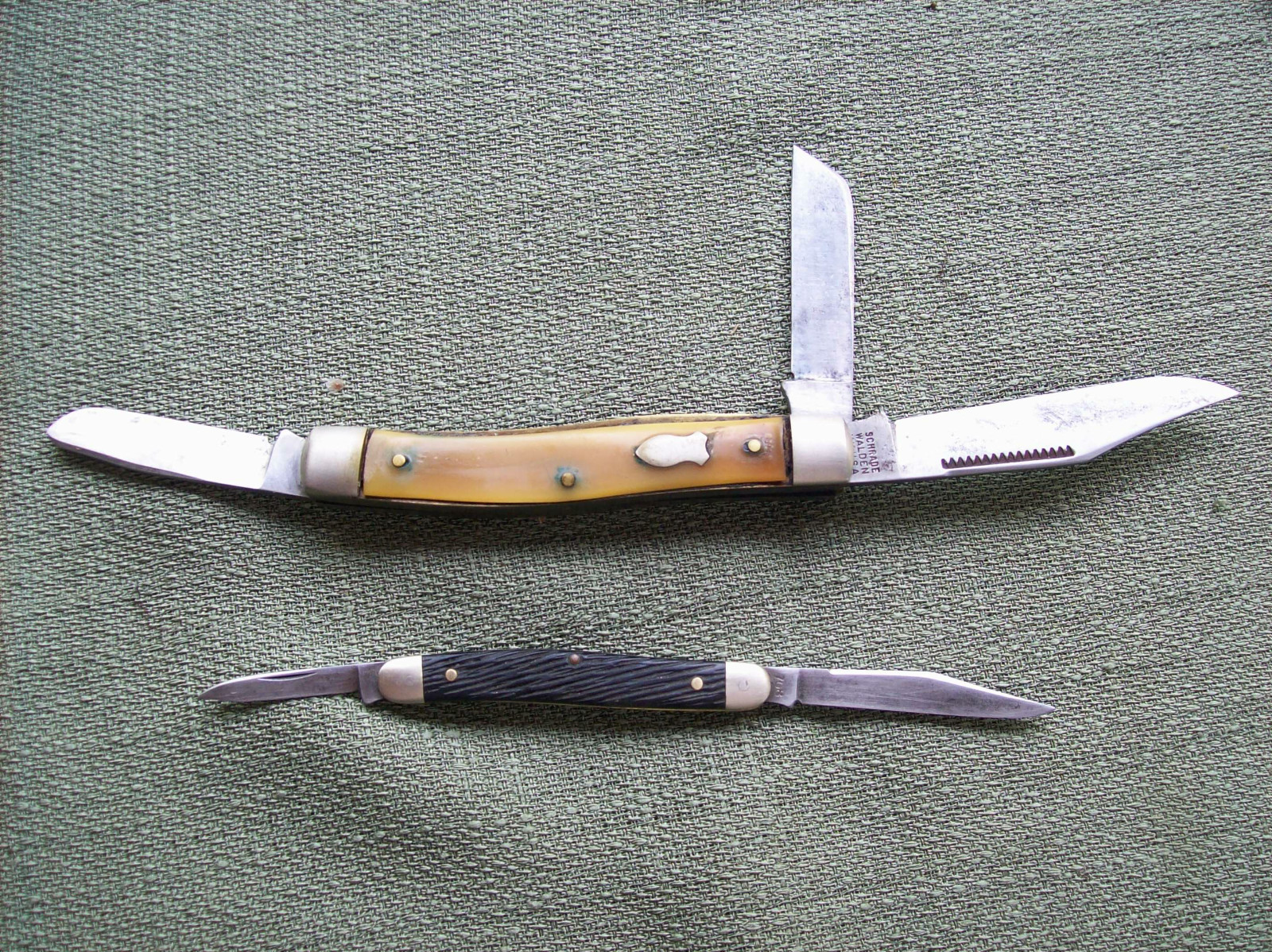

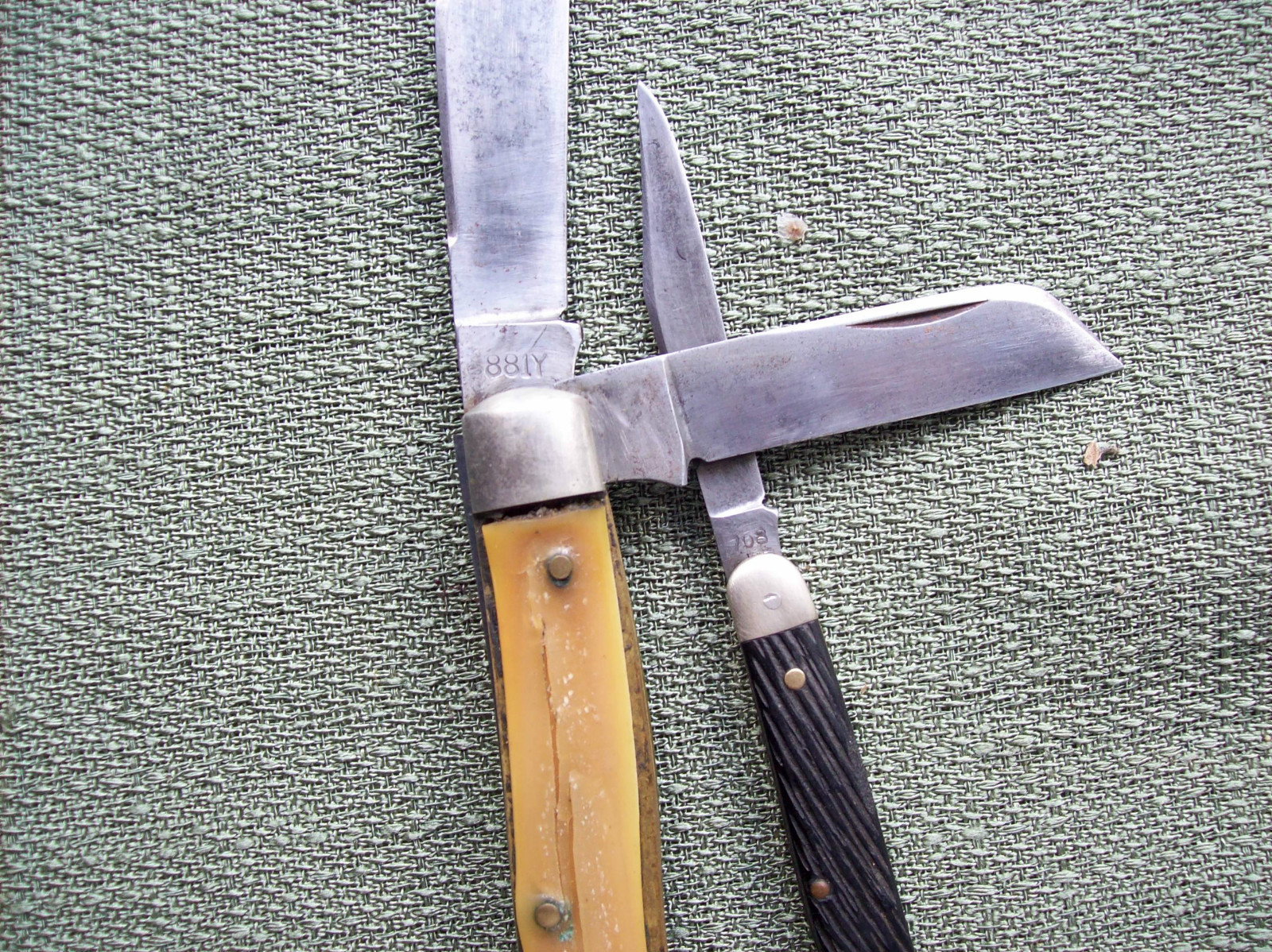

We all rejoice at hearing that you are able to do some cutlery work again, Dale; you have had some "interesting" challenges the last couple of years. I do have one of those 835Y yellow birdseye stockmans that would love a re-handle. Now, here is its big brother, the 882Y, same size as a 881Y. This one is in Delrin and feels just fine:
