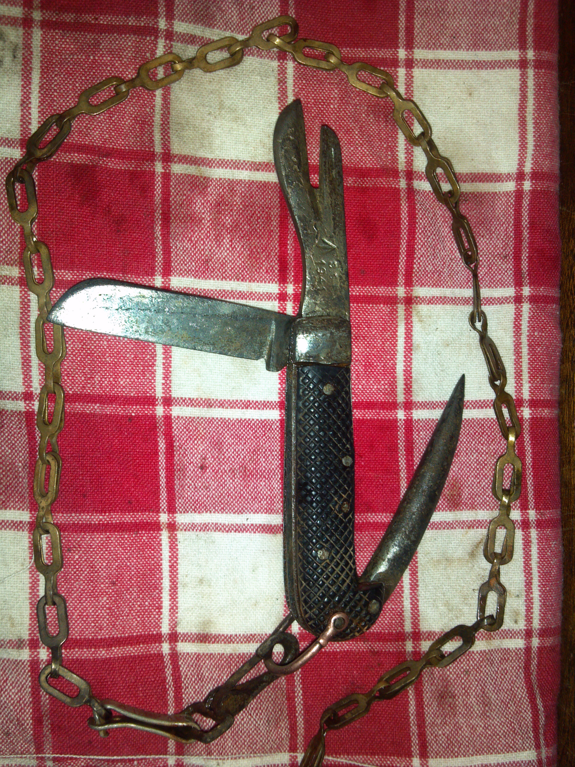

Those interested, I had a post about a riggers knife I got at a yard sale in Montana. Here is the link: http://www.allaboutpocketknives.com/kni ... =2&t=37459

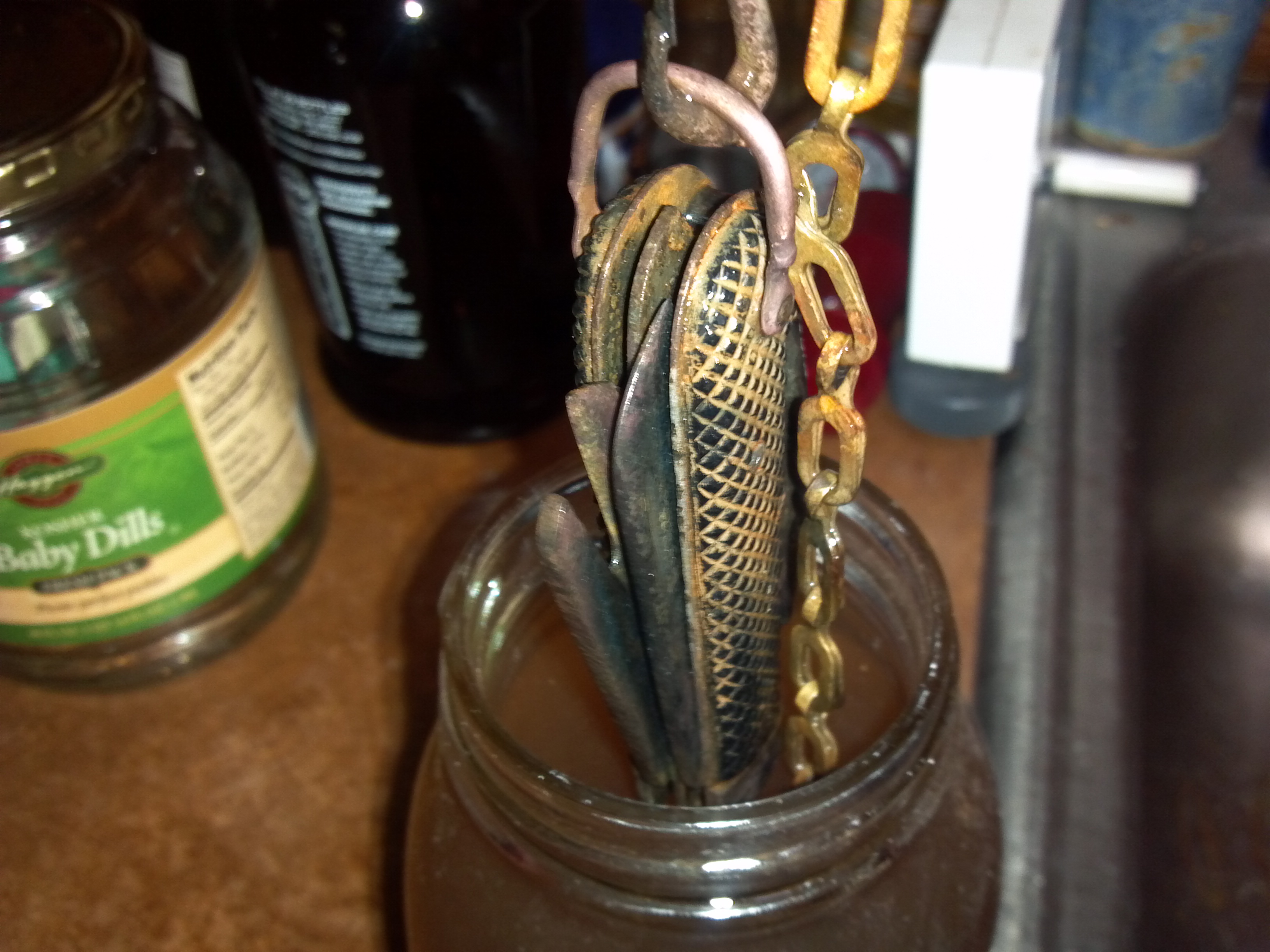

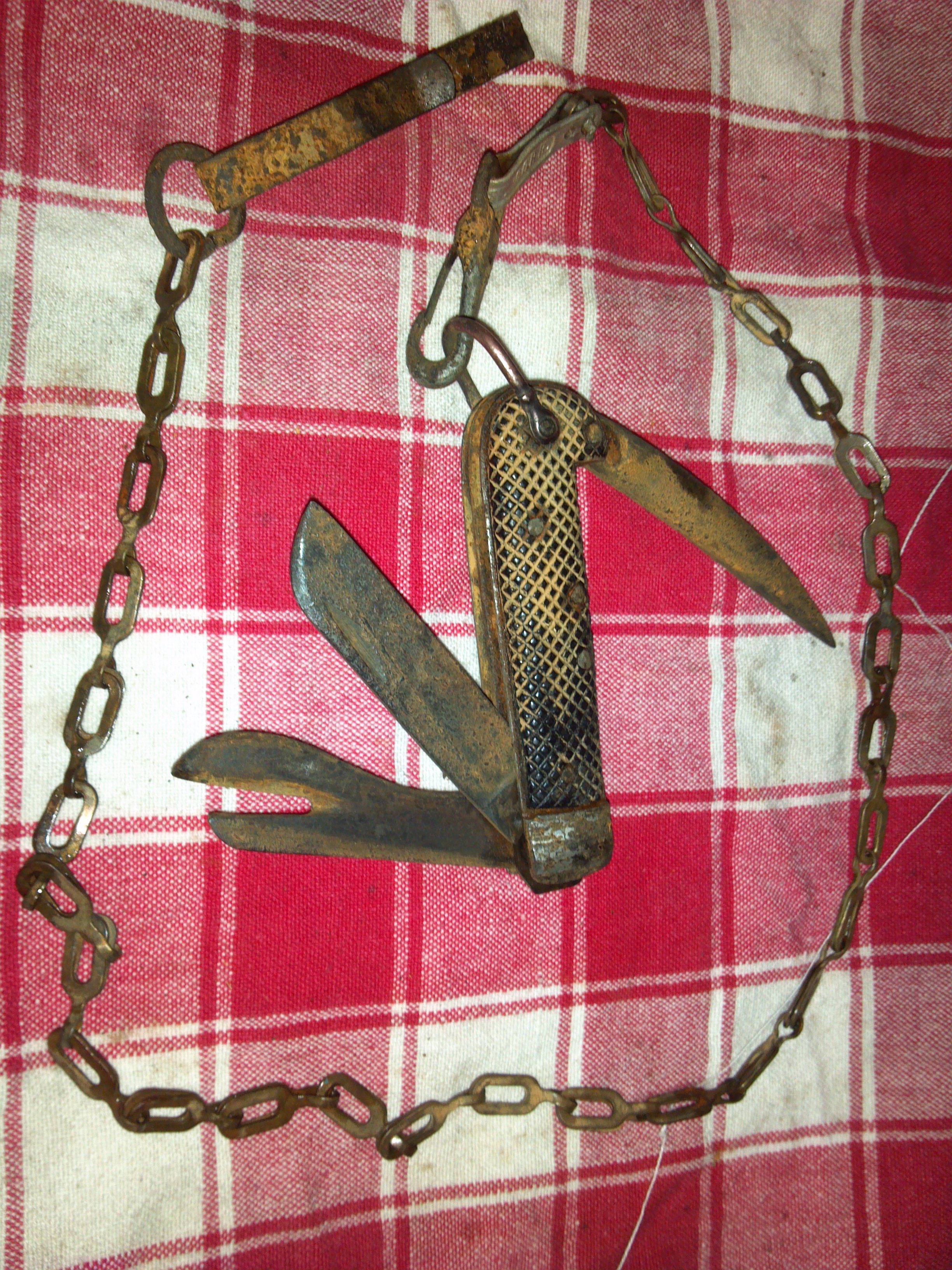

The knife was fairly badly rusted. Because of the rust, the blade, marlinspike and can opener were all very difficult to open. The farmer I purchased the knife from suggested a water/molasses mix of 4/1. He also said to use "feed" grade molasses. This is the stuff I opted to use: After letting the knife soak in my 4/1 mix for 48 hours, this is what the knife looks like currently without any scrubbing with a steel brush or scotch brite. I can definitely say there is improvement in the snap of the blade and can opener. I have placed the knife back in a new batch of the mixture and will take it out on Sunday with the intent of seeing if I can get the rest of the rust off.

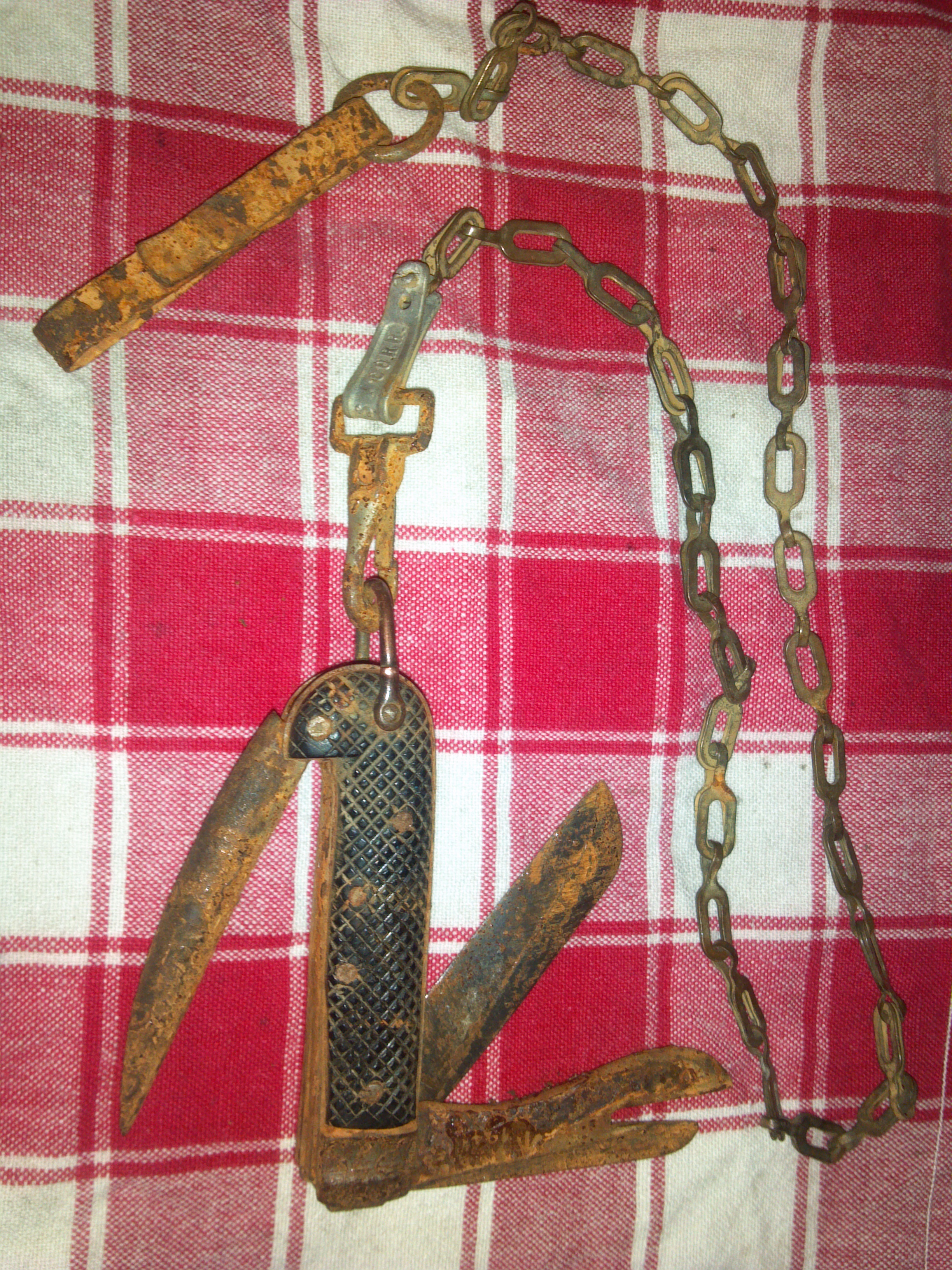

For those that want to know what the knife looked like before the mix, here is that pic:

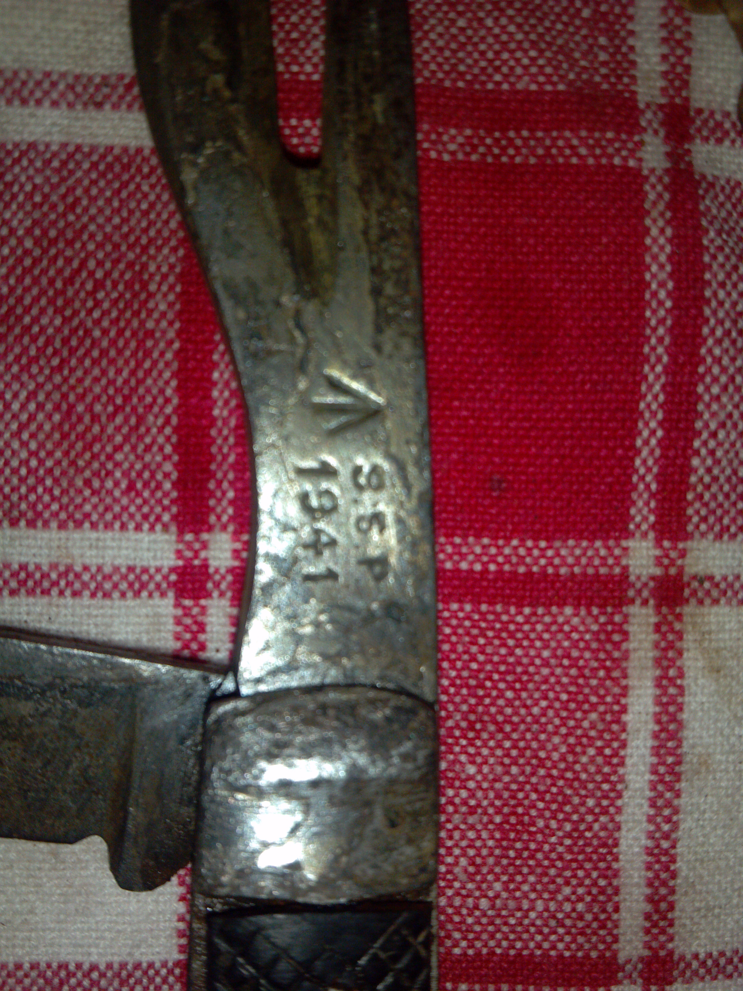

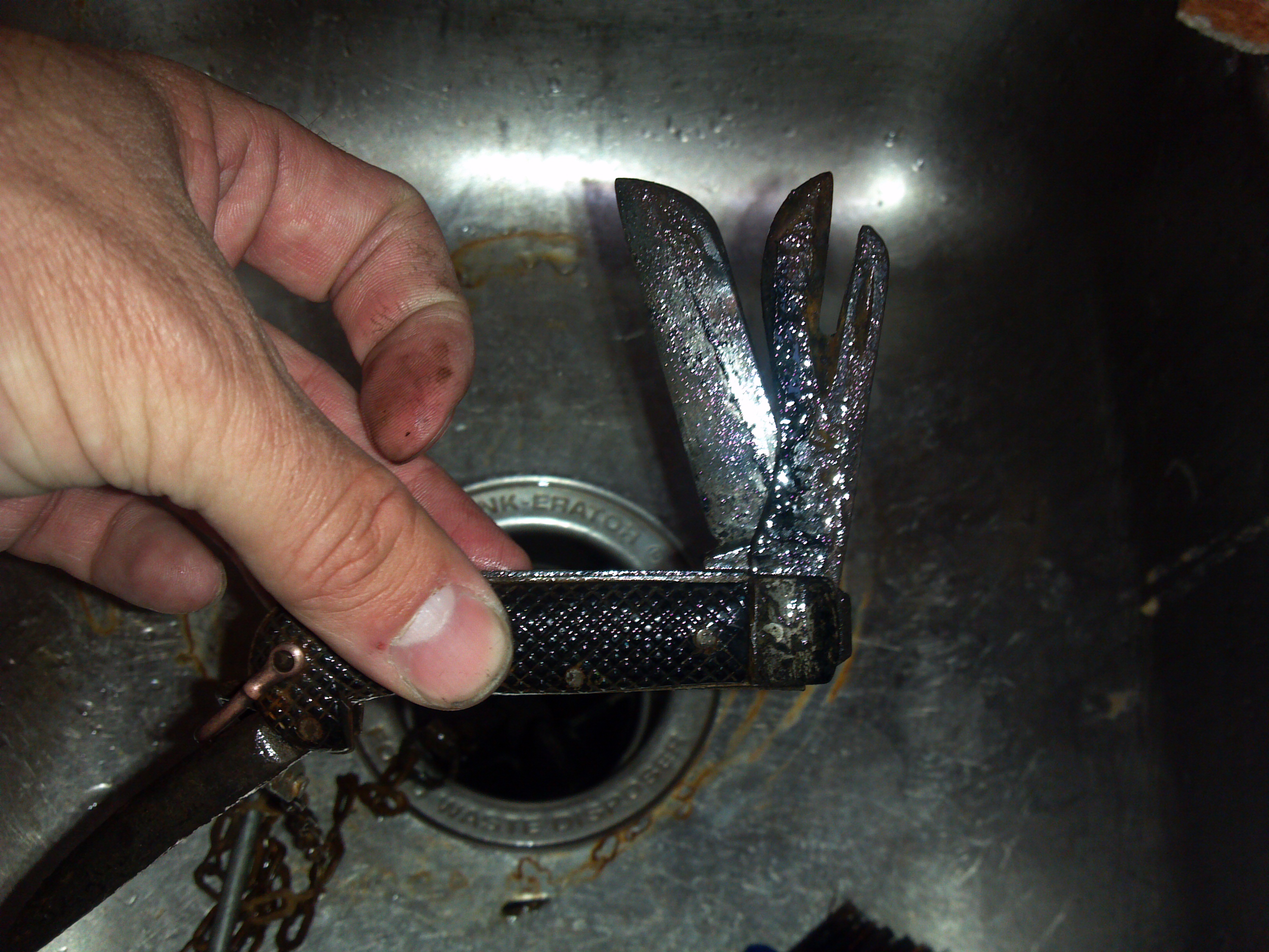

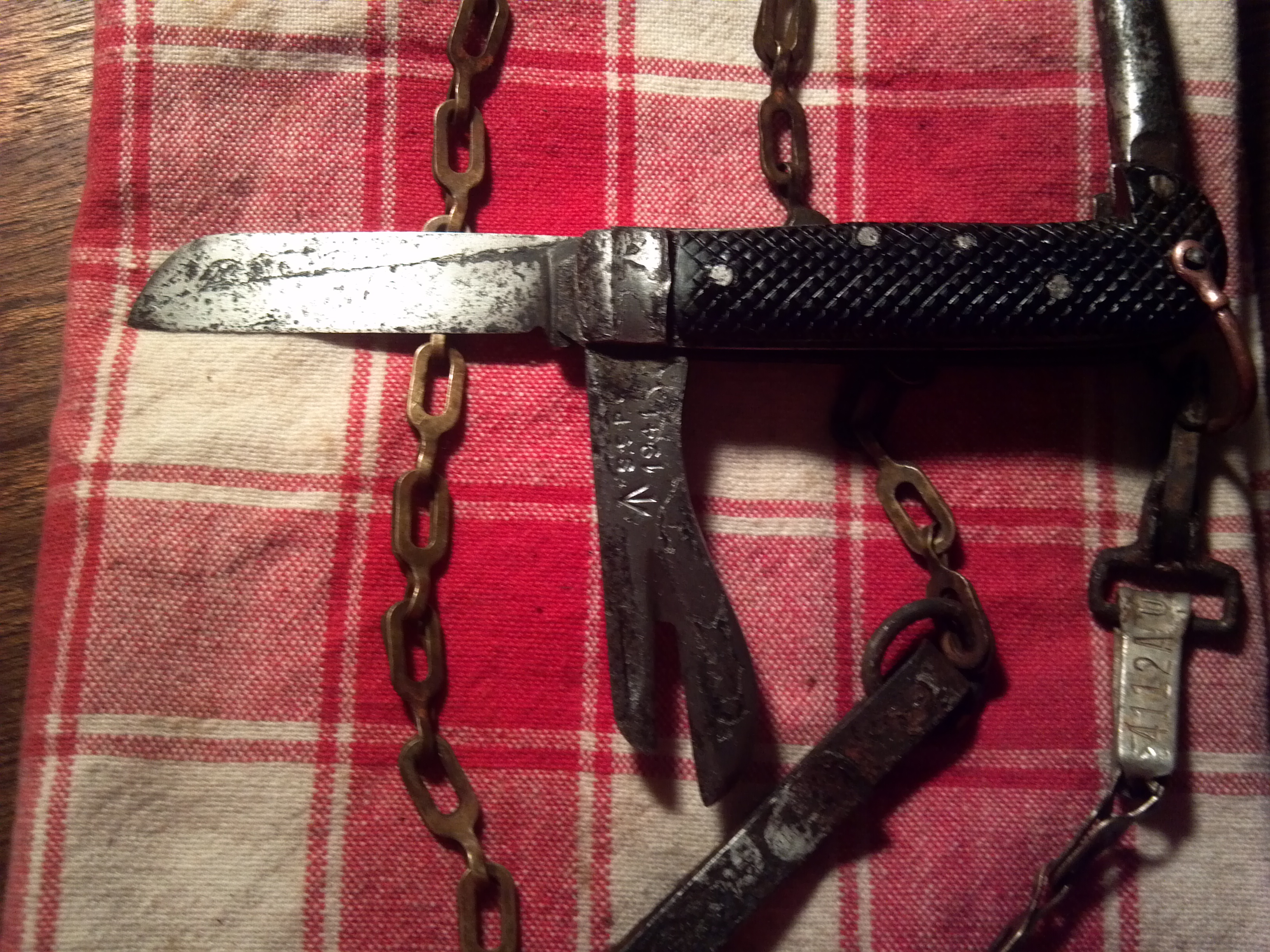

Ok, I must say I'm, a bit disappointed. After a total of five days in my mixture, the knife still has some heavy corrosion. I suspect that is was the feed molasses mixture. Next time I will try the much darker and thicker cooking molasses.
Here are some pictures after rinsing and some scrubbing with a wire brush.

Ok, I just cleaned them after a week in the oil bath. What do you think?
Scrubbed it with scotch brite and then hit it with a degreaser. I oiled the joints and the blades move smoothly.

That looks like it did the job pretty well!
