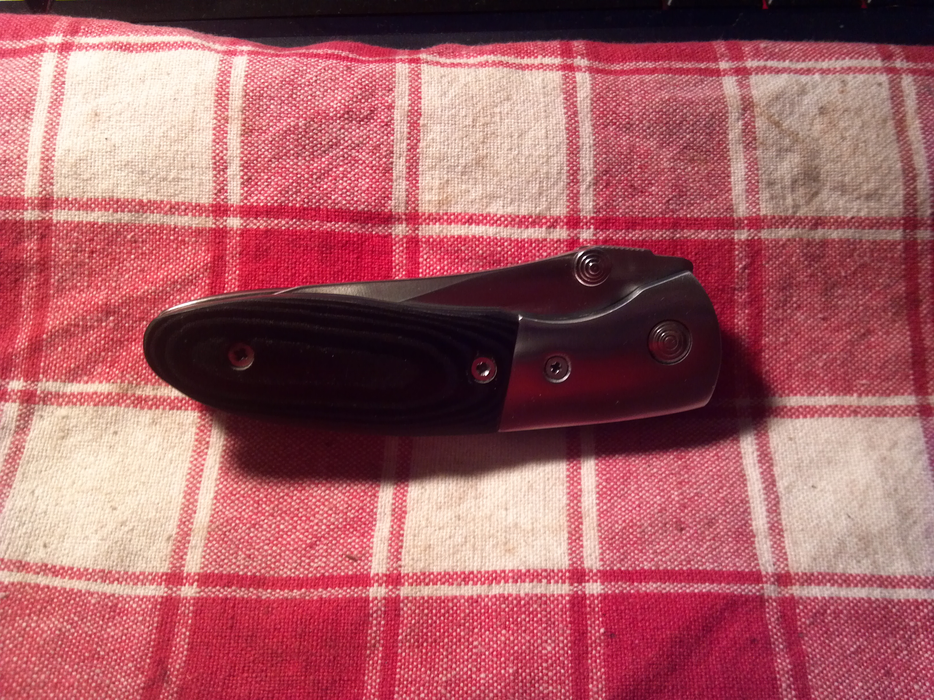

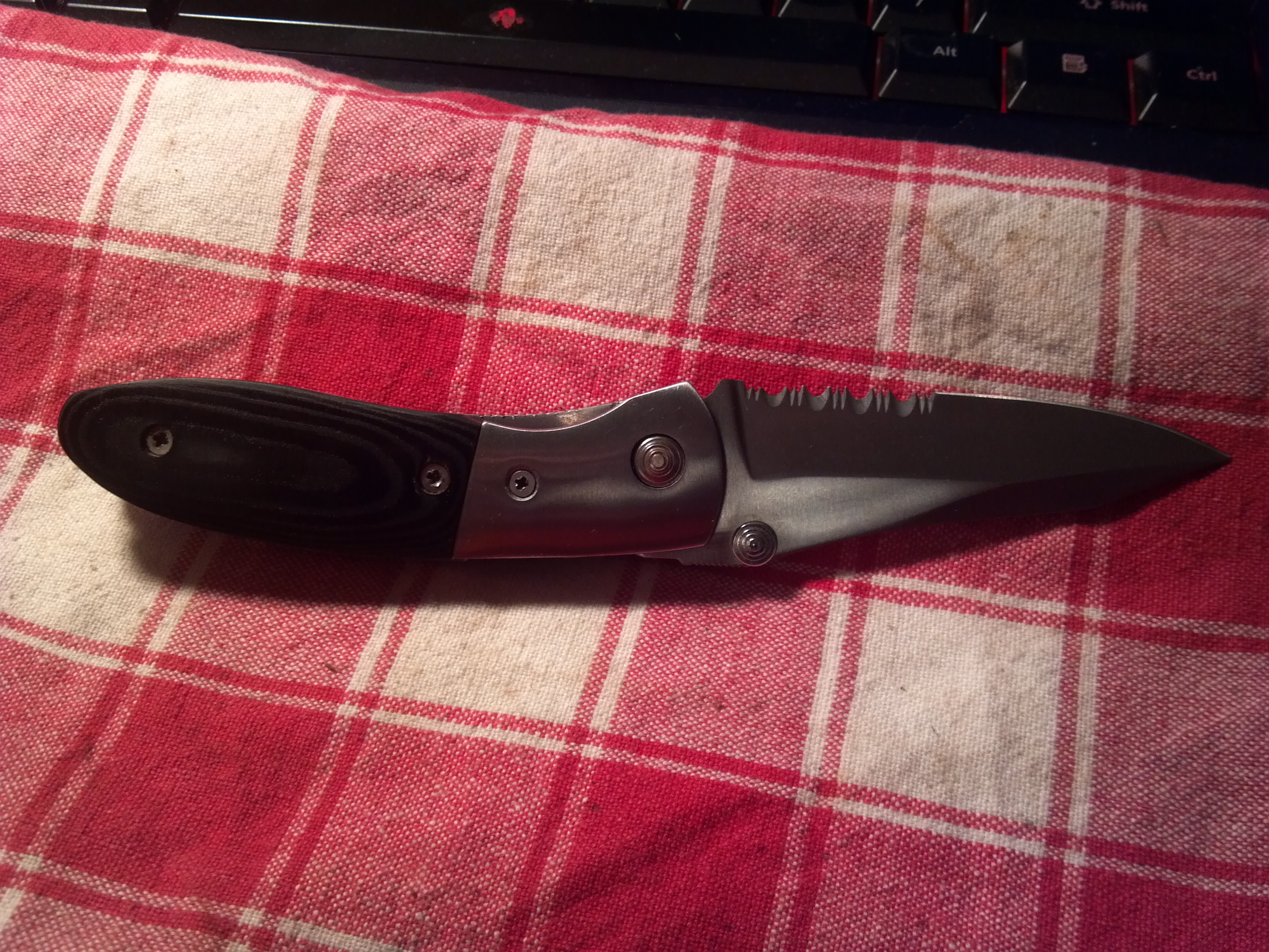

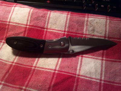

I got it yesterday for free at a garage sale. It was an "assisted opening" knife where the bolster slides ever so slightly, releasing the spring forcing the blade open.
The problem was according to the previous owner was not only wouldn't lock correctly but when it did lock, it would open up suddenly in his pocket. He said the final straw was when it opened up by mistake, it almost sliced his finger open.
AFter taking the handles off, I inspected it as thoroughly as I could to see how the mechanics were suppose to work. I noticed that when the bolster slid down, it wouldn't release the spring. So I opened it up a bit, cleaned it out (lots of grime and pocket dust) and filed the spring ever so slightly as to help it latch when closed but also release when moved. I also rounded the end of another screw that appeared to get in the way.
After putting it back together, I have tested it now over 50 times without it having a hitch. However, it will open up if jarred to heavily.
I just wanted to thank all you guys and this website. Without the information here, I might not have even tried to salvage this Chinese import. Now I'm even thinking of replacing the cheap plastic handles with wood and sell it at the next gun show for $25.00.
I fixed my first knife tonight!!
