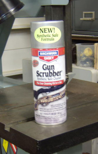

I would clean the knife with Birchwood Casey's Gun Scrubber. Available at most gun stores, Big 5, Wal-Mart, etc.
About $5 for the smaller can shown here. It won't hurt the handles, whereas warm soapy dishwater may accelerate the oxidation of the Blue Delrin.
For some reason I have seen a lot of the blue Delrin that has oxidized; it gets a white layer on it.
The Gun Scrubber won't cause that, but sometimes warm soapy water will.
The mineral oil will keep moisture away from the steel (preventing rust in most cases) and it will coat the brass & Delrin too help keep out contaminants. It helps keep the knife oiled too. I would work it into the joints also unless you use something like Quick Release on the joints, which I highly recommend, BTW!
