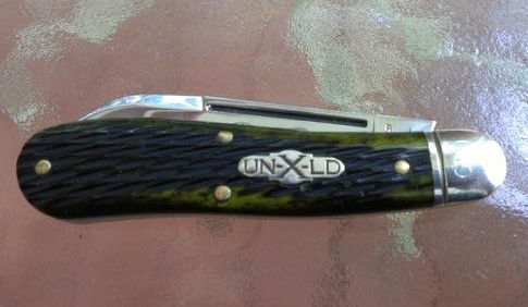

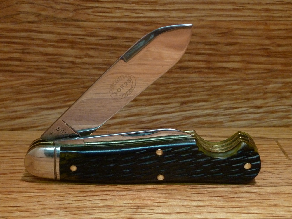

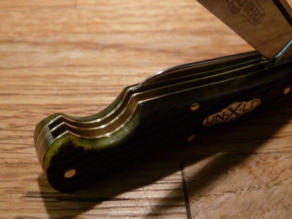

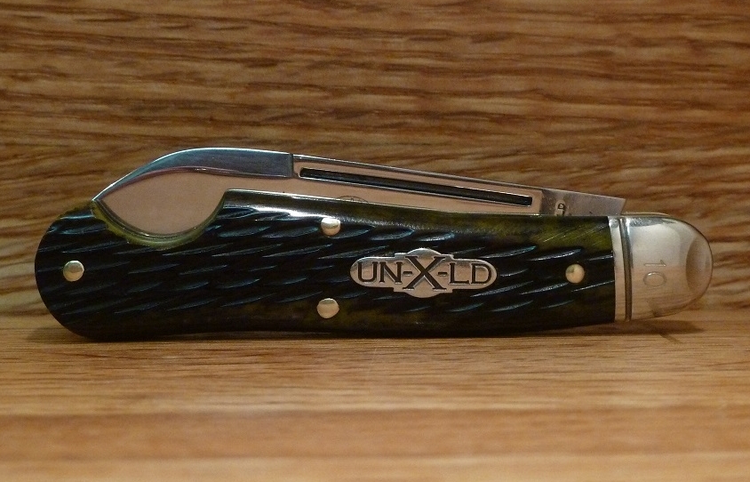

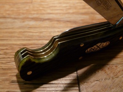

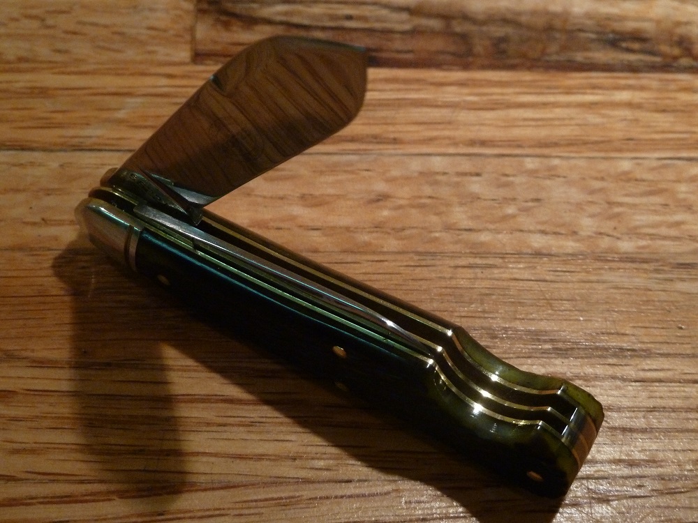

I got a good price on another GEC #56 Dogleg and decided to add an Easy-Open notch.
Was not too difficult and I am happy with the results........ 8)
IM
Before EO Mod
Before EO Mod

Very cool man. You can't go wrong with a eo knife. No matter what pattern it is it looks better with eo notched out,in my opinion.
Looks like you did a very professional job. ::tu::

Good job Trevor. I agree with Phillip, I think it improved the appearance of the knife but then I may be prejudiced 'cause I'm an EZ-Open fan.

Nice job Trev ::tu:: ::tu:: I think the EO notch really adds to the knife ::tu:: ::tu::

Well done Trevor. You made it look like it came from the factory that way. ::tu::

very nice, dremel tool works wonders eh? if you can live with 3/16" lanyard tube the spring and liners can accommodate drilling out to the larger size and using the tube at the butt end pin

Jody744 wrote:Very cool, what did you use???
Used a dremel with a drum sander attachment and then a large bolt with fine sandpaper wrapped around it to finish.
Buffed with dremel a little to remove sanding marks.
