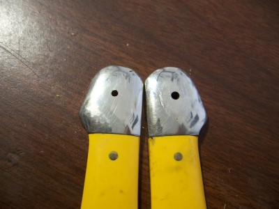

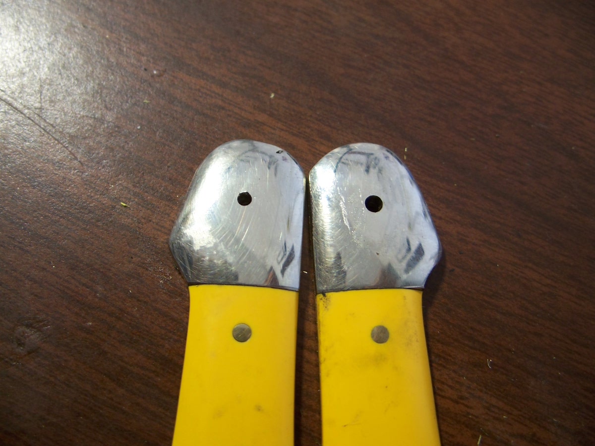

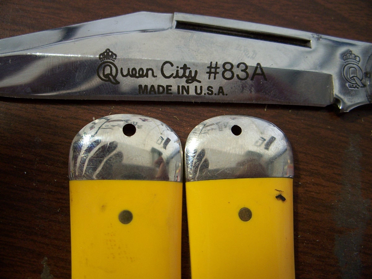

I suppose you see alot of oddities when you work on so many knives. Whilst rebuilding queen #83 cokebottle folding hunter today I quickly noticed upon disassembly that the mark side bolster holes (the butt and pivot holes) were considerably smaller than the pile side holes. Maybe done on purpose for use with a tapered pin, or maybe a screw up. I did note the pin was flanged out a great deal on the pile side while the mark side end of the pin was not flanged at all. The pile is exactly 3/32" the mark is right about 5/64". Just thought I'd show ya'll.

it looked like it may have been tapered, hard to really tell after it's been sheared in two

MM,
Is the hole through the blade & backspring tapered too? If so I would make a new tapered pin on my disc sander.
If the holes are not tapered, the easiest thing to do would be to drill out the smaller hole.
I am really curious now if the holes in the blade & backspring are tapered.
Please let us know.
Please let us know.

well, a bit more work on it today confirmed that the pins are/were tapered. The holes in the pivot, butt and rocker areas of the spring and blade are tapered. the pile holes are 3/32 the mark holes are 5/64 the spring and blade are midway. I learnt something new in knife construction today gotta love that

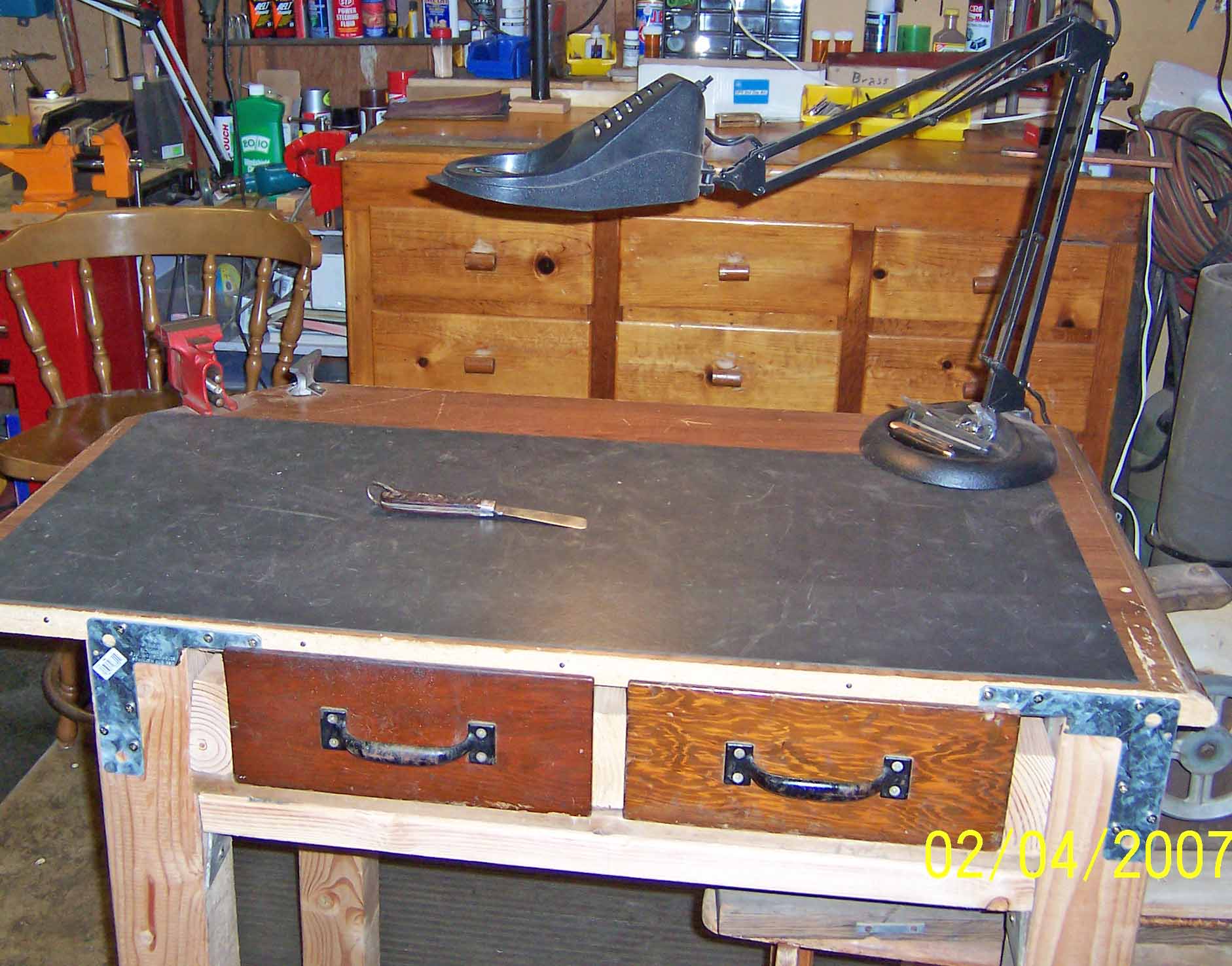

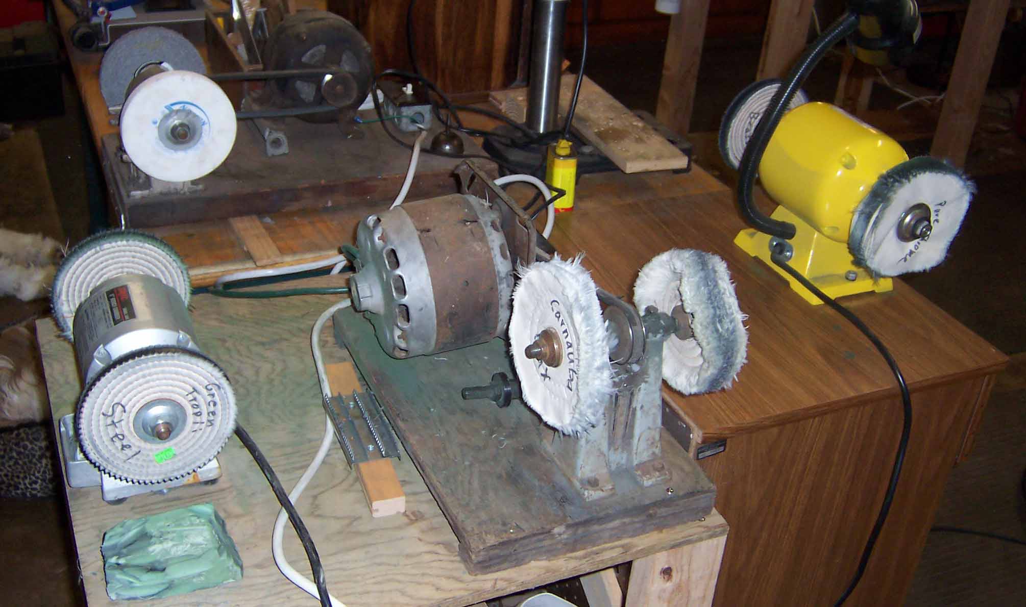

I have lots of vices.... I mean vises.
I have a variety of jaws I have made or bought for my vises, brass, soft rubber, hard rubber & Micarta, as well as the standard steel jaws.
I have lots of hammers too, but I didn't bother to show claw hammers etc.

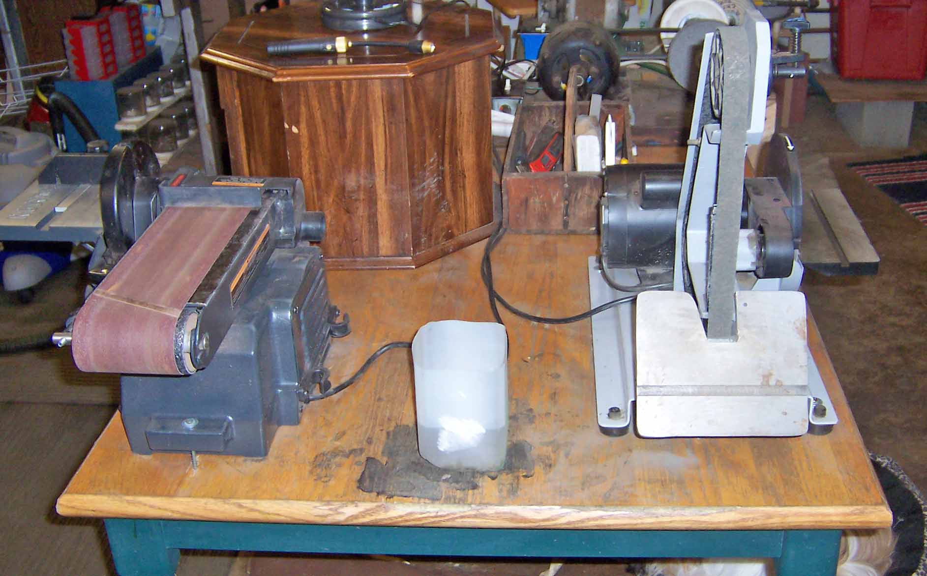

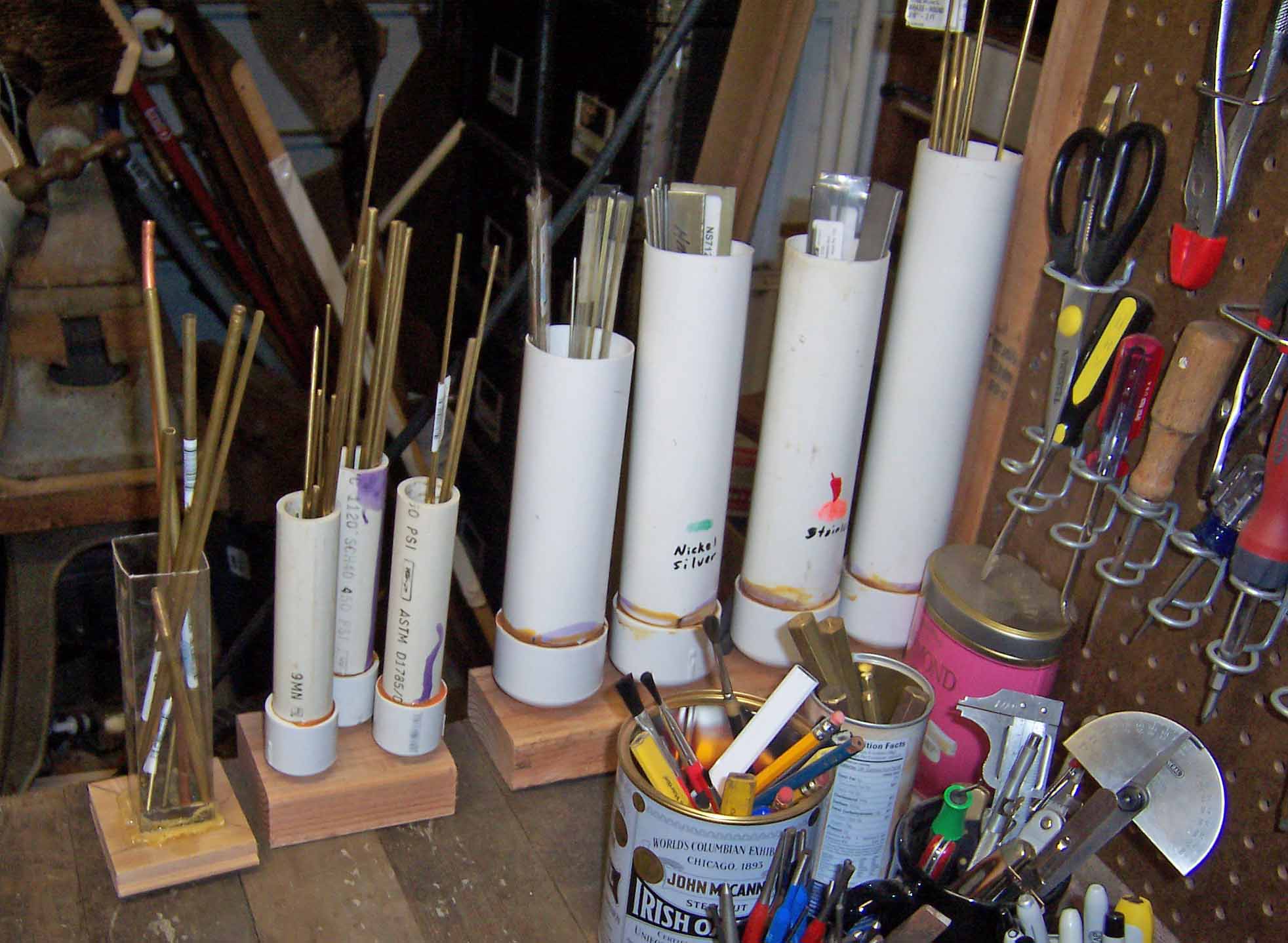

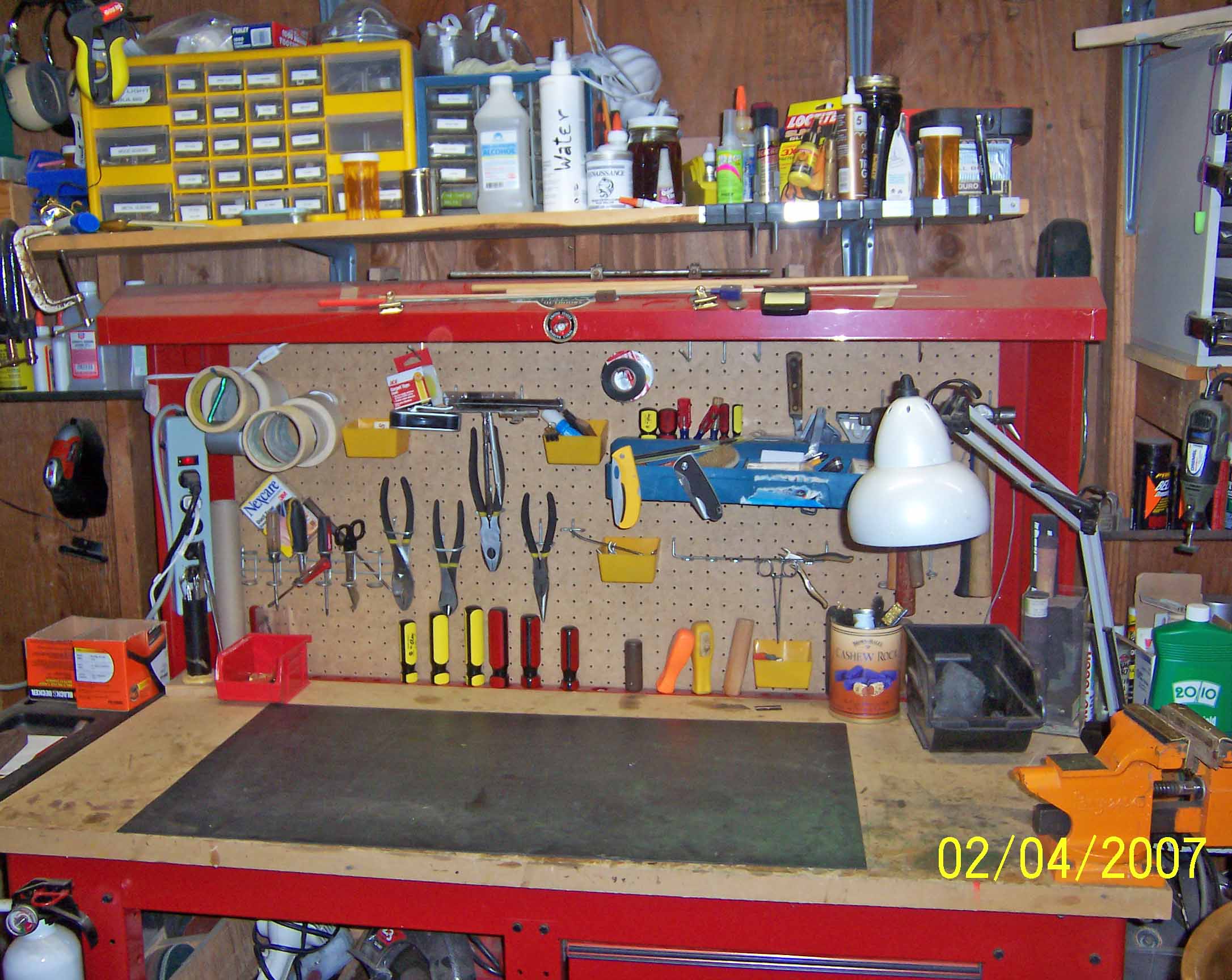

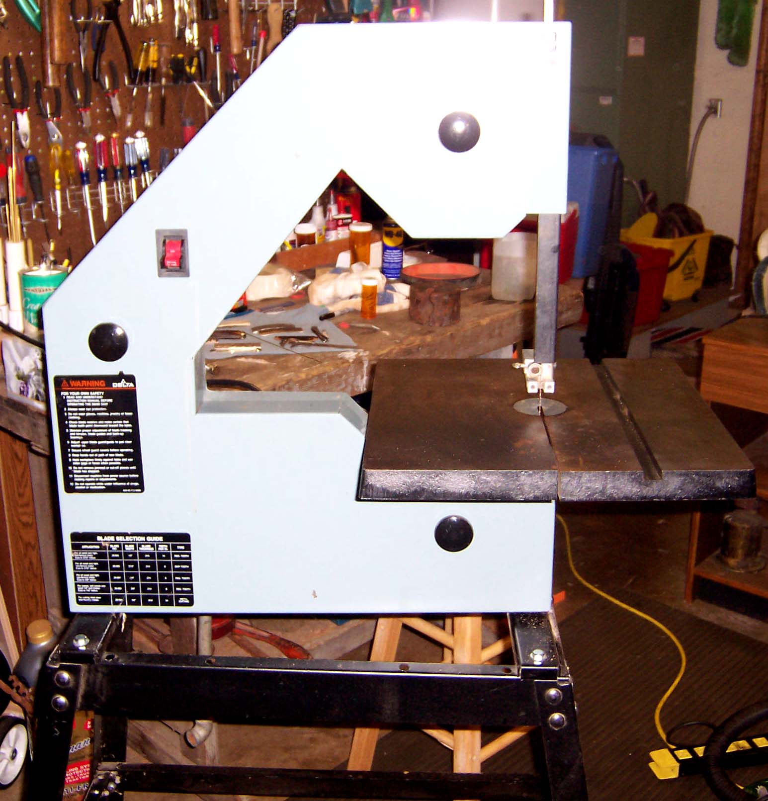

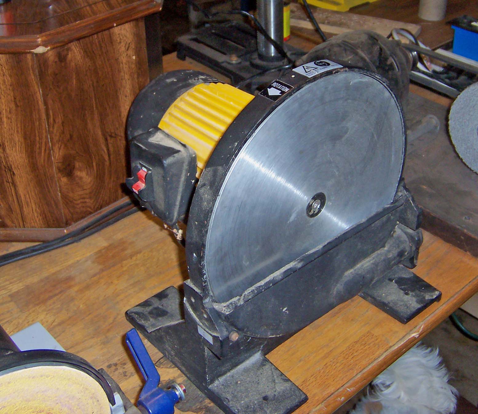

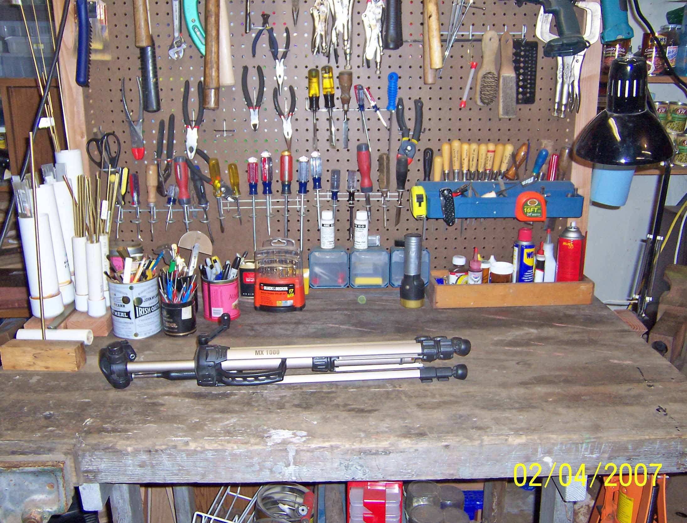

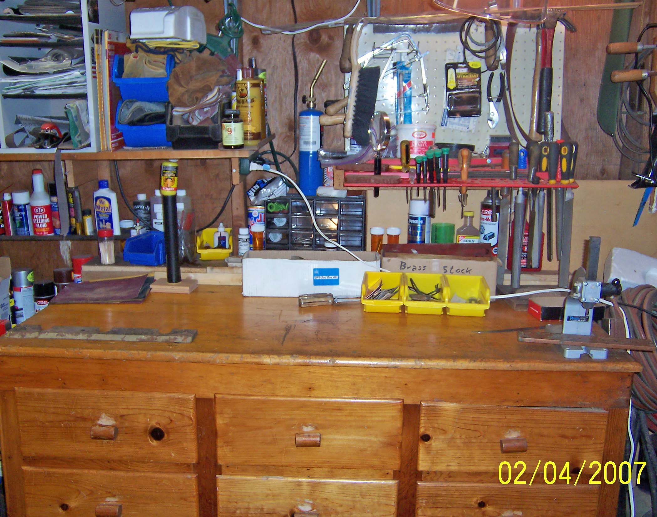

My shop usually stays fairly clean. I have a 7 year old granddaughter who loves to clean it for me...............this usually leaves grandpa a buck or two poorer.
I figured I might as well show my shop while I am at it. I am really happy with my new (to me) 14" Delta band saw, made in the USA!
How about it guys..........Show us your shop!
Sorry MM, I didn't mean to hijack your thread,
