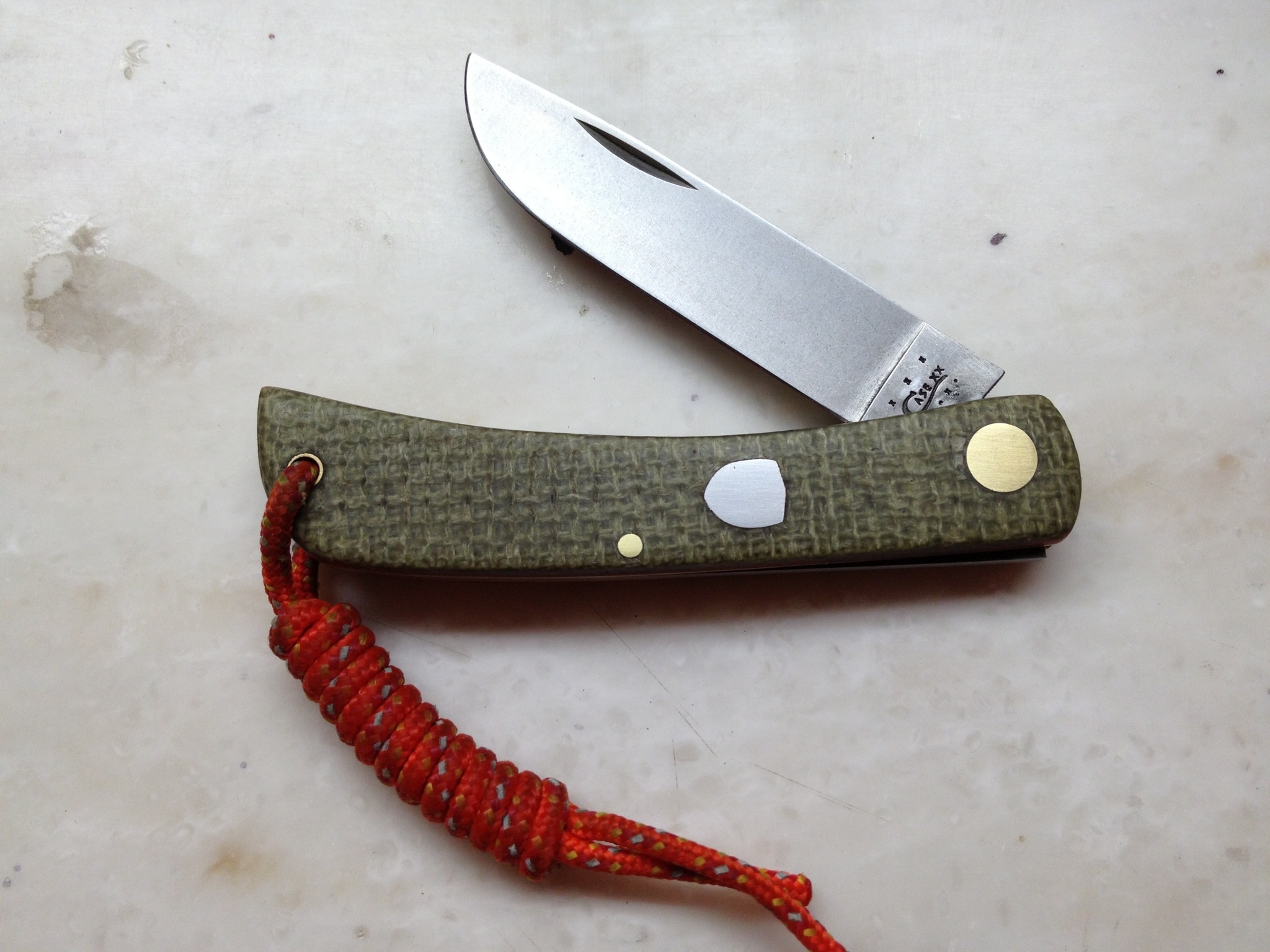

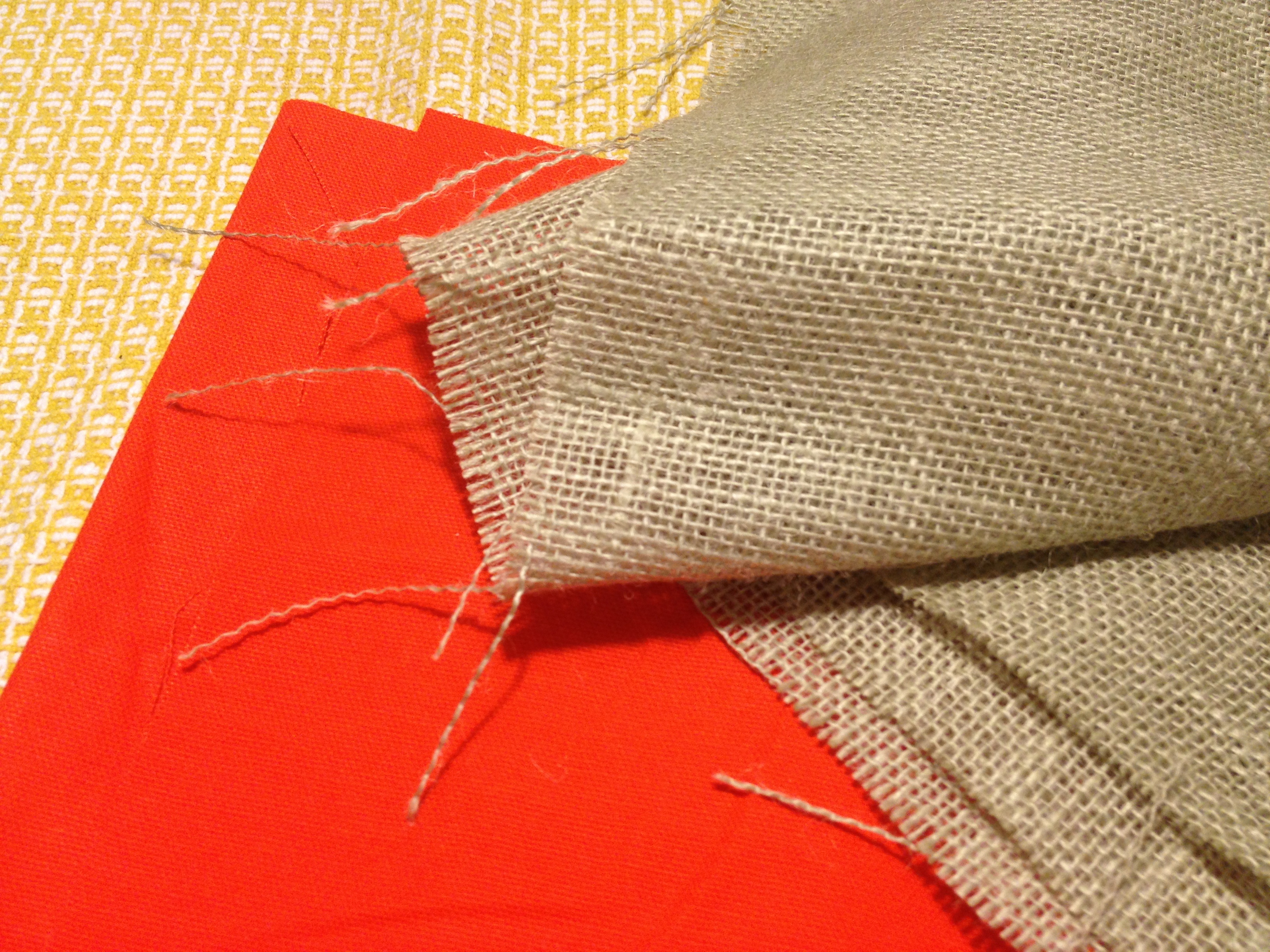

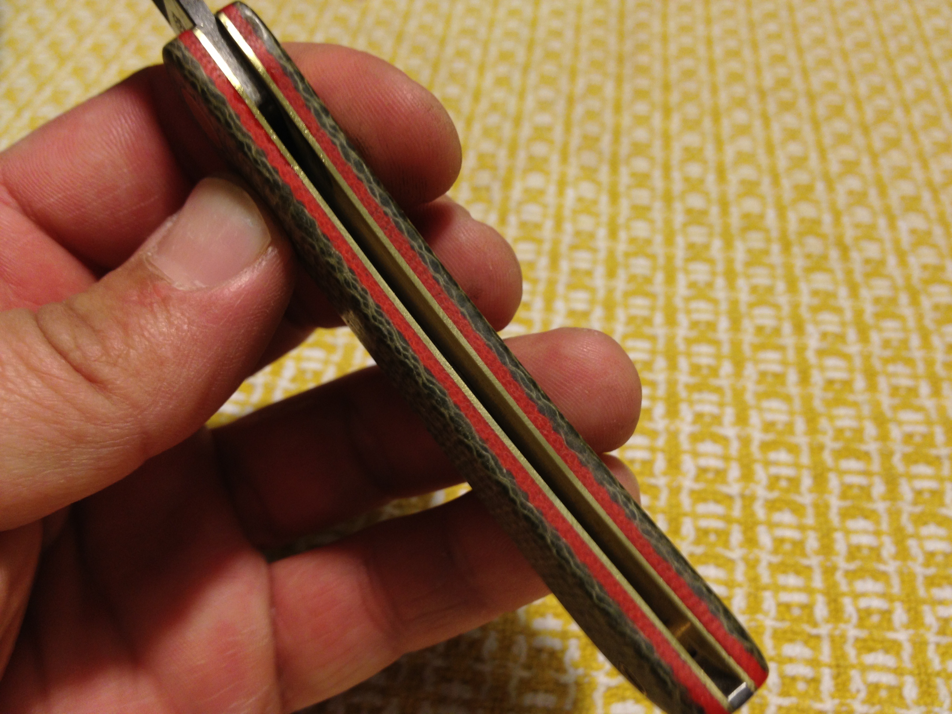

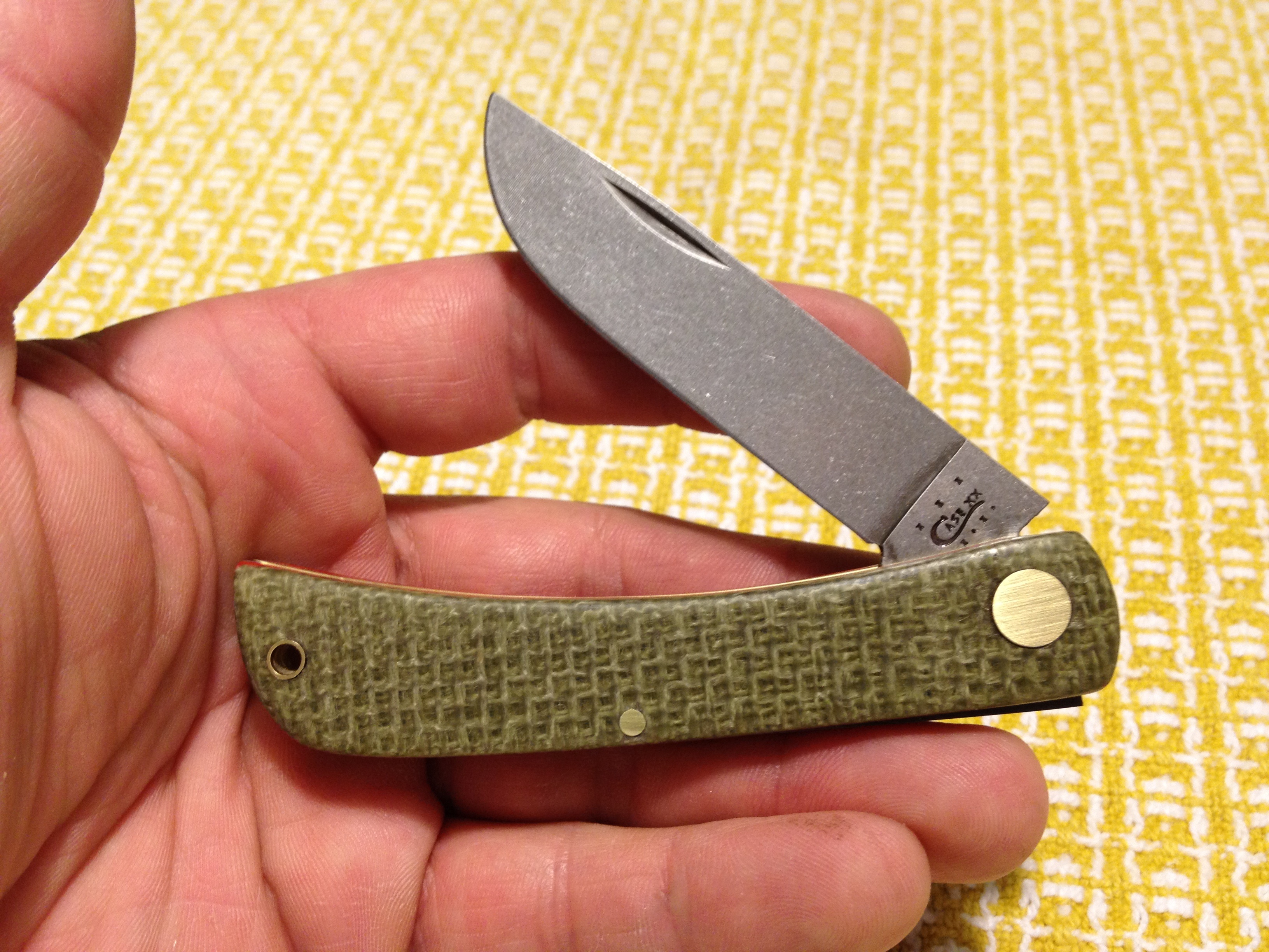

I tried something a little different today. Burlap and canvas with fiberglass resin, stonewashed blade. I think it turned out pretty cool.

I like the end results a lot... Was this your idea?
terdl76
- Posts: 143
- Joined: Tue Oct 30, 2012 7:25 pm
Re: Fun with burlap
Yes/No, I've seen a bunch of videos on YouTube in how to make homemade micarta. Seems like you can use just about any material and fiberglass resin in a vise.

What has my attention is the lanyard hole!! Nice touch.
What size is it and how did you make it?
(PS Where can ya find CLEAR resin? I would like to try and make some material myself.)

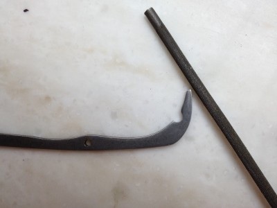

I actually got the resin from Home Depot. It's not really clear, kinda amber in color. As far as the lanyard I believe it's a 5/32 bit. Drill the holes out on the butt end of the liners only and then use a small round file to open up the squared off opening of the backspring to fit.

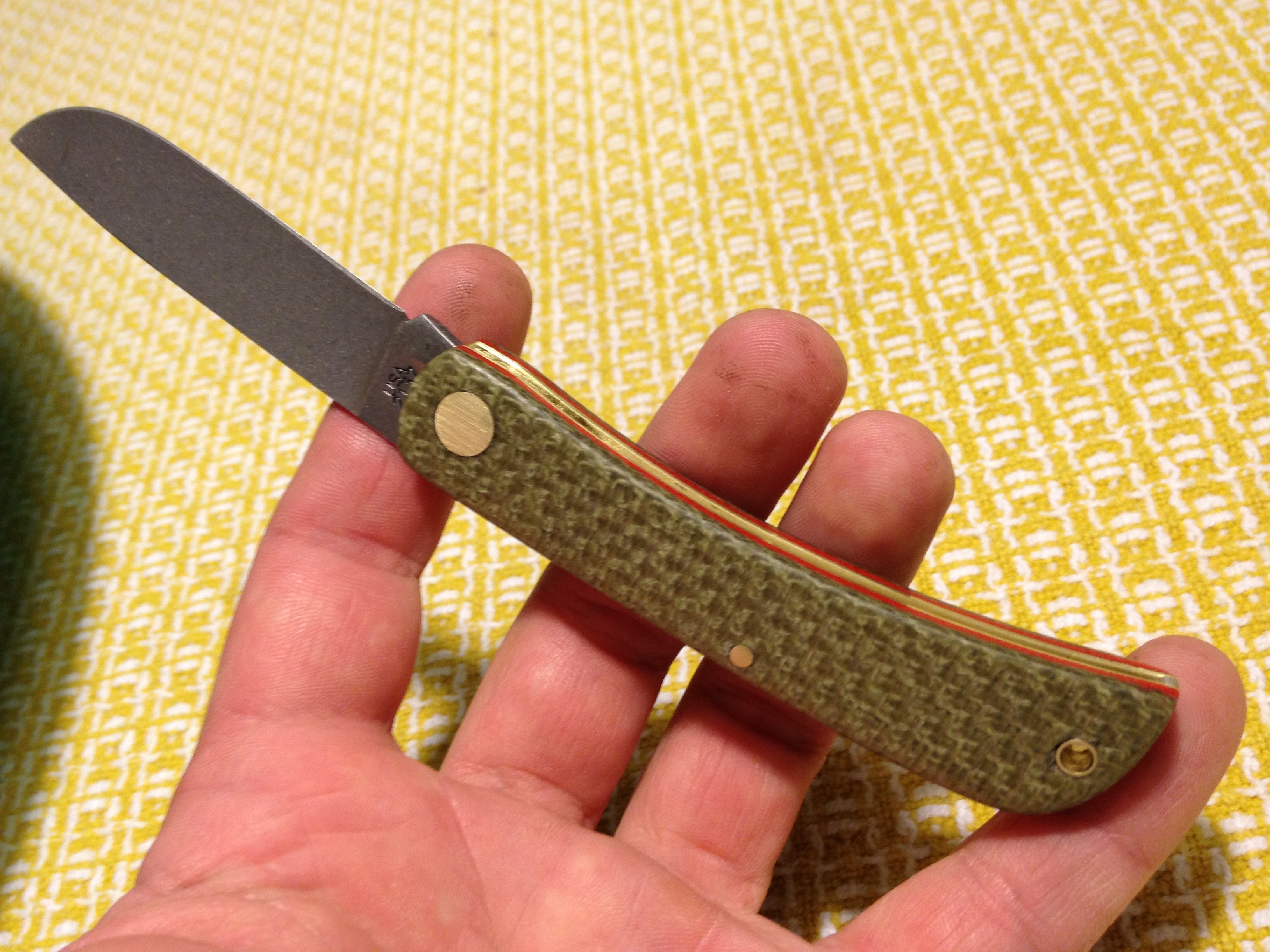

Just couldn't leave well enough alone. Tried my hand at puting in a shield and added a lanyard.
If it ain't broke, break it!

NICE job on the shield.
Did you make it from NS? How hard was it ti inlay in the burlap & resin?
