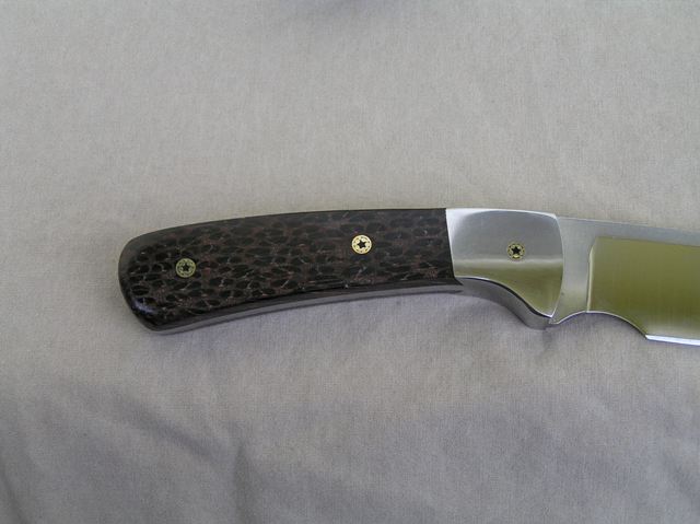

Here is a skinner I put together using stabilized Black Palm. Black Palm is actually in the grass family and is the outer bark torn away from the rest of the tree. It has to be stailized to be used on knives. I still need to finish it, but you get an Idea of what it looks like.
Black Palm is the scales on the customized Buck that Jeff did. This one is a different cut, end grain. I have a few skinners going, I'm falling behind on pictures :oops: Anyway, this is the look Jeff was after, I like the look a lot myself. I guess you can't see it, but I dovetailed the bolsters on this one.
Click on the picture for a better view.

nice hukk, is that a kit? if so details. if not? more details! ::tu::

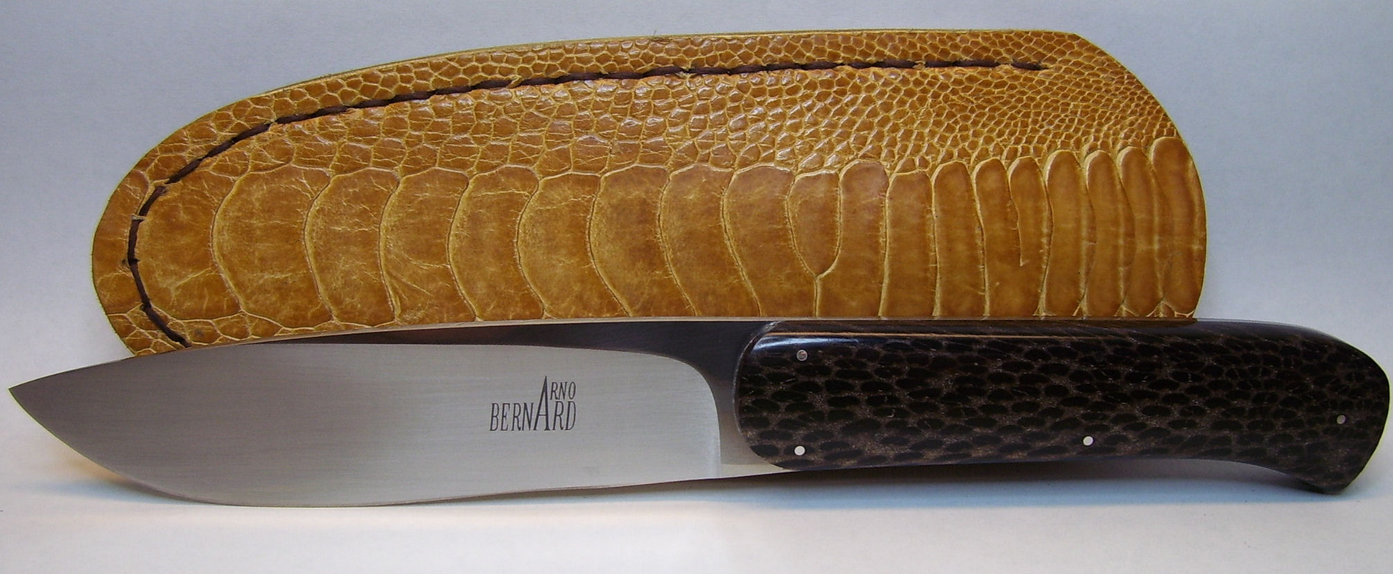

I have to say that it looks almost identical to this Arno Bernard with South African Palm Wood handles, do you think its the same palm..??

Yes, it is a kit, but I throw out everything but the blade, I make my own bolsters from 1/4 inch 416 stainless bar stock. Bolsters that came with it are about .210, a little on the thin side for my taste. .040 on each side makes a huge difference. The kit comes from knifekits.com and is the Modern Skinner model. I chose that because it is AUS8, which is about like 440c with about .25 vandium added. Better steel than AUS6. I made 2 for my brothers and gave them as Christmas presents. After they showed the knives and sheaths I made, I ended up with a bunch of these knives for orders and the Maverick model (6 on order, they are on backorder) also sold at http://www.knifekits.com/kk_1mainframe.htm
I also have 7 Scandi's to make and 2 Puukko's to make. The Puukko's will be from scratch. I make the sheaths from scratch. I am back up to 20 knives I need to make along with 13 sheaths.
I also have a Barlow designed but no time to make it. I keep finishing these knives and getting orders for more. I have all the stuff to grind and heat treat, just no time to start.
This one had some bad spots in the blade (divots), I used acraglass with black dye that comes with it to fill in and you can't find those spots. Same stuff they use to glass bed a rifle, makes a great adhesive.
Yeah sunburst, when I first saw your knife I thought it was Black Palm cut on the bias, or an end grain cut. I know they have these in South Africa and I think the knife maker is from there if I remember correctly. Actually this can be done on any palm as long as the "wood" is large enough.
