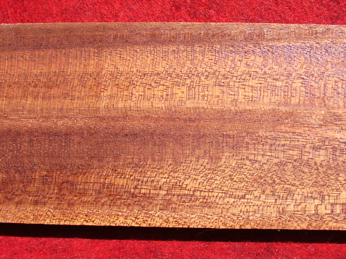

I'm looking forward to it. I have two Camillus electricians knives at the ready, hoping to make them into a one blader. The ones I've seen on the forum really caught my eye. I have some nice ambonia wood I plan to use for the scales. If the first one goes as planned, I also have some fiddleback maple I'll use on the other.
Pictured is the ambonia. Nice stuff to work with. About the same hardness as walnut. It has a unique feature of sort of an irridescense (sp?) when you turn it on a different plane with sunlight on it.

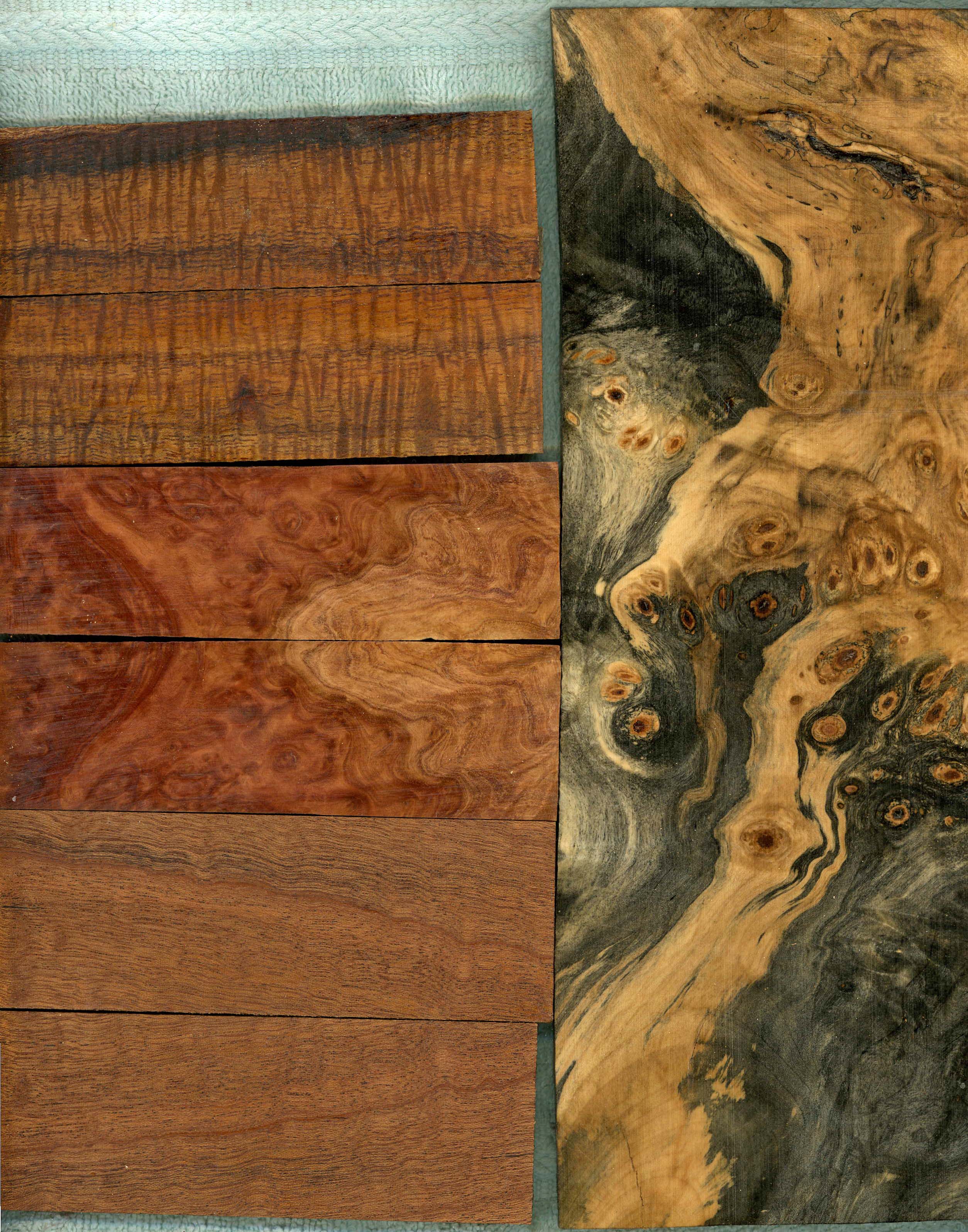

Yesterday I found a new source for wood locally. I won some Koa on ebay and saw it was local. I made arrangements for local pickup. It turns out that I used to work with the guy about 10 years ago. (It's a small world, but I would hate to paint it) :mrgreen: He has some of the finest burl I have seen & a number of woods I have not heard of before.
Here is a pic of the wood I got yesterday:
The large piece on the left is stabilized Buckeye Burl, Koa on top left, Red Mallee in left center & Sepele on the bottom left.
Does anyone need a knife re-handled? :lol:

Would that place be in Klamath Falls? I was drooling through a warehouse over there last summer. Fantastic selection and nothing like picking out your own wood. I have a piece of KOA (5A EXTRA CURLY XF lumber) coming from Klamath Falls also, along with some very nicely striped Brazilian Tulipwood.
Real nice haul Dale! ::drool:: Makes me want to be up around those exotic wood warehouses. ::tu::
P.S. That sure is a great looking piece of Buckeye, indeed one of my top 5 favorites! ::drool:: ::tu:: ::tu::

Nice Hukk. ::tu:: ::drool::
This guy has a lot of instrument grade wood & exhibition grade too as he gets it in. I saw a piece of Koa that would make a guitar back.....Knock your socks off.
