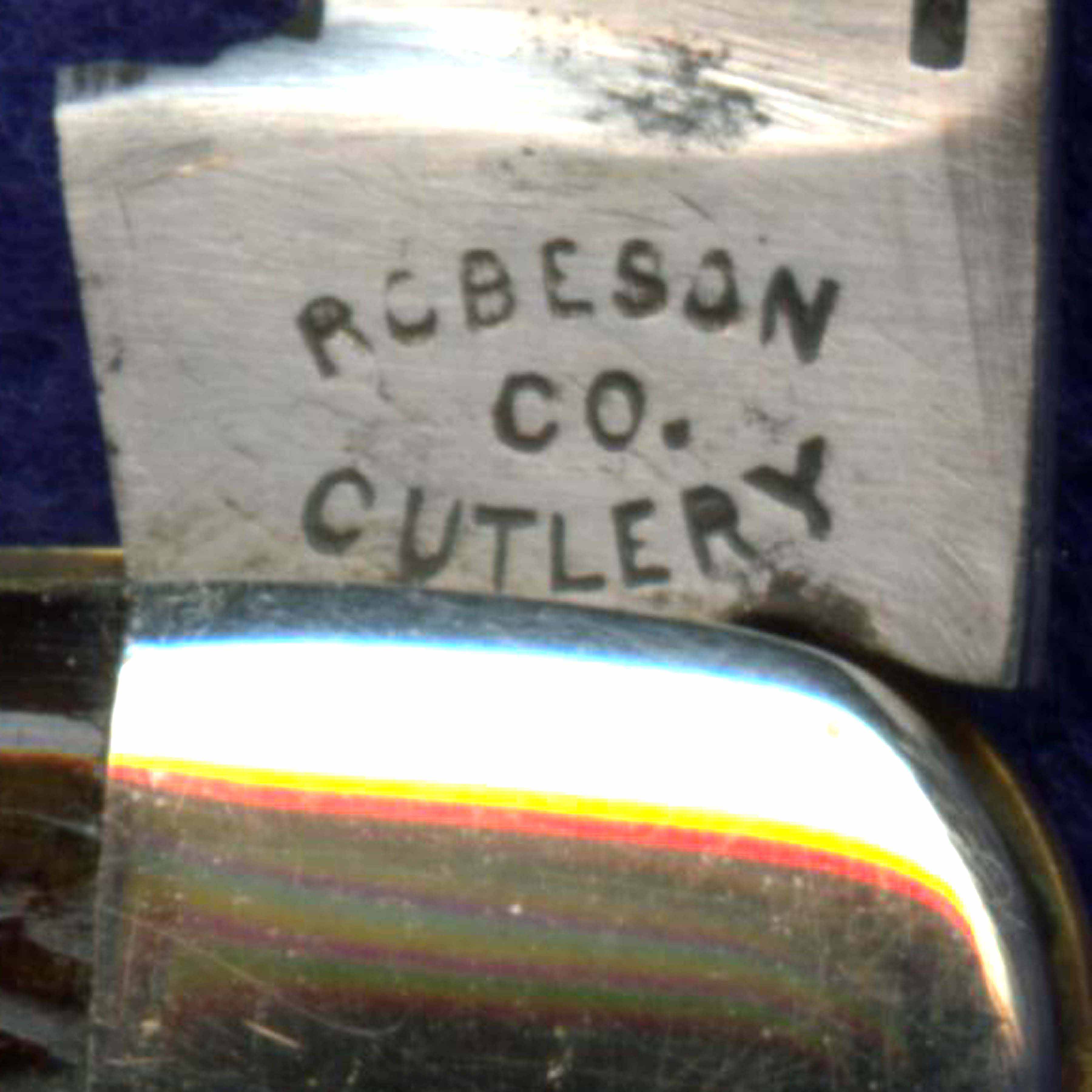

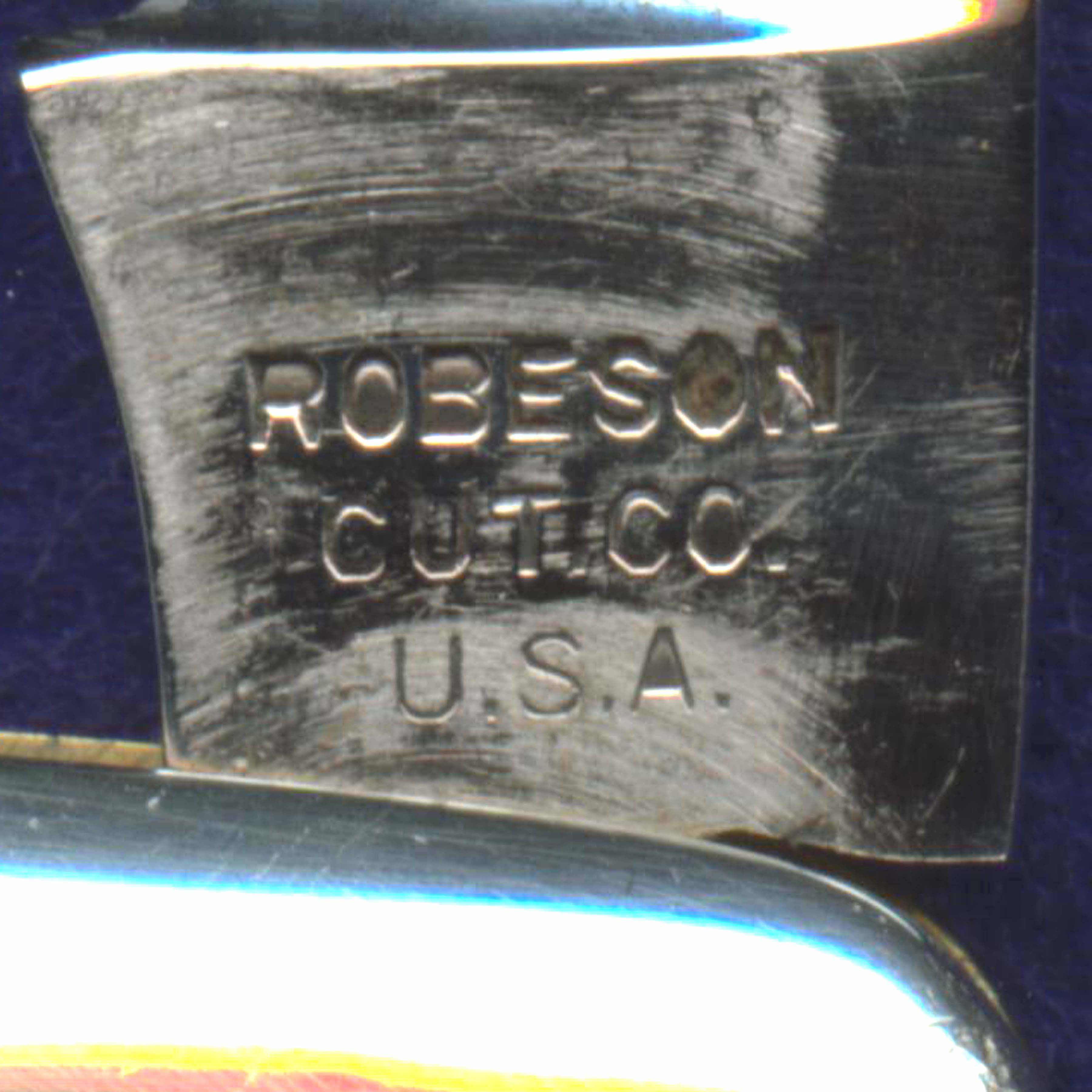

A Historical Perspective On Vintage Robeson Tang Stamps
The various tang stamps used by The Robeson Cutlery Company apparently fall into fairly well defined time periods. Like the tang stamps used by the Case cutlery companies, Robeson's tang stamps were used for certain periods of time, then replaced by newer, but different designs.
Robeson's stamps have traditionally been divided into periods of time that included those from the early 1890's to about 1900, 1900 to about 1945, 1945 to 1965, and 1965 to 1977. These time period estimates were provided initially by Mr. Dewey Ferguson in Romance of Collecting Cattaraugus, Robeson, Russell and Queen Knives, 1976. These estimates served me well during the earlier years of my collecting.
As I have stated earlier, the best reference on all things Robeson is Knives Can Talk, by Tom Kalcevic and most recently Robeson Collectables and Rarities, 2012. Mr. Kalcevic resides in the Avon, New York. He has had access to former factory workers, factory documents, the spouse of Emerson Case, Robeson's last president, and City Directories in the local libraries. Tom's breakdown and dating of the various stampings used by Robeson is the most detailed in existence. I have chosen to accept, by faith, what Tom has published.
I do have one or two marks that were not included in Tom's books, and I have dated them in with his dates, where they seem to fit as best as I can determine.
I do not possess a representative example of every tang stamp known to have been used by Robeson. I will provide a photo of any tang stamp that I can, however.
The different lines of a tang stamp will be separated by a forward slash /, with a space preceding and following. Different styles of lettering will be described within parentheses. Arched stamps will be designated as such within parentheses. Straight stamps will be as they appeared on the knives.
I am going to limit this to the tang marks on the master blades of folding knives. If I depart from that, it will be noted.
Attempting to date a Robeson knife by the stamps on the secondary blades is futile. Some premium knives do have the same stamp on all blades, so obviously my last statement is not exactly true. However, Robeson generally placed on of only three or four stamps on the secondary blades, while the master blade went through dozens of stamps over the years.

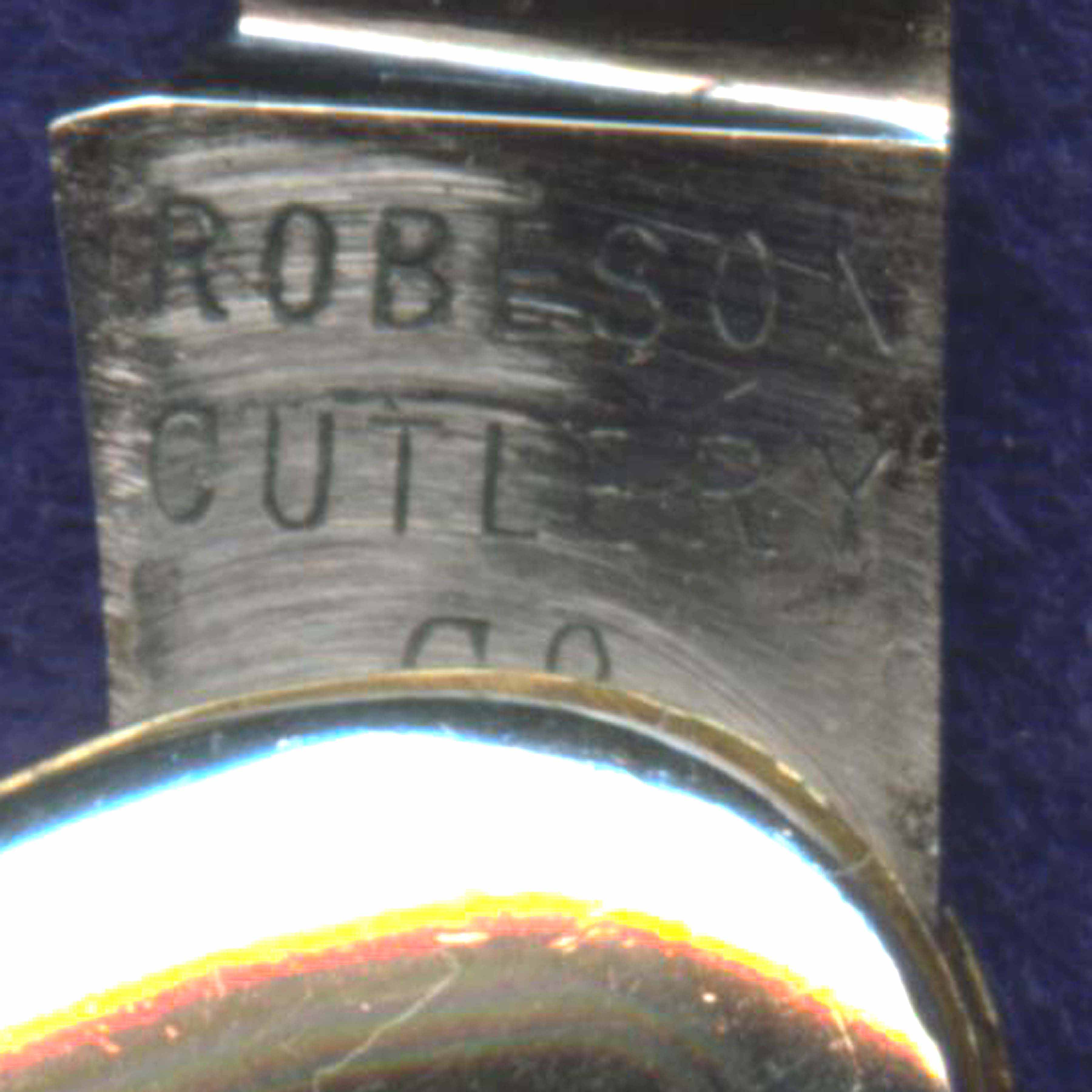

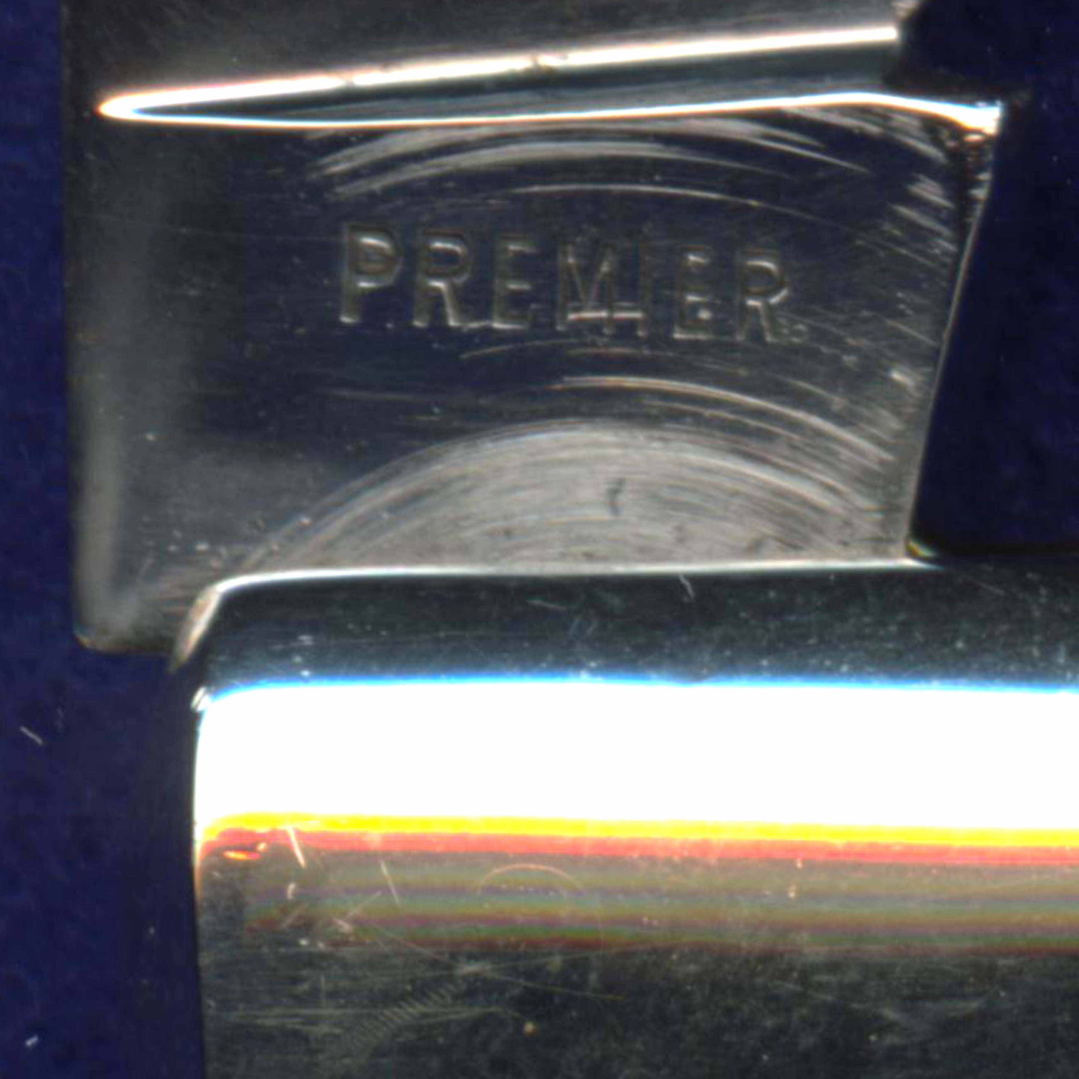

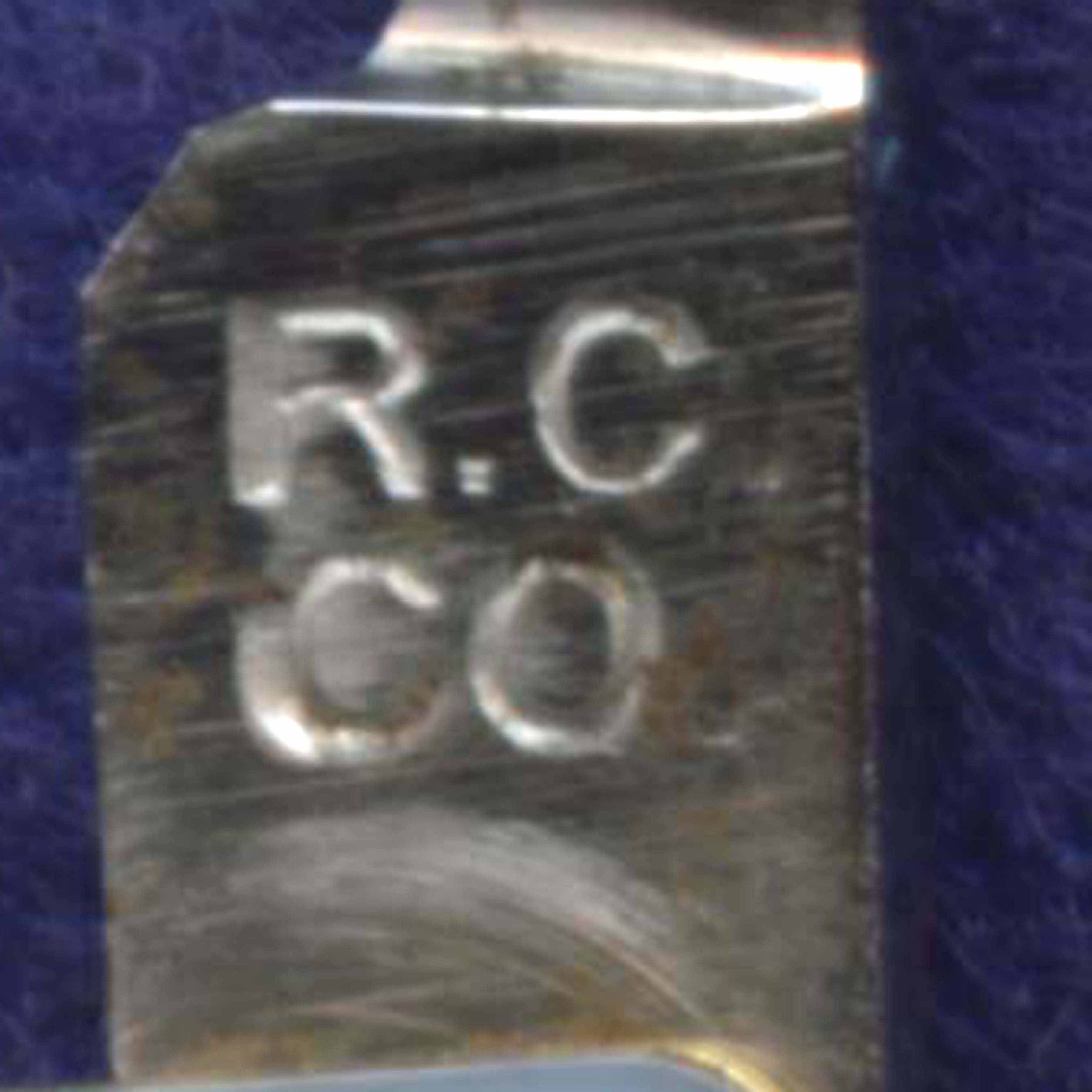

Here are the stamps, in chronological order as Tom Kalcevic and I understand them. The dates should be considered as close estimates only and not written in stone.
M. F. ROBESON (Seen only on razors, thus far) 1880 - 1884

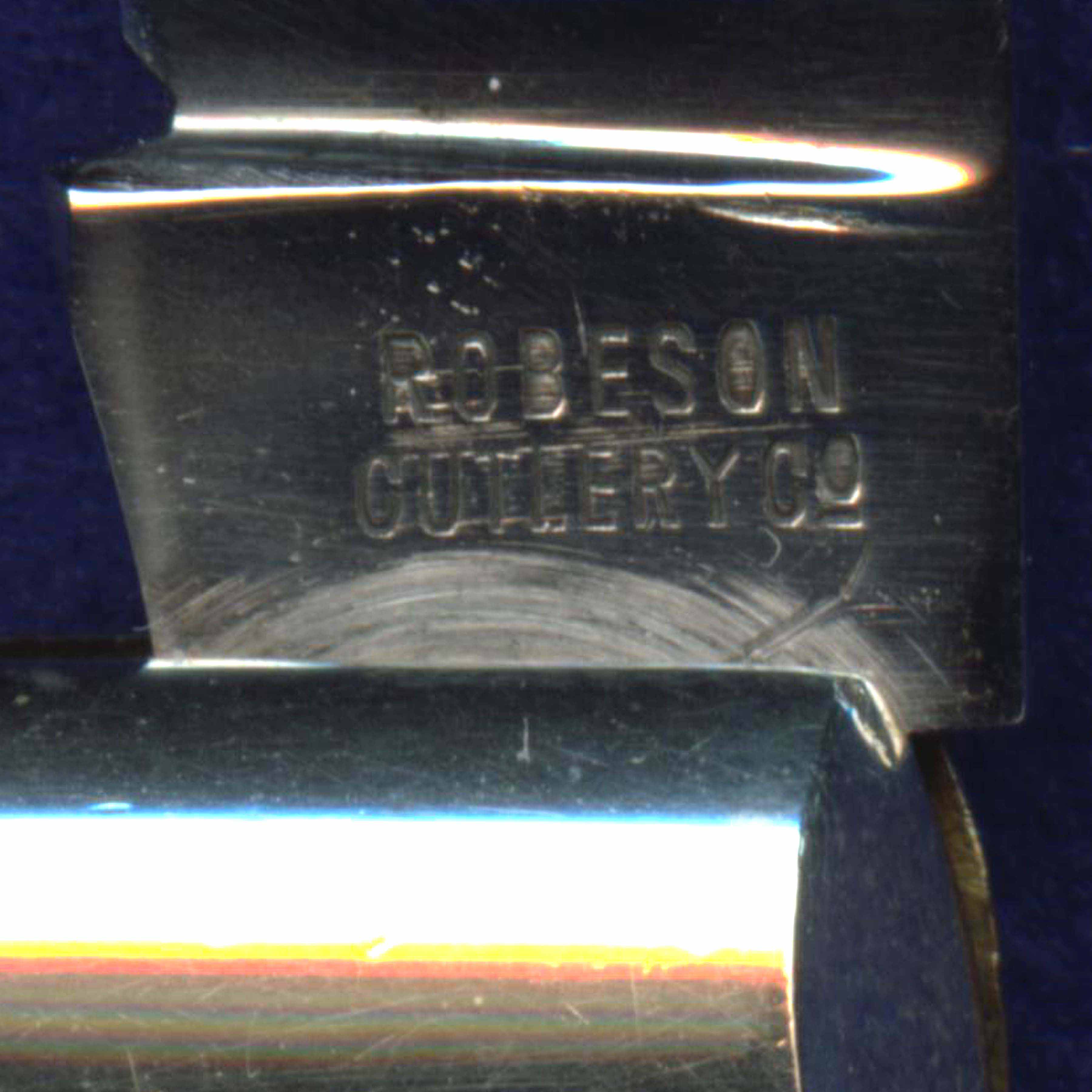

ROBESON / CUTLERY Co / ENGLAND 1885 - 1890

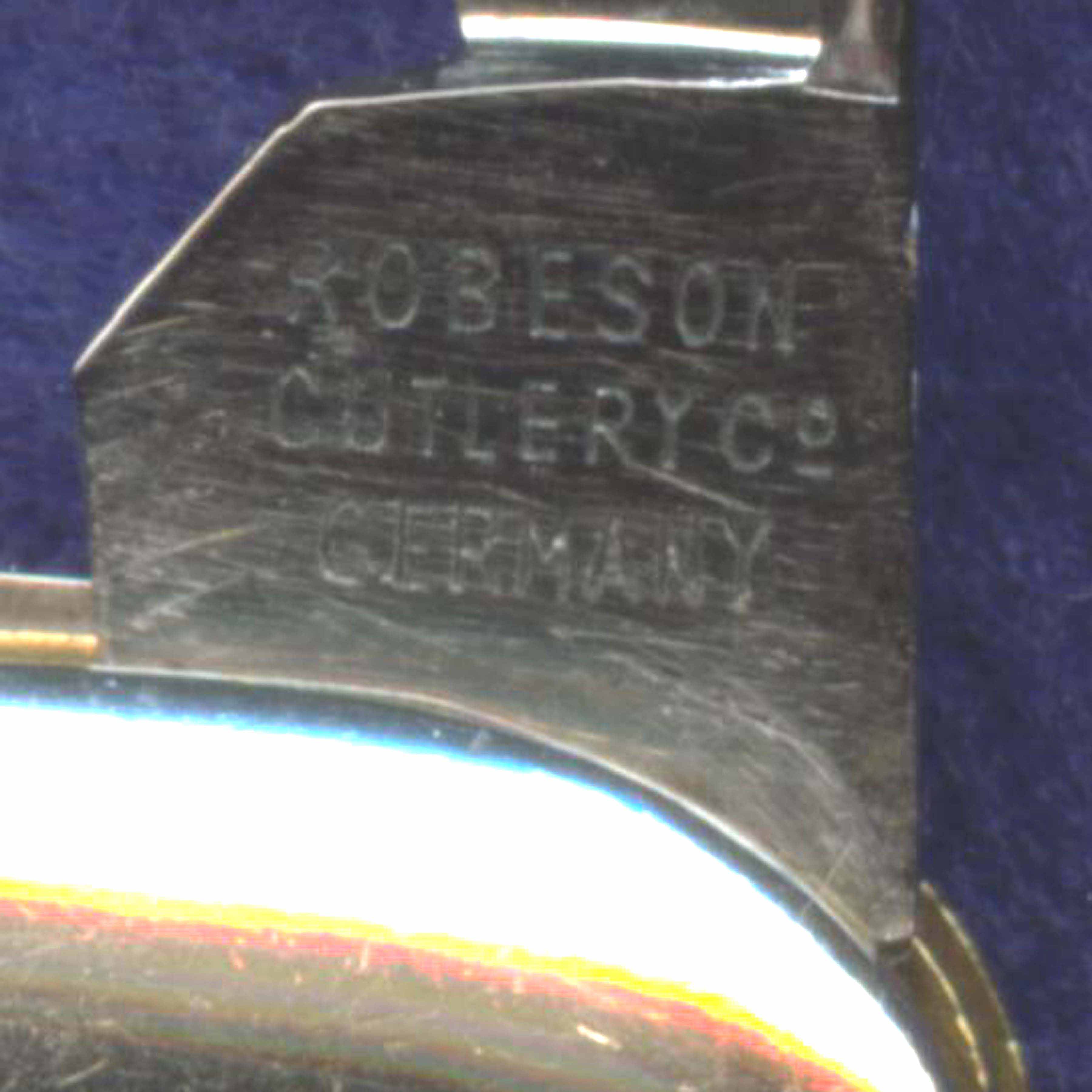

ROBESON / CUTLERY Co. with GERMANY on one blade 1891 - 1895
ROBESON / CUT. Co. with PREMIER on one or more blades 1891 -1895
R. C. Co. with GERMANY on one blade 1891 - 1895
GENESEE 1891 - 1895

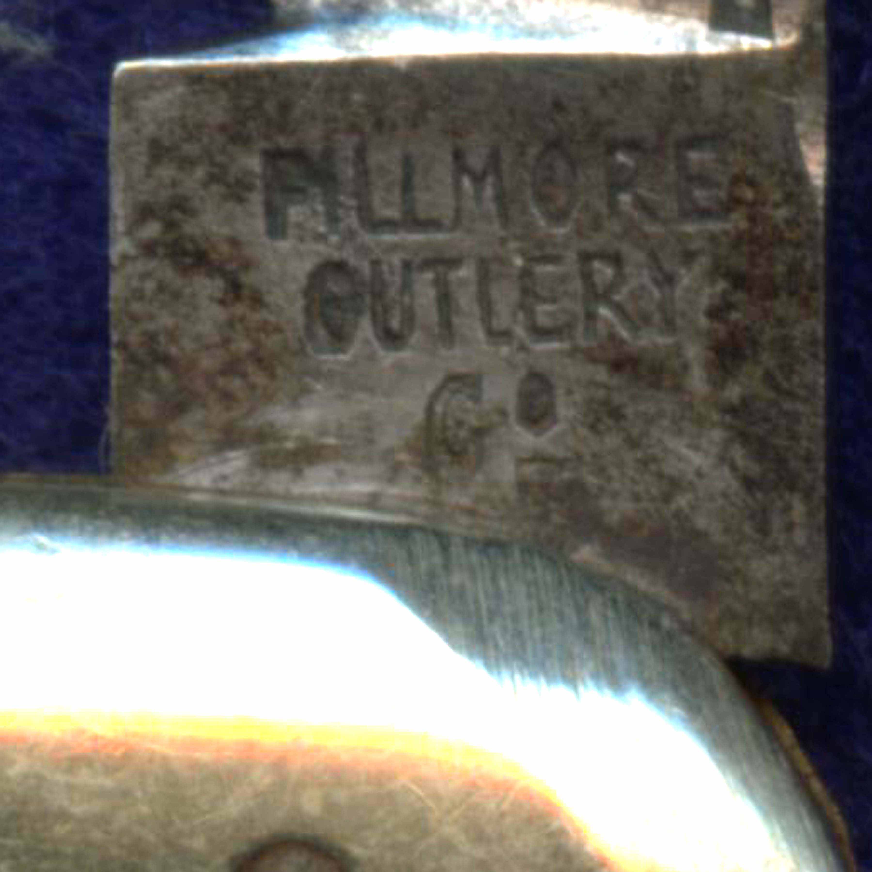

FILLMORE / CUTLERY / Co. with GERMANY or AUSTRIA on one blade 1891 - 1895
ROBESON / CUTLERY CO. / WARRANTED 1896 - 1899

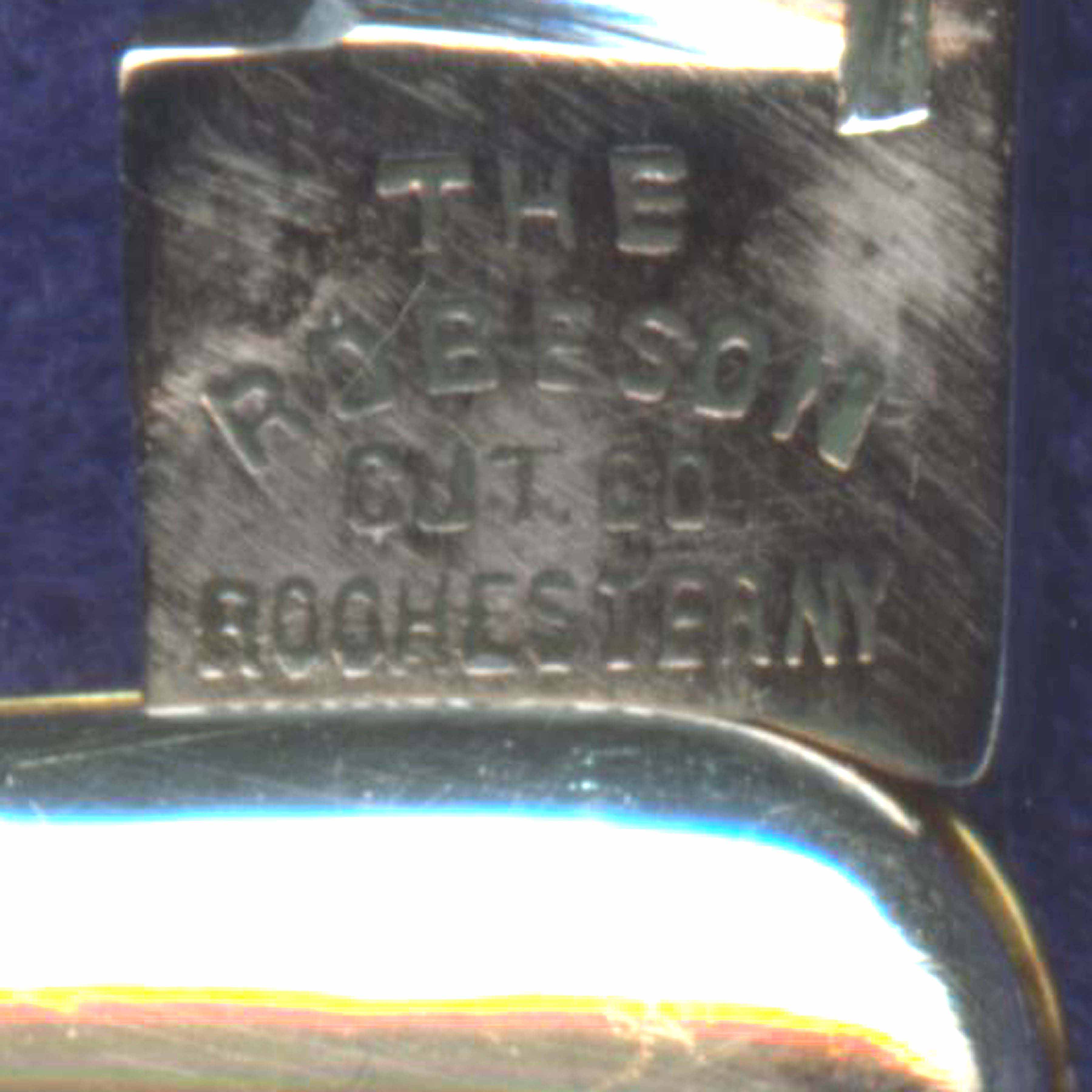

THE / ROBESON / CUT. CO. / ROCHESTER, N.Y. 1896 - 1899
THE R. C. CO. / ROCHESTER 1896 - 1899

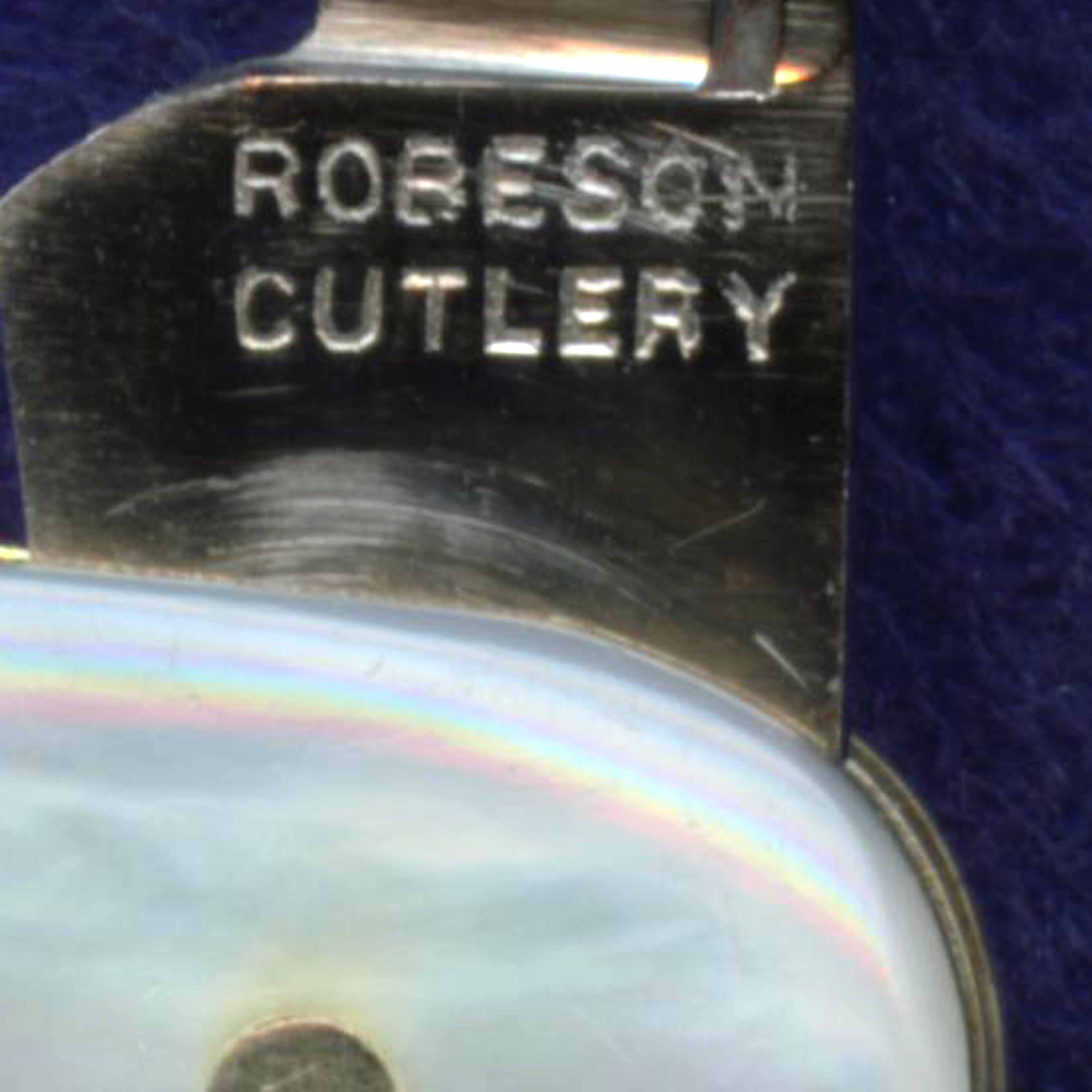

ROBESON / CUTLERY 1896 - 1899
ROBESON (arched up) / CO. / CUTLERY (arched down) 1900 - 1910
ROBESON (arched) / CO. / CUTLERY 1900 - 1916
R. C. / CO. 1900 - 1939
ROBESON / CUT. CO. / U.S.A. 1910 - 1920
ROBESON / CUTLERY / CO. 1910 - 1921

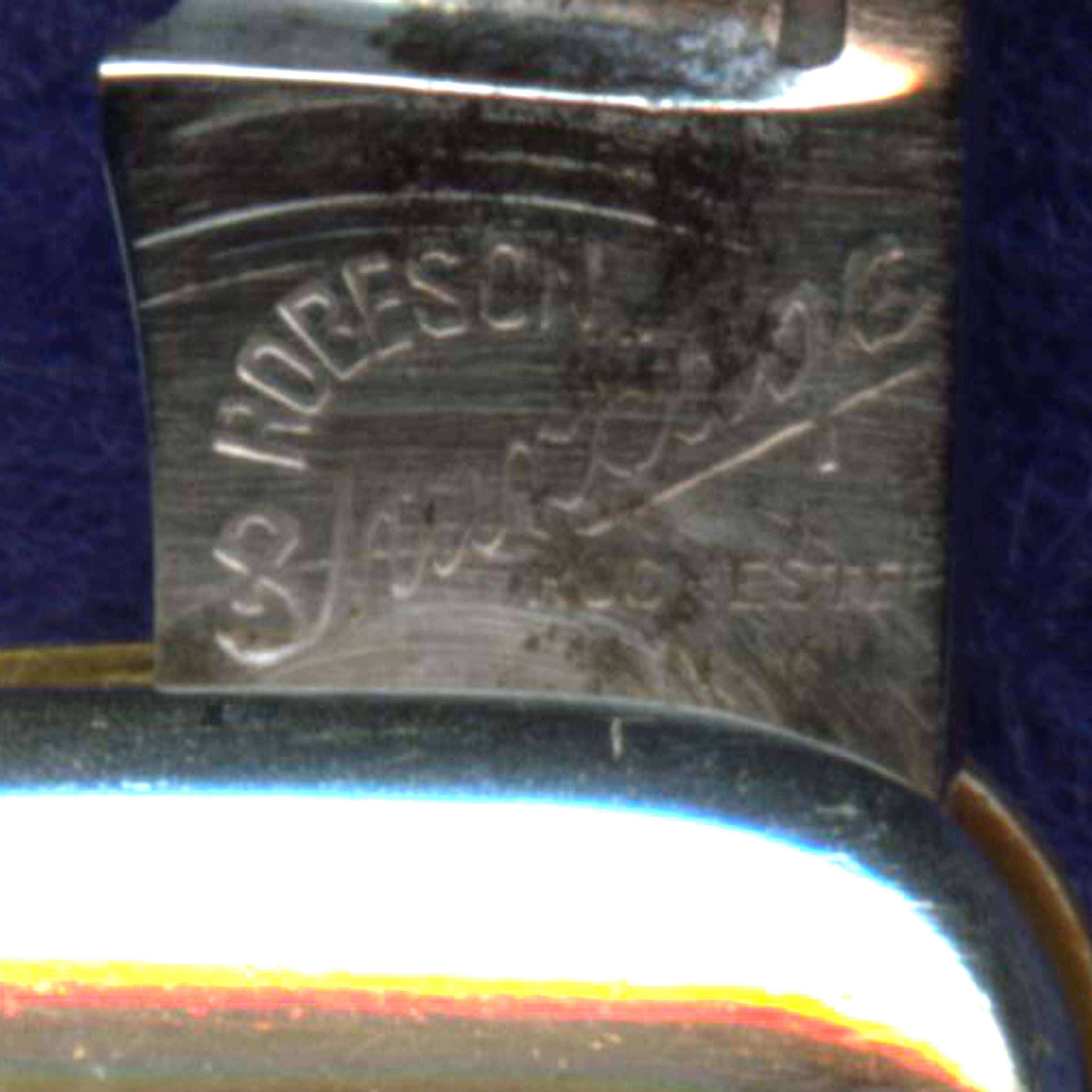

ROBESON (arched) / ShurEdge (script & diagonal) / ROCHESTER, N.Y 1907 - 1911
TERRIER / CUTLERY / ROCHESTER, N.Y. 1910 - 1916

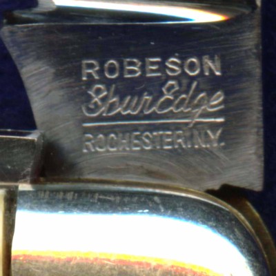

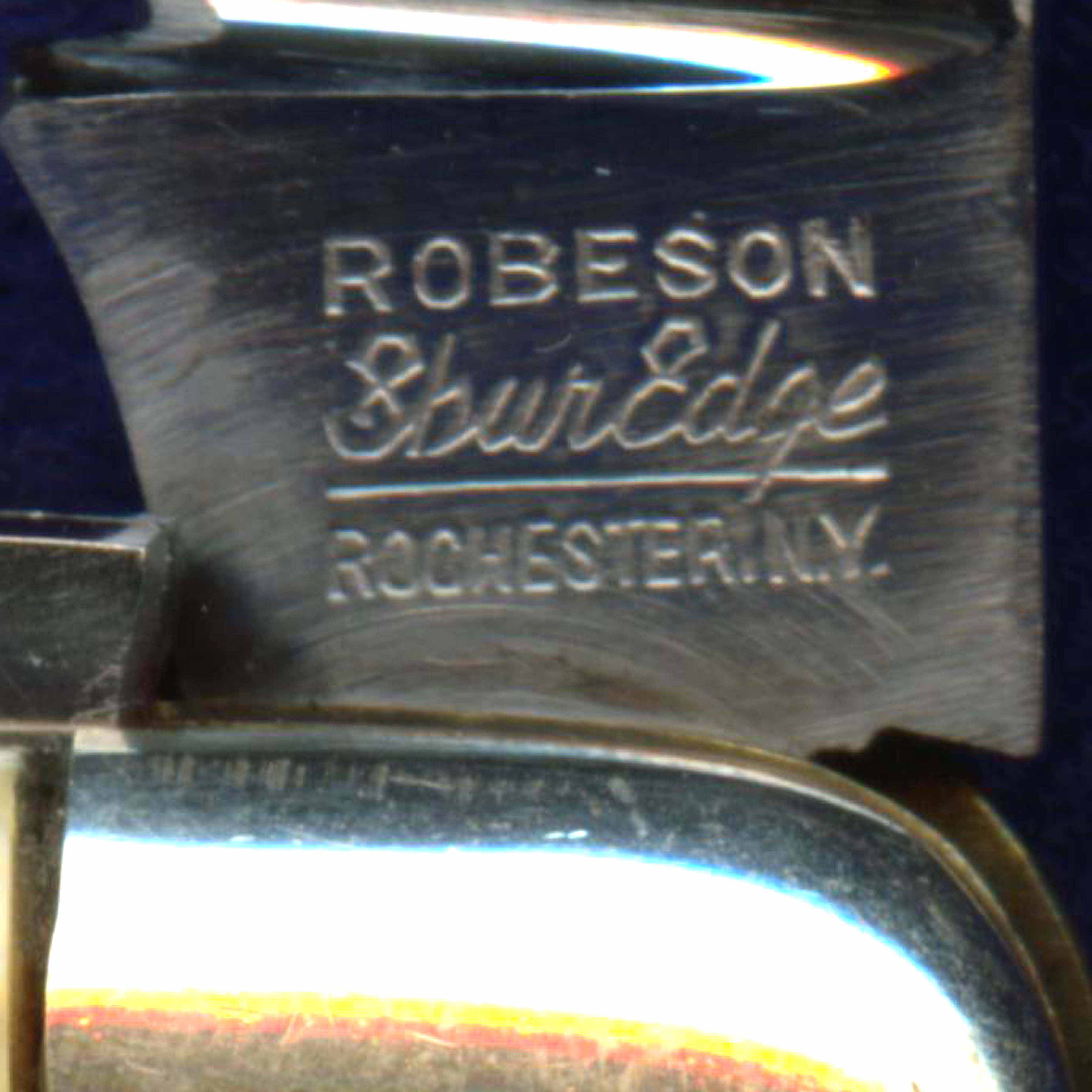

ROBESON / ShurEdge (script) / ROCHESTER, N.Y. 1911 - 1921

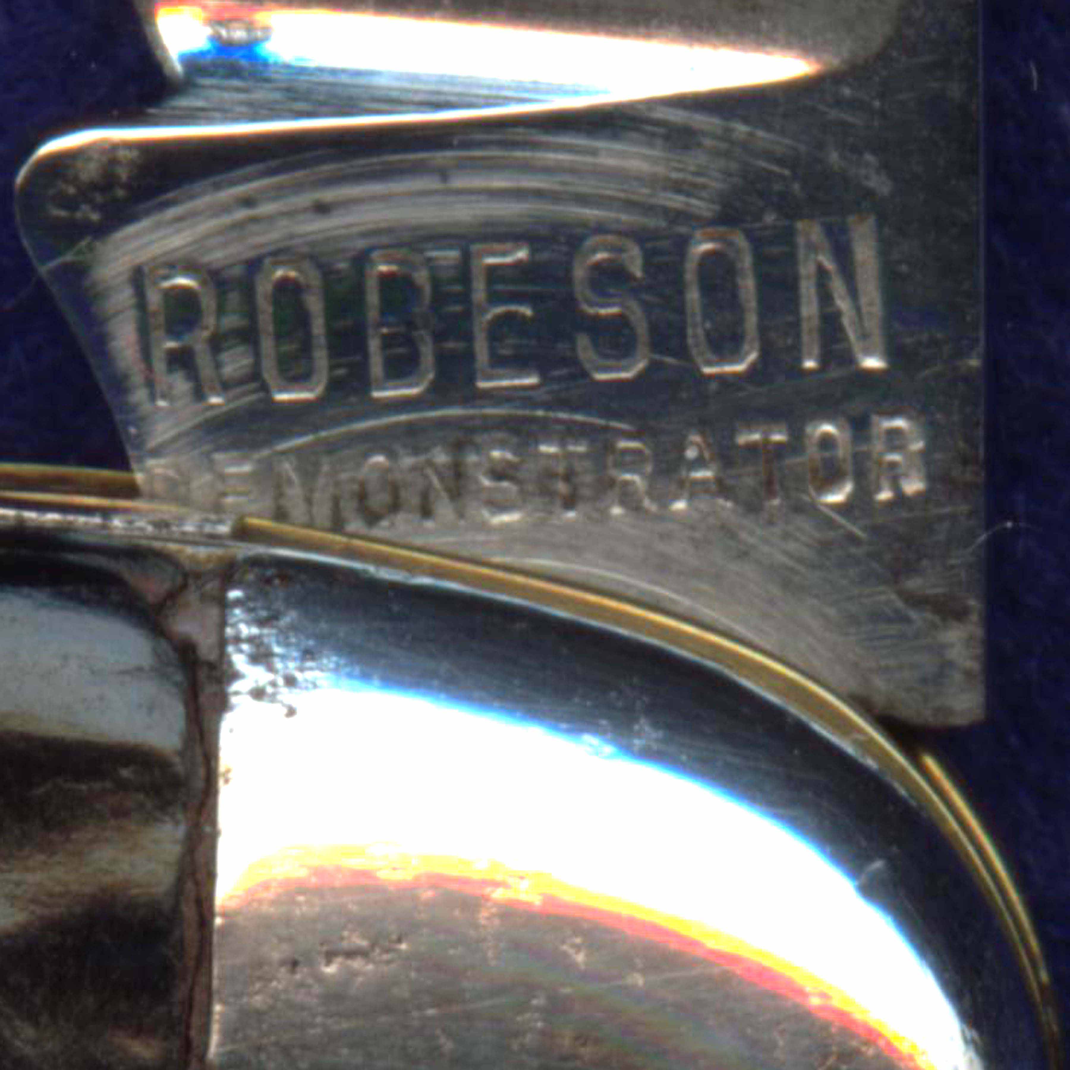

ROBESON / DEMONSTRATOR 1911 - 1939

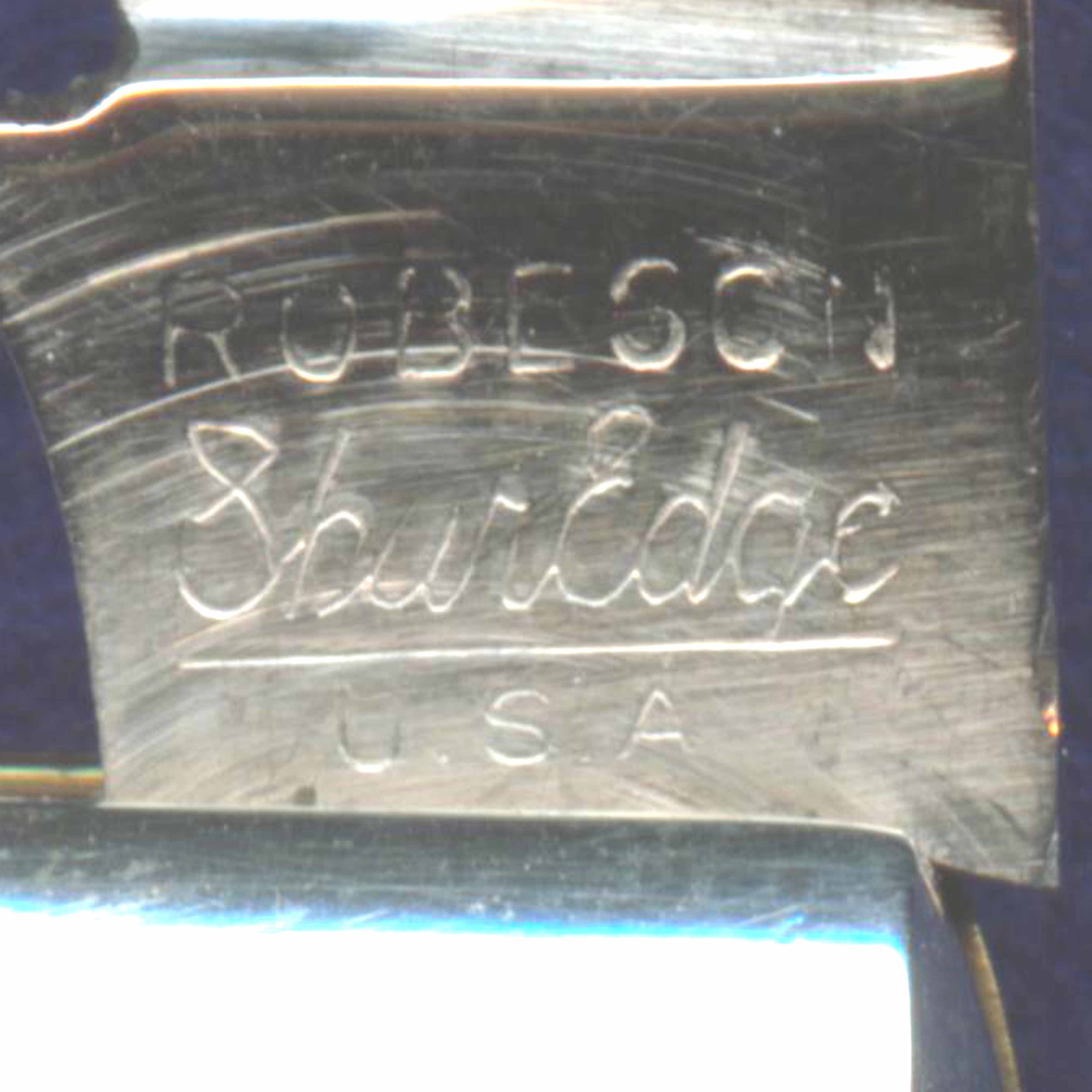

ROBESON / ShurEdge (script) / U.S.A. 1916 - 1939
ROBESON (arched) / U. S. A. / CUTLERY on master blade 1917 - 1939

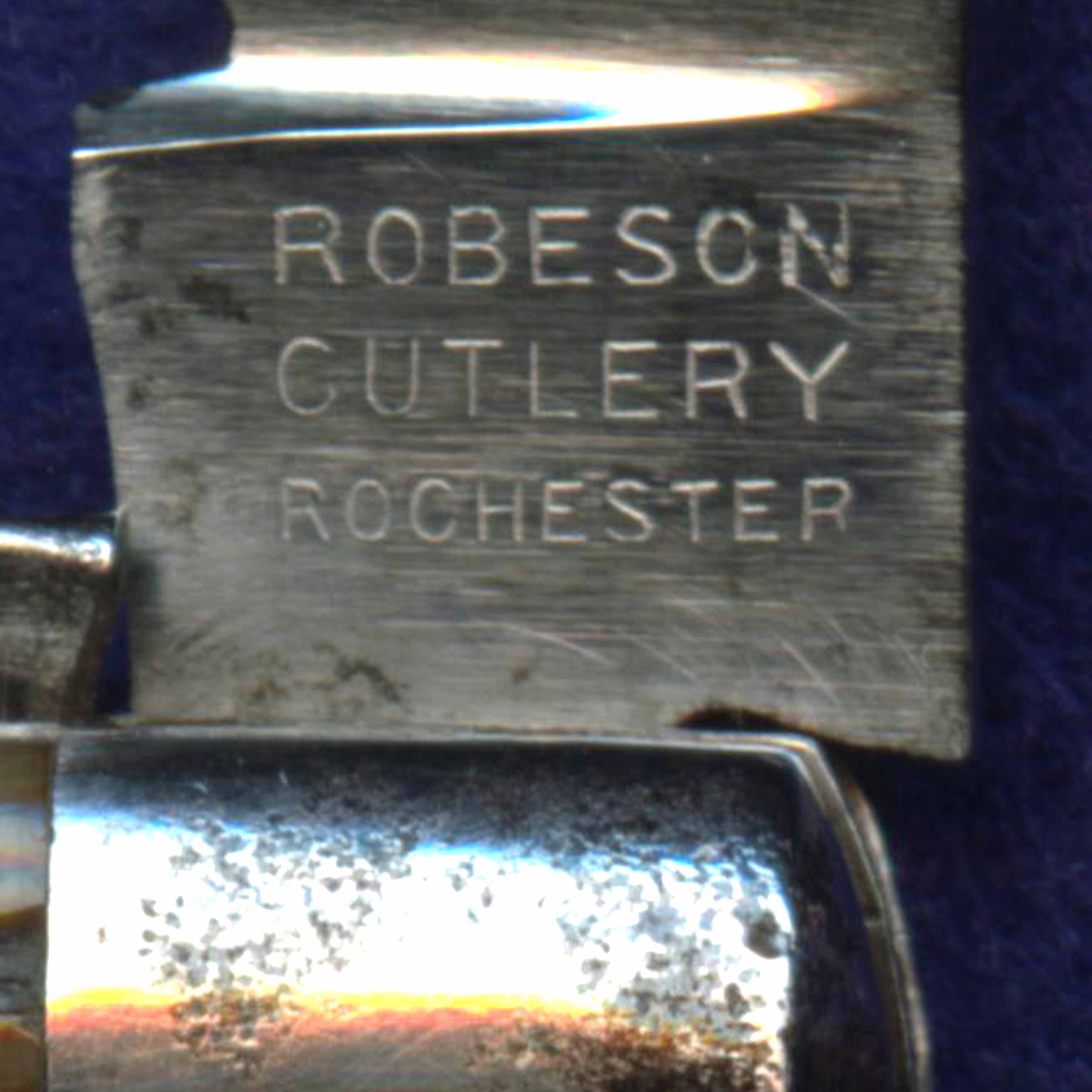

ROBESON / CUTLERY / ROCHESTER 1917 - 1939

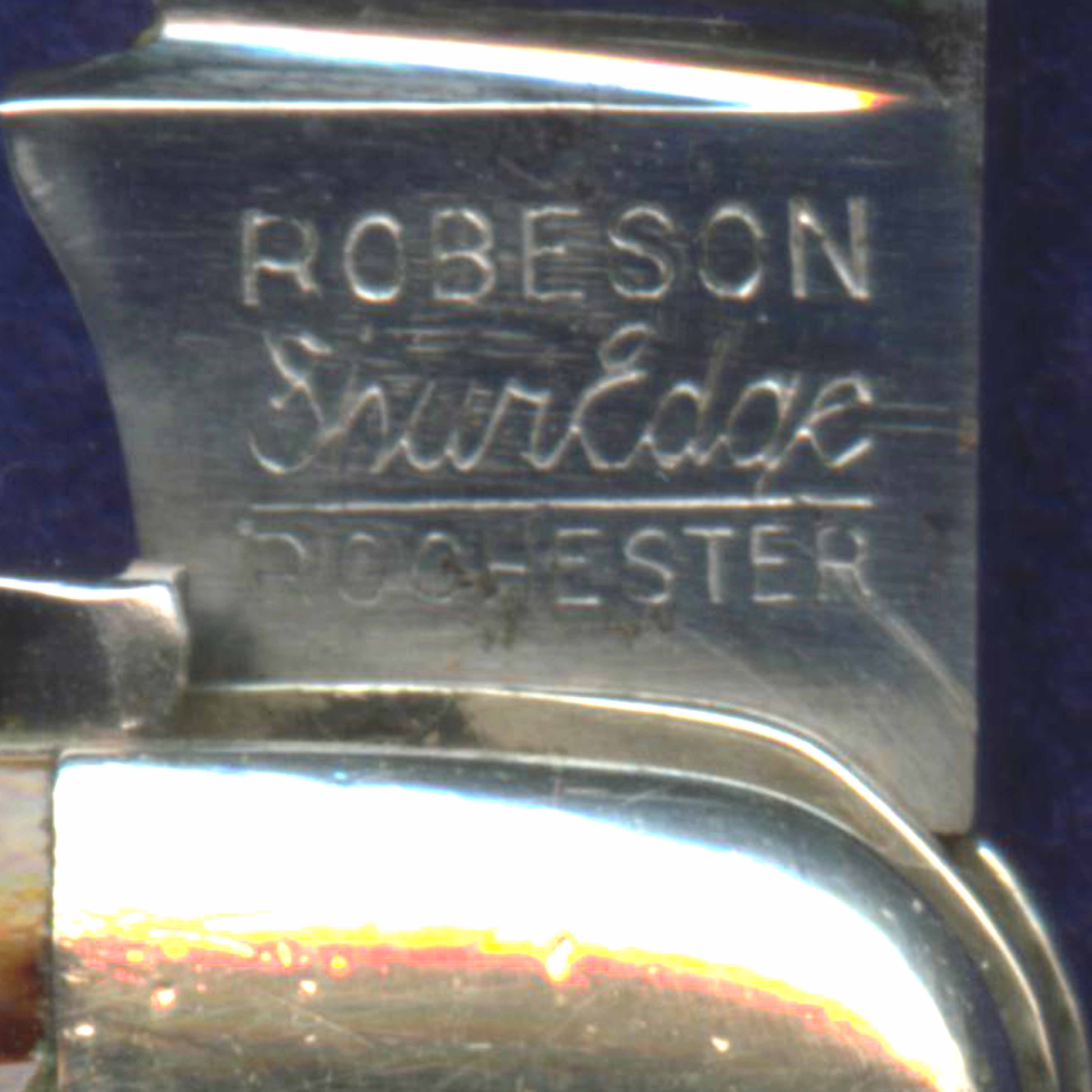

ROBESON / ShurEdge (script) / ROCHESTER 1922 - 1939

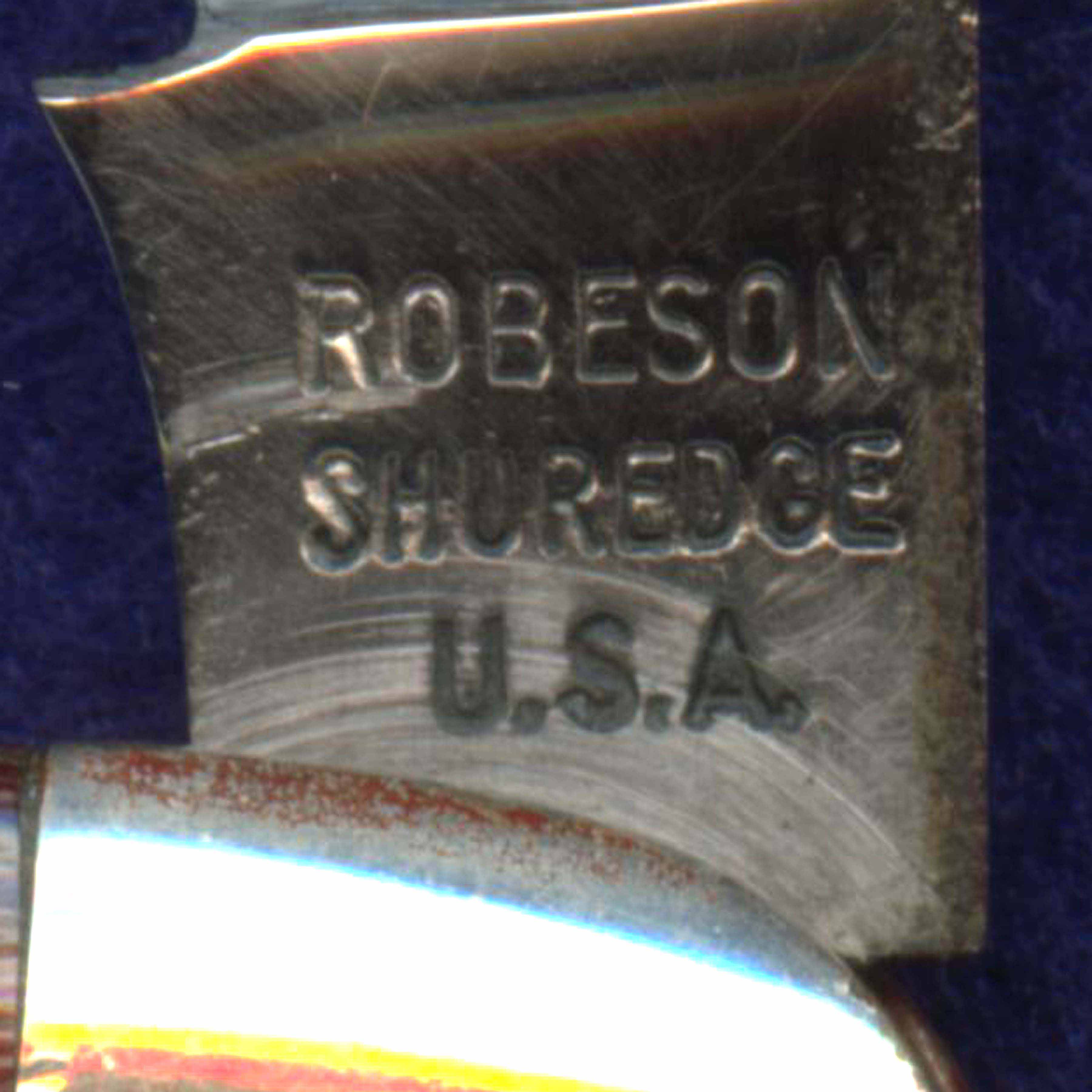

ROBESON / SHUREDGE ( block) / U.S.A. 1940 - 1964

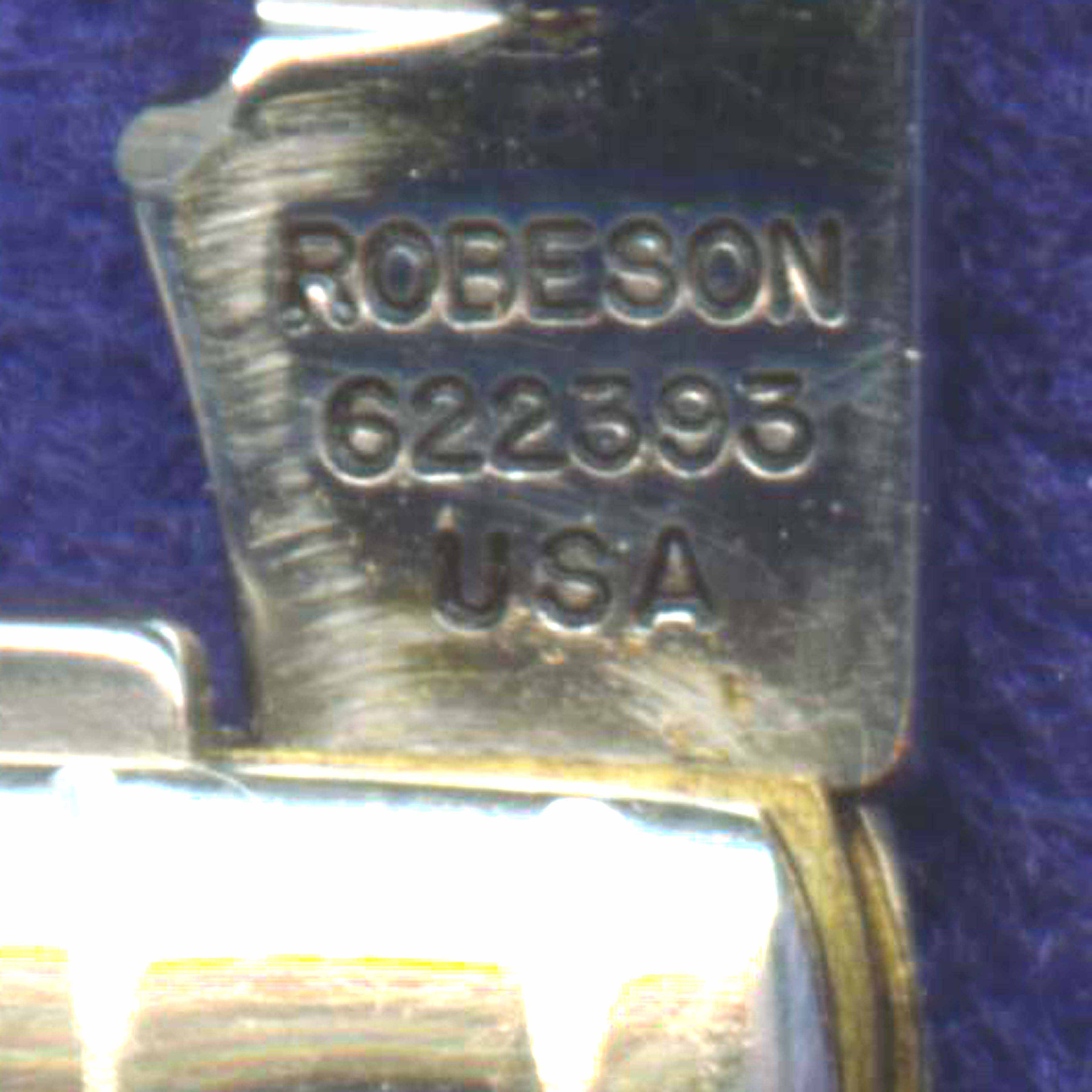

ROBESON / pattern number / U.S.A. 1965 - 1977

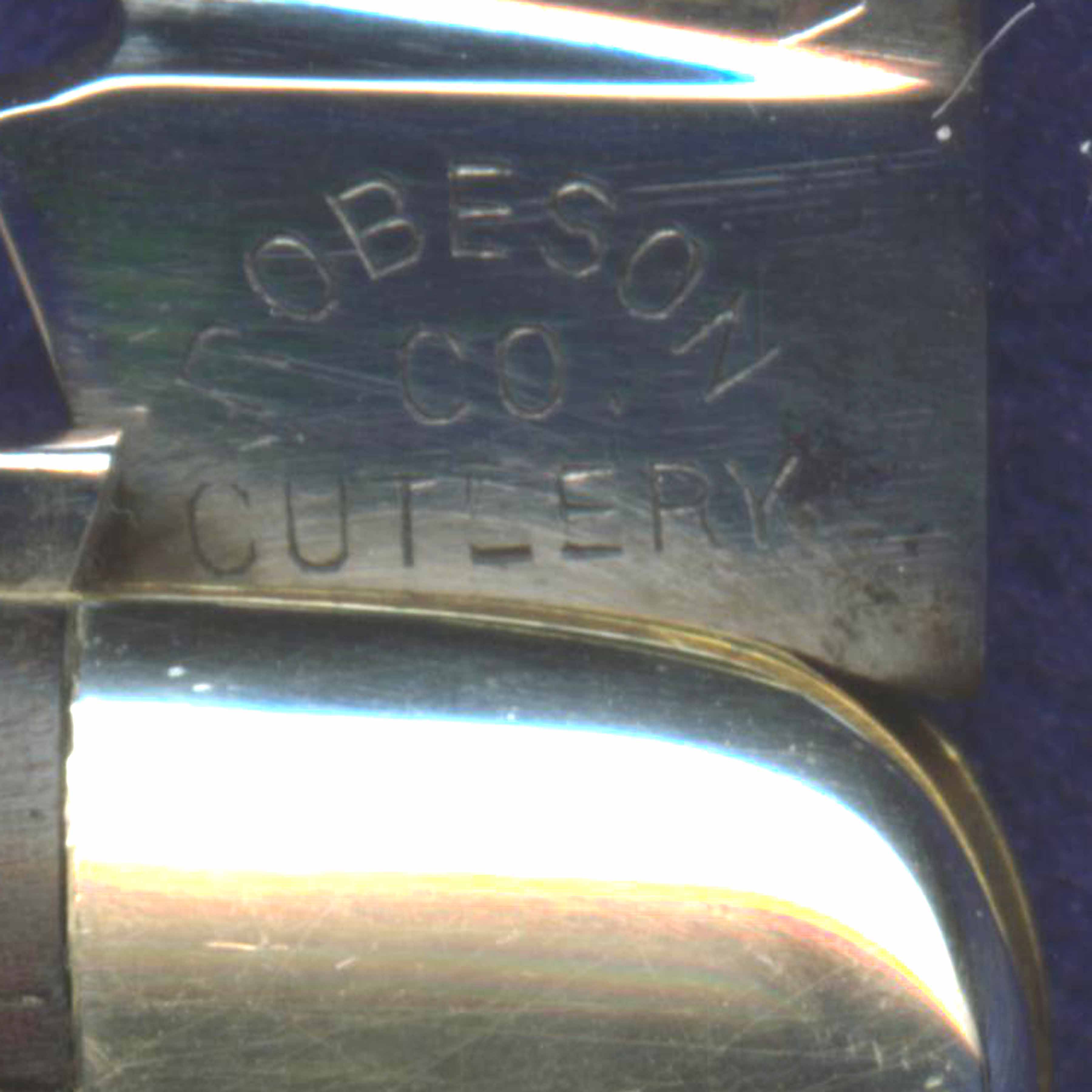

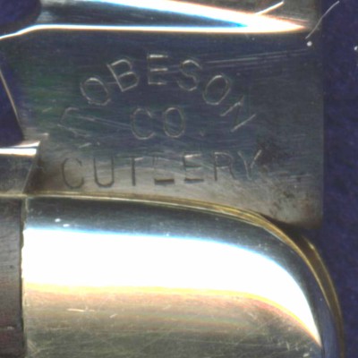

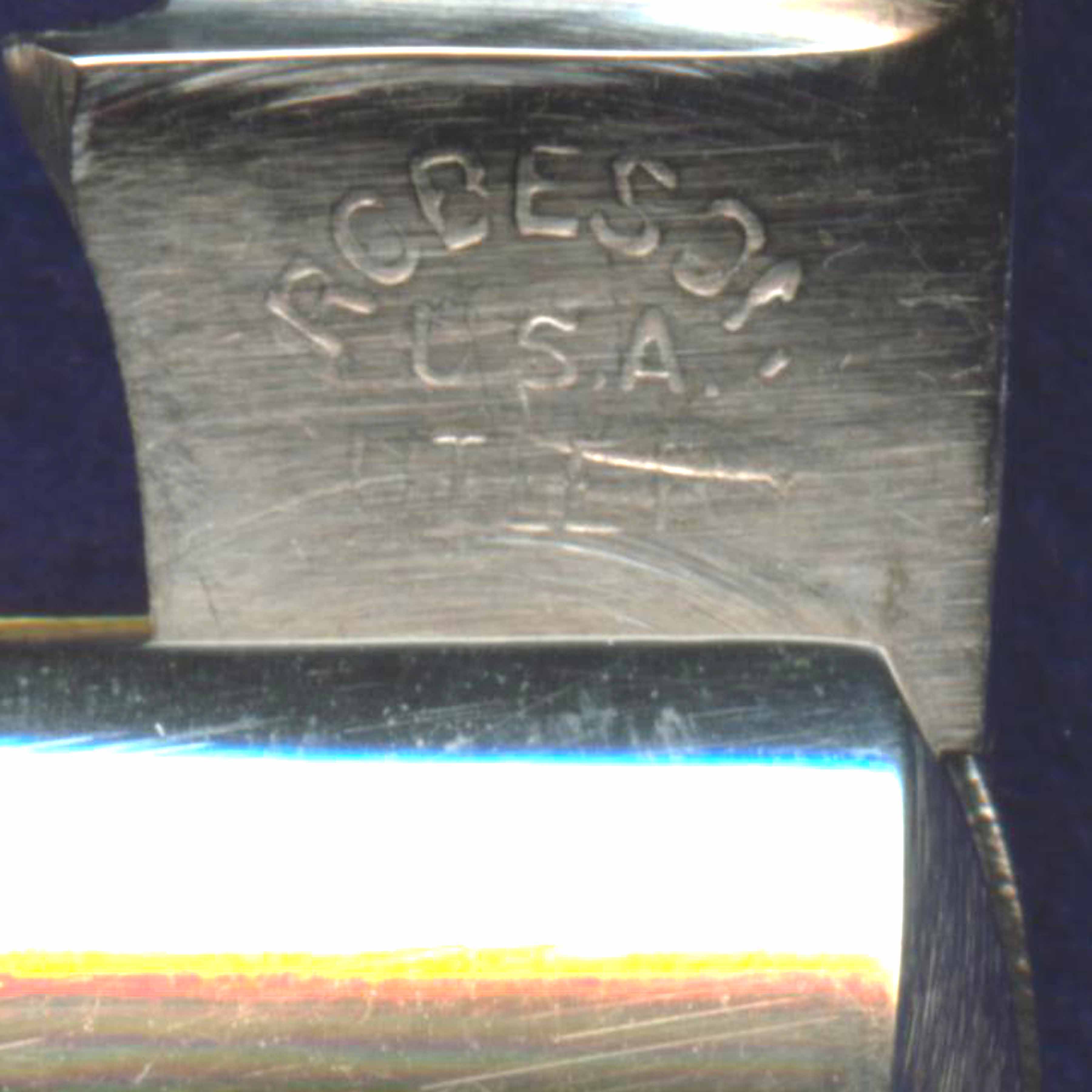

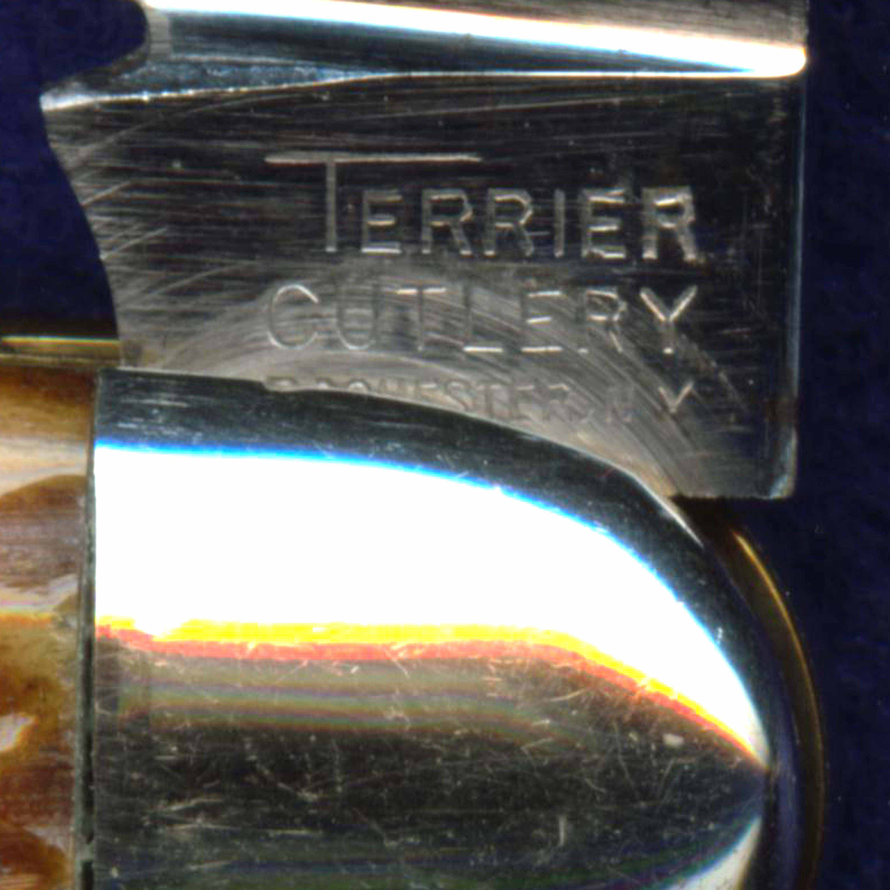

More:
- Attachments
- Terrier logo found on most, but not all Terrier knives
- TerrierLogo.jpg (21.19 KiB) Viewed 79987 times

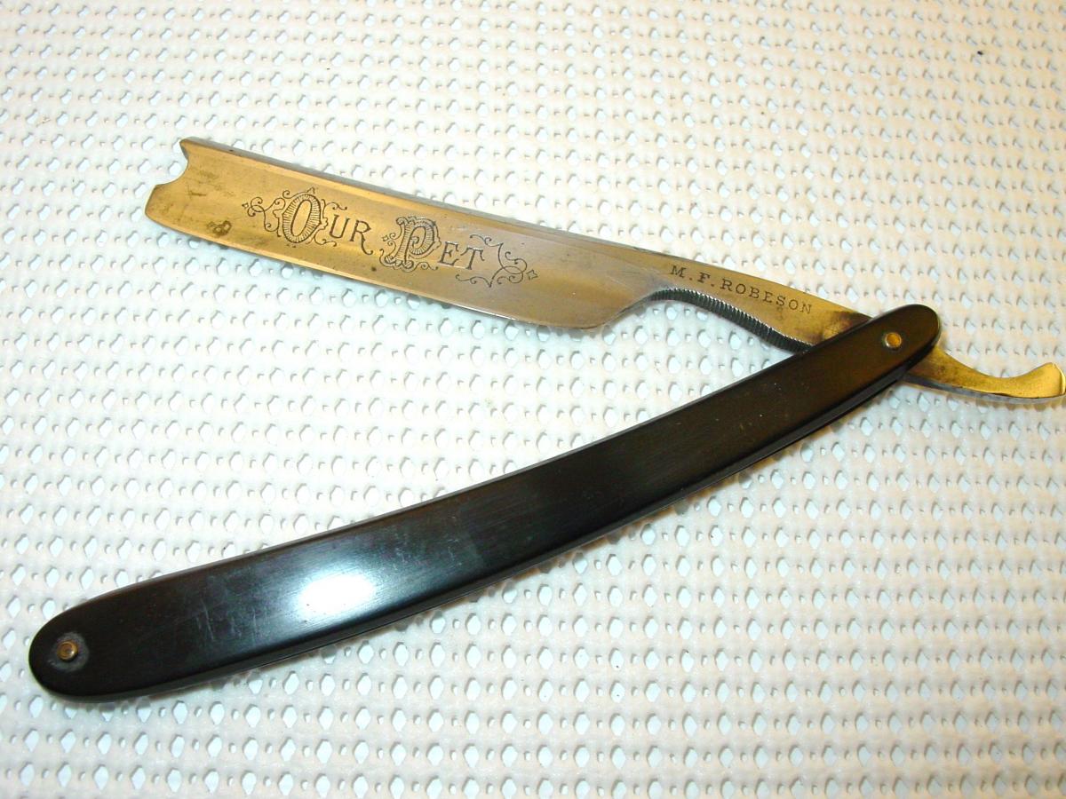

Great information and thanks for posting Charlie.
Here is a M. F. Robeson razor I have.
Wayne
Wayne
- RobesonsRme.com
- Posts: 10129
Re: A Historical Perspective On Vintage Robeson Tang Stamps
Wayne, that's a nice old razor.
Is there a country of origin on it, such as Germany?
Some of the M.F. ROBESON marked razors were made in Germany and some were made here, presumably in New York.
I have a very similar, if not identical, razor with that same awesome etch.
They also made one in that same time period that was etched, "OUR BEST".
Thanks for posting.

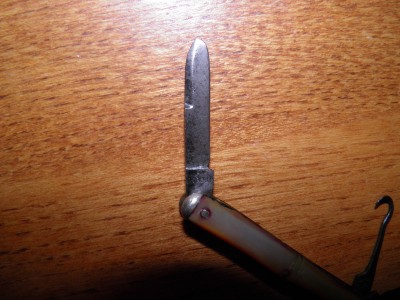

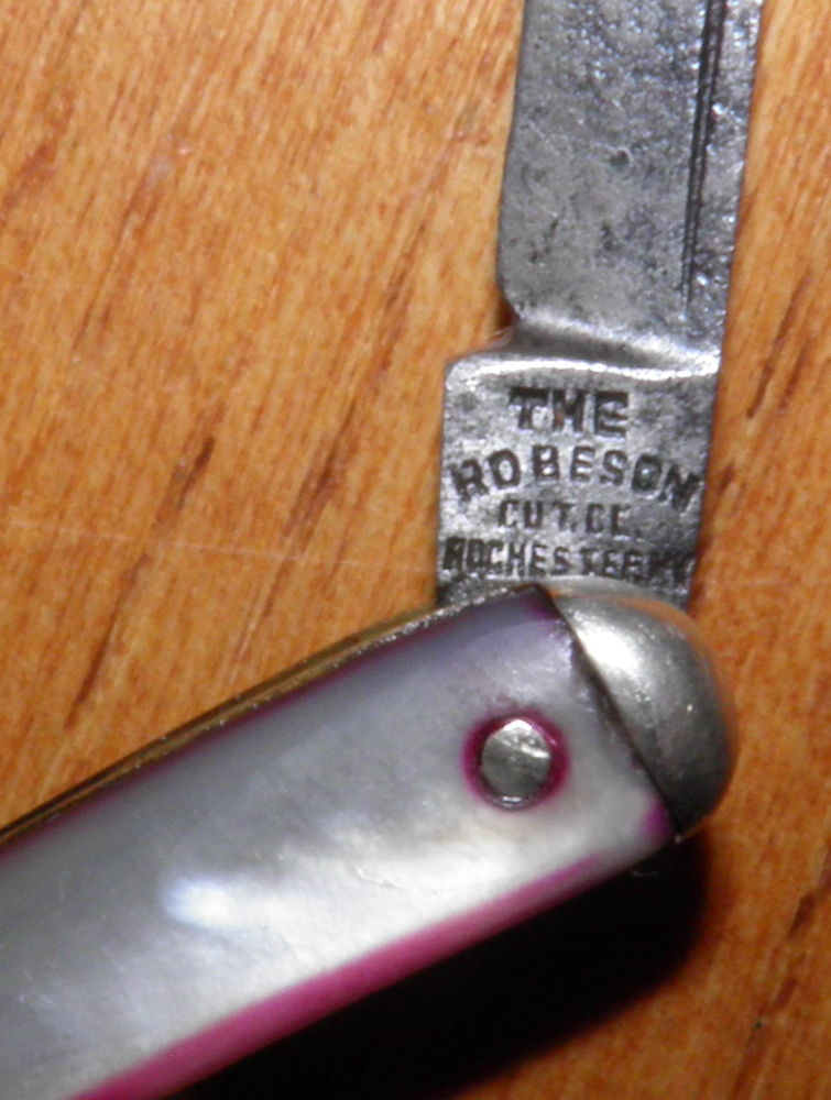

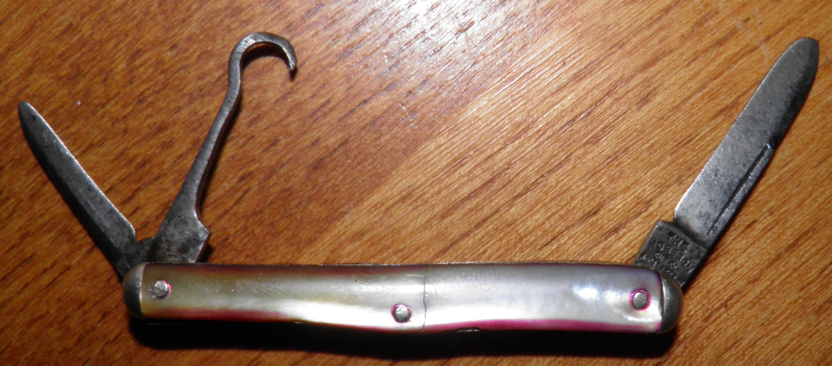

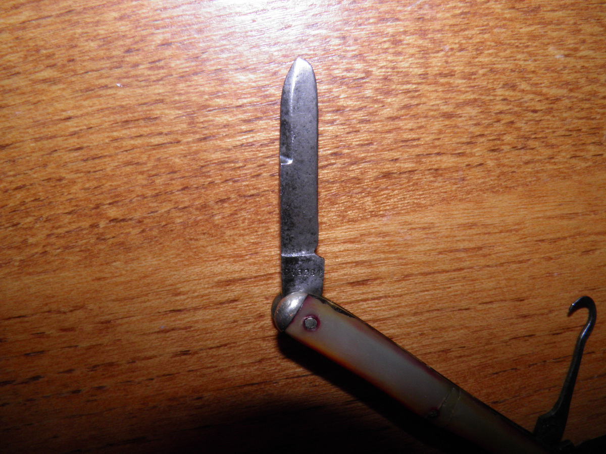

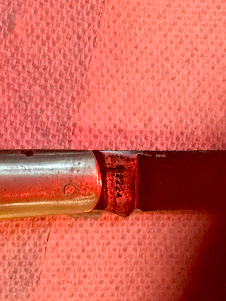

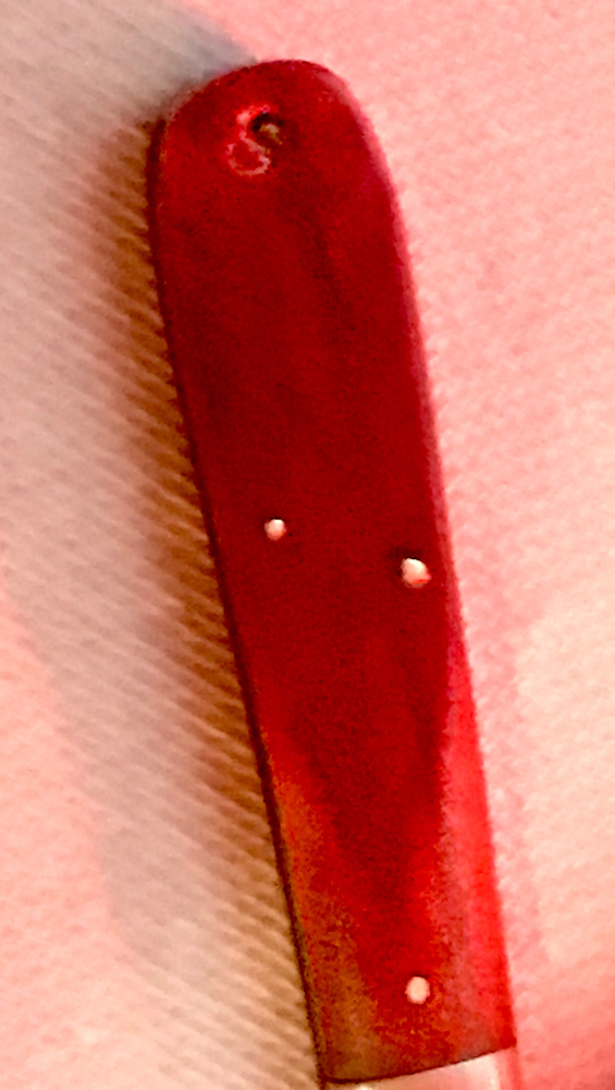

I have a Robeson 1896 to 1899 my number gave me a little problem ..but i am hoping i understand it better now. my number is C73284 and here is an image or 2 of the knife .. i would like to know what model it is since it has a boot hook on it ?
- RobesonsRme.com
- Posts: 10129
Your little knife has rose colored genuine pearl handles, so the "C" as the first character of the pattern number is a curiosity.
Early on, the "C" stood for celluloid.
Also, the second character of the pattern number denoted the number of blades. Obviously, your knife does not have seven blades.
However, "7" was the character that denoted genuine pearl handles.
So, If we ignore the "C", I read your pattern number as 732084.
Robeson often dropped the zero from the fourth position on knives whose handle-die shape number was 001 through 099.
I assume that "C" must have something to do with the special dye job of the pearl handles.

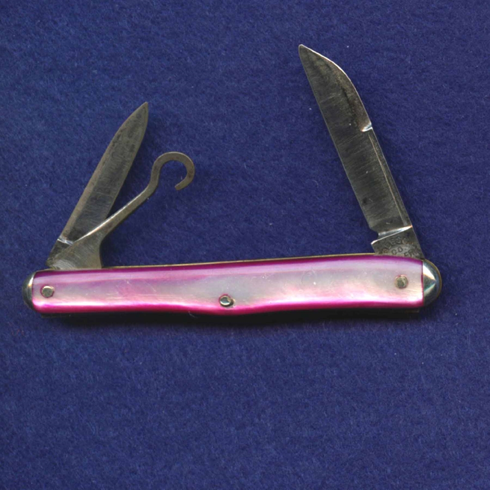

I have an identical knife with rose pearl, but unfortunately, mine has no pattern number and it is a little later than yours.
The pearl on yours is somewhat faded or bleached out.
I've seen these with four blades, as well.
The hook is a glove hook for fastening ladies gloves, as these knives were meant for women.
Charlie Noyes
Charlie Noyes

Thank you for all of your help ...is it possible the hook was also for boot laces as well..the high boots they used to wear ..only reason i ask is i used it in my ad copy as boot lace hook although i probably need to let people know it is a ladies knife ...

I think the knives are a bit too dainty to be used to button boots or shoes.
We have a button hook on the dresser in our guest bedroom and it is much more substantial than these knives.
That opinion, though, probably does not matter to the average Ebay knife bidder.

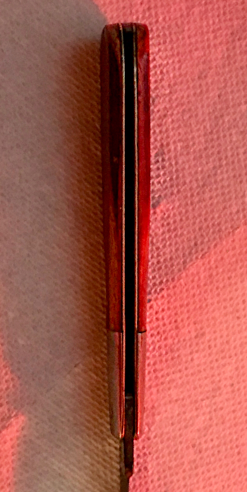

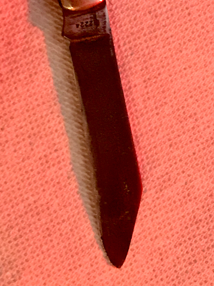

RobesonsRme:

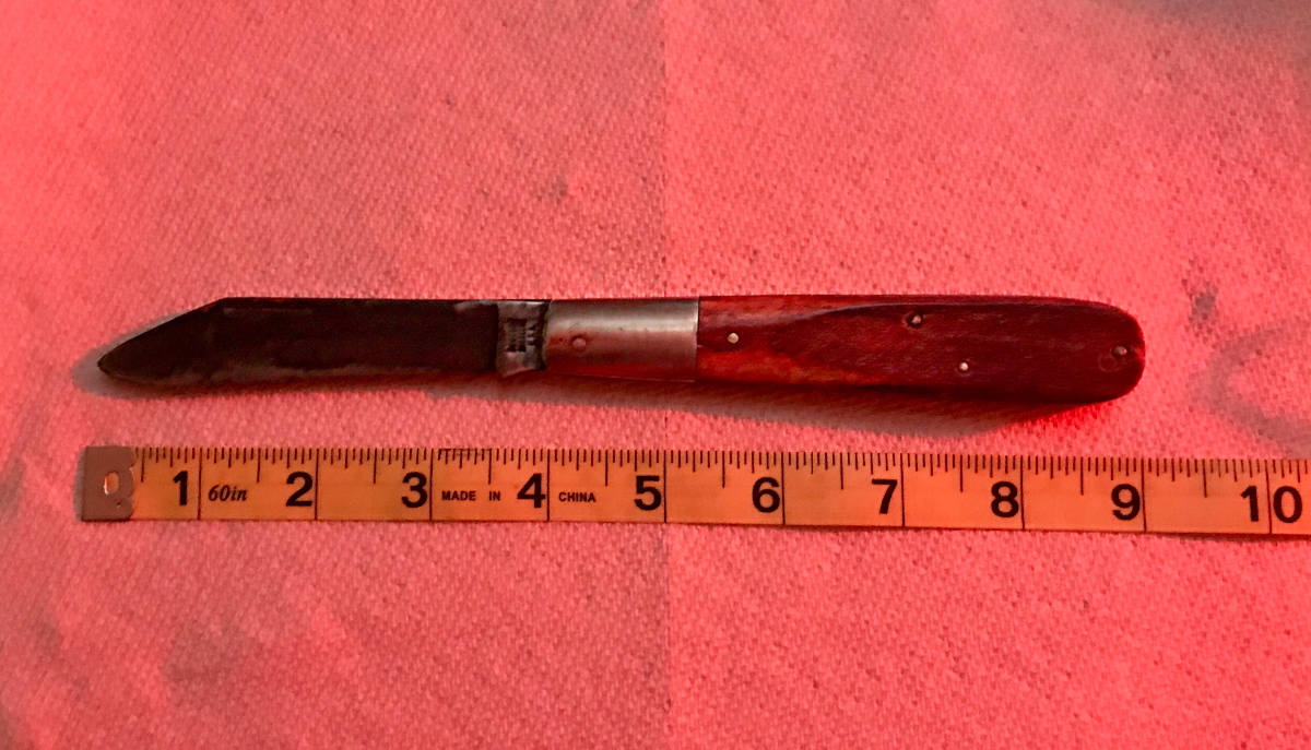

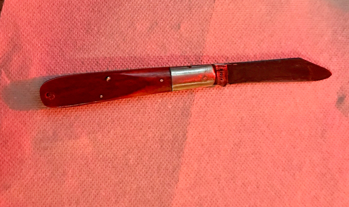

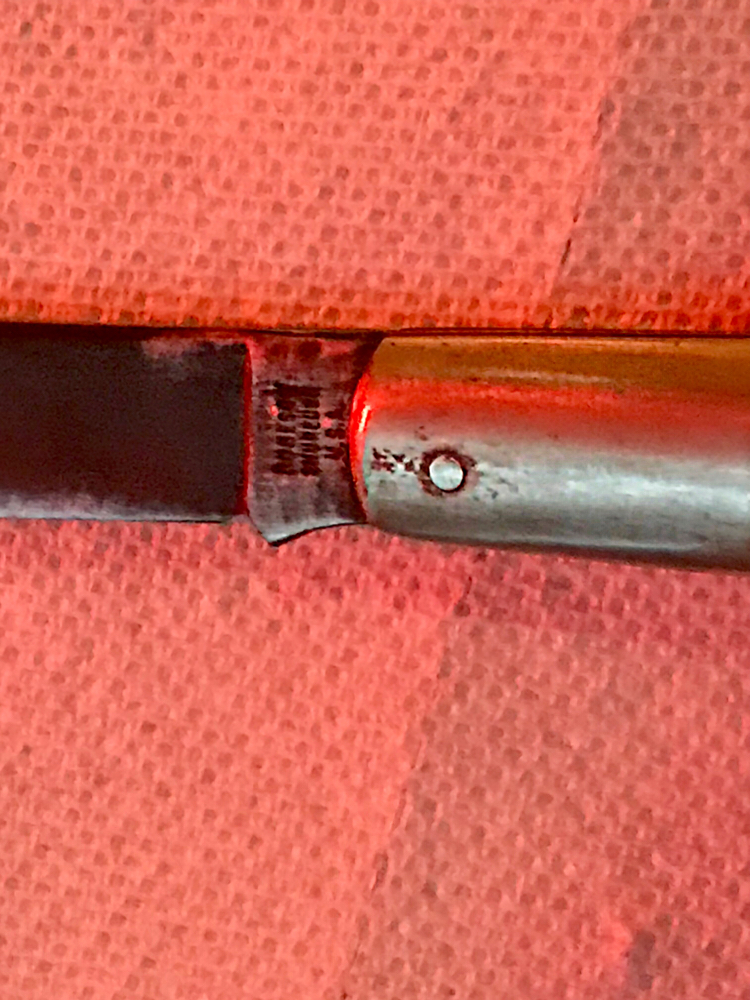

Thank you for your very complete information on Robeson’s Knives! I’m still going through my Grandfather’s knives he collected and used throughout his life and came across the large Barlow style ‘Daddy’. I used your info provided to determine composition of liners/scales, etc. as your can see in my pics, he used this knife almost dailybin his hunting guide position out of Colorado. I remember as early as I can of him pulling this knife out of the inside breast pocket of his hunting vest. It looked huge to me at 4 years old! That was in 1956, which corresponds to the era matching the tang stamp.
My question: it looks like the scales, bolsters, and liners are in very good shape, but the blade looks well used with the patina it has acquired over the decades. How far can I go to ‘save’ the blade from further deterioration? As far as collector value, I don’t have a clue. Will I ever use it as intended- no. So what would be the best advice to preserve the blade? I haven’t attempted any blade cleansing of surface rust removal, so any advice would be most welcome!
Thx I. Advance !
-TnqCmdr
Thx I. Advance !
-TnqCmdr

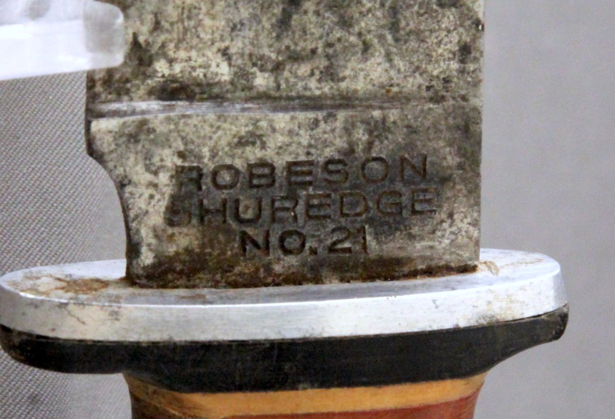

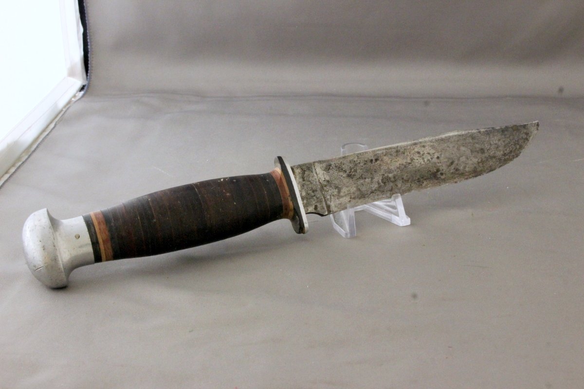

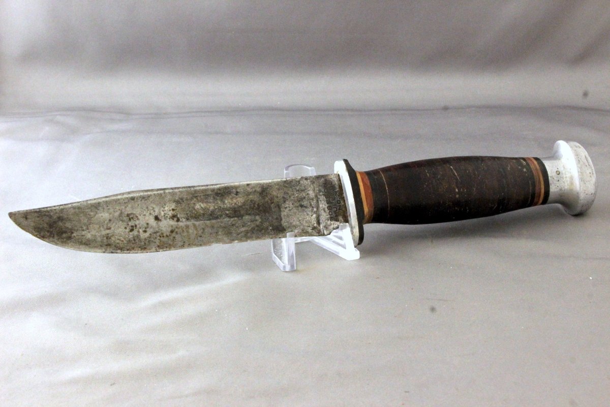

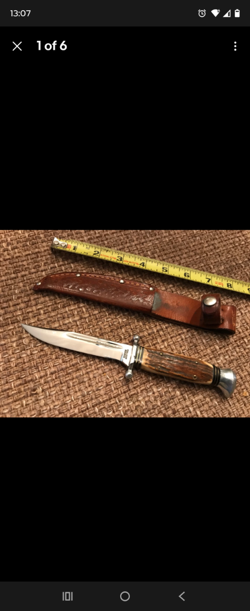

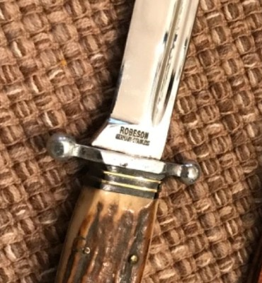

Charlie,
I have just acquired a Robeson Shuredge fixed blade with a stamp that I am unable to match with any thing I have found. A pair of photos are attached but essentially the stamp is ROBESON (over) SHUREDGE (over) NO. 21.
How does this fit in, agewise? I first thought it might be military issue but I have decided there is too much shiny blade under all the stains and spots.
Thanks for any info,
Ray

Sorry, I didn’t see this until today.
That NO. 21 is the same pattern they made as a Navy issue knife during WWII, but those were marked differently.
I have no idea how to date a Robeson straight knife using tang stamps.
I suspect your knife is post WWII, as there were some earlier issue models with a wooden pommel, which were later changed to aluminum.

Trying to get information on this Robeson tang stamp
