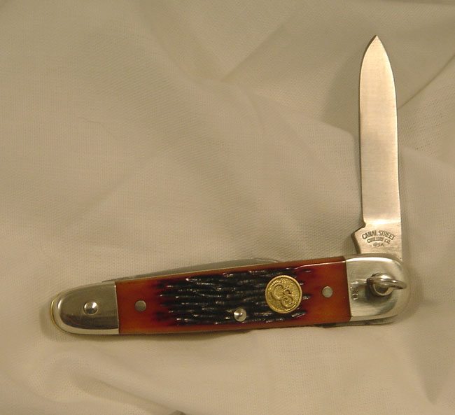

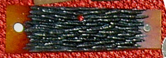

It takes some expensive machinery and lots of labor to cut blades. I'm sure what they get is the heat treated blanks, so the polishing, grinding, sharpening is still up to them. Most of the knife companies buy their scales from the same distributors. These usually come as rectangular pieces that are ground to the contours of the knife after mounting. For example , here's a amber jigged scale in it's raw form with just the holes drilled for mounting on a Canal Street ring turn knife (Incidently one I've never seen Queen make.) While I'm at it here's a micarta locking folder out of their custom shop as well.
Eric
Canal Street NAHC knife.jpg (67.43 KiB) Viewed 6339 times
Canal Street sleeveboard ring opener.jpg (70.83 KiB) Viewed 6340 times
