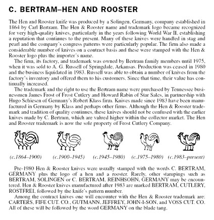

I was wondering if it would be a good idea to have a topic called Tang Stamps where members could post the lists of tang stamps. A member can than match a knife for age and make .
Is this a good idea .What do you think ?

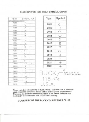

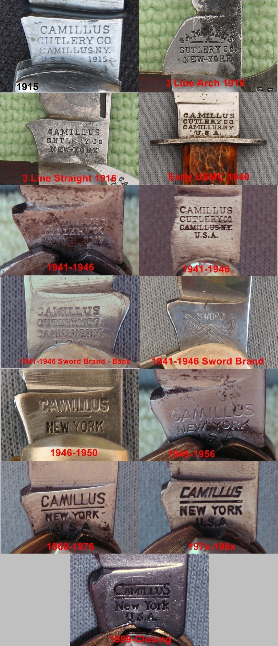

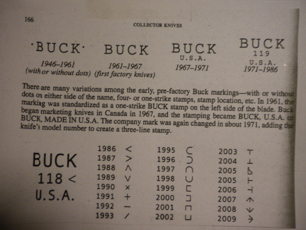

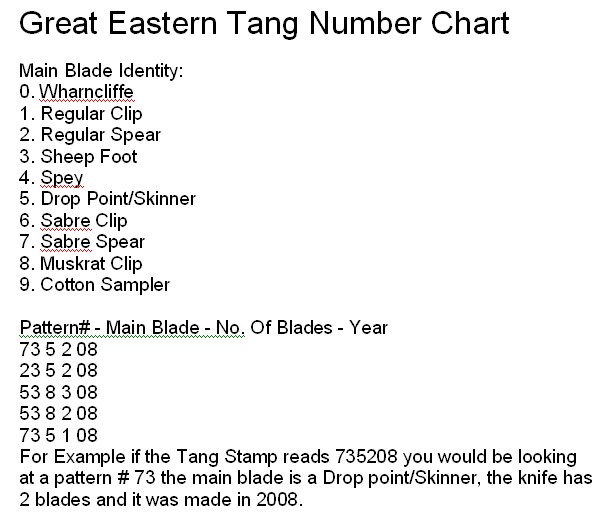

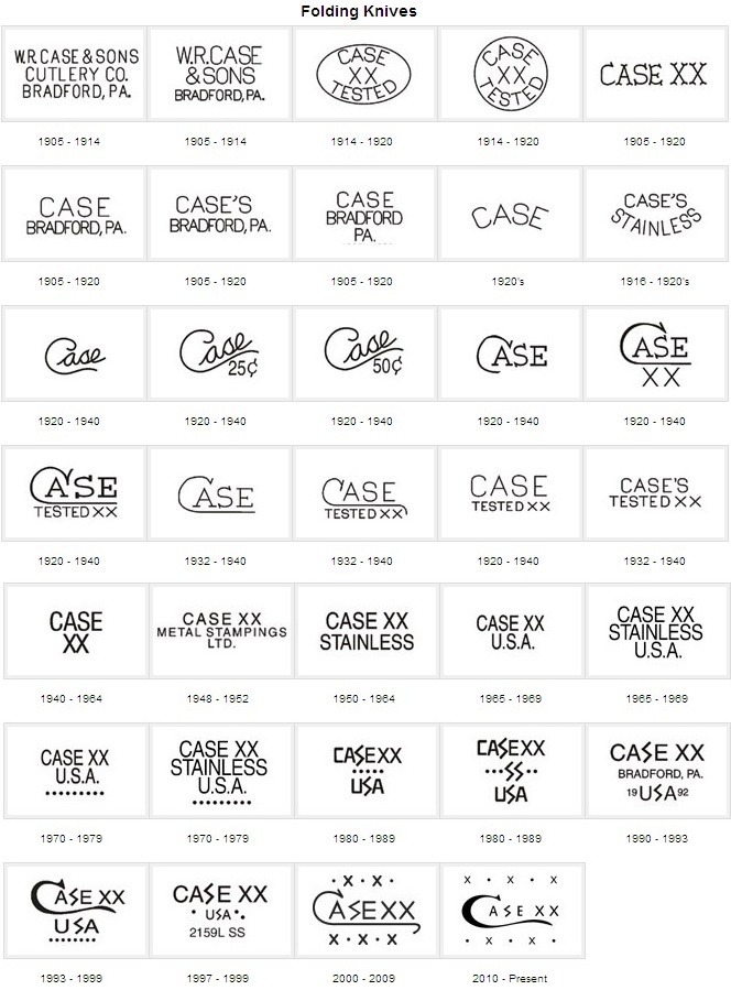

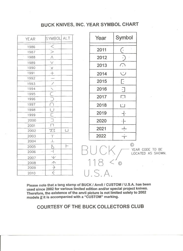

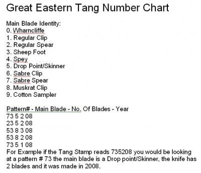

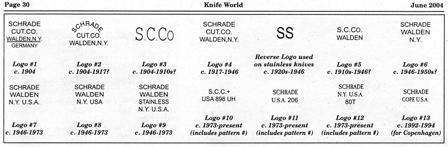

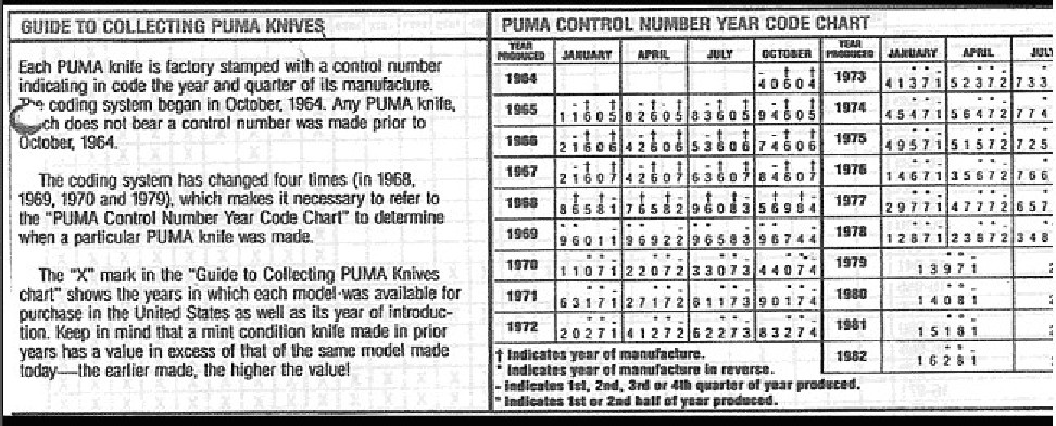

Is this what you're talking about Grant?

Yes jerry .What made me think of this topic I purchased some old knives the other day and spend hours trying to find information.I though if we have the information in a one s topic it would be handy.

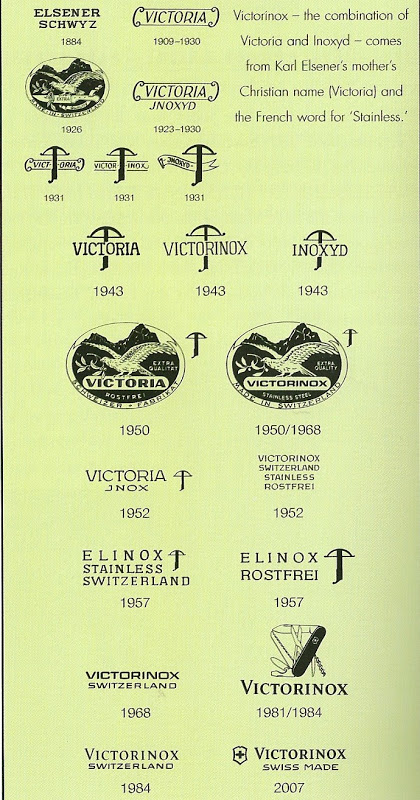

Here is some SAK
Politicians should be like a good pocket knife ." Sharp and useful "

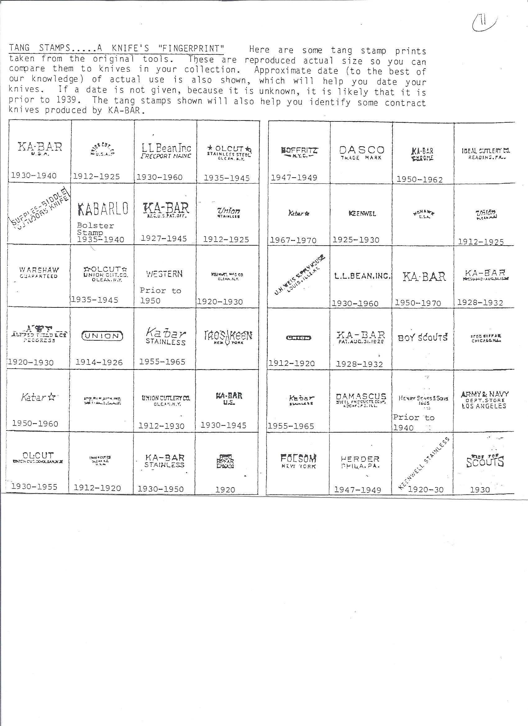

I copied this info on Kabar tang stamps somewhere in the last couple months.
Not sure where I got it from, not how accurate it is.
313 Mike
Posts: 3774
Re: Tang Stamps
Post by 313 Mike »
Good one Dale! Don't think I've seen a chart on KaBar stamps before, 'preciate you posting that one ::tu::

Woo hoo baby. ::ds:: I've never seen either one of them. Two new tang stamp charts. It's a good day on AAPK.

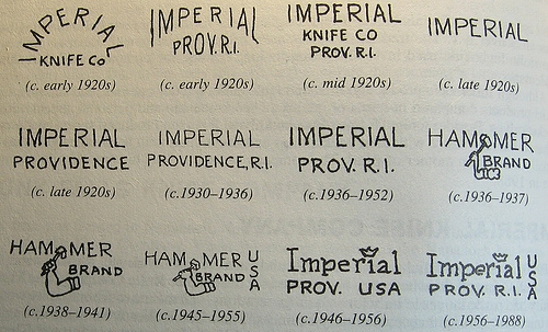

Here is another bunch of Imperial tang stamps that may vary slightly from those posted earlier.
I believe these were originally posted by LT, (Rich Langston).
Just so you can reference them all in one place I added the earlier list-

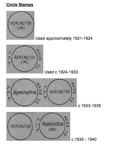

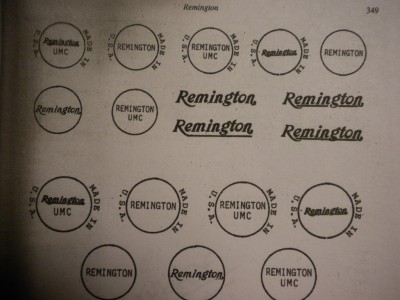

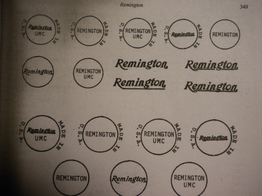

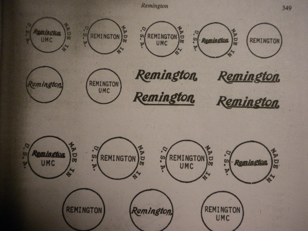

Here is some info on related knife companies: Remington & Pal.
The Pal info I found posted in a thread. It appears to be from Sargents #3.

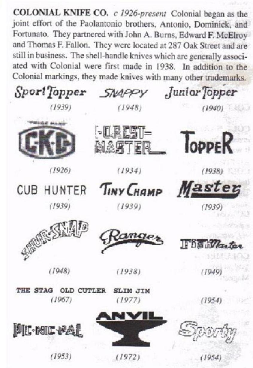

HERE IS ONE NOT POSTED YET.........
COLONIAL 8)
- Junebug 2016

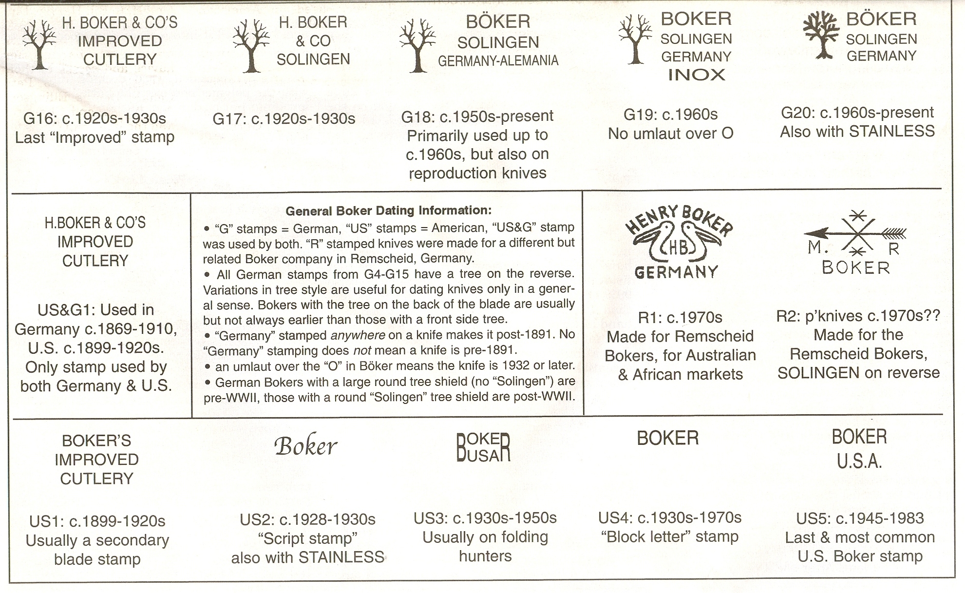

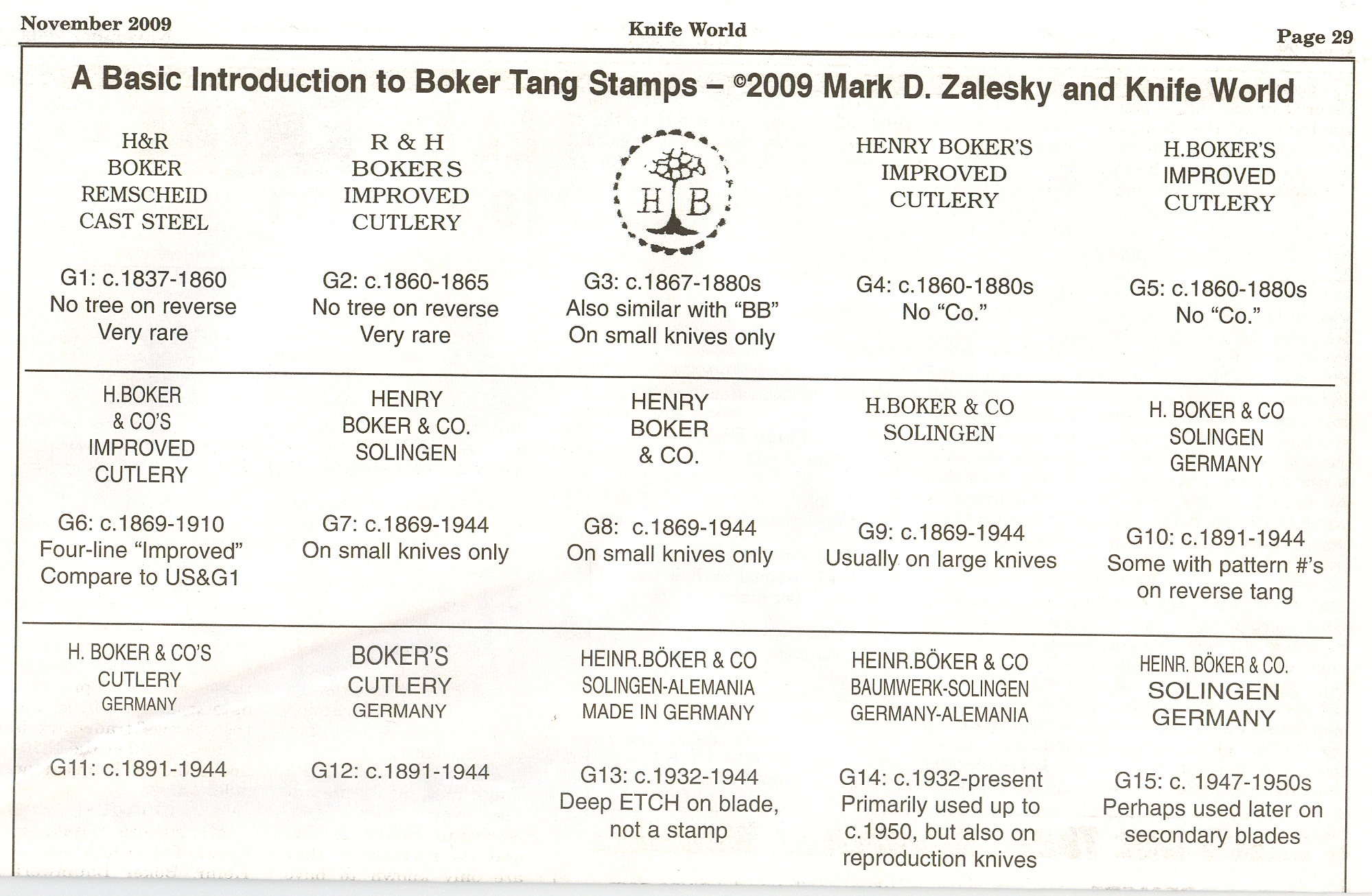

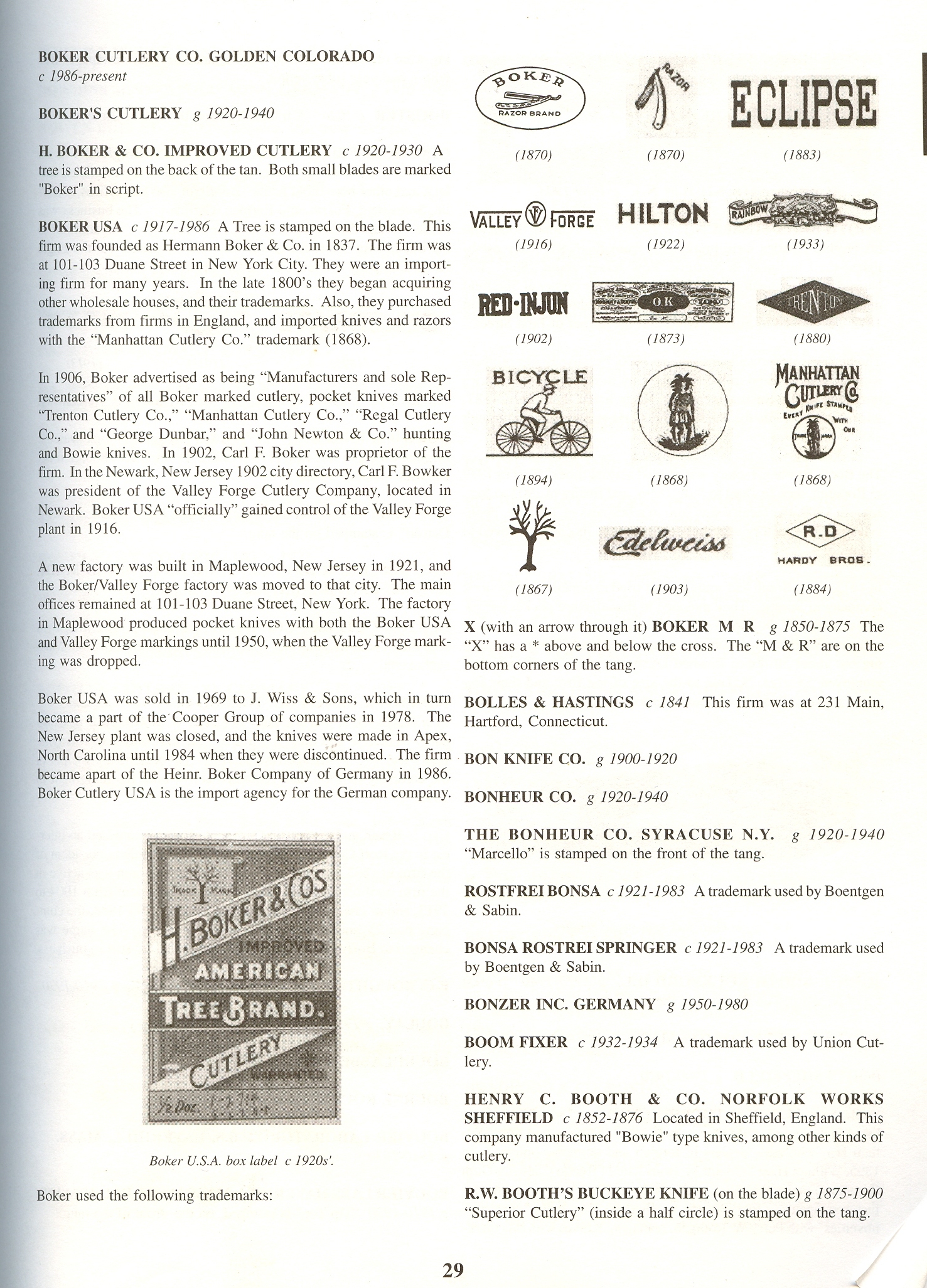

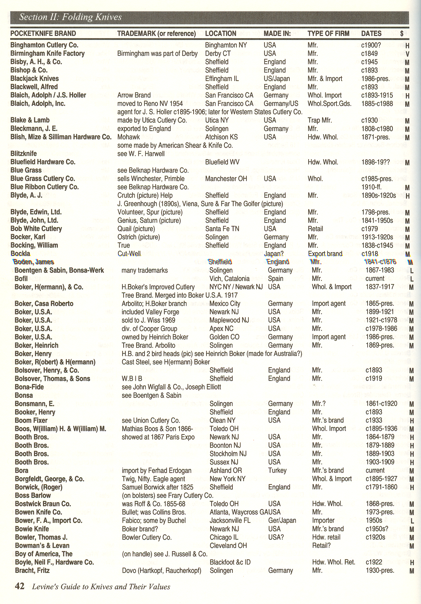

some more BOKER........sorry if some was already posted ::facepalm:: :mrgreen:
- Junebug 2016

BUCK
has some same and some added info, to already posted chart.

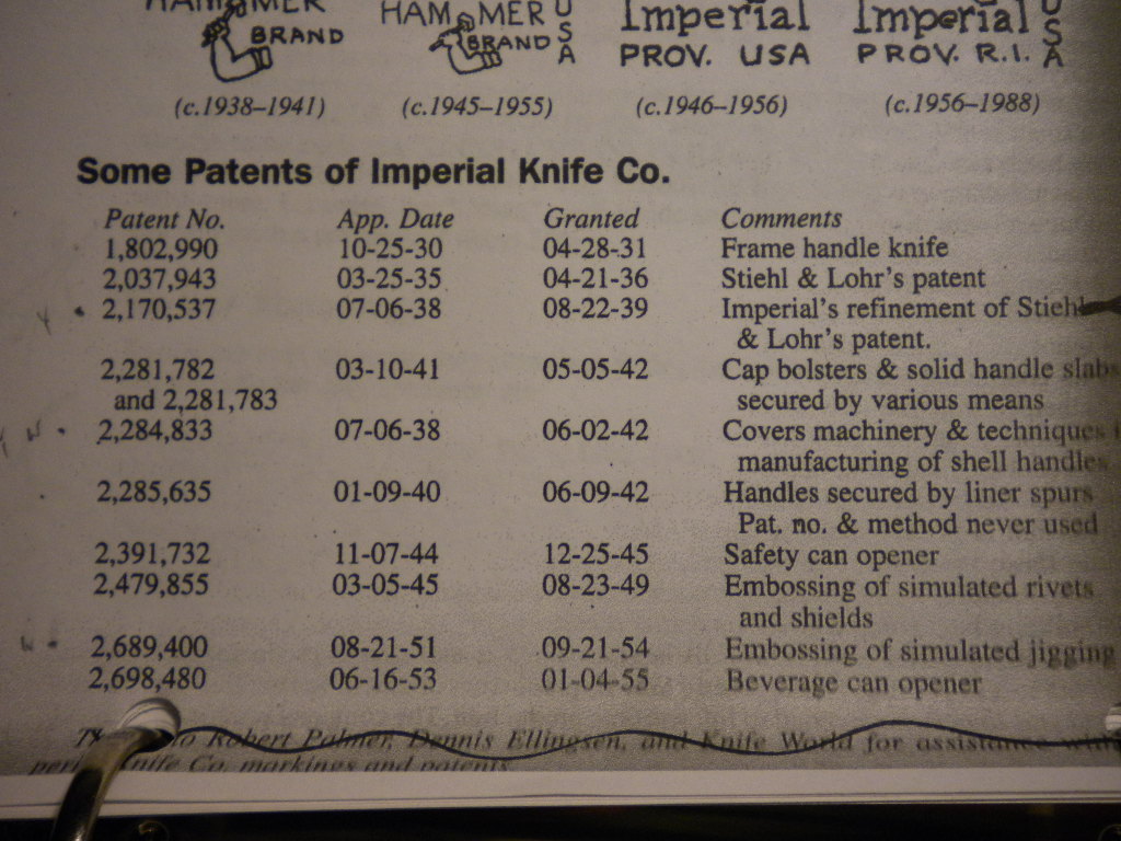

Re: Tang Stamps
Post by junebug »
IMPERIAL
PATENT NUMBER "APPLIED" FOR DATE & "GRANTED" DATES ....and a lil side info 8)
- Junebug 2016

REMINGTON
again some same as posted.....some different/new info in this chart ::tu::
oh SNAP ::doh:: NO DATES IN THAT CHART ::paranoid:: ::super_happy::
