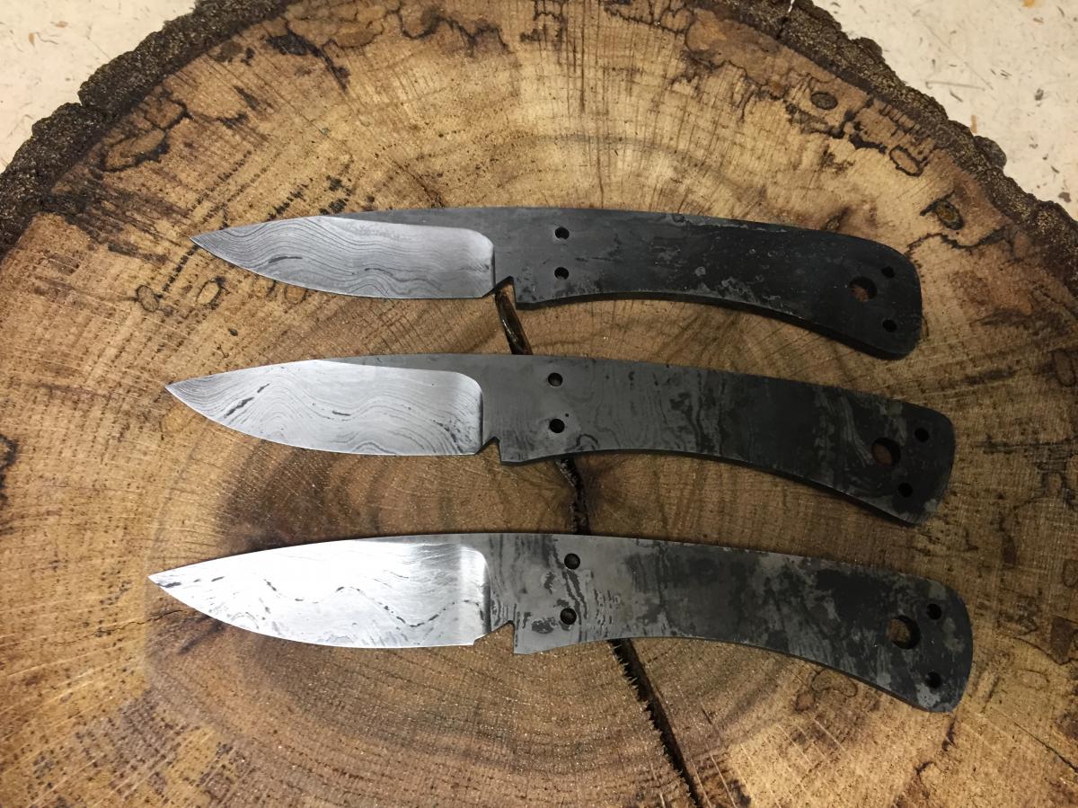

I just did a few Alabama Damascus blades.
1500 deg F. and held for 2 min. and then immediately quenched in peanut oil. Temper at 400 deg F. 1 hr x 2.
This is my first try at this but what I found as a decent method through various searches.
Here is what they look like out of the quench after a little steel wool cleaning.
Wayne
Wayne
